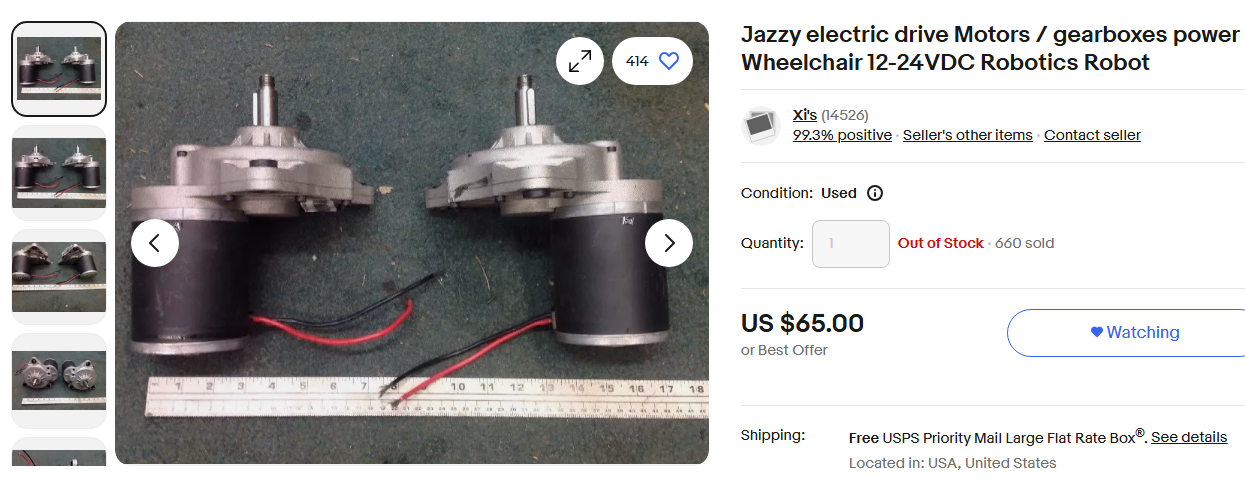

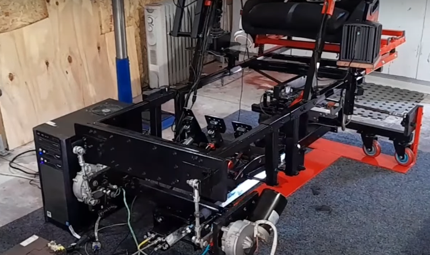

    Hello, I bought a Fanatec base a few years ago and it has been collecting dust. Last night I decided with the coming cold weather (Pennsylvania) and no riding season in sight I would build a racing sim. This morning I decided I would add motion. A few years ago when I bought the fanatec I looked into the spx100 I think it was called. Although now I like D Max's and Doctor ADHD's build. I'm feeling slightly overwhelmed sourcing parts for the best price. I've already purchased these two motors:

    I've seen the crab pot motors, but they seem to be all over the place in terms of quality and power ratings varying by manufacturer. Also the cheapest I could find them was a listing on ebay for $130 plus $30 shipping form Canada.
    I have a good 3D printer and a MiG welder I just can't weld aluminum. No lathe yet, but I have a drill press and other tools needed for basic fabricating. I also have automotive 12v experience just not small electronics. If I could get a good up to date build list from someone living in the US similar to Doctor ADHDs design I would be grateful. Or any advice to get me through this project cost effectively.

    Will try to help but first tell you exactly what you want to build 2DOF or 3DOF or something else.
    The Doctor ADHD platform is okay but it doesn't look the best optimized in terms of engineering :).
    Questions to start with:

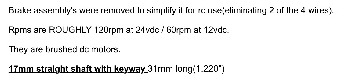

    1. you bought the motors but nothing is known what voltage they are powered by? in the description is 12-24V , give the exact parameters voltage , max current consumption, number of turns
    2. what kind of movement you want to get pitch, roll, traction loss ?
    this is what I know.

    I looked at other auctions on eaby seller of the engines you bought , unfortunately with each auction pastes the same description so it is not a valuable source of information.

    I can always return components if you have a better design. The only dislike I have about the Doctor ADHD design is that there is no write up for it. There are 20 or so videos in the build series and each one is at least 20 minutes long. So it will take me a long time to go through and pick out the necessary info.
