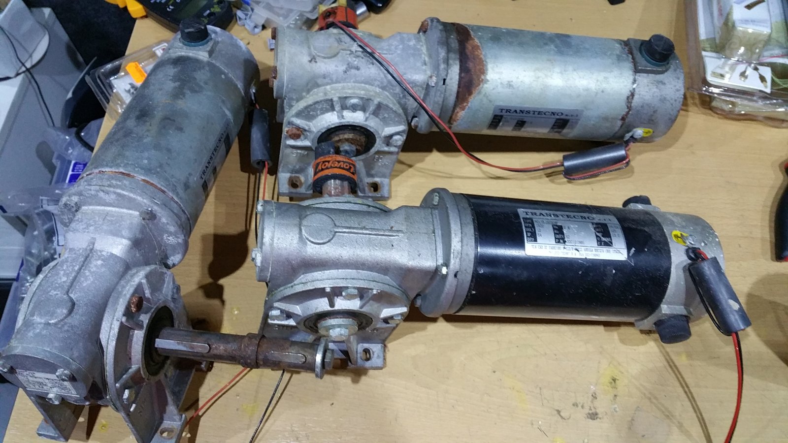

    I will be using my current motors off my rig which have not had any problems over the past 9 months. I think I will be trying a 13cm CTC lever (15cm overall) if that is too long I will shorten it down.

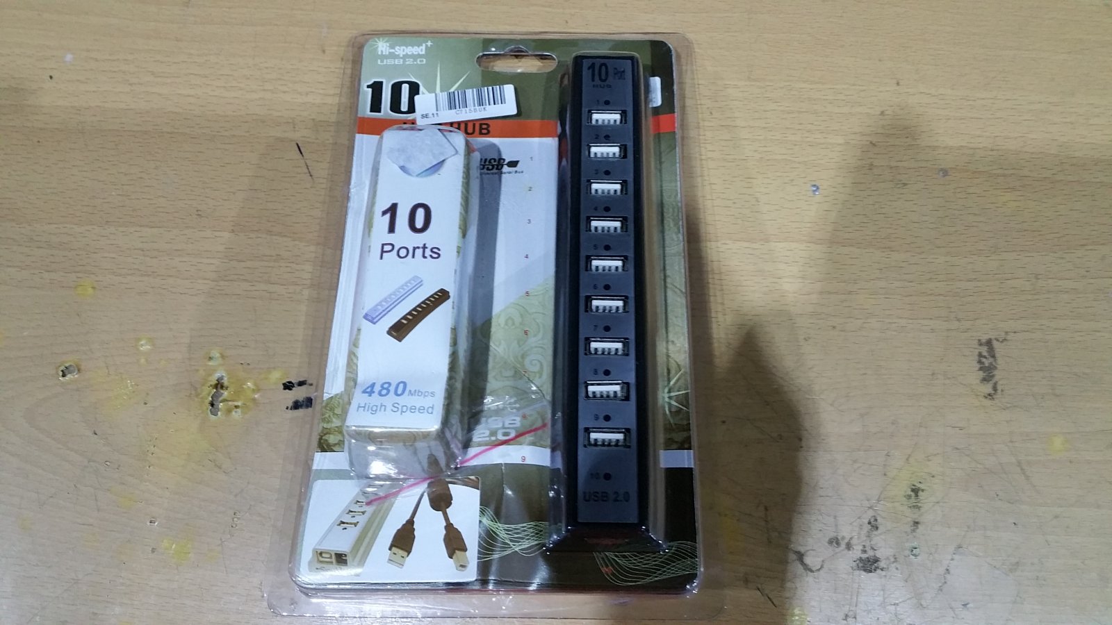

    Some of the parts I have already to get me going,
    Powered USB Hub

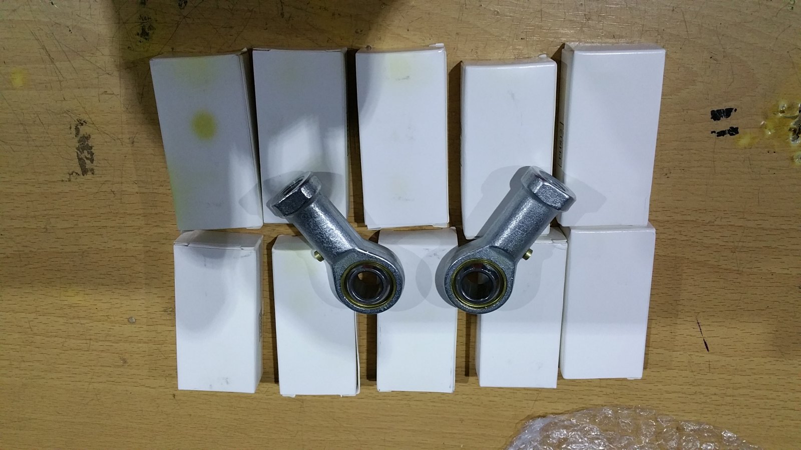

    12 x Ball Joints

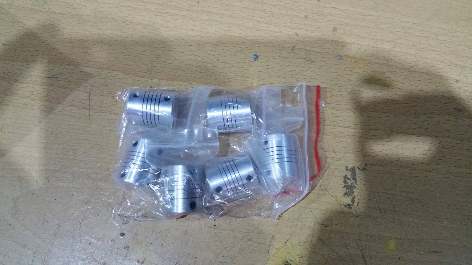

    6 x Flexible Shaft Couplers

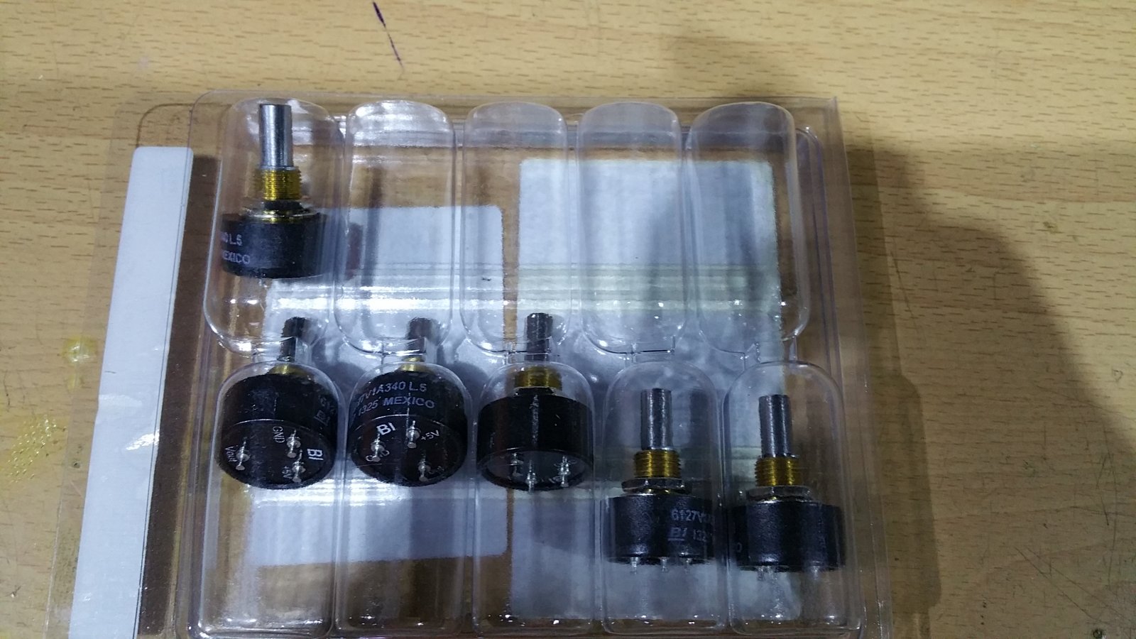

    6 x 360 Hall Effect Pots

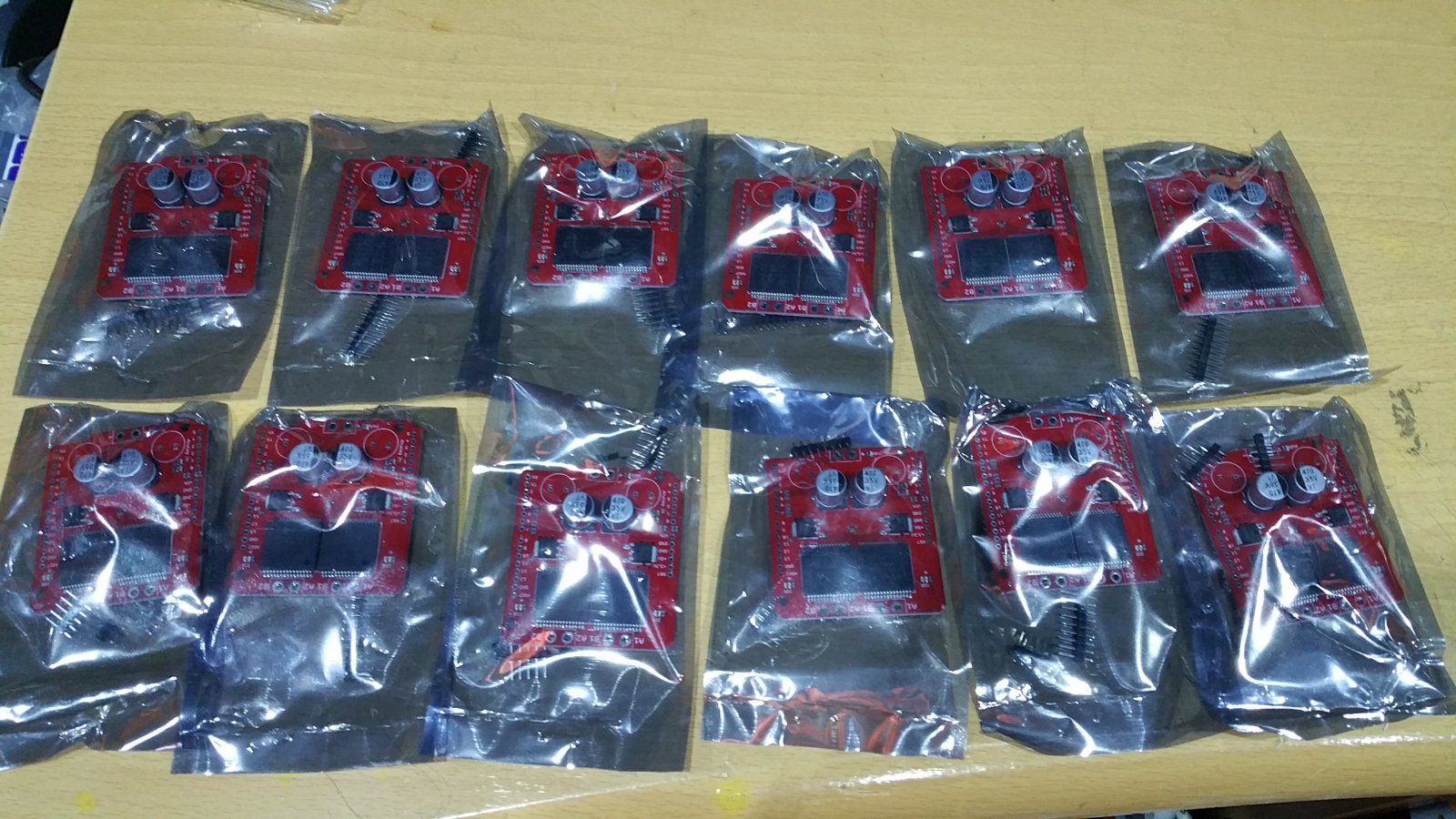

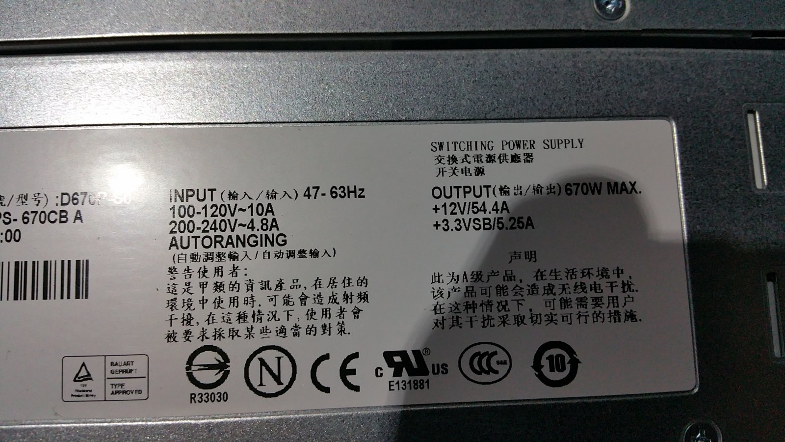

    6 of these bad boys

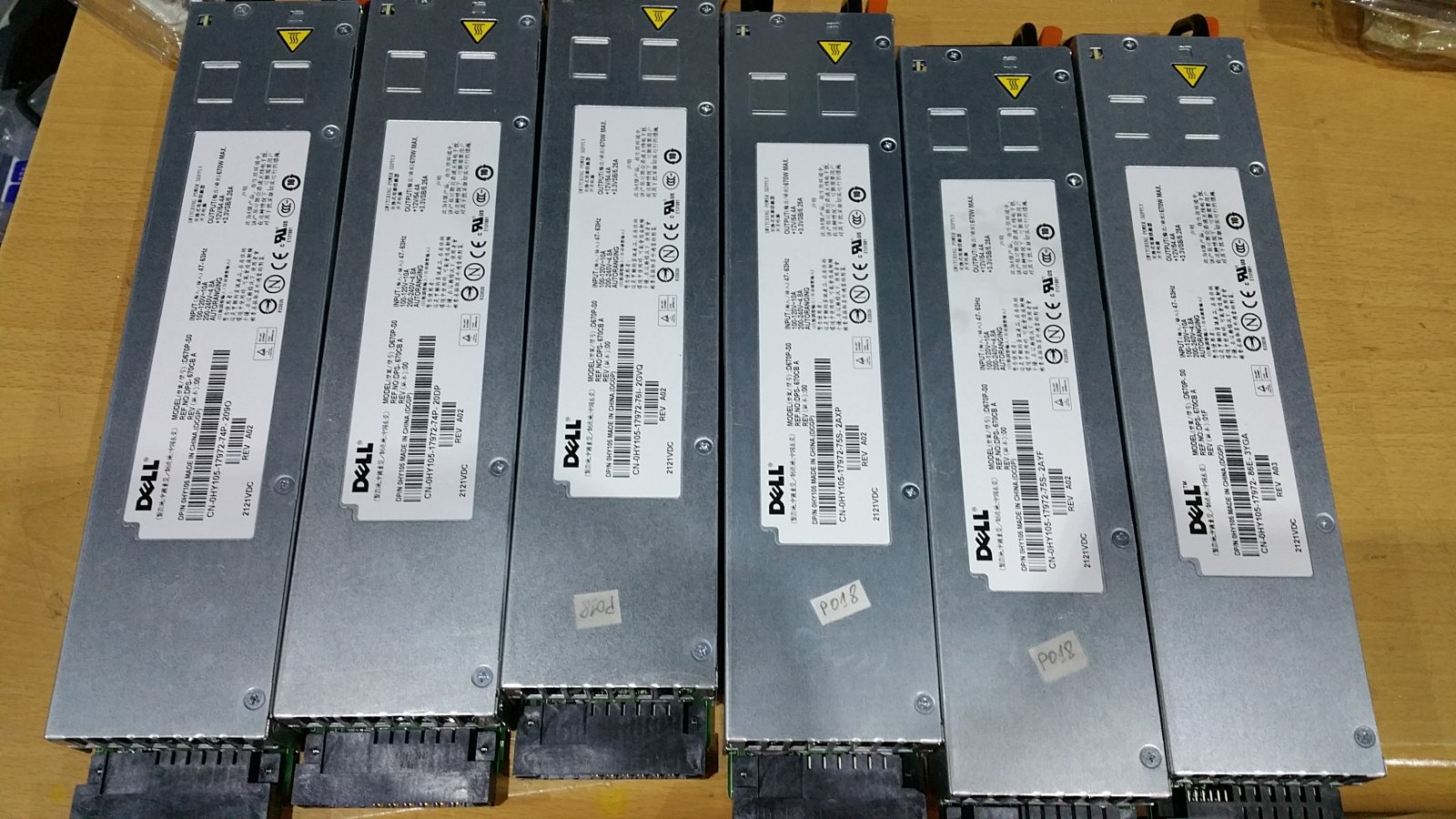

    6 x 670w PSU's eeeeek

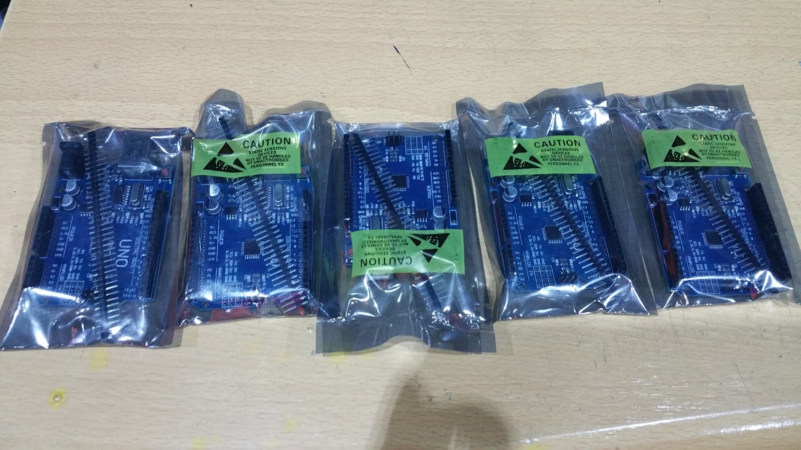

    5 x Arduino Uno clones which I have not had any issues with so far.

    Why buying 360° pot or hall effect if you will mount them with no reduction ? You can buy directly 180°, it will be more precise.
    Why 6 power supply and 5 Ards ?? You can easily use one of this power supply for 3 motors at least, and instead of bying 5 Uno, 1 Mega would be enough (even a chinese copy)...

    @Wanegain the motors I am using will still trip those psu's out if I put the power up to full in scn with a single motor on each.
    Sway and surge are there and as good as any surge table that you may have seen.
    www.transtecno.com are the motors manufacturer

    I am using Ards because that's what I know how to use the same with the POTS it's just what I used before so I will use them again. 3 Ards for the motors and 1 for my fans and then u have a few more to do what I want with .

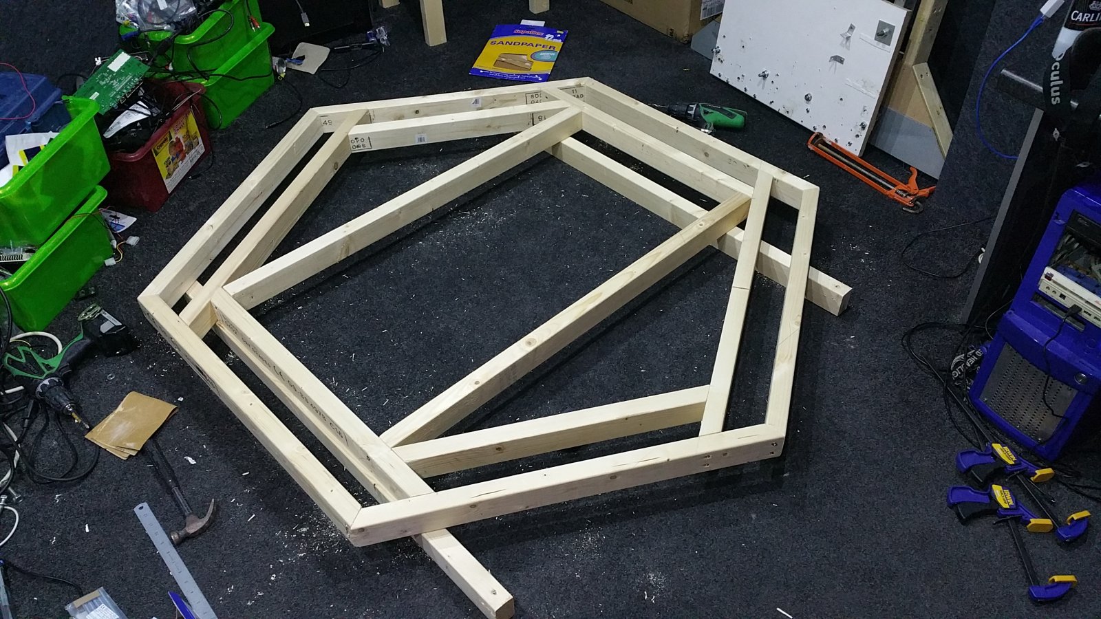

    It's started :D
    I have myself , well ermmmm a hexagon lol

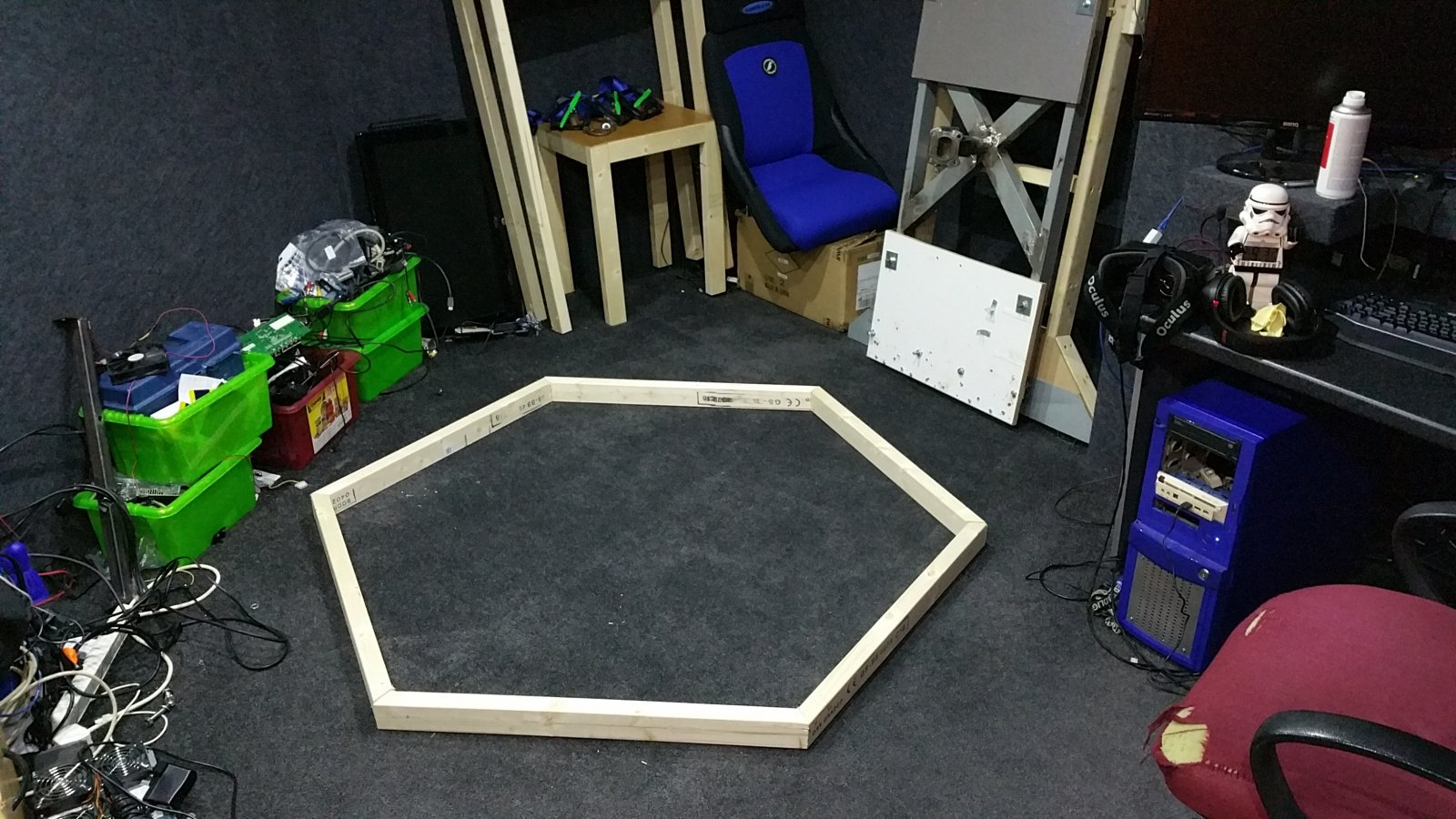

  15. SilentChill
    2,645
    20,585Coins

  16. SilentChill
    2,645
    20,585Coins
    +3,566 / 34 / -0

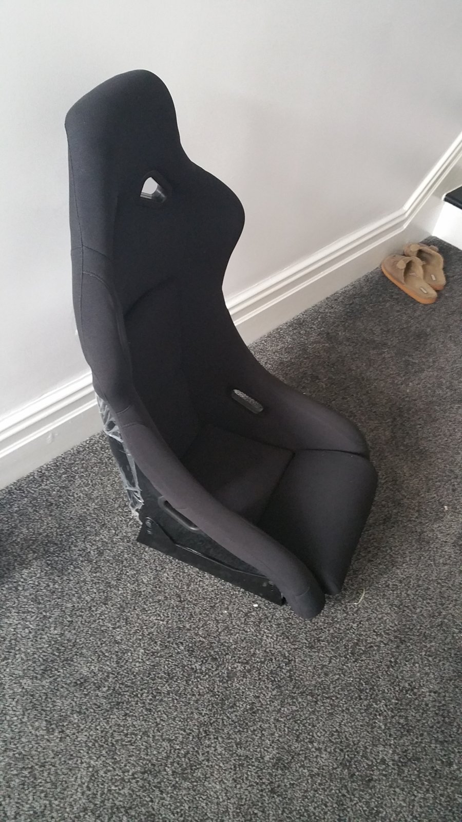

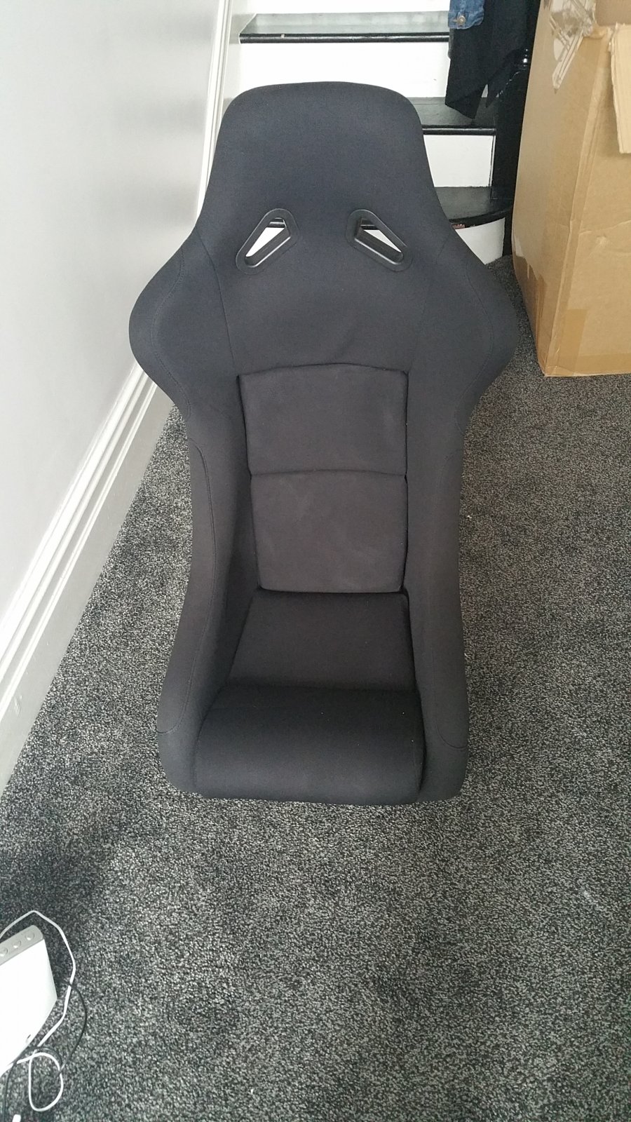

    Oooo new parcel arrived :)
    Only weighs 6.7kg so should help a little.
