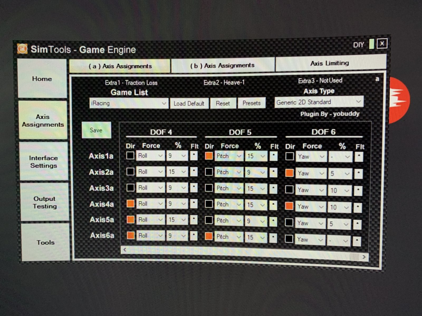

    I finished my new rig with 6 AMC servo controller axis in a hexagon arrangement and using Simtools for my games mainly iRacing, MSFS2020 and nolimits2 rollercoaster. But I am not pleased with the clean movement of every axis. When I test the single axis movement with the "output testing" function of the game engine there is the right movement, but no clean return to the middle position, only a kind of hard shaking movement to the middle position. From my understanding every axis is involved in the movement of every DOF, e.g. the Roll-Movement is involved with DOF1 ....DOF6 with different percentages. Maybe the different percentages must be calculated with a CAD-Program according to the geometry.
    Can anybody offer such a default setting for the axis Assignments in Simtools? Or better a manual to calculate these values?

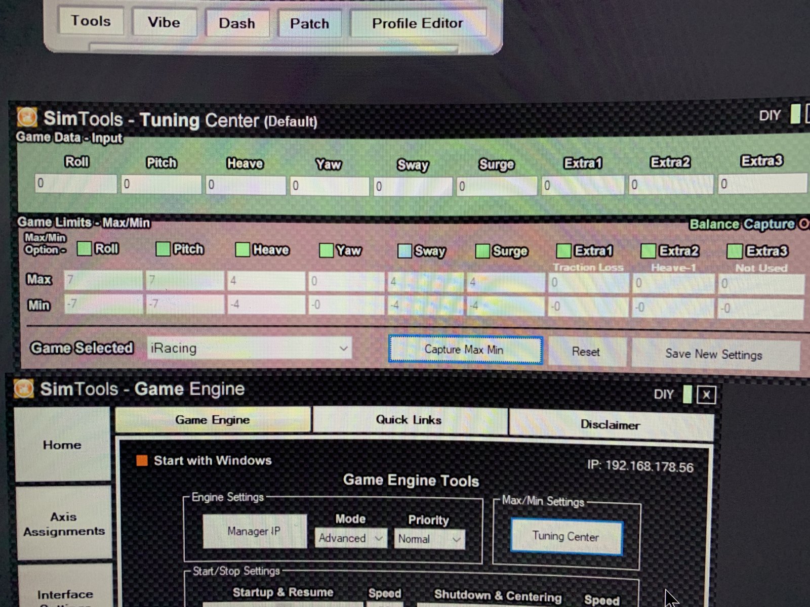

    This is what SimTools should show in Output Testing: https://www.xsimulator.net/community/faq/which-way-to-set-simtool-axis-movements.230/
    That said posting your settings provides context, as there is far more to setting up and refining a motion profile than just the Axis Assignments: https://www.xsimulator.net/community/faq/steps-to-create-a-motion-profile.228/

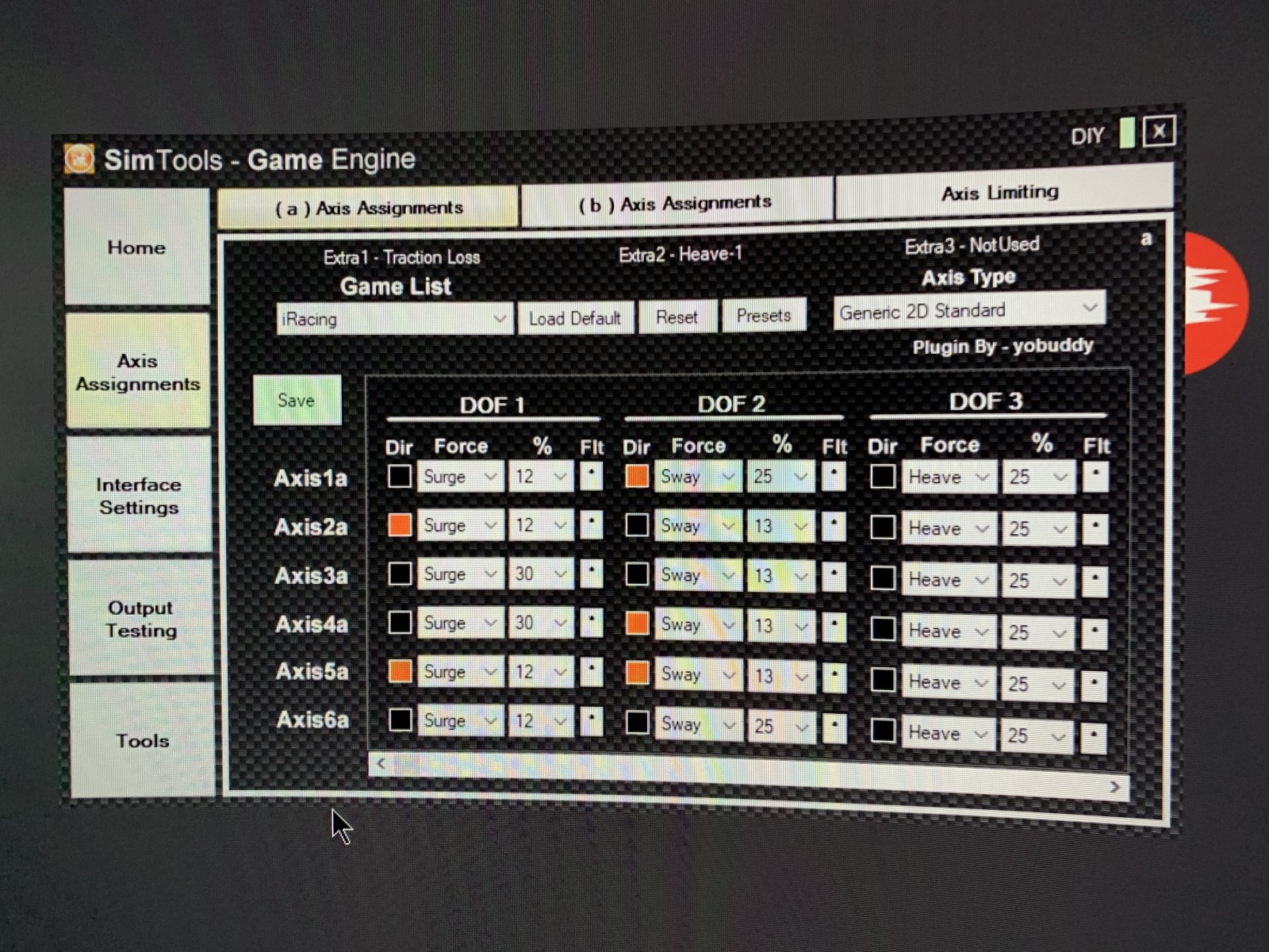

    Coming back to my question for my Axis Assignments. My first setting is working as shown in the pictures.
    But before I can make further optimization I would like to know, how to set a correct Axis Movement for a linear Hexapod. E.g. setting DOF1 as Surge I've been thinking wich Axis should make which movement direction at which value in mm or %. So I found out by try and error as follows (see picture too)
    Axis1a 12%
    Axis2a 12% invers
    Axis3a 30%
    Axis4a 30%
    Axis5a 12% invers
    Axis6a 12%
    The Output Testing at the Game engine shows the right movement, but it is no clear and clean Surge-Movement, only approximately. At the some method I "guessed" the settings for Sway, Heave, Roll, Pitch and Yaw (so fare not used).
    Is there an easy CAD- or Excel-Tool available to calculate the correct values (%) for ever Axis in function of the geometry of the linear Axis of my rig?
