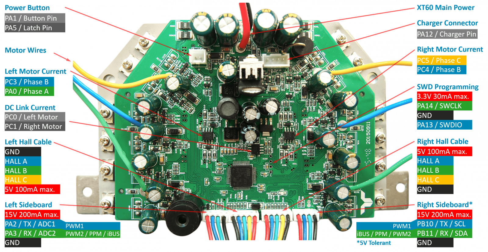

    Hey, I have made DD wheel using hoverboard motor, rotary encoder, original hoverboard controller flashed with Eferu Foc firmware, stm32f401 controller which is flashed with EMC firmware, and I'm controlling it with RC PWM signal. My question is why I cant feel road curbs, or road bumps, only thing I can feel is really big bumps and a car if it starts drifting etc. I tried turning of filters in Eferu firmware, but it only gives the wheel shaking, oscillations etc. how can I fix this? I saw someone remove some filter caps on the unused side of hall inputs to handle higher pulse frequency from encoder, but I don't really know how to do it.. Thanks for the help
  17. Eduardas
    Eduardas New Member
    Jan 10, 2023
    29Coins
    I saw some people use encoder directly connected to this motherboard instead of hall sensors which gives very nice precision, but I don't really understand how to achieve this..
