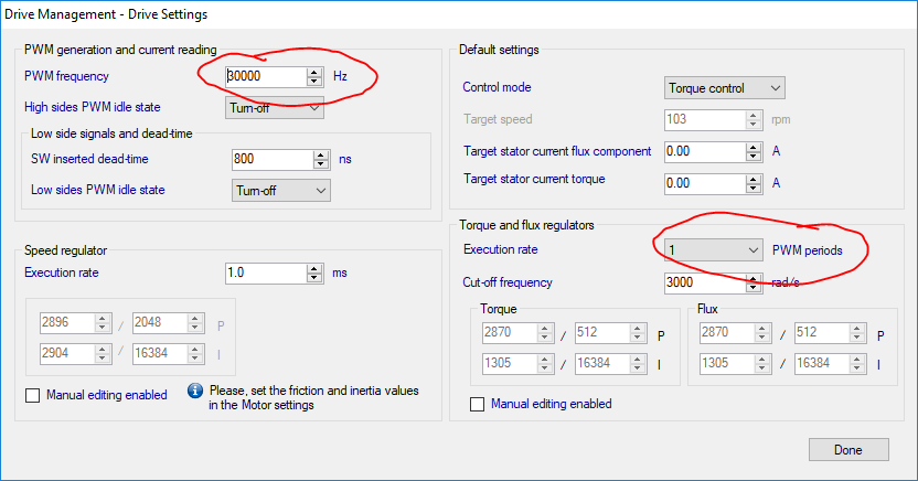

  14. Benu
    Benu Member
    Mar 19, 2018
    128
    1,295Coins
    +41 / 2 / -0
    I agree, you will not use the full strength of the motor unless you are using it to build your muscles.
    The wheel rim I use is a 30 cm DIY wheel. Max torque in motor driver board is set to 8 Nm. In-game gain is set to 75%. That is enough for me. I like the quick response more than the available torque.
    The PWM loop is running at 30 kHz and the torque/flux regulator runs every PWM period. That should be 0.033 ms period length. These are the drive settings from ST Motor Control Workbench:

    That's was very valuable information, thank you. My first thought is that the BTS7960 my be a bottleneck. They doesn't work that well going above 15 khz. My current PWM frequency is 8 khz. The fast PWM in the 32u4 doesn't give you so many option, either 7812 Hz or 62500 Hz according to what I found in the code I found on the net. Didn't think of that earlier, but with the current PWM frequency I'm not helped by a faster cycle time than 128 us...

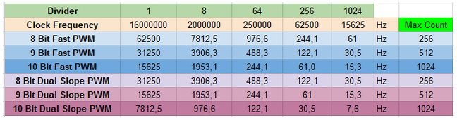

    140Coins
    But what if you'll use 62,5kHz and execution set to 2 PWM periods? If I understand it correctly it should give you something like 31,25kHz resolution which is 3us... Of course if BTS7960 could handle it.

    You are welcome.
    The Leonardo has some more PWM modes for timer 1. This is a nice blogpost on capabilities and how to unleash them. You could use 15625 Hz or 31250 Hz and would be out of the audible range.
