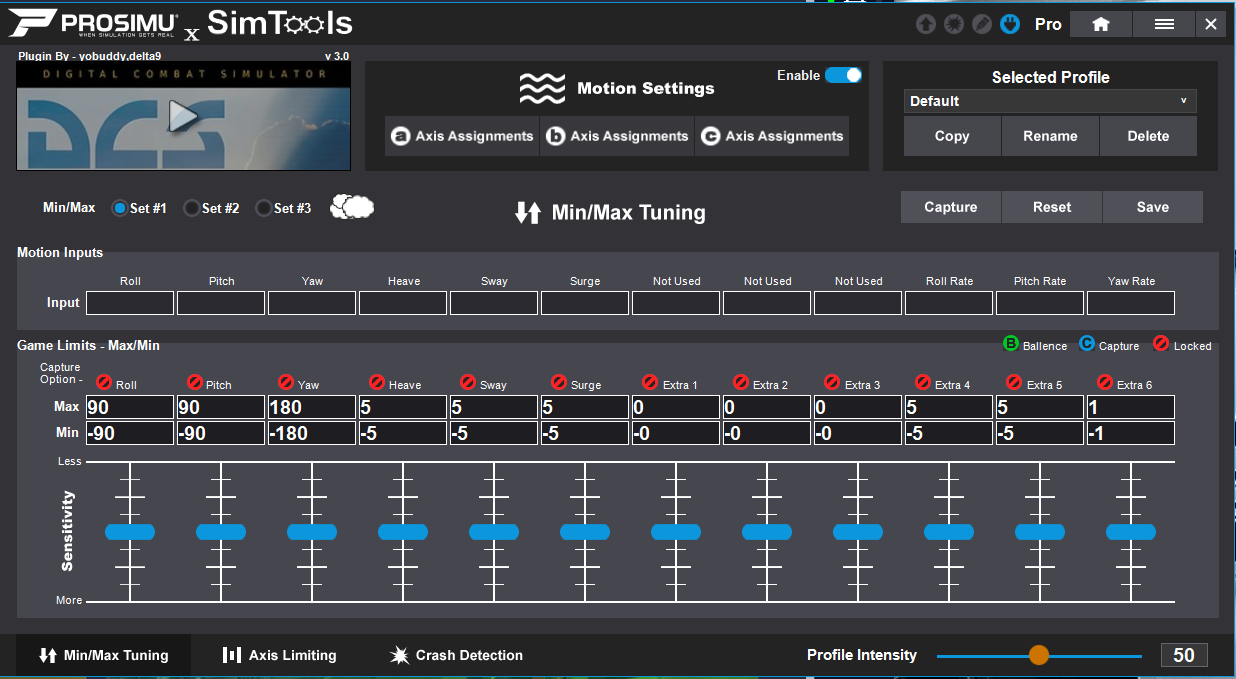

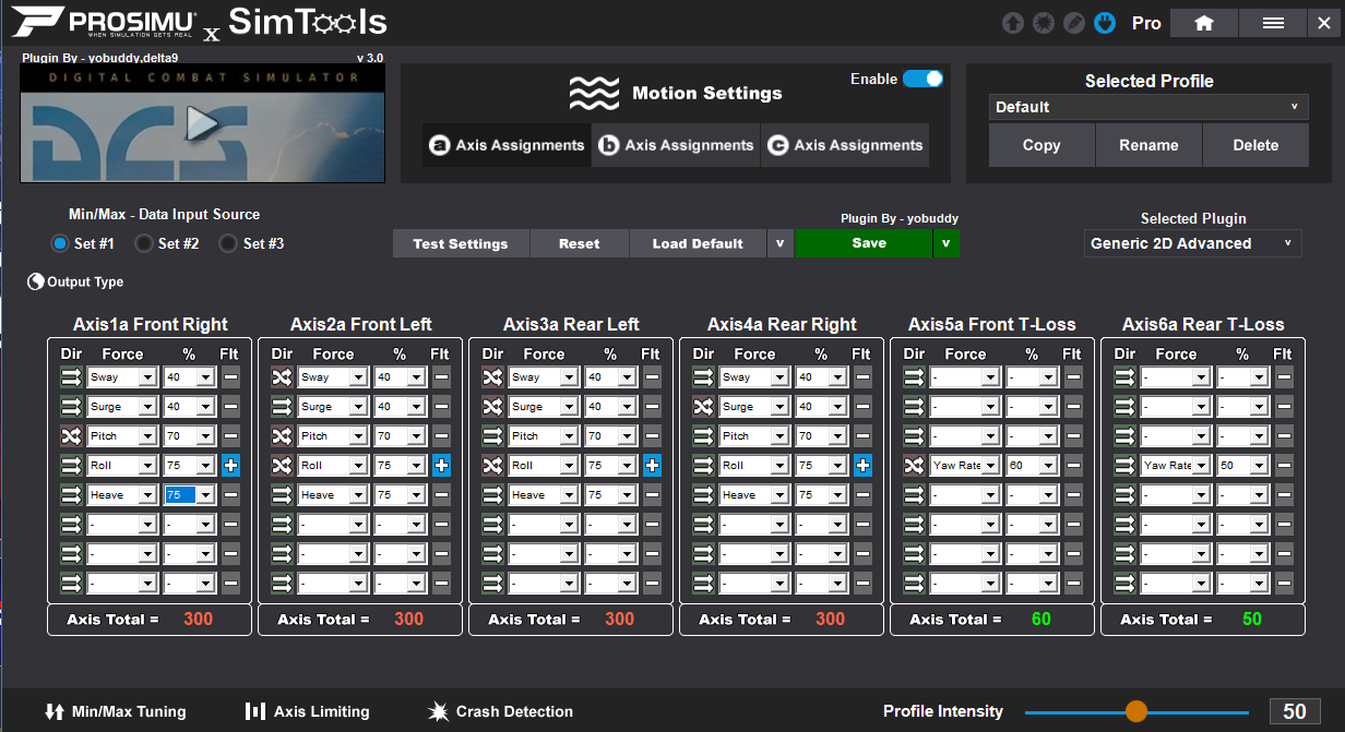

  13. VFX Pro
    VFX Pro Member
    Aug 11, 2017
    65
    Los Angeles
    371Coins
    +19 / 0 / -0
    Motion platform, 6DOF
    Hi
    Hi Noorbeast,
    Here are the default settings for DCS from ProSimu P7MP (6 Actuators). Unfortunately, they feel far from optimized... Plus the mix/max road/flying swtich icon doesn't get save when choose I fly/cloud.
    I even tried to capture the settings but the movements are still "steppy/jerky" vs being smooth.
    Thanks in advance for the tips.
    21,582
    151,106Coins
    I know it may sound like a pain, but if a manufacturer does not provide a great motion profile for their own hardware then you are going to have to refine one yourself.
    First off, while written in the SimTools v2 days the FAQ tips for refining a motion profile for v3 are pretty much the same, though some of the interface has changed in v3, with some added refinements: https://www.xsimulator.net/community/faq/steps-to-create-a-motion-profile.228/
    Understand the basics, that axis assignment splits 100% of the available axis to various shared axis allocation, though in a flight sim you can go over 100% total allocations as it is very unlikely all axis will be at their max at the same time, other than in a crash.
    With the Min/Max, the higher the value the smoother the SimTools response, over a greater range of axis movement. Conversely, the smaller the value the faster the response, but over a smaller axis range.
    Take note that as SimTools mixes setting on the fly it is best to initially refine one axis at a time, so you are not setting up false cues. Do that for each axis and refine them before enabling all axis at the same time, so you know you have a sound foundation.
    Start with pitch and roll and do yaw and sway last, as the latter are more of a refinement.
    Similarly initially don't use filters, think of those as final tweaks to an otherwise fully sorted motion profile.
    Where you have a dedicated axis, such as yaw on your rig, you can allocate 100% to that axis, unless there is vulnerable hardware, like the SCN actuators.
    Once you do nail a good DCS motion profile you can share the love with others who own the same rig: https://www.xsimulator.net/community/threads/simtools-v3-public-beta.17329/page-99#post-251622

    @noorbeast Since changing all the Axis Assignment values to equal 100% now the motion if FINALLY smooth. Why would ProSimu suggest crazy default values like 300? Especially since they require SimTools? Why would they not know any better or ever try their own crazy settings?

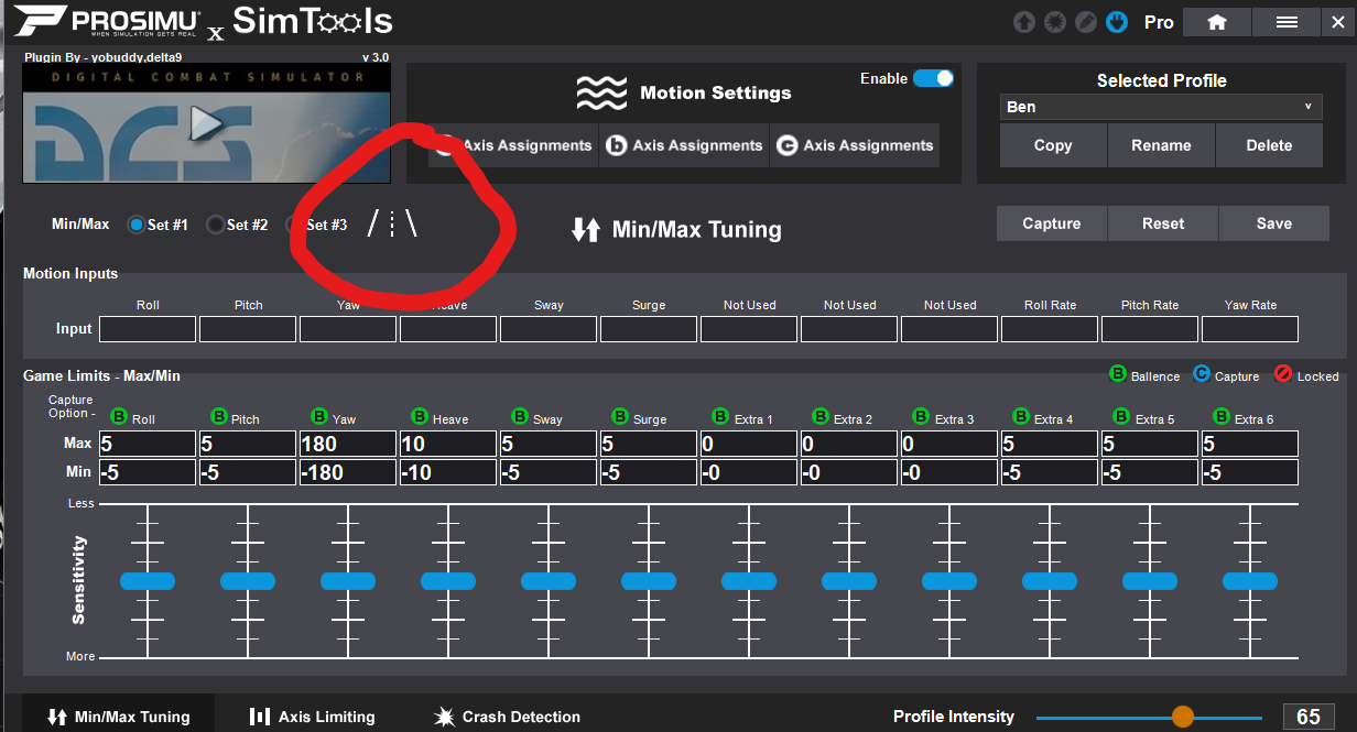

    Also, is there a reason I can't save the road/sky option properly? I keep changing to "sky" and it always comes back as "road".
  18. noorbeast
    21,582
    151,106Coins
    I can't really comment on what a corporate entity chooses to do or not do, but SimTools does make it possible to share settings with others who have the same hardware/rig.
    SimTools v3 is still in RC Beta testing, so I will defer to @yobuddy for dev advice re road/sky option saving issues.
