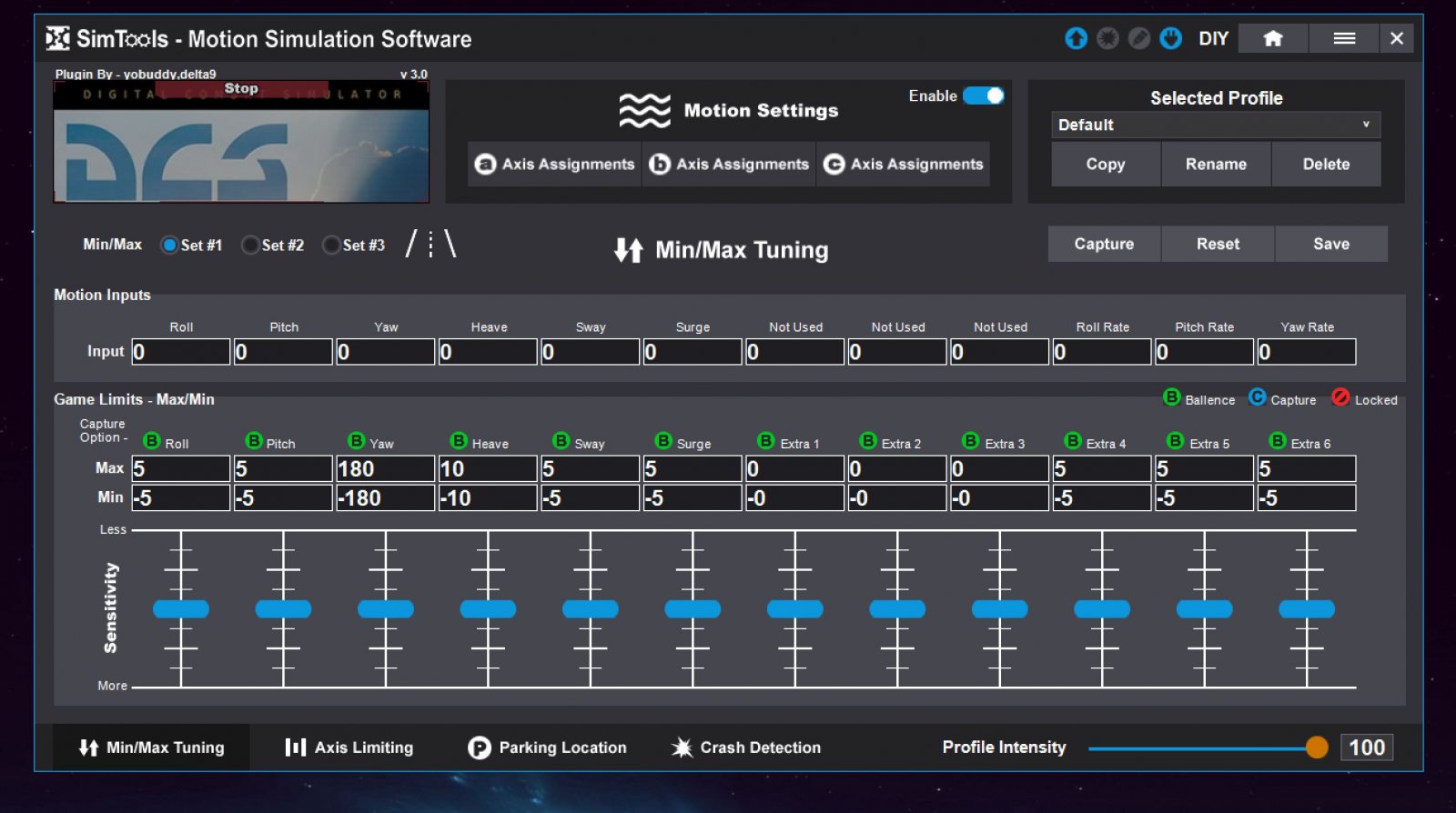

    Good morning
    I have exactly the same problem as Michel.
    Since I switched to Simtools 3 it no longer works.
    I never had a problem before on the old version of Simtools.
    I have no problem with other simulations (except WRC Sport)
    What interests me at the moment is to run my engines on DCS
    Has anyone found where the problem could be coming from?
    I still have the old DCS plugin, but I think it's the same one installed in Simtools 3

    The v2 and v3 plugins are not compatible, if that is what you mean. So I am just checking that you installed the DCS plugin from directly inside the plugin manager in v3?

    I am using the latest version of the DCS plugin for simtools 3.
    Motion inputs are 0 in flight. However, simtools detects DCS well.
    I have no movement issues with my other games.
    I tried simtools 2 again which is still installed on my computer. it does not work either

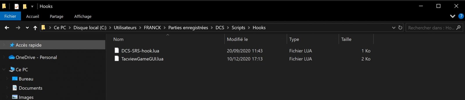

    Oui j'ai installé le plugin avec le gestionnaire de plugins simtools 3
    Voici mon dossier Lua

    There are several steps to validate and troubleshoot the problem...
    1) validate that your interfaces are set up correctly by using the "test settings" function in the interface setup
    2) validate that your DOF's are setup correctly using the "test settings" function in the DCS motion settings
    3) validate that simtools is actually connecting to DCS (the plugin changes to say "stop")
    4) validate that simtools is receiving telemetry from DCS (you get changing values in the max/min screen)
    5) validate that you have proper values in the min/max to get motion
    Other things...
    - ensure axis limiting is set up properly
    - ensure that enabled is set
    - make sure you know how to configure the 'on ground' settings vs the 'in air' settings that you are tuning the right one:)
    if you know which step (1-5 above) is the issue, then maybe someone can help troubleshoot. I can confirm that it does work when everything is setup correctly.

    I did a lot of testing yesterday and I can for sure say that simtools do not receive telemetry from DCS.
    I tried to uninstall/install the pluging in both the c-drive/win/steam/steamapps/dcs and the c-drive/user/save games/dcs (from memory).
    Where should the plugin be installed so I at last eliminate that. However it didnt work either place.
    Thank you.
