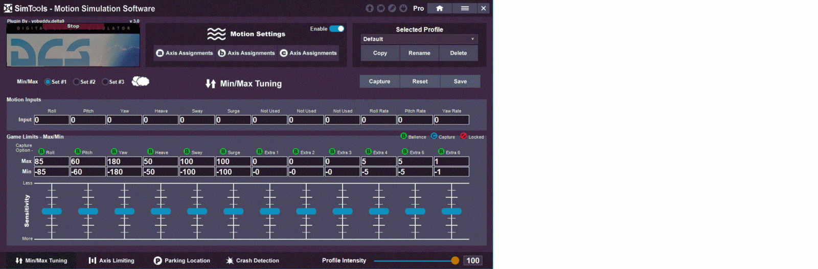

    Here is my Export.lua from Saved Games_DCS_Scripts
    Sorry for the wrong format. Would rather have uploaded the file itself if I could, but forum seems not to permit lua files to get uploaded.
    Remarkable thing with this plugin though, the one that points to DCS World when launching, is that it gives me zero's (0) in the Max/Min screen on the input line when I start the game and have capture button on. But no changes during the game when I'm flying although I move the stick (a Thrustmaster Warthdog) a lot. Still zero's when I come back to the Max/Min tuning screen.
    The DCS Open Beta will come in next post. Need to uninstall the current plugin first and then make a new installation.
    Michael

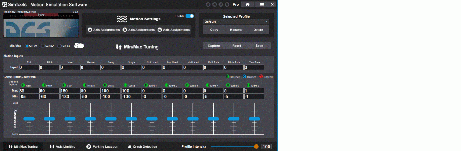

    Here is the content of my export.lua from my Saved Games_DCS.openbeta_Scripts folder (after I have reinstalled the plugin and dropped the DCS Open Beta exe on its banner and launched the game from this plugin)
    Here is the Max/Min Tuning screen from within Simtools when I have launched the game.
    I see now that this launching (to DCS Open Beta) also gives me a series of zero's on the line for input. Same in this case though. I have moved my stick all the ways, rolls and pitch, when in game flying. But no changes of the zero's when I come back to Simtools and turn capture button off.
    All help is much appreciated.
    Kind regards
    Michael
  16. John Murphy
    John Murphy Member Gold Contributor
    May 11, 2023
    85
    Tech Exec
    Virginia, USA
    513Coins
    +23 / 2 / -0
    3DOF, DC motor
    couple of things.. lets just focus on stable for now to see if we can get one working and then apply to the other.
    - Do you have any other lua scripts in your 'Saved Games\DCS\Scripts' folder or your 'Saved Games\DCS\Scripts\Hooks' folder?
    - I assume you have a plane loaded into DCS:) are you on the ground or in free flight when you are looking at the tuning window?
  17. Michael Pleym
    Michael Pleym Member
    Apr 25, 2023
    40
    258Coins
    +8 / 0 / -0
    Dear John,
    I'm so glad you are trying to help me with this.
    Answers to your questions:
    1. No, I have no other lua scripts in my Saved Games\DCS\Scripts folder. The folder Saved Games\DCS\Scripts\Hooks I don't even have as a folder. The Scripts folder is clean besides the Export.lua file.
    2. I have tested flying with Viggen, F 16 and the Hornet. In free flight so I come directly to the flying without ground movements. No avail.
    3. To reach the Simtool Max/Max tuning screen I need to Alt Tab out of DCS. When I do so it seems that any flight stick movements stop to respond in DCS. I need to Alt Tab back to DCS window to connect to the plane again. But although I have capture button on in the Max/Min tuning screen when flying in DCS I have no changes in the values when I exit the game and return to Simtools.
    Kind regards
    Michael
  18. John Murphy
    May 11, 2023
    85
    Tech Exec
    Virginia, USA
    513Coins
    +23 / 2 / -0
    3DOF, DC motor
    interesting... from your screenshot I can see that simtools knows dcs is running and that it's installed. do you have an axis plugin installed?
    you can run dcs in a window and then see both while the dcs window has focus
