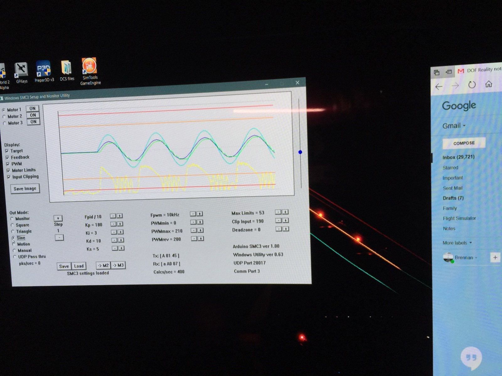

    I attached the peripherals as planned with DOF Reality in my order (HOTAS stick center, rudder pedals, HOTAS Throttle Left, and Rift Sensor Right)
    I wasn't given directions on how to best balance it.

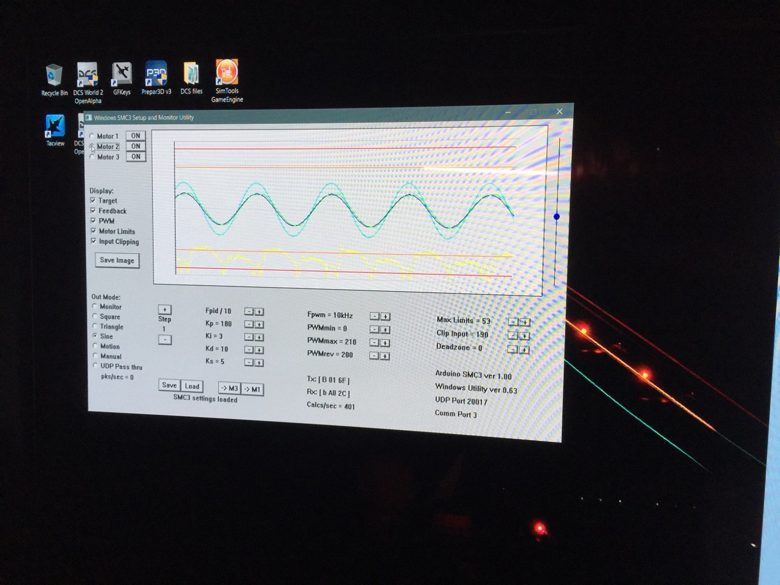

    I am working with DOF reality using SMC3 testing script, and the sine test. See attached pics for motor 1 and 2 output.
    I noticed motor one creates the jerky movement on the downward movement only. Motor 2 seems smooth as it makes the sine wave and Motor 1 is smooth movement on up movement. Could this be a motor issue? I also have more weight (HOTAS throttle and gear box) on the side of Motor 1.

    From your pics Motor 1 definitely has a problem.
    On the graph the yellow line represents the power the motor is using. With motor 2 the operation is good with steady increase and decrease of power as the load is lifted and lowered.
    Motor 1 is a different story. Power is steady on lifting the load okay. But see the oscillations of power as the load is lowered. To me that indicates that the load is not stable.
    Double check your mechanical couplings for motor1. There is slop/backlash somewhere in the mechanism there.
    If not, take off your HOTAS and gear box and see what happens. Might need to counterbalance these?

    Looks like Kp needs to be increased quite a bit.
