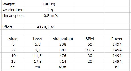

    On a french forum they told me that I have to take in account the acceleration I want, I tried with 2g (3g for going up), and I have this :
    is it right ? if I want a 2g simulator and 0.3m/s for 140kg, I have to buy 1500W (more with loss) motors ?

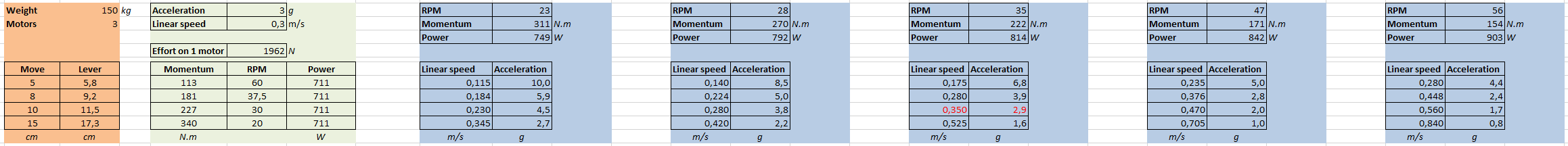

    In the previous table I forgot to divide by 3 motors.
    Here is a new table :
    the one in red could be a good choice ? 11,5cm lever, 0.350m/s linear speed and acceleration = 3g
