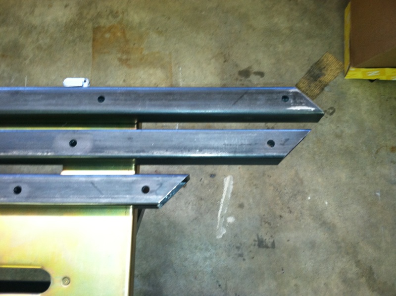

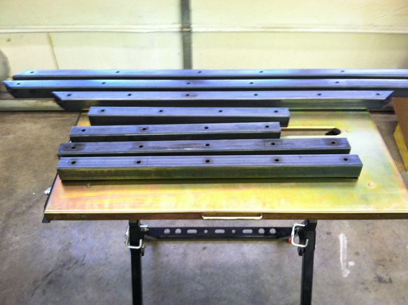

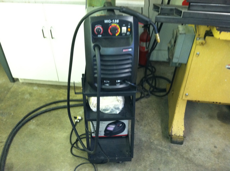

    After two years +, and over 1 year of have the majority of parts - steel tubing, new welder, AC motors, gearheads, u-joints, spline and spline coupler - well you get the idea - I have FINALLY started the build - and it "feels good".......procrastination is over...and finally, I have seen interest in AC and VFD's - and my friend yobuddy turned the page for me.
    I know this will take several months, and at 66 years old, young grand-sons - well, it's going to happen.
    I am building a platform sim, 1hp AC Invertor Motors, heavy duty Boston Gearheads - 30:1 ratio - 3 DOF -
    I am good enough mechanically to do the fabrication - and electrical wiring - but the electronics is where I will really need the help - and I know you folks will help when the time comes.
    I'm sure there's a lot of thought "why is this guy building a ckas type platform" - Well, it started out about 4 years ago wanting a simulator for Flight Sim - that's my 8 year hobby - and with the information I had available then was the ckas type platform - and after much searching, I decided to build a platform with very strong AC setup.... Beginning 012514 (2).jpg Beginning 012514 (3).jpg Beginning 012514 (4).jpg Beginning 012514 (5).jpg Beginning 012514 (6).jpg
    NOW, here's the rub - I started checking out InsideSimRacing, and reading a lot of racing forums and some folks that used a motion sim - no platform types though - Well, I now have, along with FlightSim, the racing bug - having purchased TS500rs - shifter etc... I'm hooked.
    I have invested about 1500.00 US in motors, gearheads, steel, listed above - and I can't go back now..
    and yes, finally, I have to make it work - and at my age I do not need the poop shaken out of me to get excited and the grandsons' are very young......
    Enough rambling - you have the synopsis..

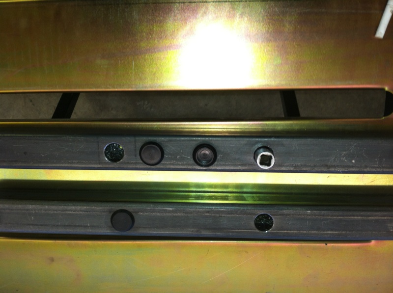

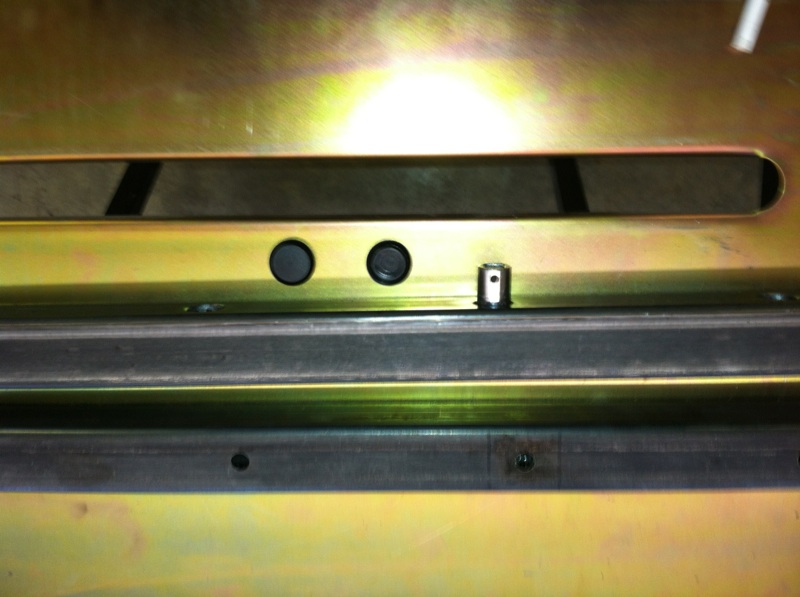

    Steel for the base platform is cut - drilled for the mfd base cover - and I've drilled the backside of steel out to 3/4" so I can put a socket in, tighten up the mfd base, and cover the 3/4" holes with flat hole plugs..keeps the moisture out and just a clean appearance with no nuts or bolts showing.

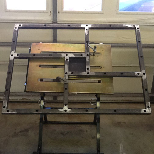

    Frame - Bottom Finished 020114.jpg UPDATE:
    Well, the bottom frame is welded and grinding is done. I'm pleased. Off to HomeDepot this weekend to get the sheeting for base and some paint for base - and onward we go.

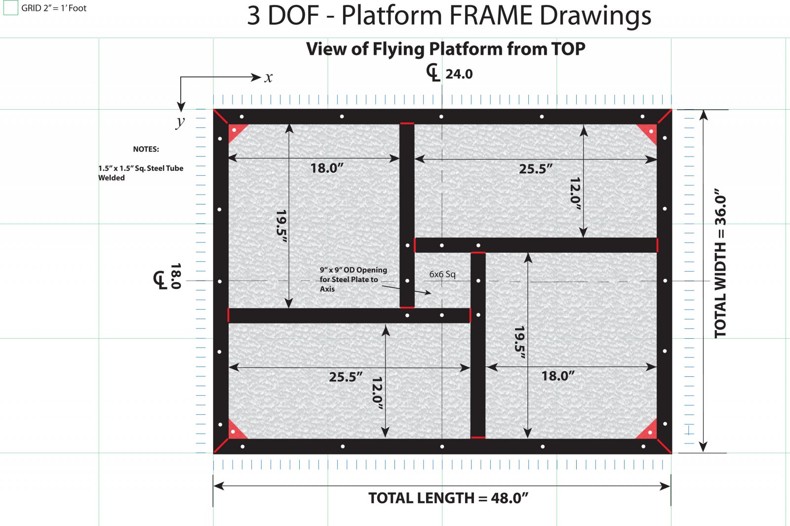

    Hi @cthiggin
    Would you mind posting some dimensions on stuff as you go?
    Maybe slap some dimensions on the picture above?
    I'm sure this will be a popular thread once you get this thing running buddy!

    Platform Dimensions - BASE.jpg Hi yobuddy,
    Dimensions Setup I drew up and used as template.
    PS...won't be long until I'm crying for your help on the electronics...
    Thanks for your interest. Tom
    PS - SORRY for size of jpeg..I'll do better

    No Problem Buddy!
    Thanks so much for the pic!
    I'm sure it will come in handy for people!
