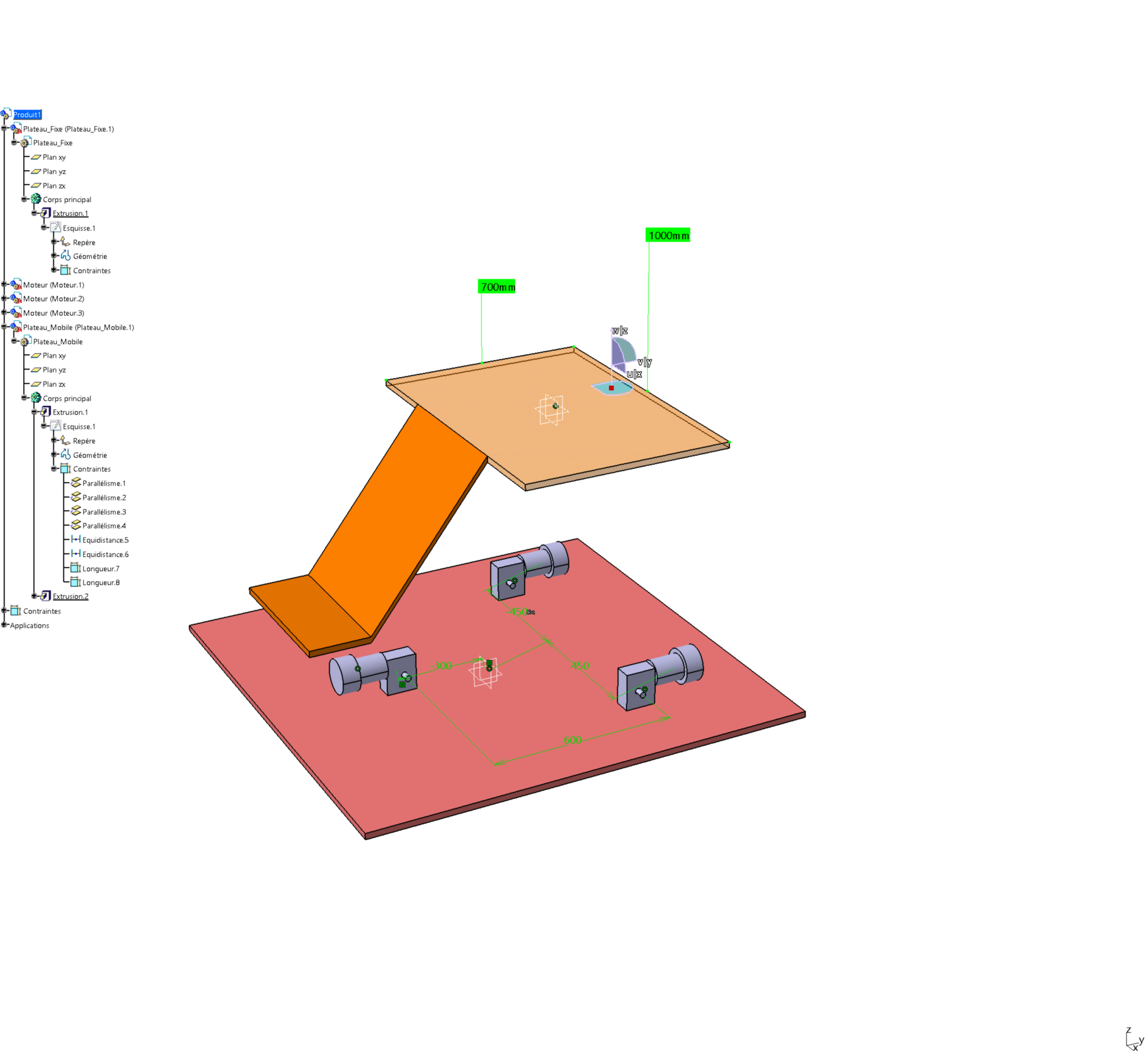

    ok :) I will start to draw my project on CAD, where is the start point ? :)

    Do a basic sketch of the 3dof design you would like to build, post it and ask for members to comment.

    I just started as you said :
    It's hard to begin !
    1meter wide for the mobile : 70cm for my seat, and 30cm for hotas and other things.
    Dunno which angle and height for rudders, if you have any advices ?
    edit : I am 185cm height :)
    And after, what about motors? space between them ?

  12. noorbeast
    21,530
    150,800Coins
    +11,022 / 55 / -2
    There is a thread on cockpit design dimensions that may be of use: https://www.xsimulator.net/community/threads/sharing-cockpits-dimensions.6789/#post-76077
    On my compact spring assisted 3DOF I have 2 motors at the front and 1 at the rear. I suspect it is about as small as it is practical to go, as the base is 500x500mm and the distance between the 2 front levers is only 535mmm and the rear lever is only 45mm out from the base frame. My HOTAS is mounted outside the connecting rods that go to the motors.
    But the wider the footprint the more leverage, so going bigger than mine is a good idea.
    In terms of your drawing I would suggest turning the motors around 180 degrees and indicate where you plan to connect levers.
