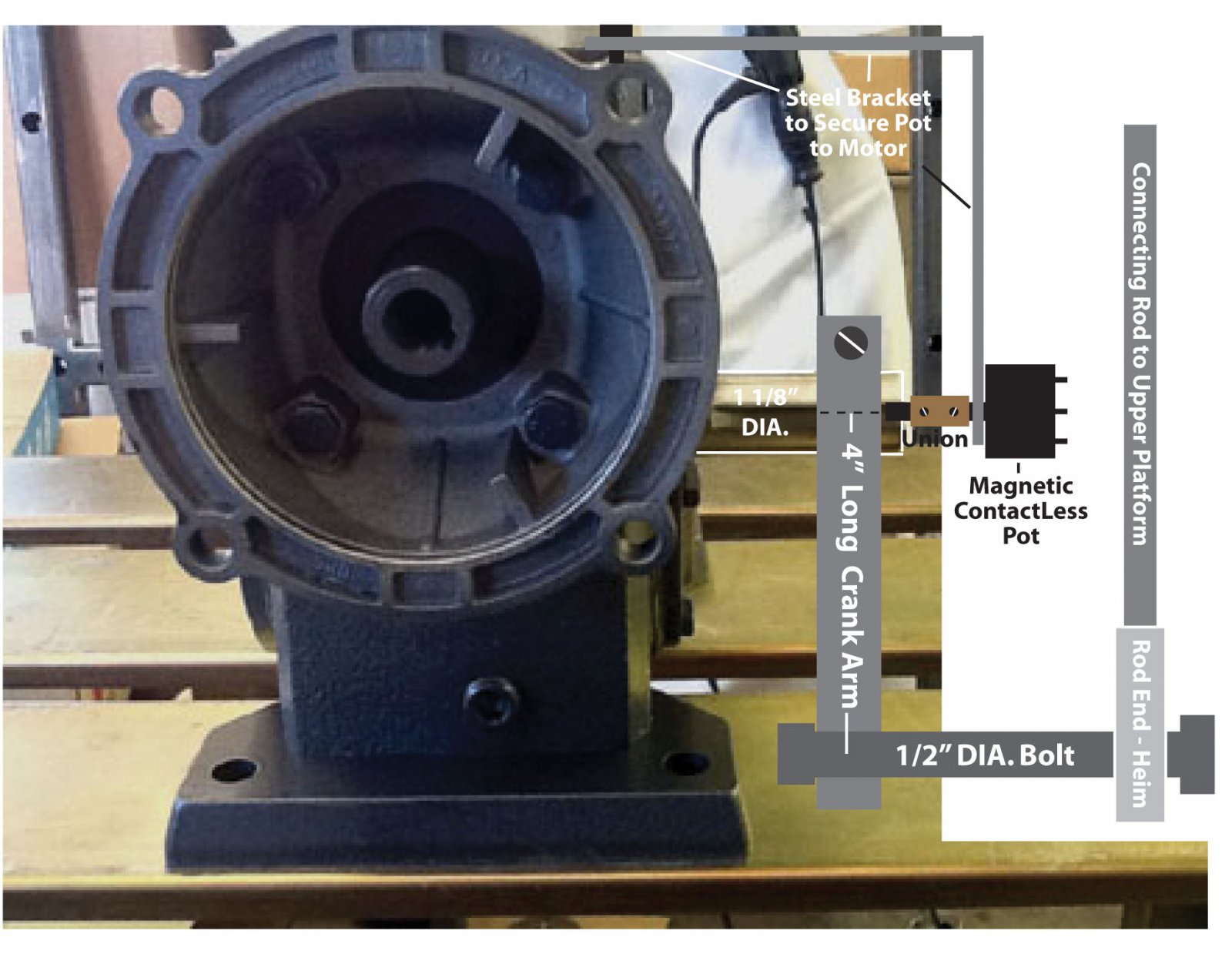

    Hello folks,
    I'm at the stage of my build (See Projects - 3DOF AC Motion Platform IT Begins)
    that I need some assistance and help from forum members.
    OK - My 1st Question of many to come:
    My Gearheads are all cleaned, gear lube installed - and due to the weather not allowing me to paint,
    I want to start working out the pots and how they will interface with gearhead.
    The above attached photo of my gearhead, along with some attached information as to what "me thinks"
    will work, just as well. REASONING - My gearhead output shaft is 1 1/8" in diameter and it would take a very large toothed pulley to be able to drill out a hole that would fit the shaft..
    Most Gearheads of this design, builders use an aluminum gear pulley, large one that fits on the motor shaft, and a smaller one that attaches it to the pot shaft - all coming together with a belt - the pot is usually attached to the base frame with an "L" bracket.
    Info:
    1. Crank arm length - 4" from center to center
    2. Pot http://www.digikey.com/product-search/en?vendor=0&keywords=987 1387-nd
    Digikey - Sensor Non-Contacting, 1 Turn, 1/4" shaft -
    WILL the above work since it's only one turn - my shaft will only be turning about 160 degrees,
    and I want a very reliable pot, LONG TERM use without intervention.
    3. Off of the crankarm - using a 1/2" diameter bolt, LONG enough to attach Rod End and Connecting
    rod to upper platform - The bolt will have to be long enough for the rod end to not come into contact
    with pot - OR, could I assume that with setting the travel points that the arm WOULD stop before
    hitting the pot?
    4. IF this will work and I have some blessings here, I will have to drill the gearshaft 1/4" with carbide bit,
    tap for a 1/4" threaded shaft to accommodate the splice/connector/sleeve (whatever we need to call it)
    to attach the pot shaft.
    I am asking for advice, thoughts, why it will work IF, or why it won't work BECAUSE - well crap, I just need you advice and help.
    Thanks so much friends for hanging with this ol' guy...it has been a blessing.
    Tom

    The pot you have linked to has a 180 in the product code, thats 180 degree the same as the one I'm using

    Thanks for your reply - I went to the data sheet and I'll need the #6127 (has a 1/4" shaft) - and it says "Single Turn" - does that mean it will measure the whole 360 or just 180 degrees?
    AND, gosh forbid, it the gearmotor would start spinning, would it destroy the pot?

    Gday Tom, my main expierence is with 12v DC operation, I connect my pots directly to the centre of the shaft as in the pictures below.
    Pros - Pot rotation is the actual rotated position of the lever. ie lever moves 45 deg , pot has travelled 45 deg.
    Con - If motor spins out of control (rare thing for the Jrk) the pot is broken very quickly.
    Ok to fix the con in 12v gear Im going to use mechanical stops as the Jrks sense a major increase in amp draw but no movement so it actual stops the motor until the reverse direction is detected and they move on. Another way I though about was limit switchs way past the deg of movement I want but not too far that the pot breaks, so if a motor overshoots it clips the limit switch and kills the power to the driver. It should only reach these limits if it goes out of control.
    Not sure if such a safety thing can be incorporated with the VFD's but would be a good safety point to have.

    The 180 means the you get from about 0.4v to 4.9v over half a turn 180,
    these pots will go 360+ full turn without damage, but you feedback voltage is 0v for the second half of the 180

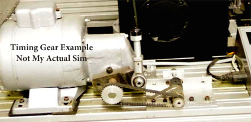

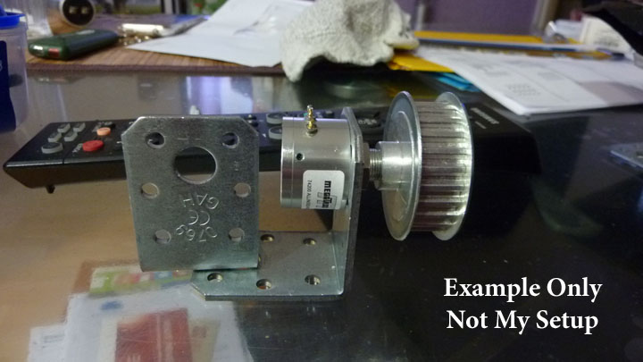

    I am going to go the Timing Pulley/Belt Route - Due to the fact I can keep my rod end closer to the crank arm, which "me thinks" will provide more stability...I had concern that a 4" x 1/2" bolt may cause more stress - PLUS, I don't want to have to drill out and tap the gear shafts.
    The Timing Pulley/Belt Route will rectify this problem, and as stated, I have finally found a source for the pulley's to go over a 1 1/8" gear-shaft.
    From the great info you sent, we are assuming that I am going with the mechanical setup of attaching pot to gear shaft?????, Like initial photo at beginning of thread.
    Please help "here": By going the timing gear/belt route, you will see in the two pics that "these builders" use a large pulley on gearshaft, a smaller one on the pot - which means we are going to turn the pot about 5 complete turns per 180 degrees of gearshaft movement - IF this is correct, then I would need ????? a different pot - the timing gear/belt builders seem to be using a wire wound multi-turn pot. I want a pot that will last longer and more precise, such as the magnetic contactless one I listed. I don't see how this would work considering I'll be turning the pot shaft about 5 times??
    MAYBE this is an acceptable thought process: Go with the same size timing gears on both the gearhead shaft and on the pot - then we have a 1:1 ratio and the above pot would work great - DOES this seem acceptable to you folks??? Like I said, DUH, I need help in these areas.
    Thanks for your information and help, most of all your patience.
    Have a blessed one.
    Tom

    @cthiggin I am unaware of any digital type pots myself that are multi-turn. So if you are going to go through the hassle of a timing gear/belt route anyway, you will probably want to go with a high quality wire wound multi-turn pot or a mechanical encoder. One issue with a digital pot is that since all the output is over a short range, they are very sensitive to any movement. So any play or backlash added by your gear and belt will have a move adverse effect then when the range is spread out over several turns. Also the SimAxe only has a 10bit adc (analog to digital converter) so the digital pots input will be cut to 10bit also. You could go with a mechanical encoder too but your controller must have the means (inputs and code) to read it because it is outputs a pulse or count, not a voltage. But since an encoder doesn’t need an adc that does eliminate the 10bit bottleneck.
    Ps. I guess I’m not getting why you can’t just hot melt the digital pot to the end of the shaft where the big gear goes and get rid of the gears and belt altogether. I prefer not to use high quality wire wound pots myself because they are as much or more expensive than the digital pot mentioned, still have noise on the output, and have friction that will wear them out sooner.
    Edit: Or maybe you just prefer not to use southern engineering, lol! :cheers

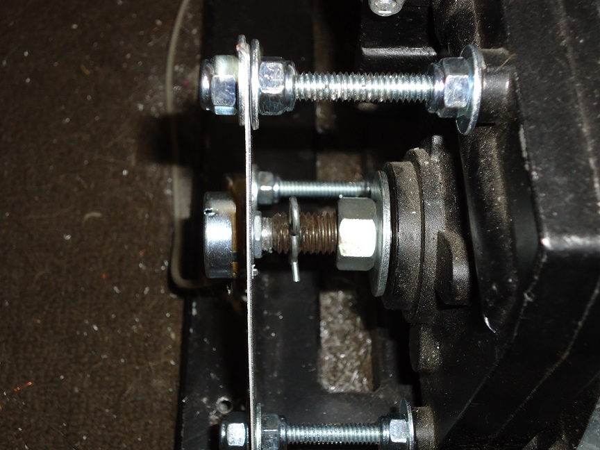

    Now you not only "see" but "know" why I need you guys. Makes sense explaining gearhead and timing gear/belt backlash...
    OK - Your "hot glue method". Your saying to hotmelt the shaft end of pot to the center line of gearhead shaft ??? then use a method of stabilizing the pot body, via a wire, bracket, or whatever works? (ME thought that you wanted me to hot-glue the ass-end of the pot to the shaft - couldn't figure that out since the terminals are on the back side - GEEZE)
    Like my first pics in this thread - (We are eliminating the drilling of gearhead shaft/and tapping - This "would" also bring pot closer to gearhead shaft. IF this is the case, then my rod end shaft could be closer to gearhead shaft - but STILL provide enough clearance to miss the pot, just in case of over-run? AND, best of all, I could use the proposed contactless pot.....
    Hopefully, I'm on the same page.......IF so, let me know and I'll proceed in ordering the pots.

    Yes, shaft end to shaft end. I have found though that the pot body needs to be able to "float" a little bit but still not twist. If there is any perpendicular movement between the motor shaft and the pot shaft, the pot needs to move with it otherwise it will fatigue the glue and it will eventually pop loose. But the bailing wire, for me at least, is strong enough not to twist with the shaft movement but still give a little so it elevates the stress on the glue joint. The bailing wire is attached at my frame, not to the motor itself so it must give a little. I am using ball bearing hall effect encoders at the moment though and there is virtually no resistance at all in the twisting of the encoder shaft. I do have some of the pots you linked to however and am planning on using them in my new build. But with it though I will be able to drill a hole in the lever to connect the pots shaft to but will still use the wire to hold the pots body in position and hot melt glue to hold the pots shaft in the hole.

    @cthiggin If the plastic disc you speak of will hold the pots shaft so it cannot shift sideways from the gears shaft at all then a hard mounting of the pots body may work. But it is imperative that if there is any sideways stress between the pots shaft and gears shaft when the motor turns, it is either eliminated or accounted for (for example if the pots shaft is not glued perfectly in the center of the gear head shaft it will wobble slightly). Without any give in the pots mounting point, all the wobble stress will be applied to the glue joint and it will fail at some point. One of the last things you want to happen is have one come loose in operation unless your controller tests for this and shuts down automatically or you have limit switches. How I mount mine with the bailing wire is form the wire in a half circle around the size of a soccer ball. Make a loop in the middle of the wire around your pots neck and tighten its nut (would be better though to have a piece of metal with a hole for the pot to go through and then attach the wire to it somehow). Now find a place to attach the ends of the bailing wire (maybe even still to your gearhead). You can bend and manipulate the wire to your needs. Just make sure that is strong enough when your done so the pots body can’t rotate with the gear shaft, but can still move slightly right, left, up, and down as necessary with the stress. Make since?
    Also there is no index on the digital pots that I see anyway. You will have to use a voltmeter to find the correct position for them and make your own. However, if they are not correct after gluing the shaft all you have to do is loosen the nut holding the pots body, rotate it to the correct position, then tighten the nut again. Also, with the bailing wire setup I use, you can make minor adjustments to the center position by just bending the wire slightly one way or the other.
