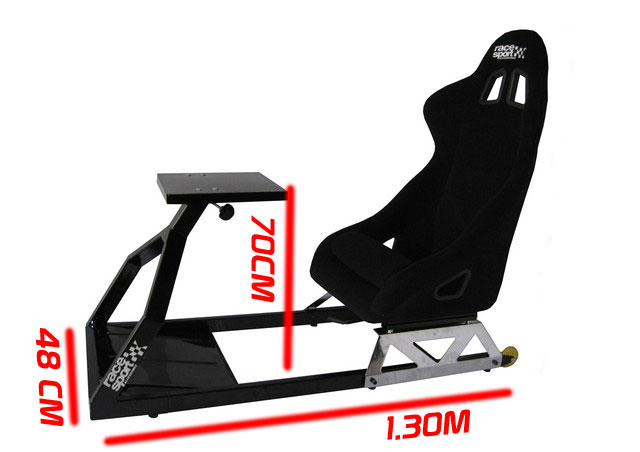

    How to start your own cockpit? Dimensions are often a good question... look.gif
    In this thread we could gather and share any information about cockpit dimensions (and accordingly driver size)
    please no small talk, only schematics! ;)
    _____________________________________________________________
    driver 1m84 :
    with a pdf guide describing all the parts http://www.sim-seats.com/uploads/SR-X2014.pdf

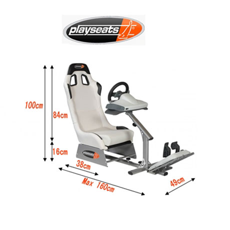

    Simulator_Racing_seat_Play_Seat_Evolution_Black_1634_2.jpg _____________________________________________________________

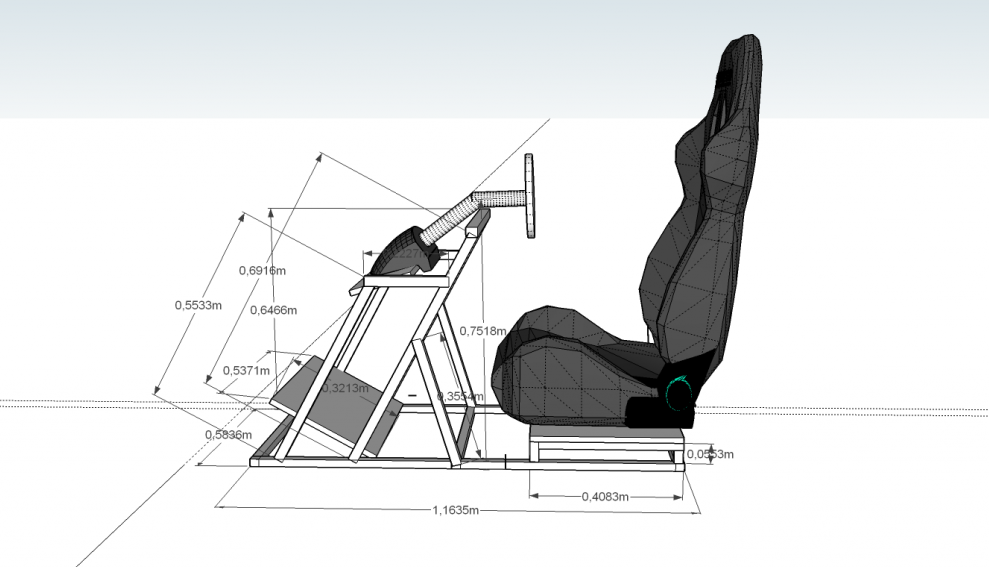

    These are my setup dimensions:

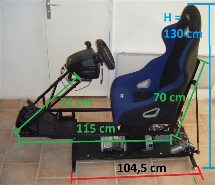

  14. willy pichon
    willy pichon New Member
    Apr 2, 2018
    france
    140Coins
    2DOF, SCN5

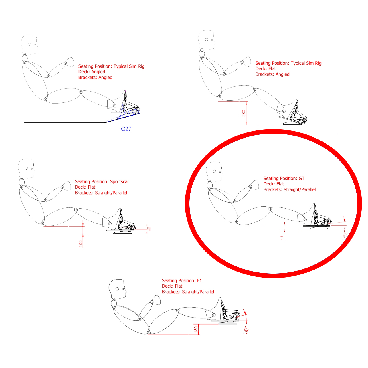

    its interesting to stay on 90 - 120 angle, and put pedals on the same angle ! more confortable, and should be great for general use. F1 position, tis cool, for the first 30 min. of play, but after this, your body its fallen down.. seriouslly. ( my experience)

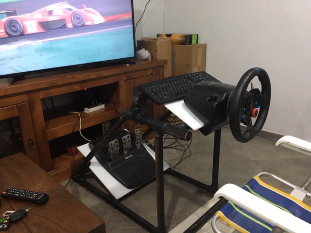

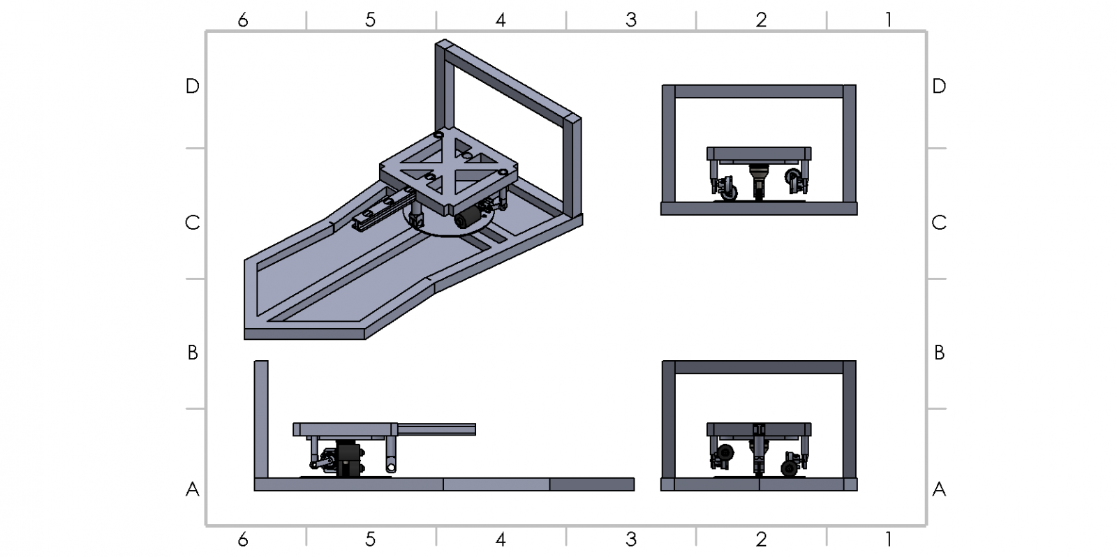

    Cockpit - Low cost steering wheel and pedals support.
    Built with Ø32mm PVC pipes and connections *, this structure is inexpensive and satisfactory for use with steering wheels and pedals. In the annex are more detailed information in case you want to copy them.
    * No need to paste.
    Good luck.
    Cockpit - Suporte de volante e pedais de baixo custo.
    Construido com tubos e conexões em PVC colado* de Ø32mm, esta estrutura é barata e satisfatória para uso com volantes e pedais. No anexo estão as informações mais detalhadas caso queiram copiá-las.
    *Não necessita colar.
    Boa sorte.
    70071 70072 70073
