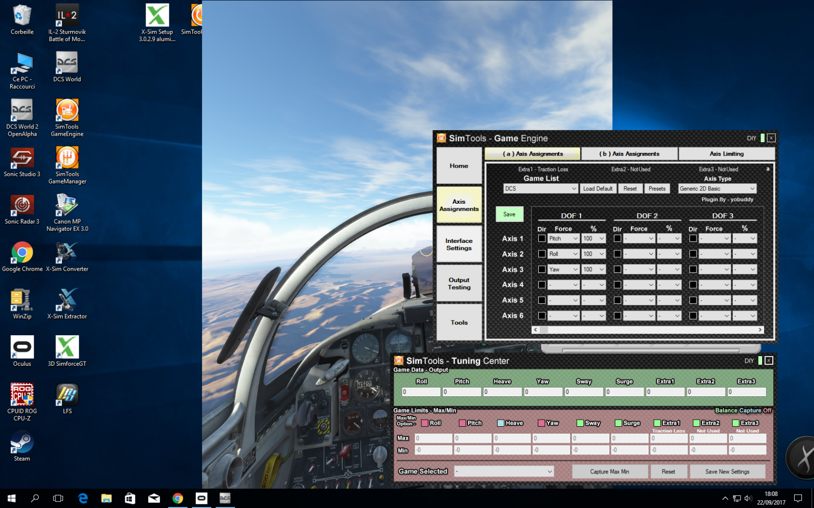

    Hello ,
    i did just buy the DIY version of simtools .
    recieve last month thanos acm 1280 6 dof board
    project will be a 6 DOF MP with 6 powerfull DC geared motors
    what i did so far :
    -game manager : plugin installed (folder check for good instal )+ game patched in in saved game\dcs or dcs open alpha : checked .lua created
    -game engine : -green flag and blue flag when game running
    -axis configured as thanos advised
    -game interface as thanos advised
    -firewall port checked udp 41230
    when game launched : no telemetry in virtual axis or tunning center
    thanos board connected and saying morors waiting for data ..
    i did also try the "no simulator method "as advised with jkr and axis assignement "to check output data without motion platform but no joy too ..
    hope there is a solution . i can't post picture for the moment as this is my second post .as soon as i will be able i will post them .
    what am i missing with these clues , any ideas ?

    21,597
    151,245Coins
    Plugins are tested against the stated version and can be broken by updates.
    In addition it helps if you post pictures of all of your settings.
    Please do not duel post on the same issue, it just gets too confusing.

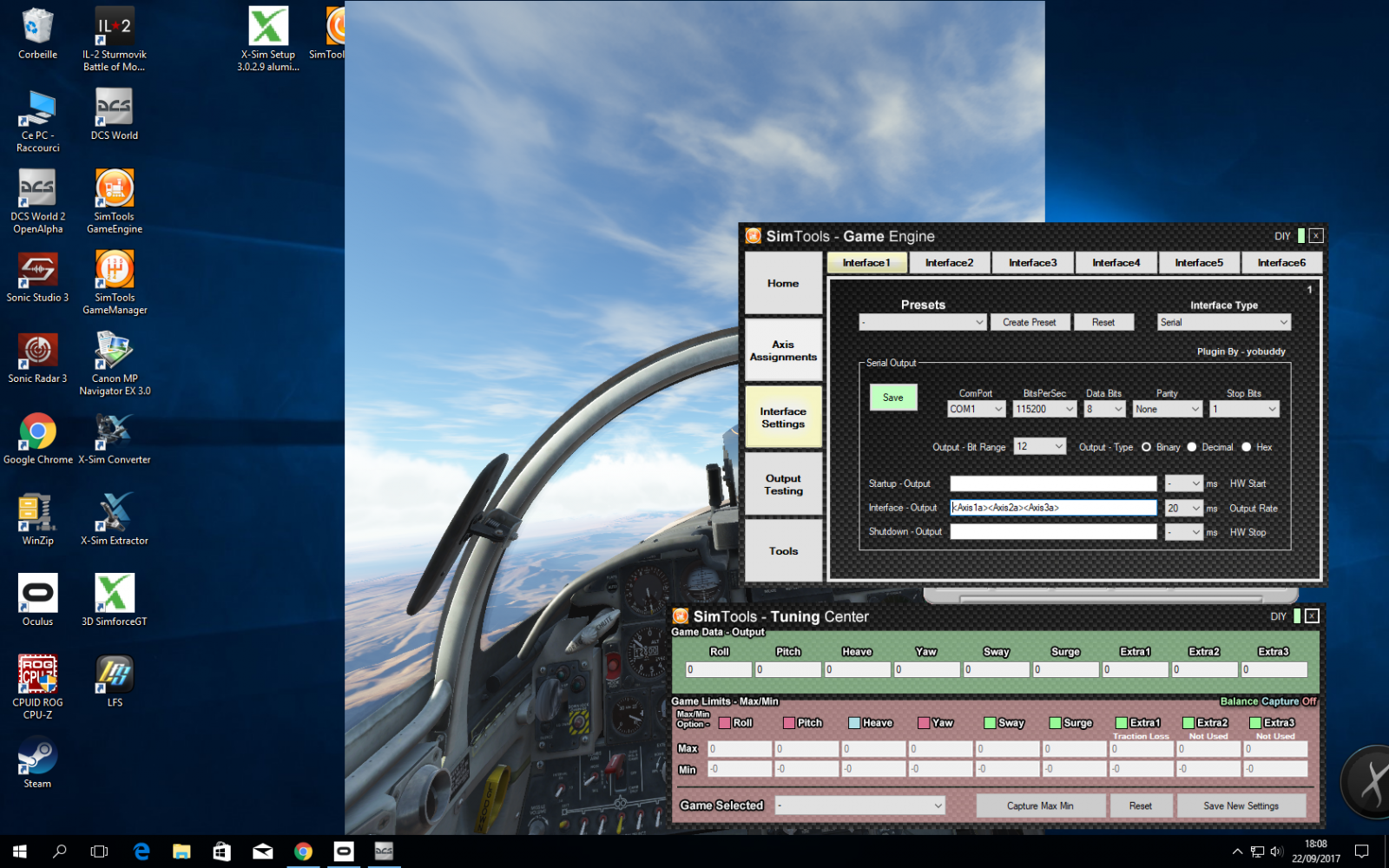

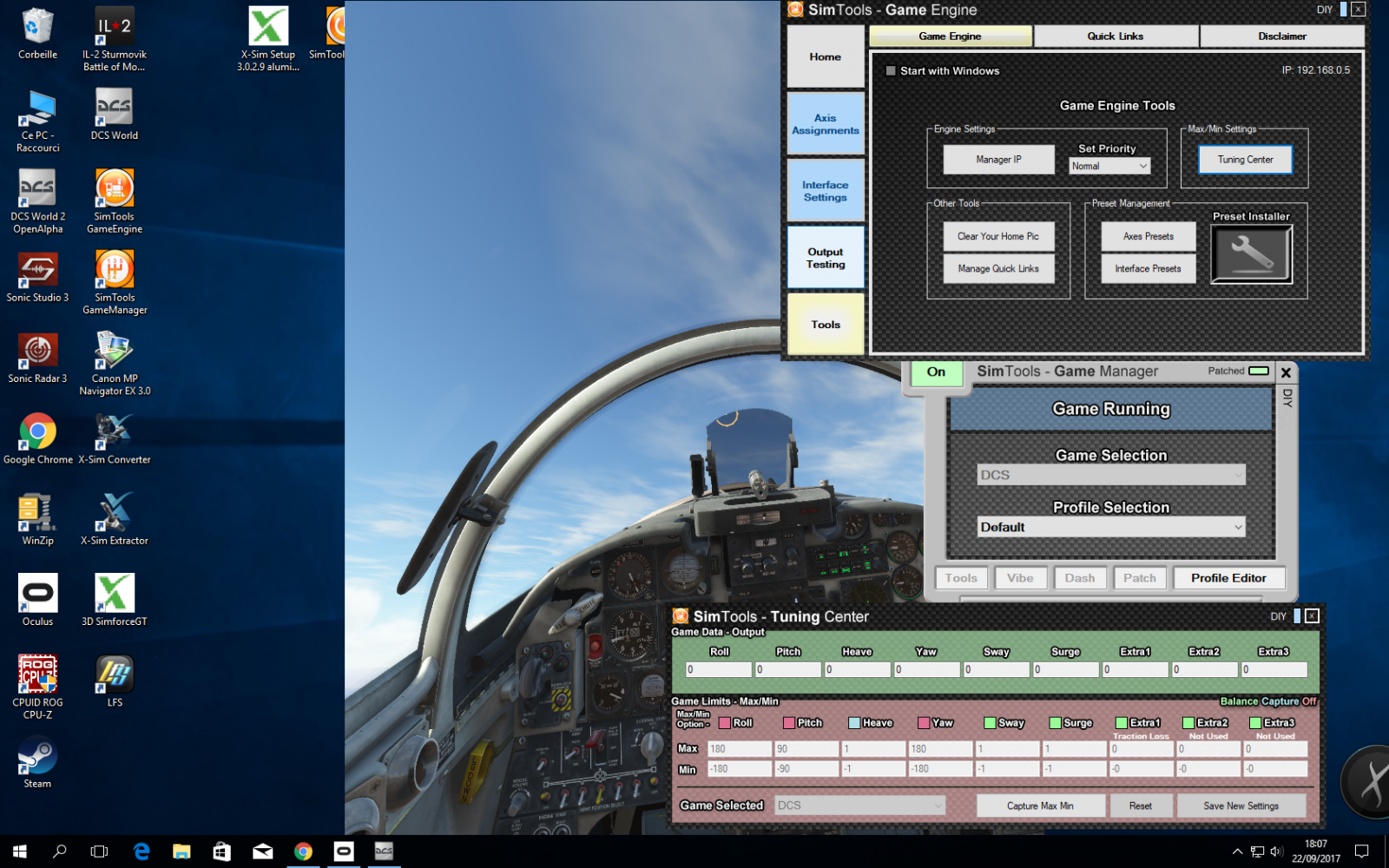

    OKI solved !!
    It was the Windows decimal separator problem as my pc is in french had to dig a little bit !!
    What a ... Dcs uses this decimal and not the other games.
