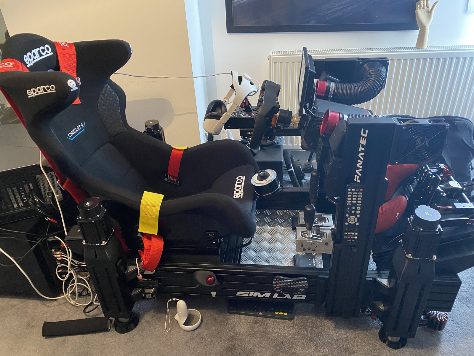

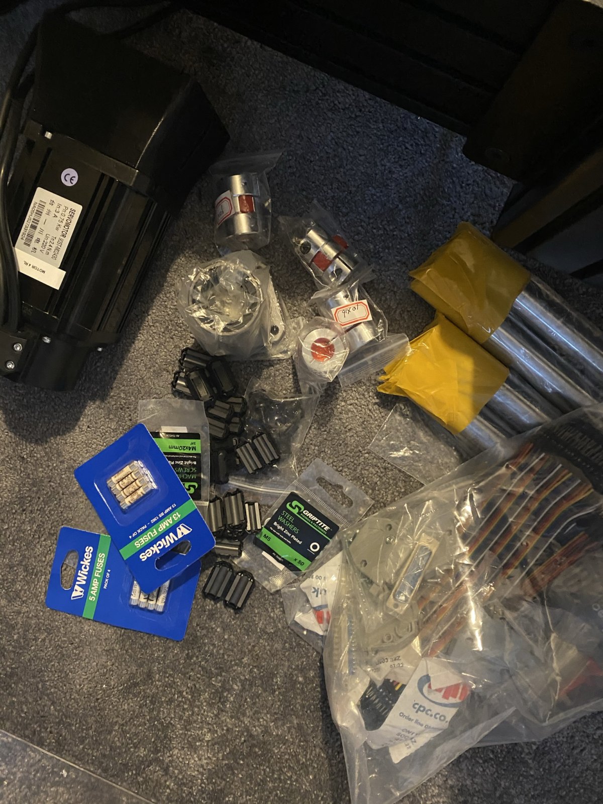

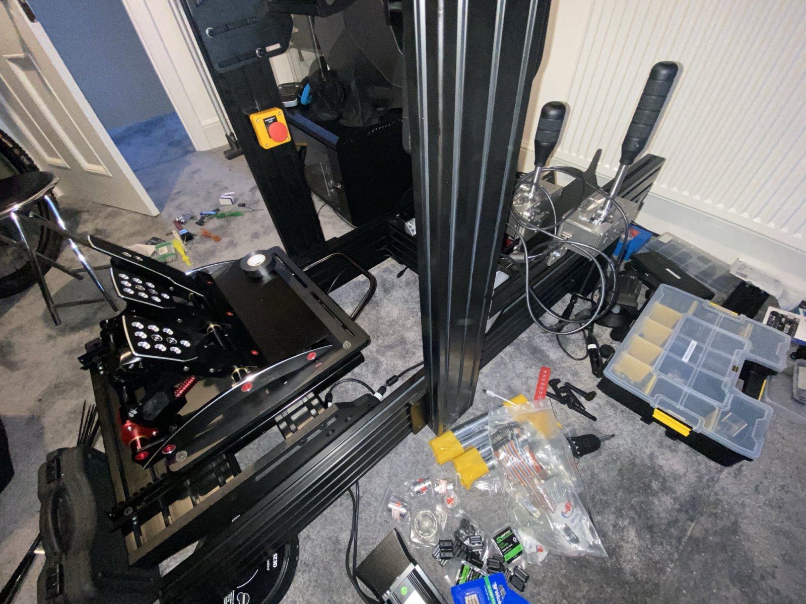

    Wow, what a journey! Thoroughly enjoying the build process which I've been doing over the past 3 weeks after a frenzy of shopping, discovering having to pay import duty from the EU (I'm in the UK) and the fact that goods are cheaper and arrive faster when shipped from China! (No wonder why everyone's concerned they will be (are?) the next superpower).
    Here are some pics and apologies in advance for the mess.
    Many thanks to @diablo2112 and Bogdan Berg who's comprehensive posts helped to smooth the process especially for someone who has never done anything like this before. The cost savings were just too tempting!!

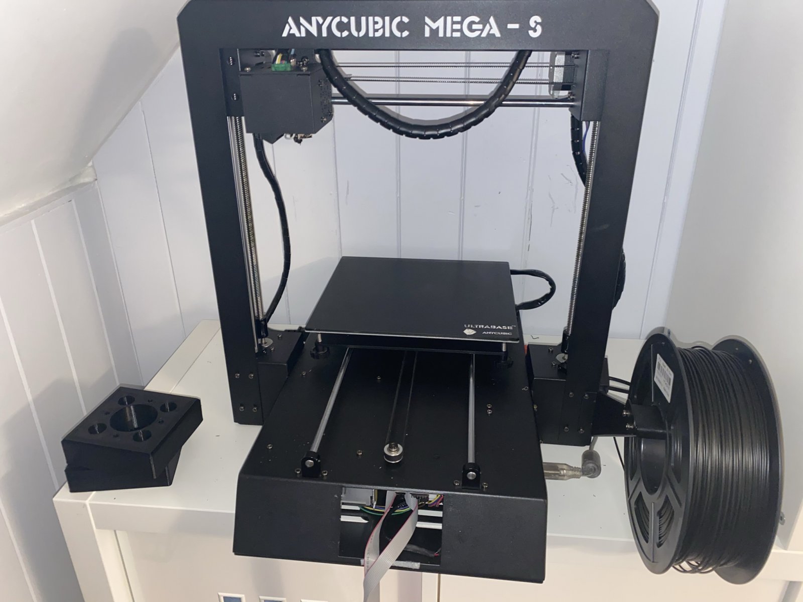

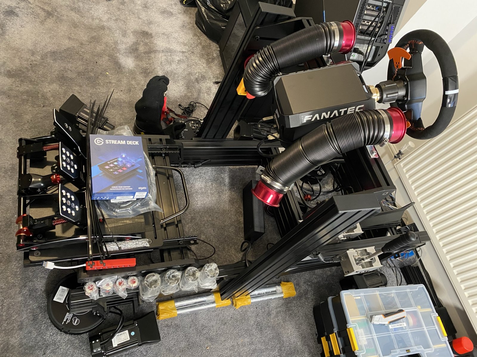

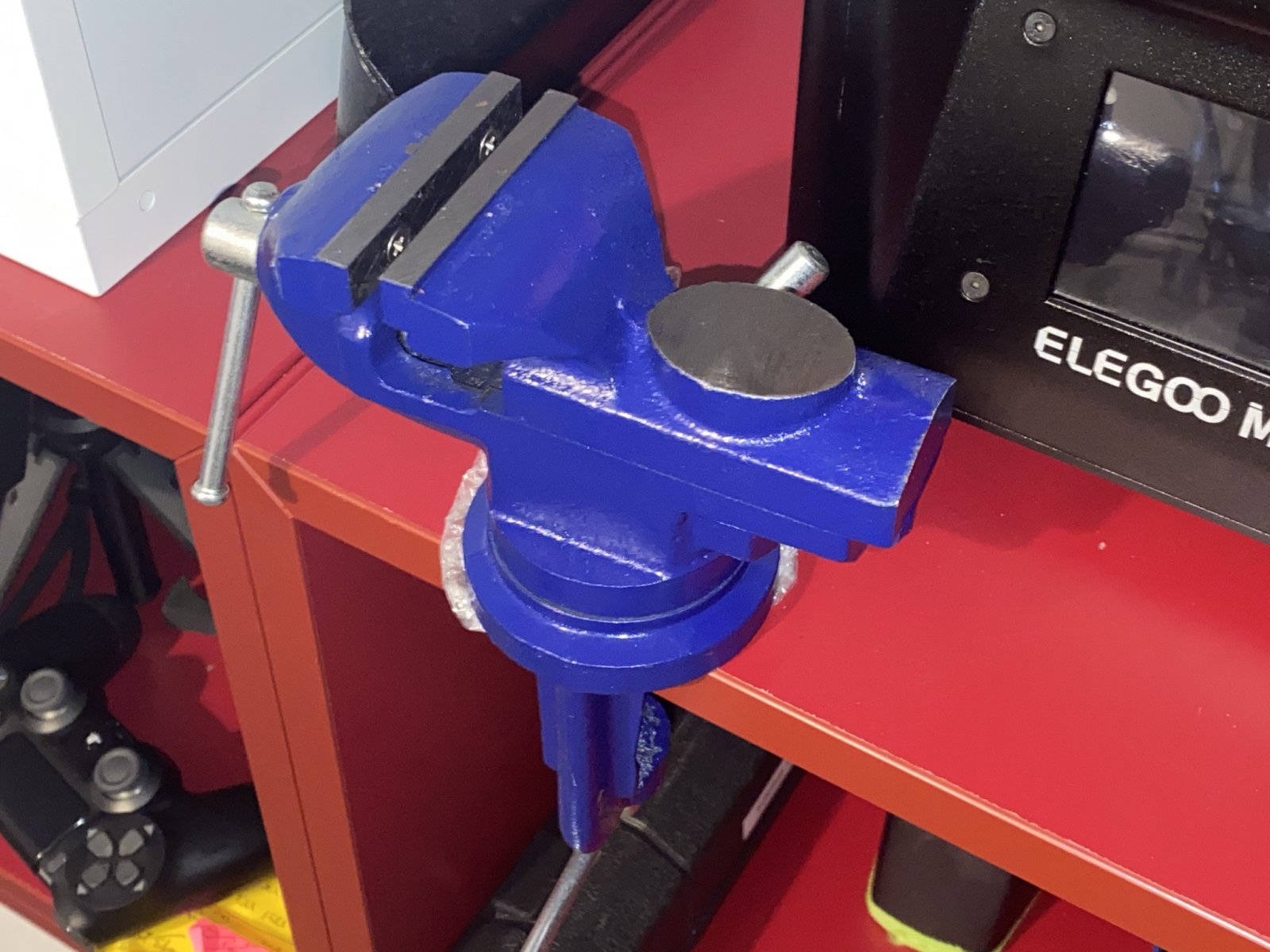

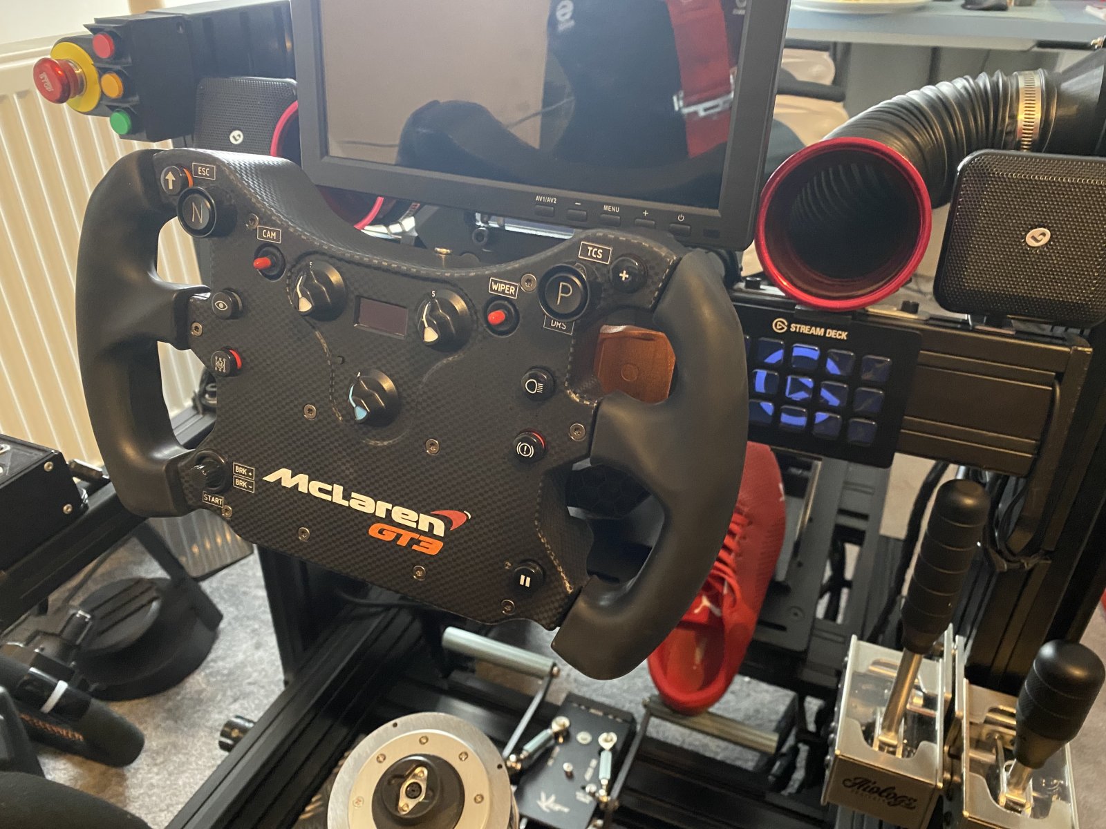

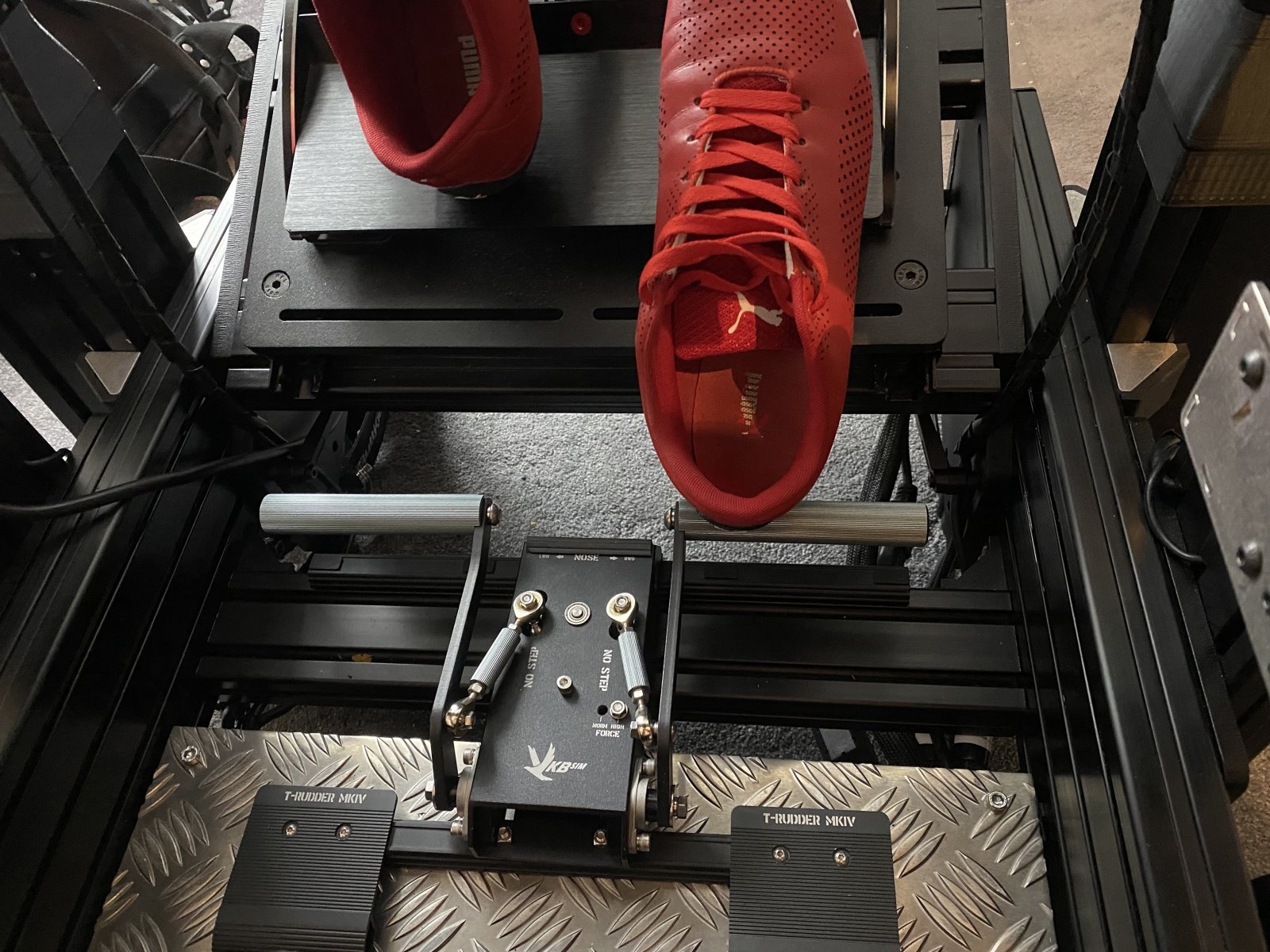

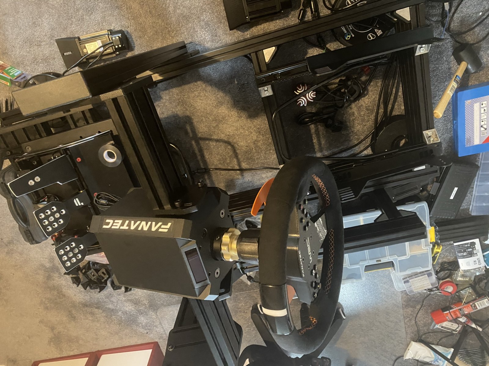

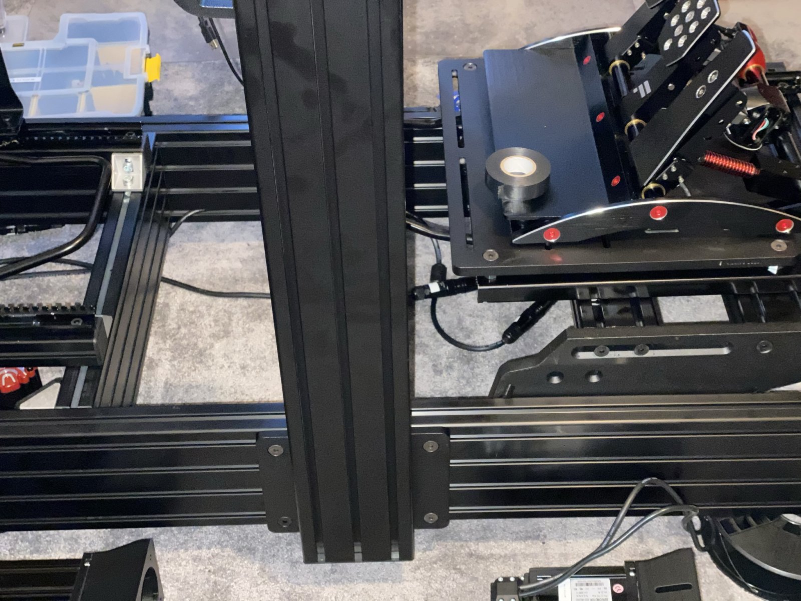

    I haven't decieded how to mount the flight sim stuff yet and..
    If you don't have a mini clamp - GET ONE. You will definitely need it.

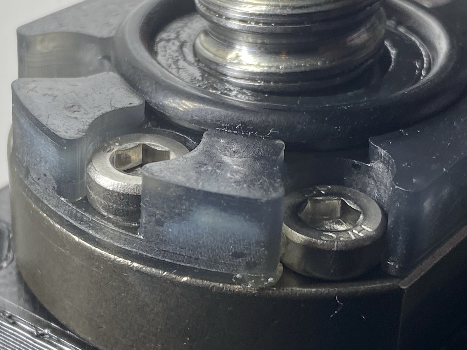

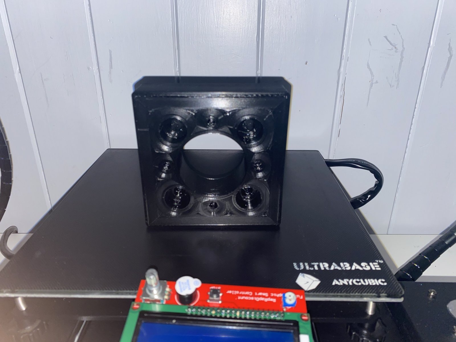

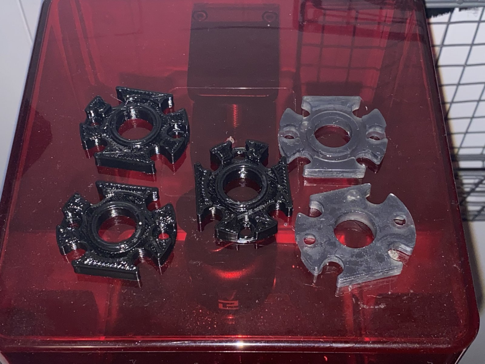

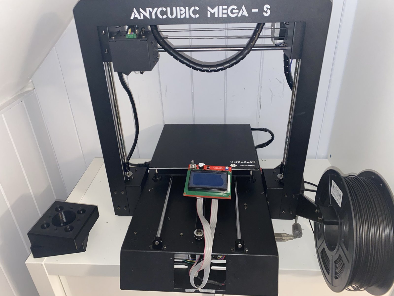

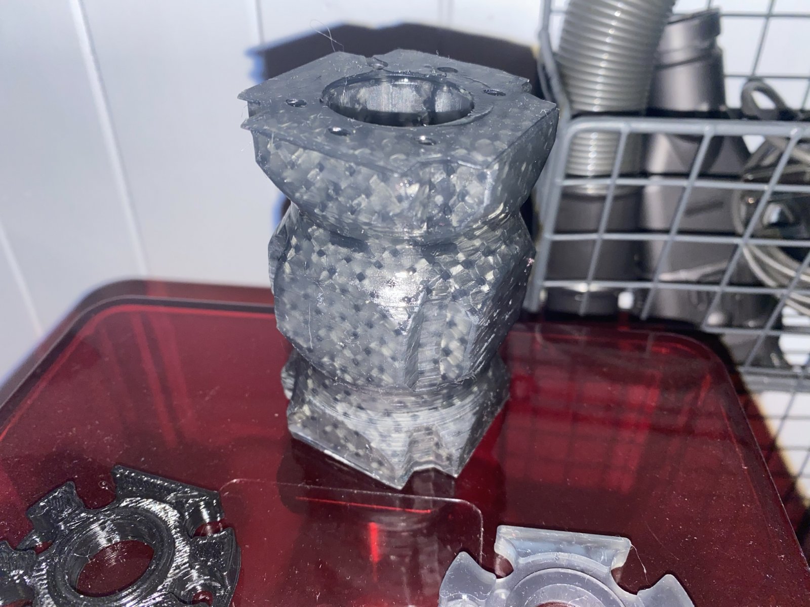

    I have a resin (Elagoo Mars) and filament printer (Anycubic Mega-S). The resin printer does amazingly dimensionally accurate prints with very little effort whilst the filament printer needed lots of calibration trial prints etc.
    IMG_9762.JPEG A slider in resin. The lack flex meant it was virtually impossible to get it on without chipping bits off so resin not ideal for these larger pieces.
    The printer has been the biggest headache since my screen froze. Getting a new screen has been a pain with delving into the firmware and Arduino compiling without success. Ultimately, I got the screen to work but the rotor would not turn rendering the thing useless! I've tried 3 screens without much luck! Having to calibrate and print via USB is not fun at all!
    Just to prints left but I don't have an (easily) functional printer!!!

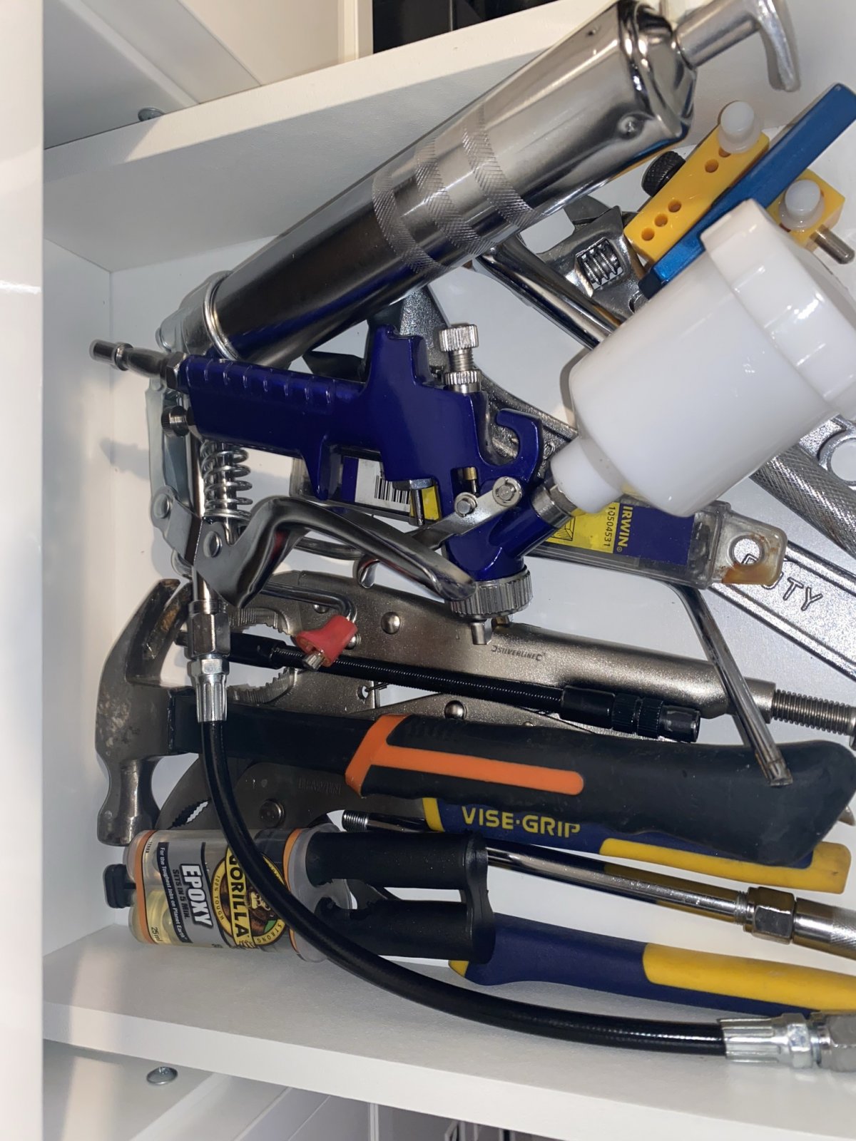

    The grease gun IMGO is not optional.

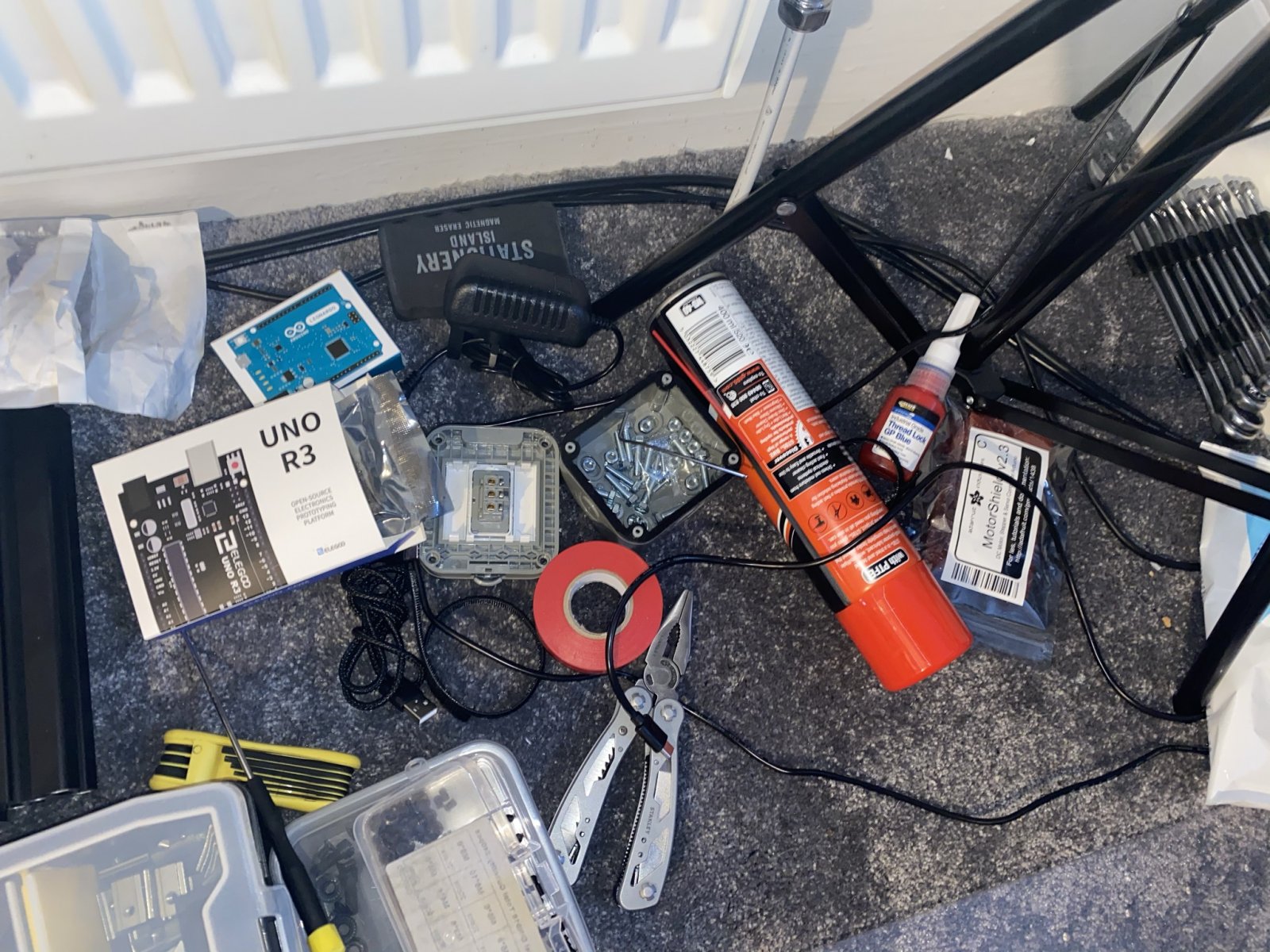

    A new use for used filament spools whilst I figure out cable management.
    81771
    More goodies arriving today - this is better than a kid in a sweet shop and I haven't played a game yet! Can't wait to fire up the Reverb G2.

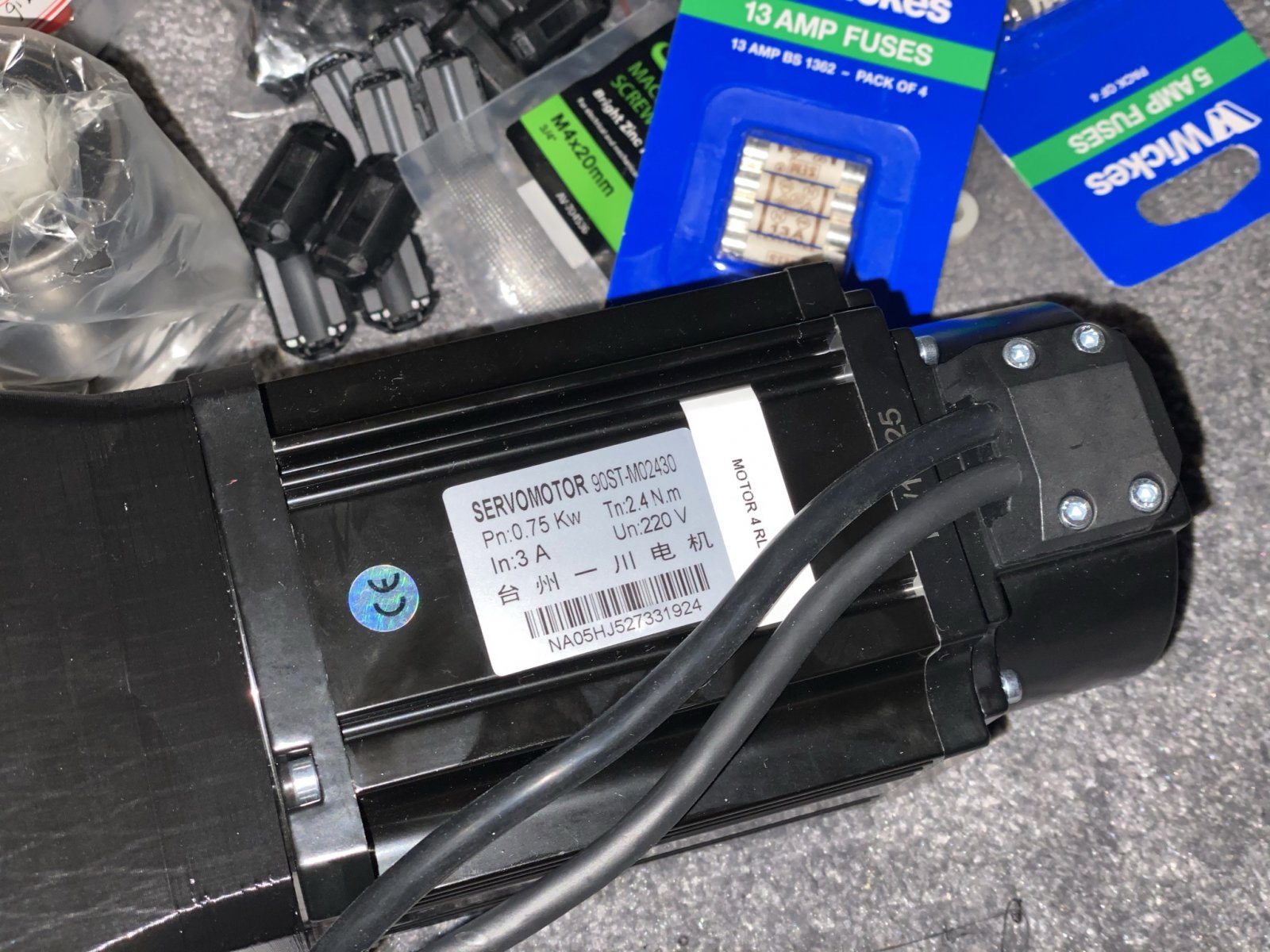

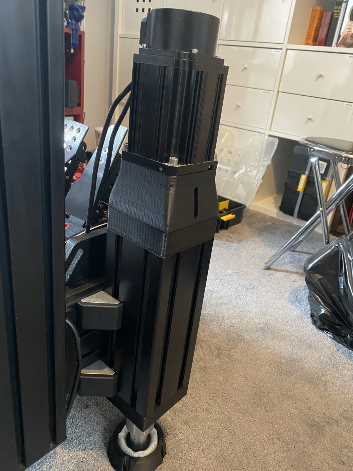

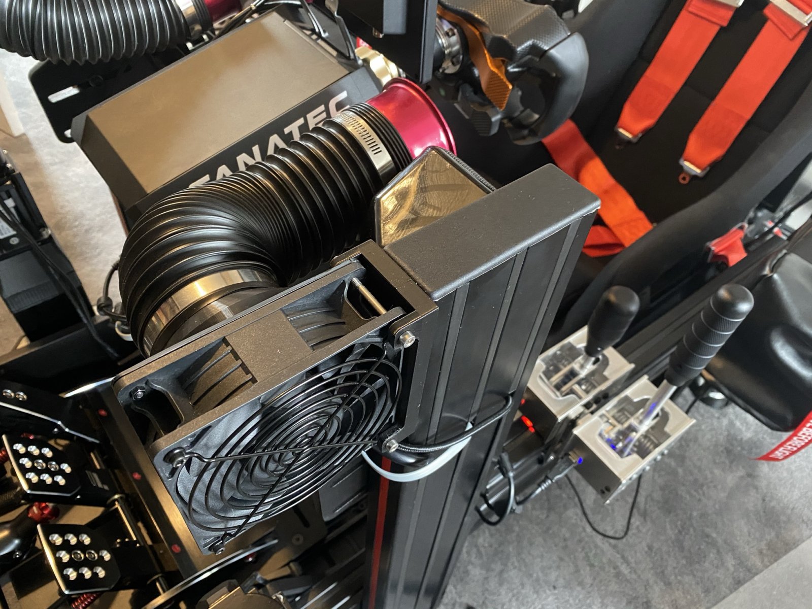

    My servo case with lock and key as well as case fan on the top. Kepp 240v away from prying fingers.

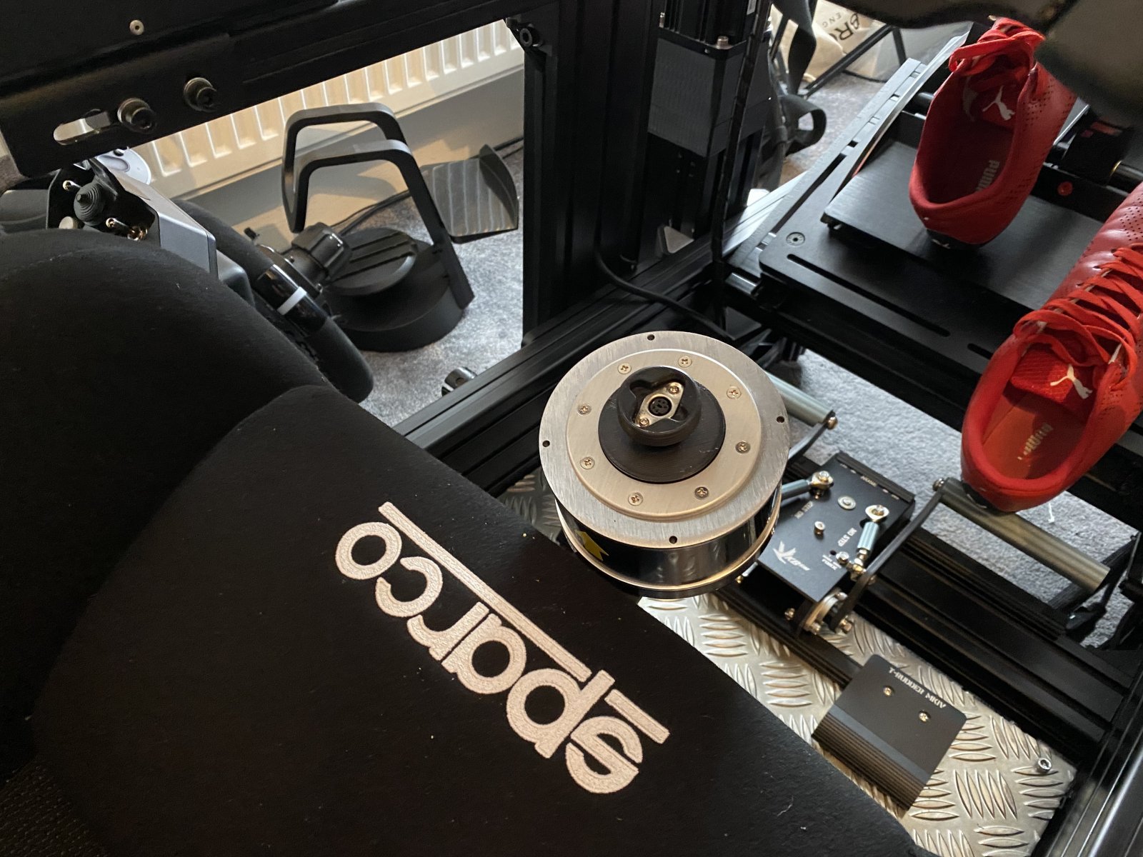

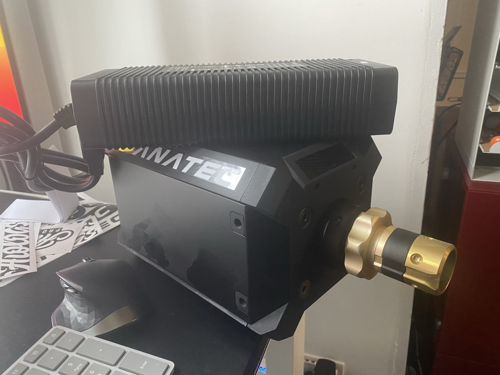

    IMG_9777.JPEG Yes, the wheel didn't spend much time in the box
    Lots of free stickers from the manufacturers
    Some ferrite cores in the mix - not sure if they'll help significantly. Leonardo board for some sim belt action hopefully.

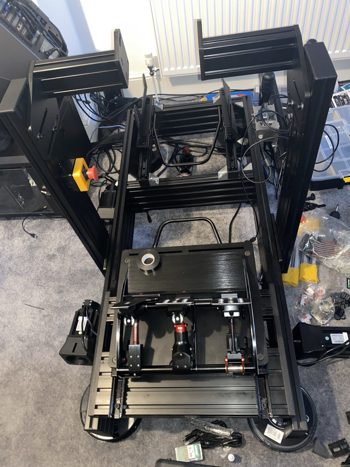

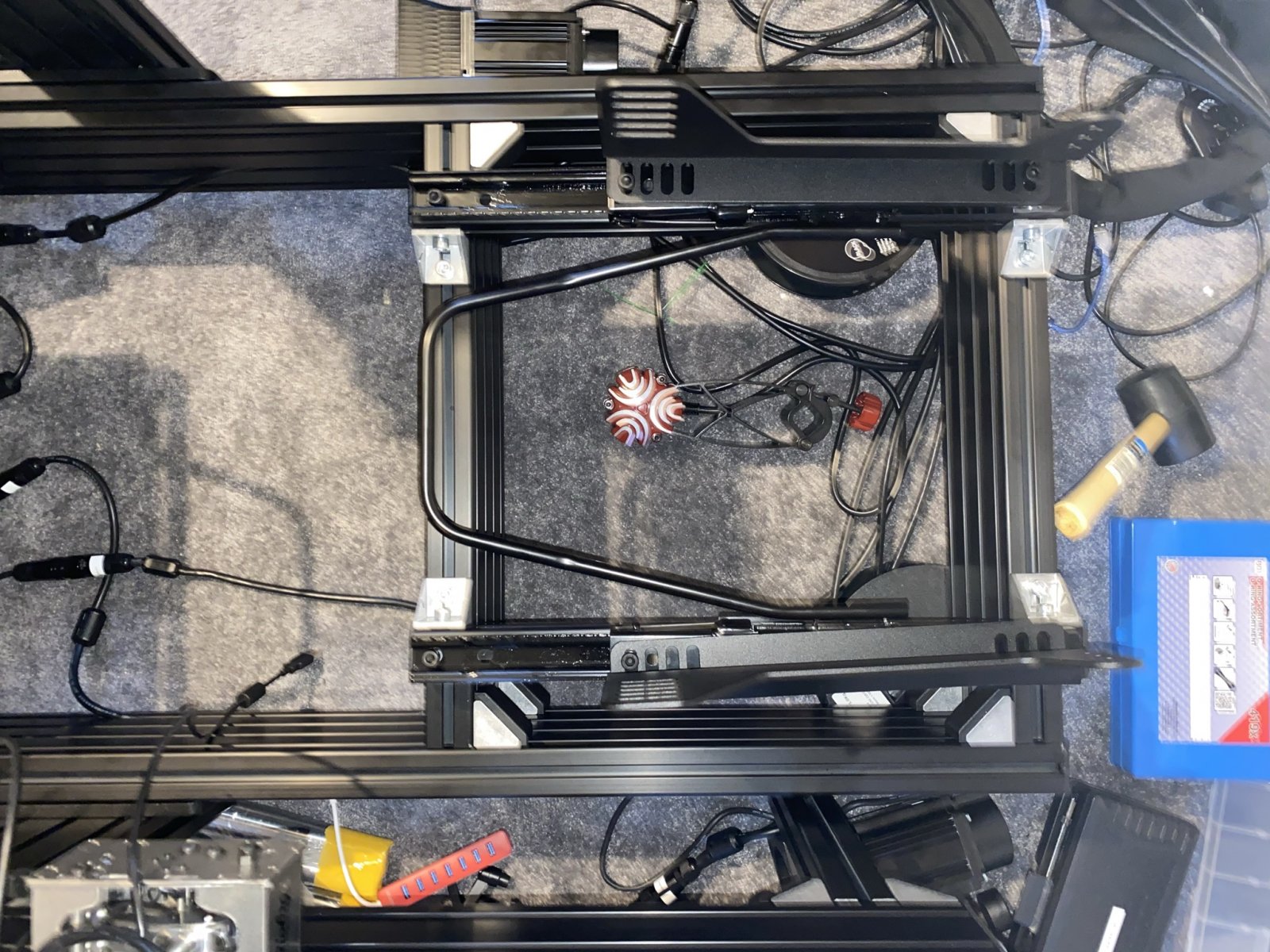

    Sliders mounted. I calibrated but in the end used a mallet to make fit nice'n'tight.
    It's PX-1 frame. Everything I ordered arrived surprisingly quickly, just waiting for the Kinetic profiles which will be here this week after they responded to my email(!)
    Fanatec pedals, Sparco seat coming soon - I have ants in my pants!
    This is gagging for a tinkering.

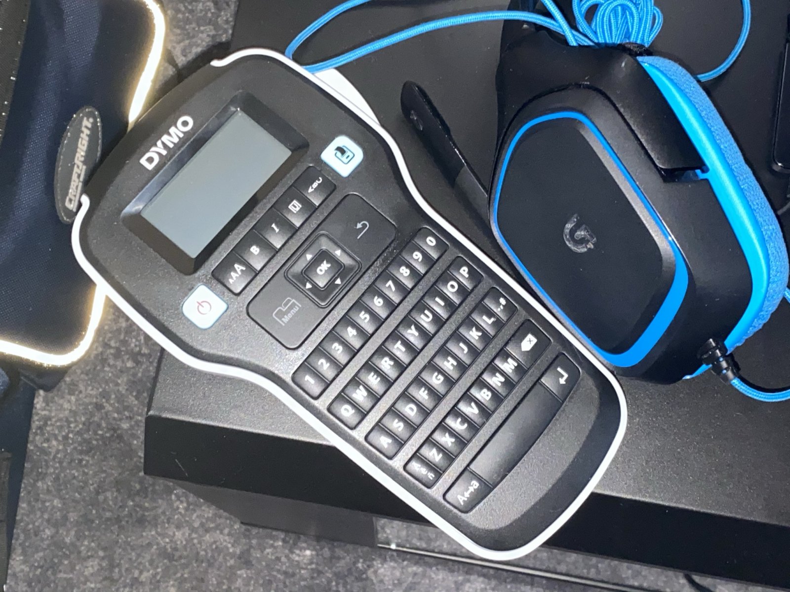

    Motors mounted and labelled. DO NOT HESITATE TO BUY A LABEL PRINTER, really useful around the house too.

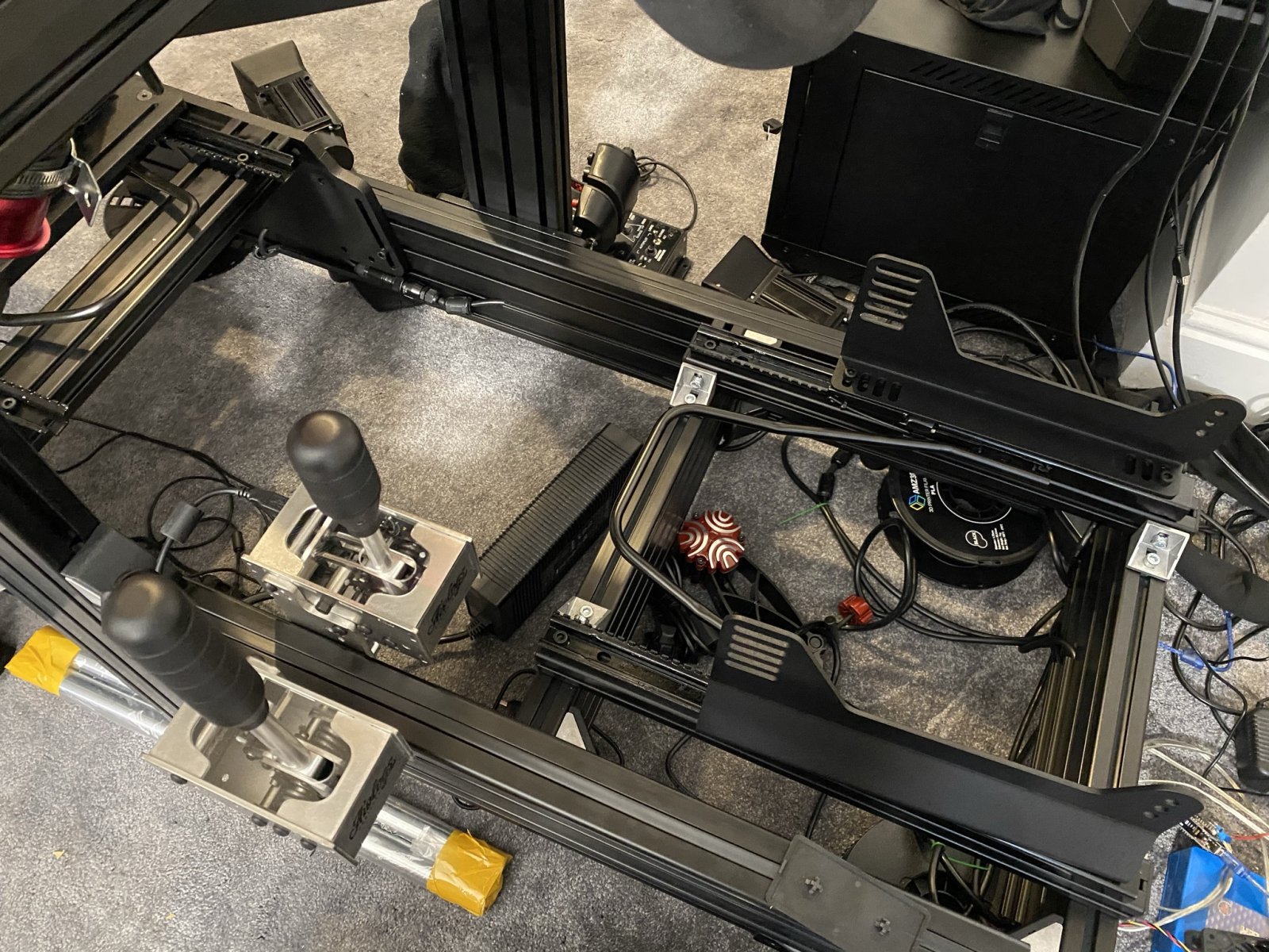

    I went for the Ailogs shifter and handbrake. These have just been delivered and it looks like they've switched from chrome to black metal for the handles.
    How did I live without a label printer in my life before...

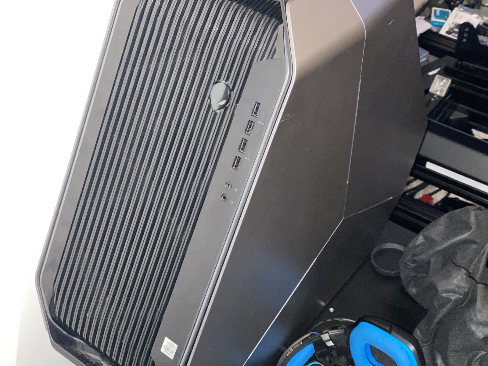

    Thr rig is running on the Alienware Area 51 R5 which I've just upgraded to an MSI gaming board and intel i910850k series.
    Needs a clean and bolts tightened once I've dialled in the position. Note the seat slider too for my son and daughters to adjust to suite.

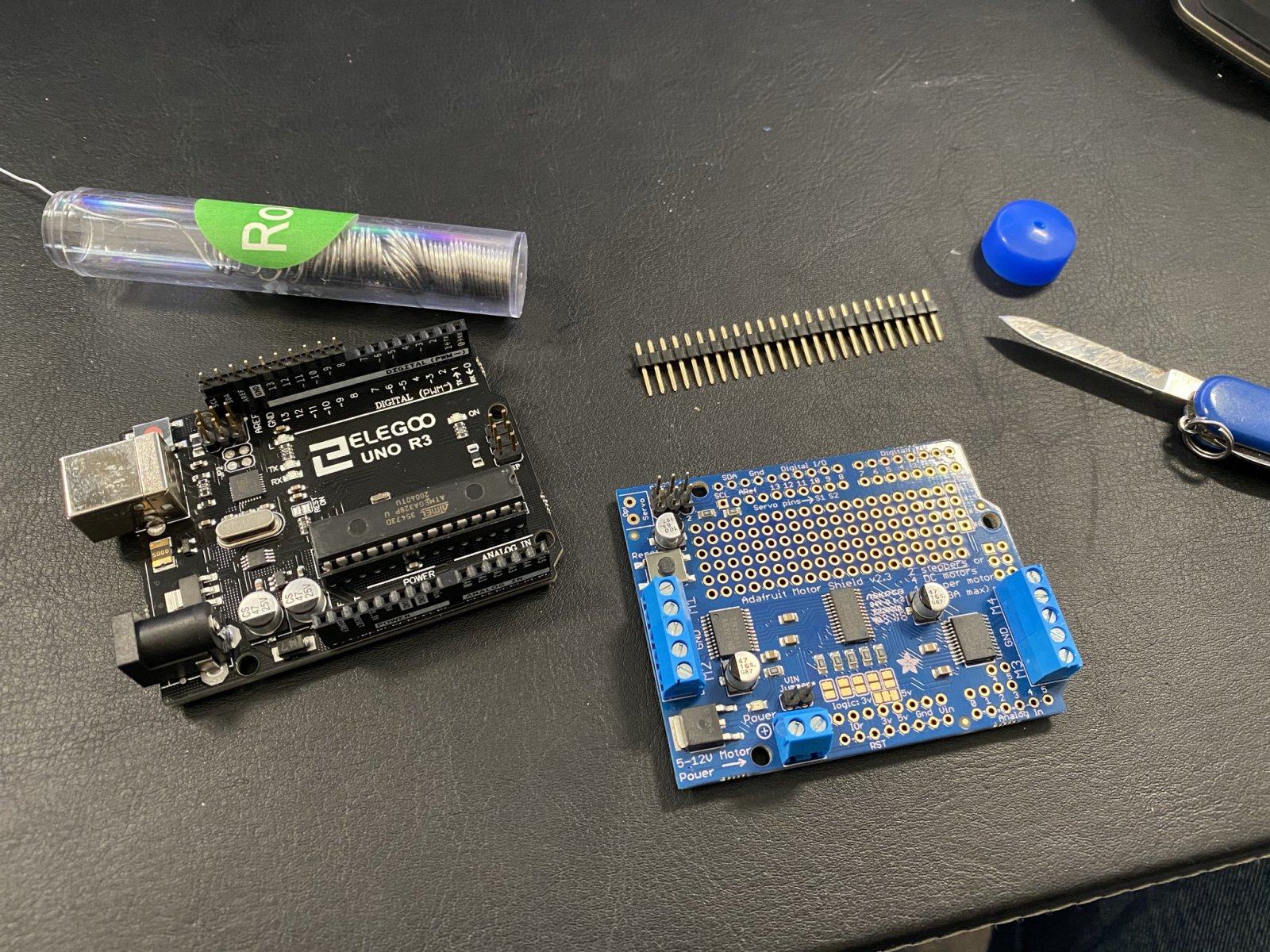

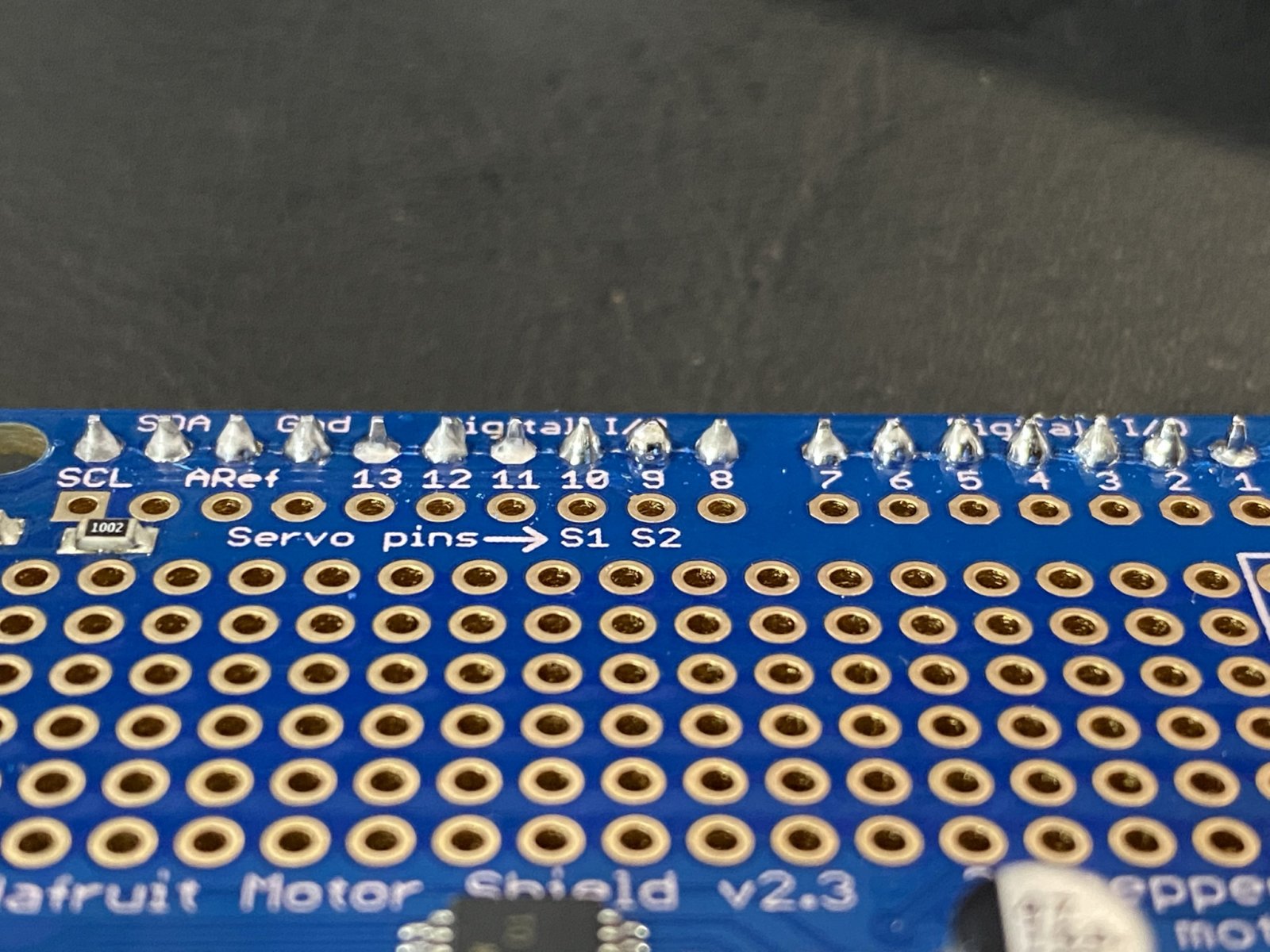

    IMG_9790.JPEG My motorshield didn't come preinstalled with pins so out came the dusty soldering iron.
    Really pleased with the result considering the last time I soldered anything was in CDT technology in 1989!

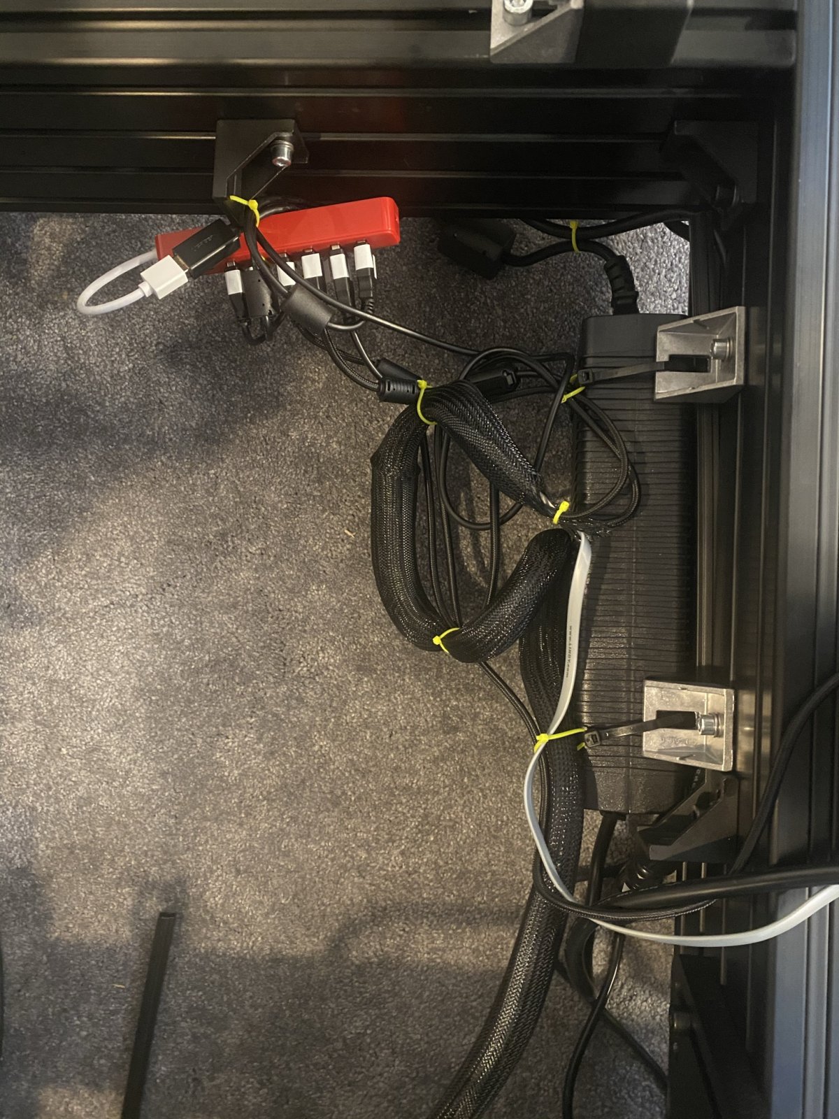

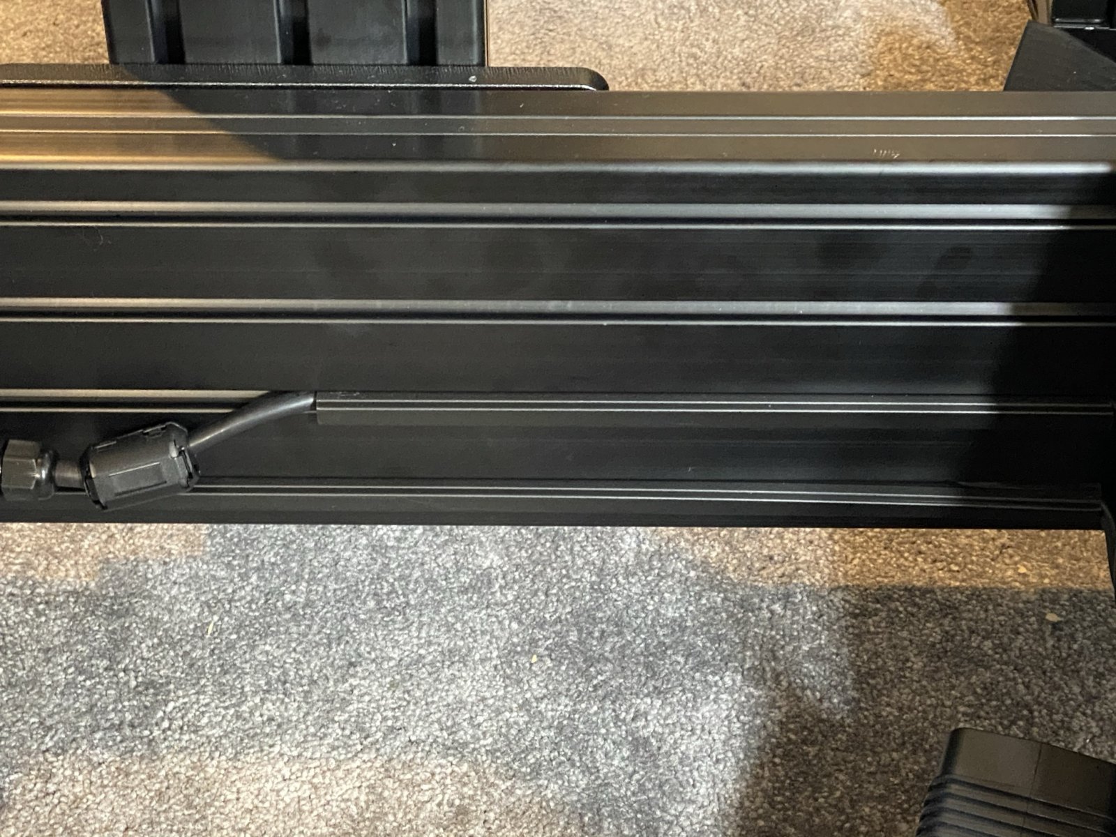

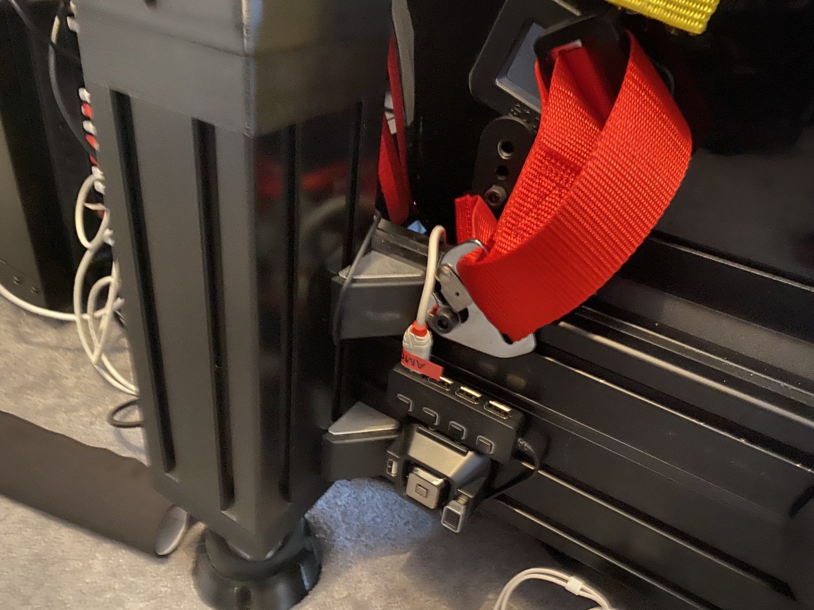

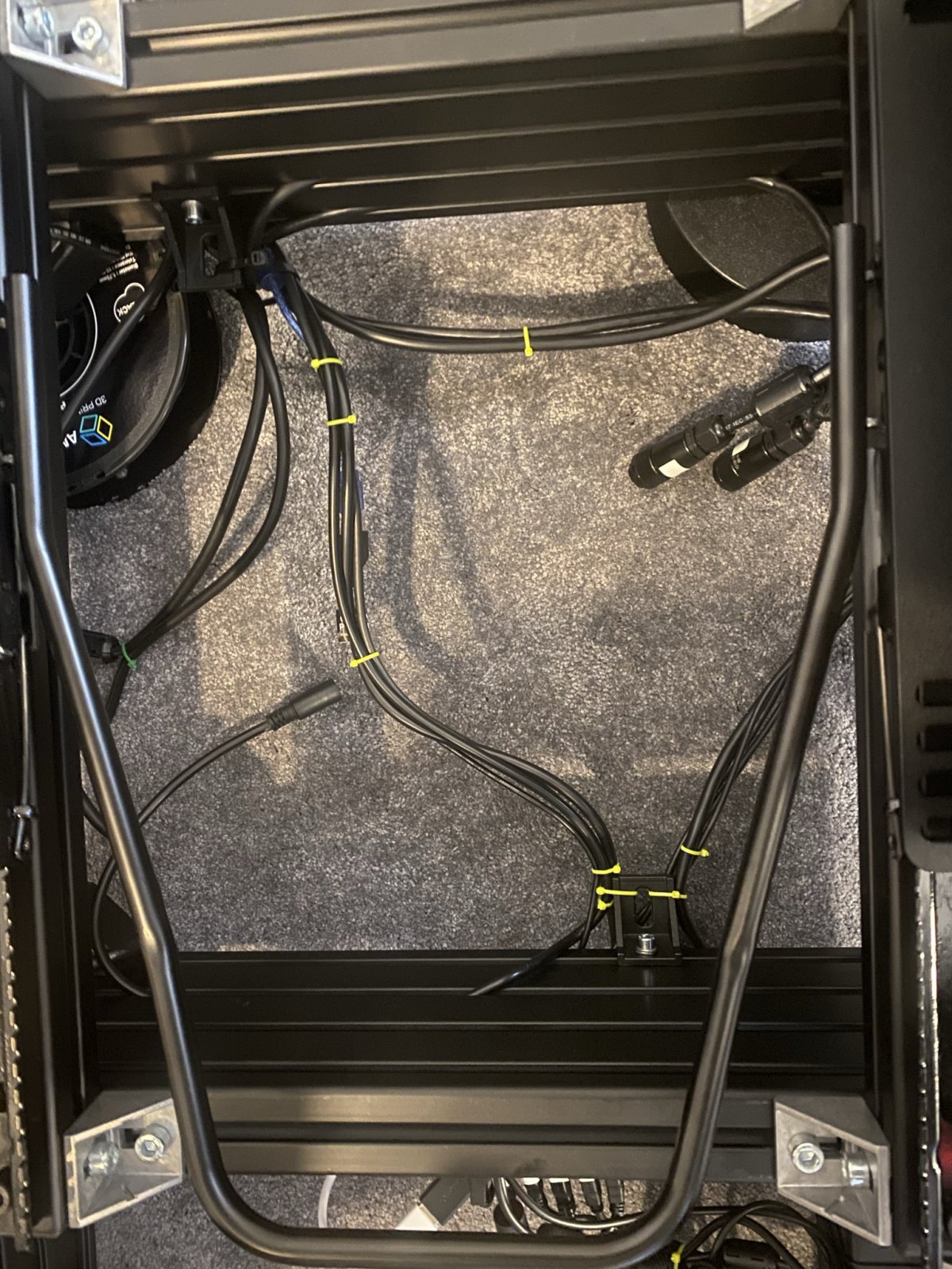

    Here I've used standard T-slot PVC profiles for cable management (really cheap 10 pack of 2m for £15), the protrude for the the thicker cables but can be inserted flush fr thinner cables.
    Starting to take shape - at least the mess has gone!
    More cable management needed.

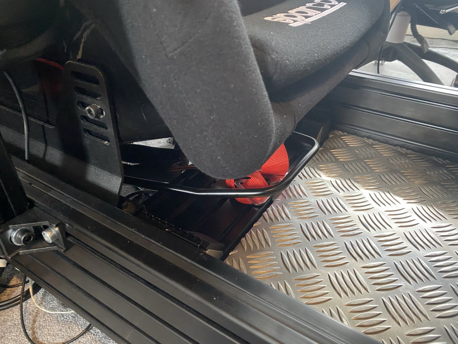

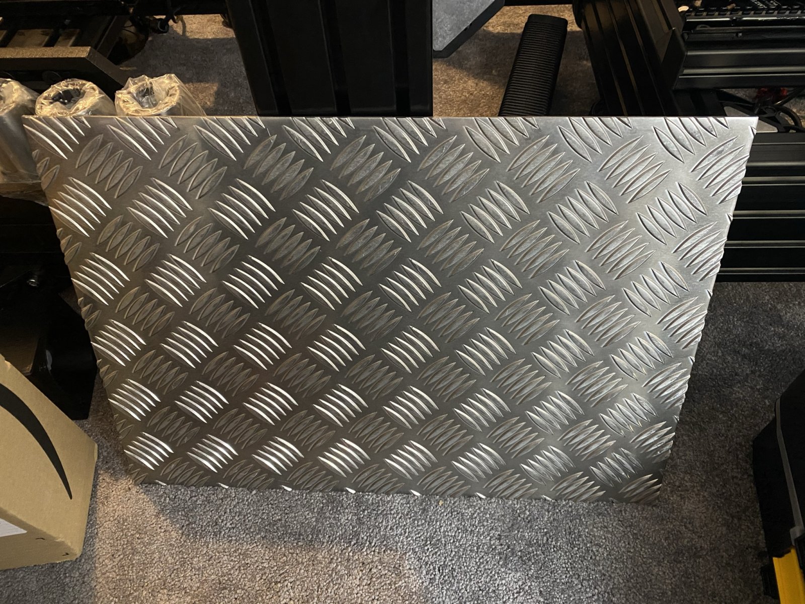

    Ordered this diamond aluminium floor plate to the same dimensions as Sim-Labs at half the price - this will help to hide some of the spaghetti as well.

    What is the arduino for? Air flow fan control maybe?
  7. darkknight
    darkknight New Member
    Feb 1, 2021
    29
    63Coins
    +19 / 0 / -0
    That’s correct. I’m also planning a seat belt tensioner addition but difficult to choose which option at the moment.

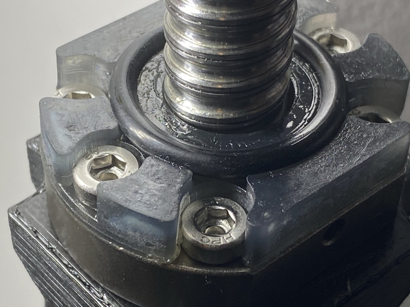

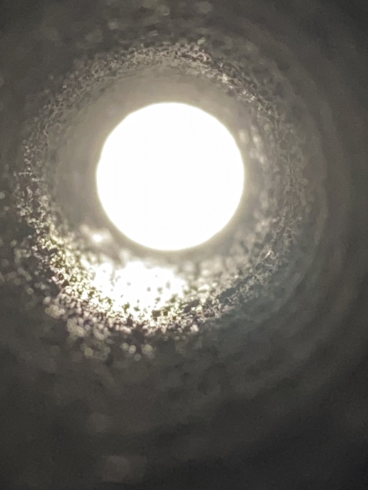

    A close up look at why its important to clean the aluminium shafts:
    Before :
    0274DFF0-AD21-4556-869F-547E1410FFAF.jpeg EBA14064-C8DF-41B2-A8C0-34B3473C4719.jpeg
    And after a good clean:

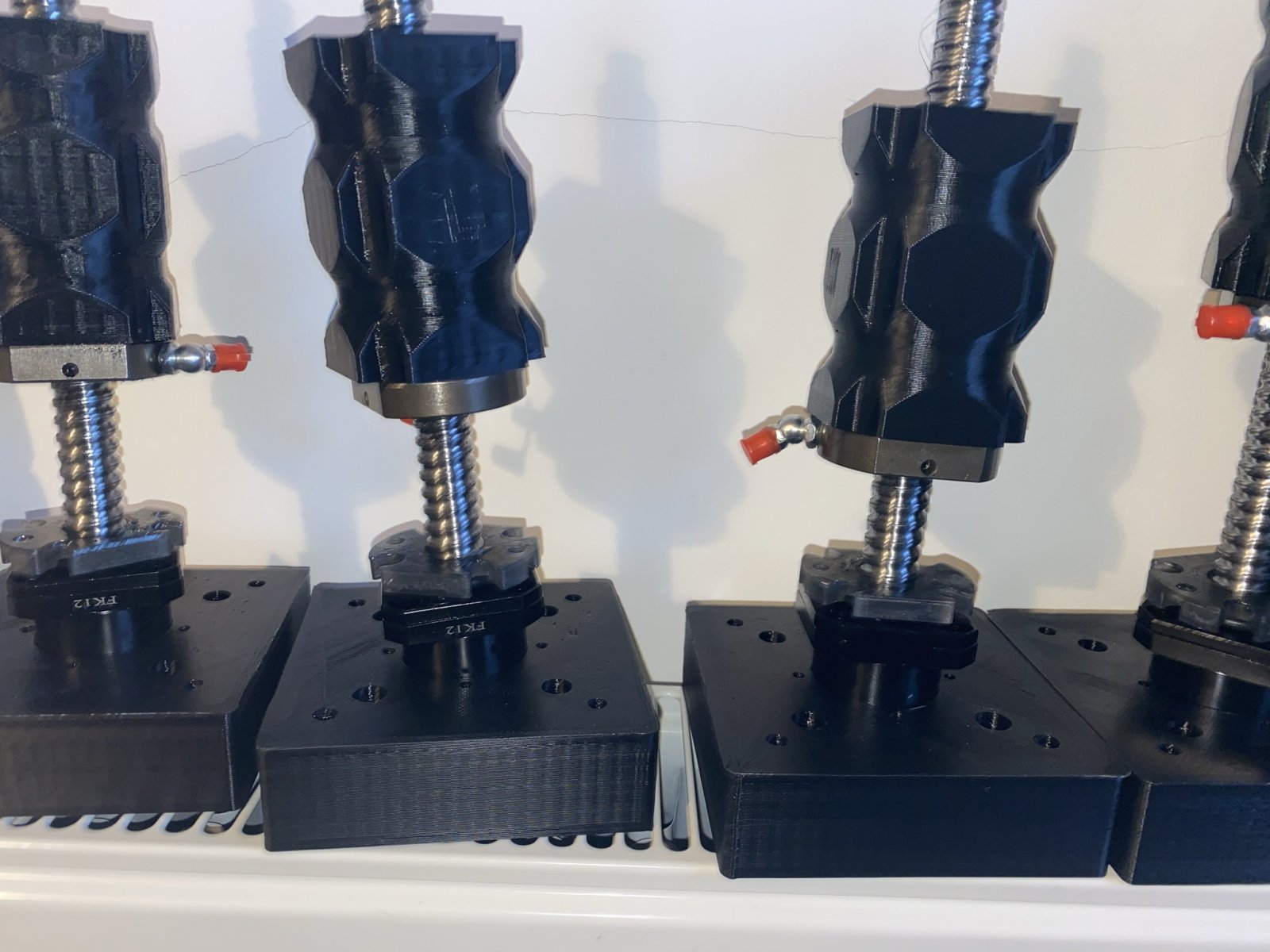

    Props to @saxxon66 for the original designs. In terms of accuracy, I don't think FDA printers can match resin:

    Some cable management has started. I was going to print some 2020 cable holders but have loads of brackets left over these work really well too:

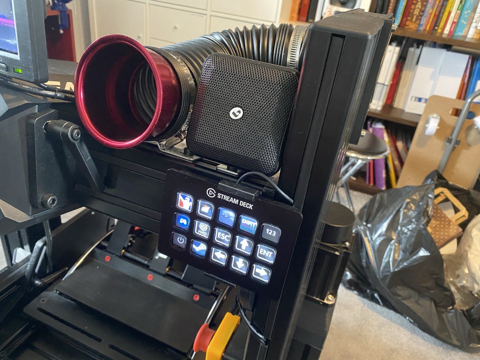

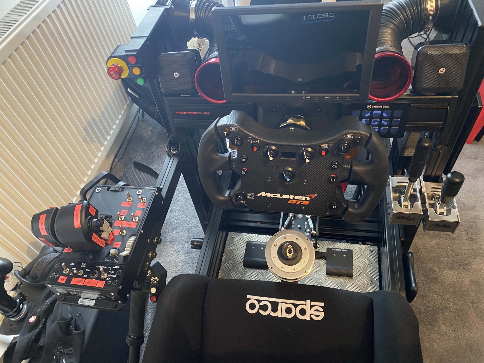

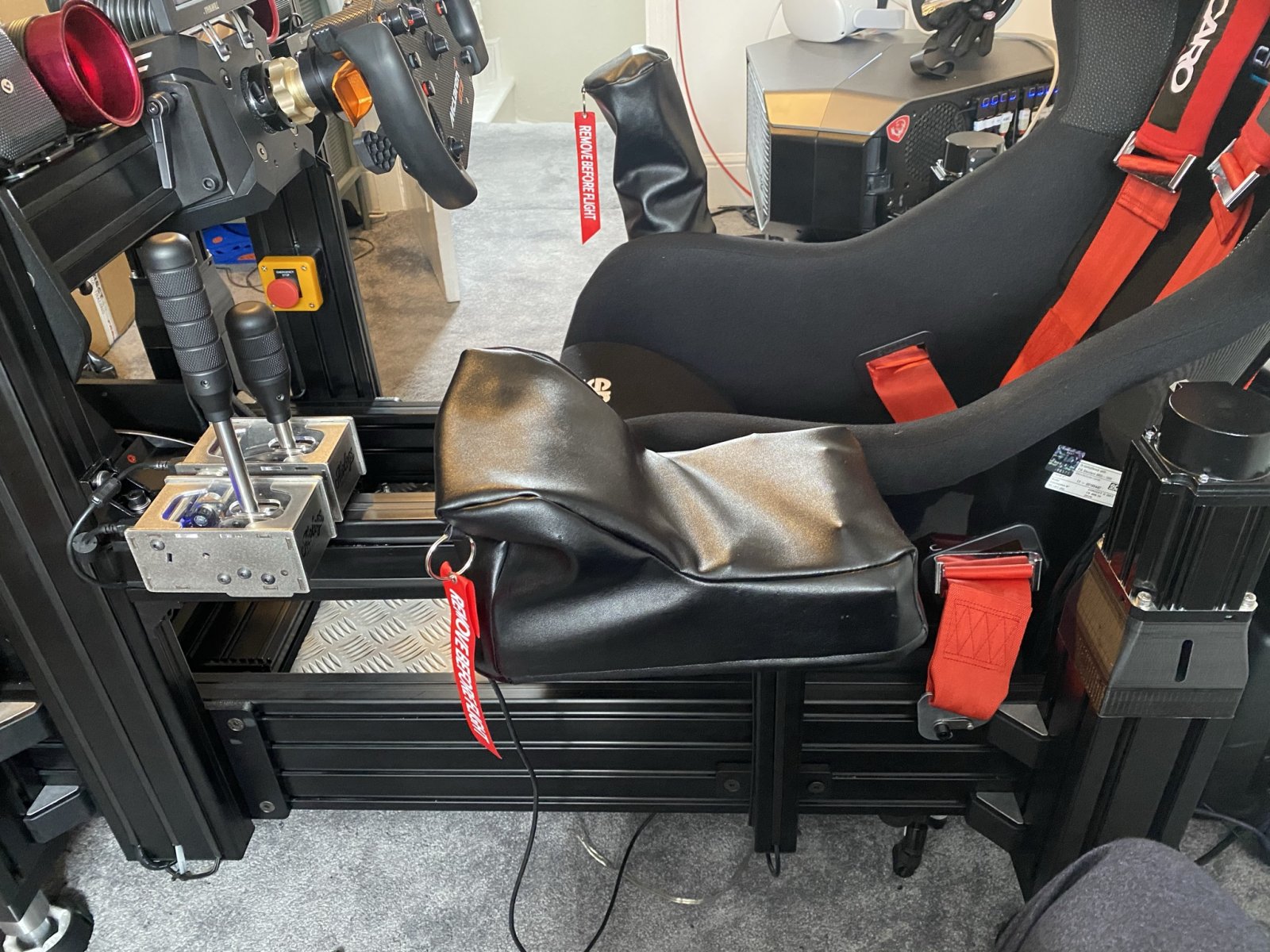

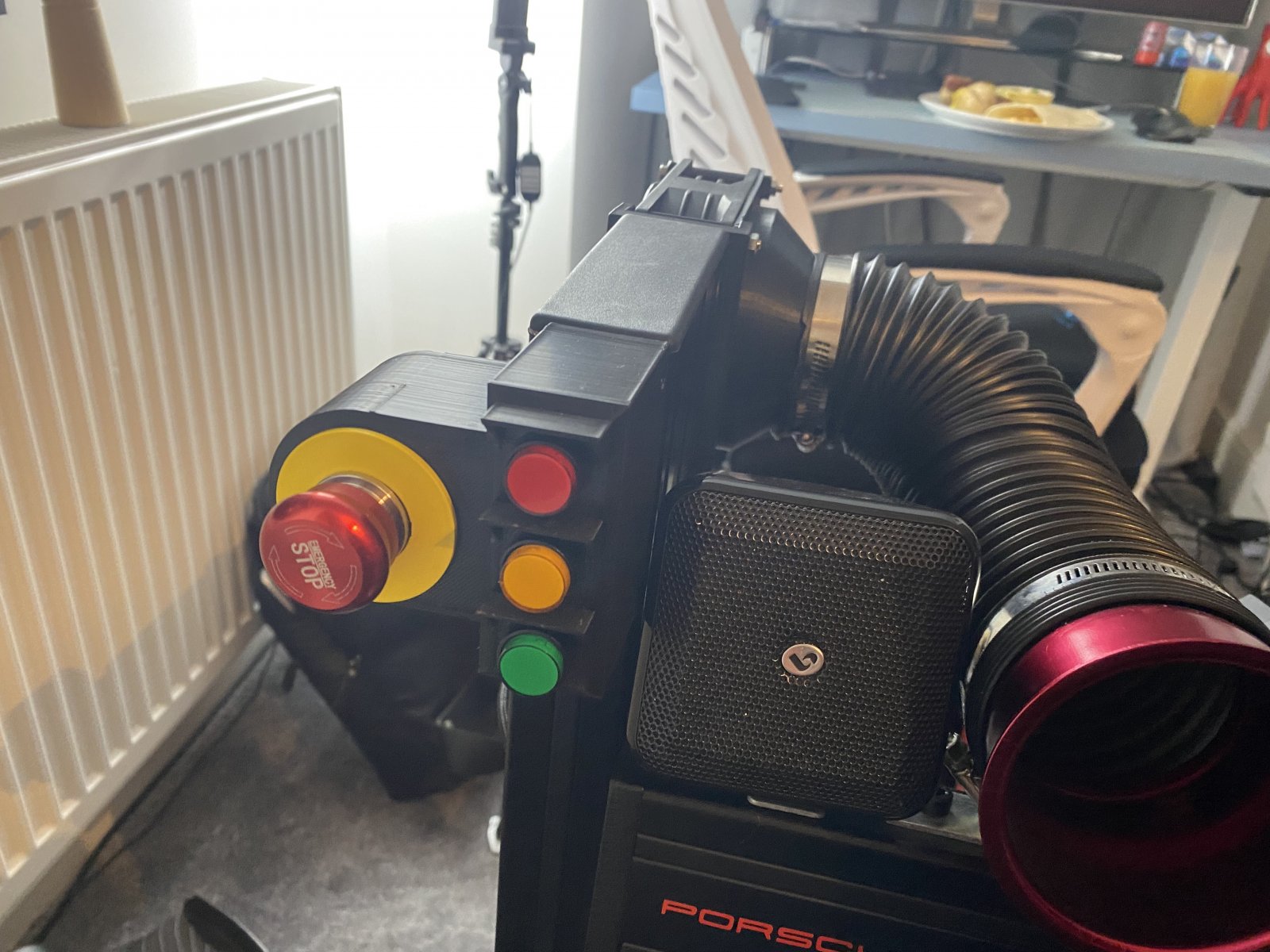

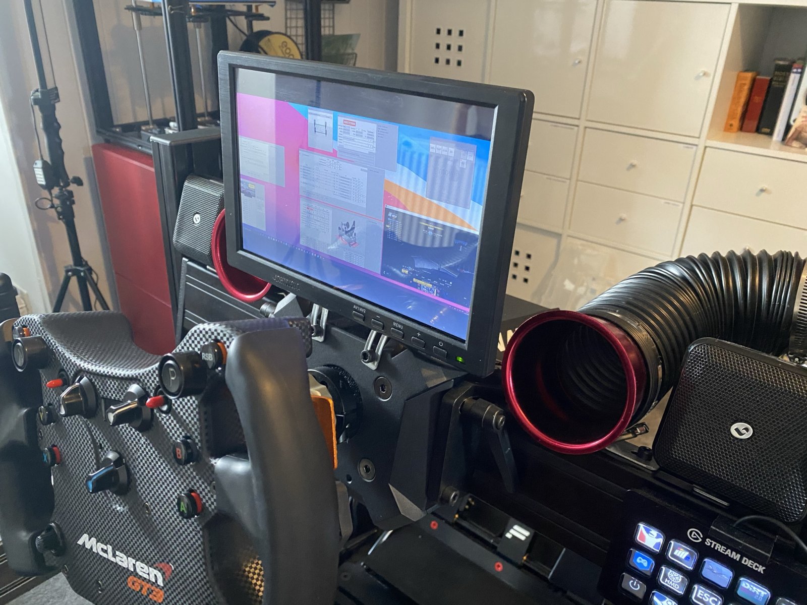

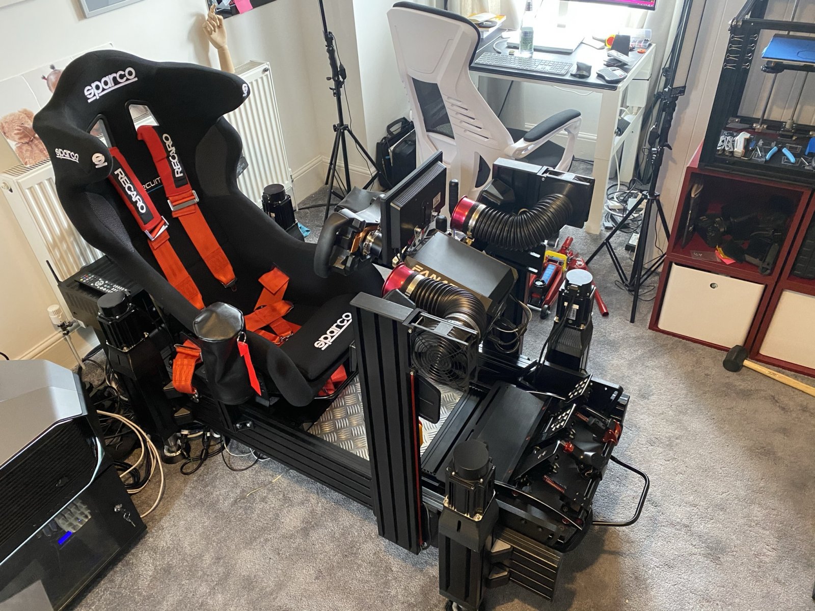

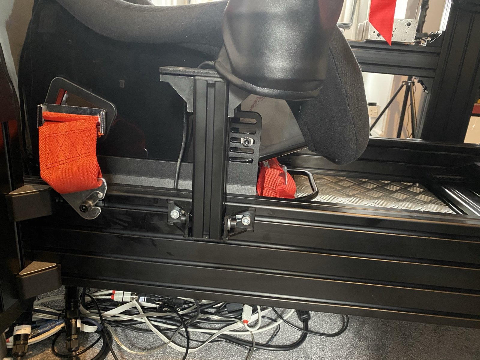

    The rig is now complete with some adjustment along the way.
    1. Lowered the seat height into the frame rather than on top.
    2. Painted the Kinetik profiles black.
    3. Switched to FlyPT mover (awesome) connecting to Thanos AMC (superb)

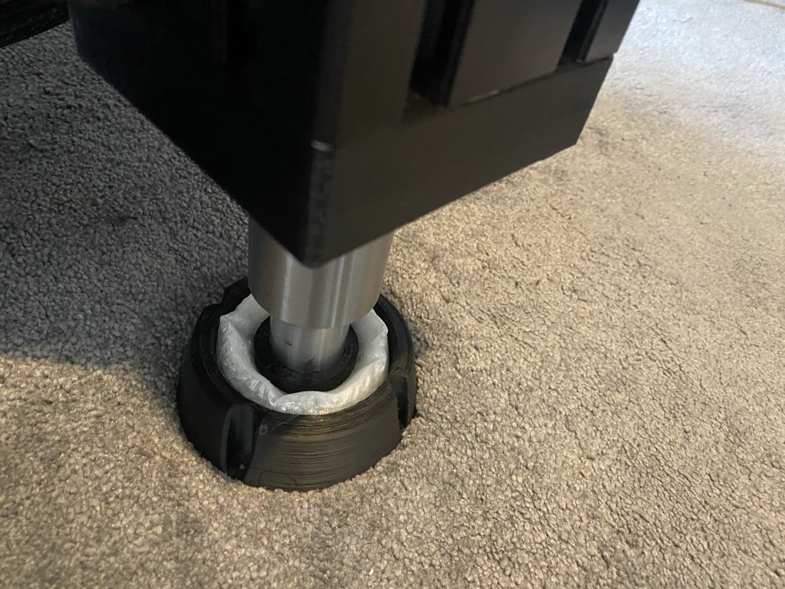

    4. Some flexi filament for the base which holds washing machine vibration pads underneath.

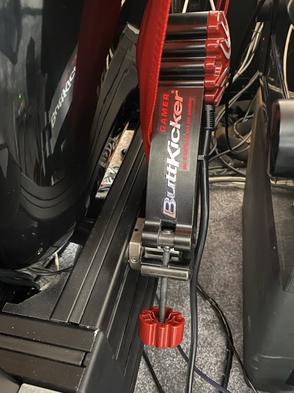

    5. Added buttkicker with 'special mount' - yes, that is a linear bearing as I'm now an expert and re-inserting ball bearings! My advice order 3 extra - it's very easy to extend beyond the shaft during the build!
    Just need to get the wind sim working with Mover and I'll be good to go. Lots of tuning still required though.
    PS. The resin printed parts cracked easily so not really an adequate alternative to PLA and I did reprint the sliders with 40% using PLEG instead.

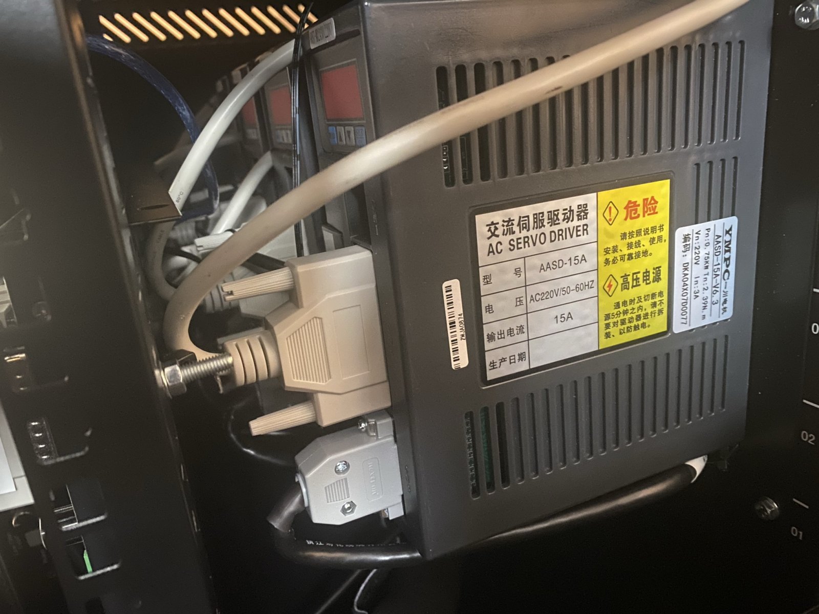

    why doesn't the servo driver match
  14. darkknight
    Feb 1, 2021
    29
    63Coins
    +19 / 0 / -0
    Sorry, which pic are you referring to??
  15. xurongyi
    xurongyi New Member
    Dec 11, 2020
    14
    - 45Coins
    Ťhere is a picture ,your
    servo driver is 15A, the
    米otor is 3a
  16. xurongyi
    xurongyi New Member
    Dec 11, 2020
    14
    - 45Coins
    friend, l think you use
    arduino uno r3
    can you send me a
    wirng diagram?
    thank you
    l come from shandong,china
  17. Thanos
    Jul 6, 2017
    1,378
    Electronics Engineer
    United States
    2,910Coins
    +1,079 / 10 / -0
    The servo drive model is AASD-15A, doesn't mean its 15 Ampere.

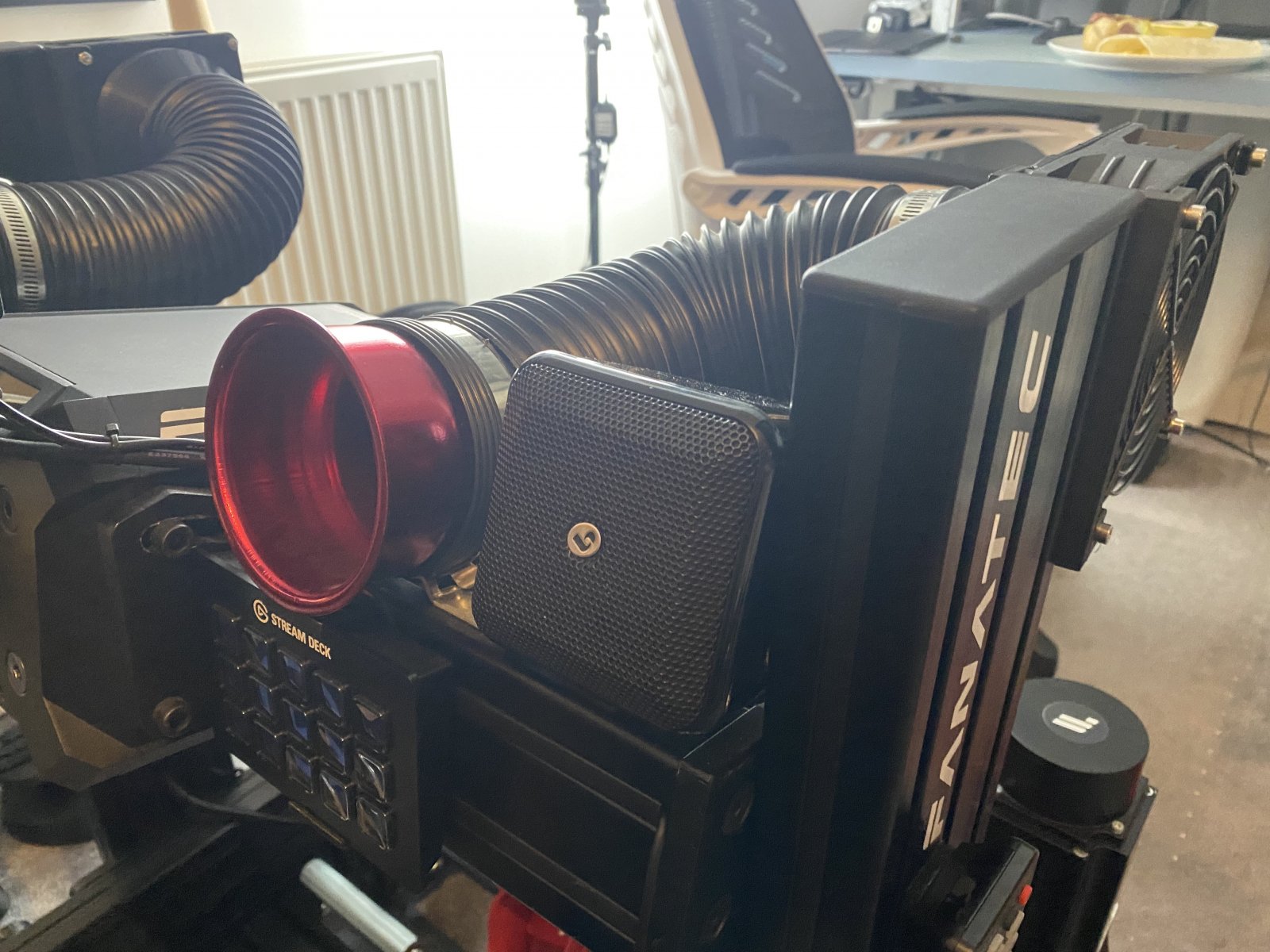

    Quick update as I've been tuning and enjoying mainly AMS2 on my rig. What a project! Just about to add another actuator for seat belt tension x4 but will need to get onto the SFX100 discord server to print some 3D parts. Can anyone here sponsor me please?

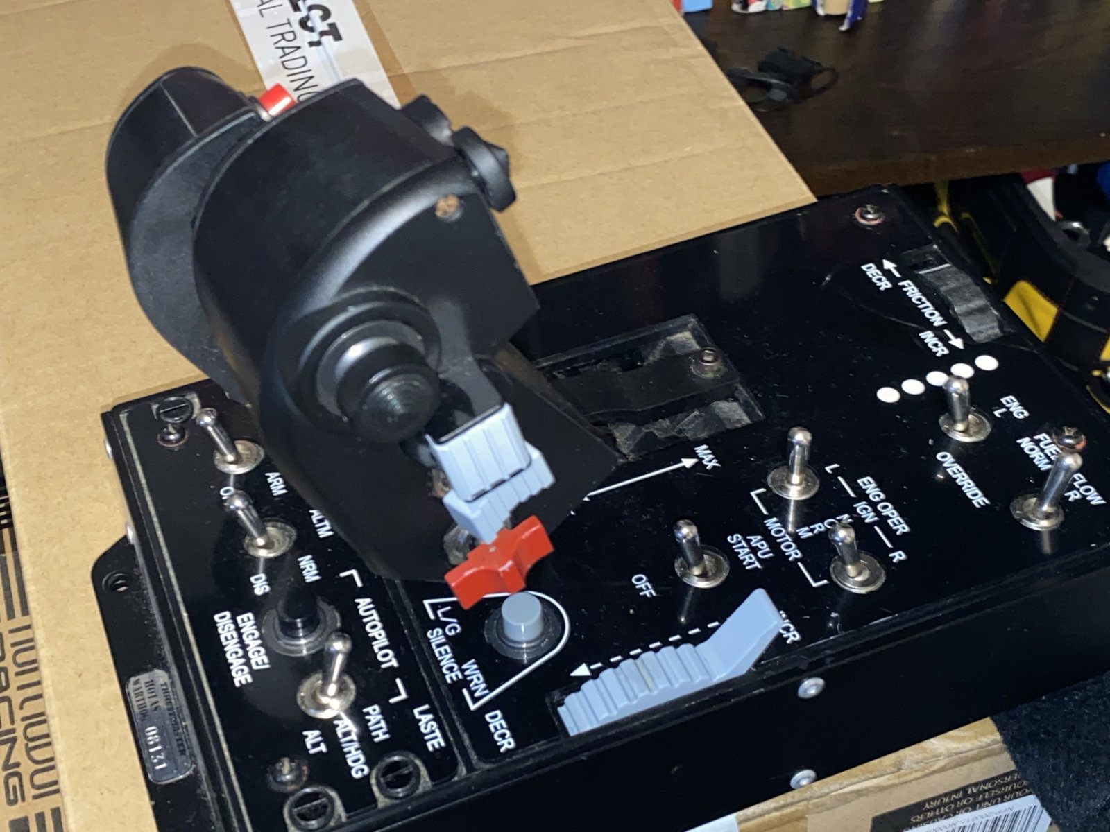

    New additions include rudder pedals and cyclic for the upcoming AH64 in DCS, Varjo aero which I hope will be here before Christmas, beefed up cooling for the OC 10850K and new RTX3080.
    With all the mods I've been doing the spaghetti junction of cabling needs tidying up too so will def. do that whilst fitting the new motor. Overall I've been very happy with the build.
