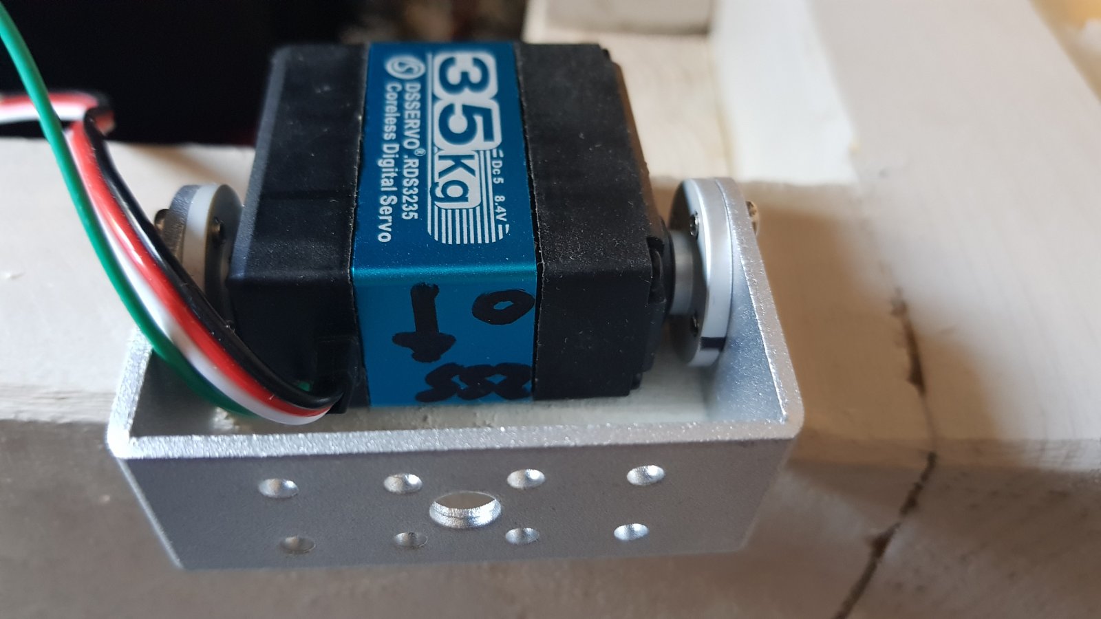

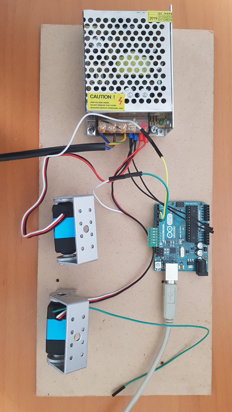

    here is the prototype board
    components are glued with hot glue. A good way to prevent short-circuits...

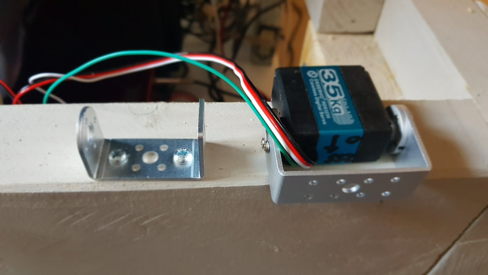

    1/ before all, move the servo without anything mounted on it:
    mark the way the servo goes from 0 to full
    and mark the middle position.
    Useful to prevent any damage, and to mount it the right way at the first try ;)

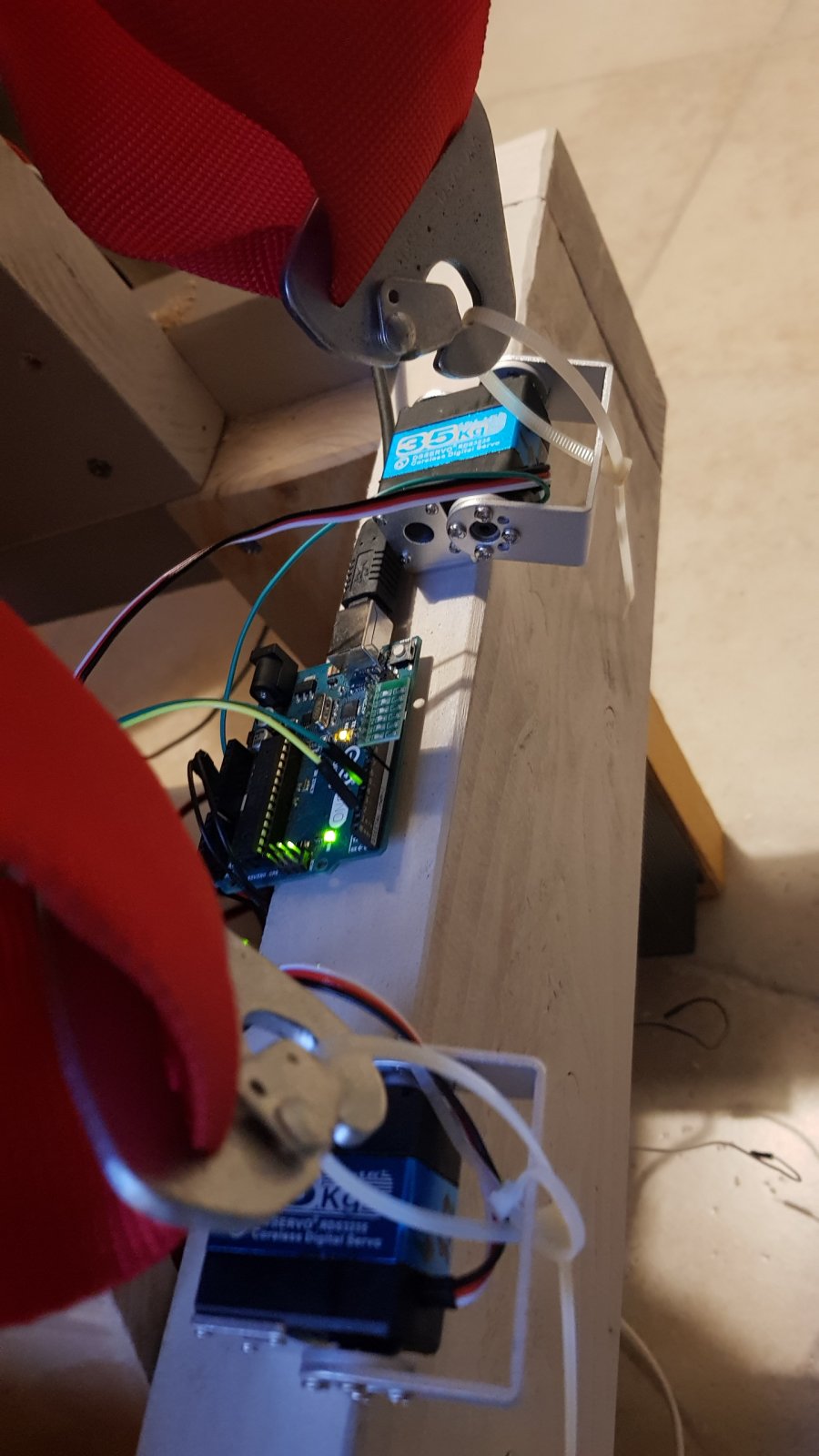

    2/ in place, use T-raps to link the harness and the servos
    Quickly done! and nice mechanical fuse by the way

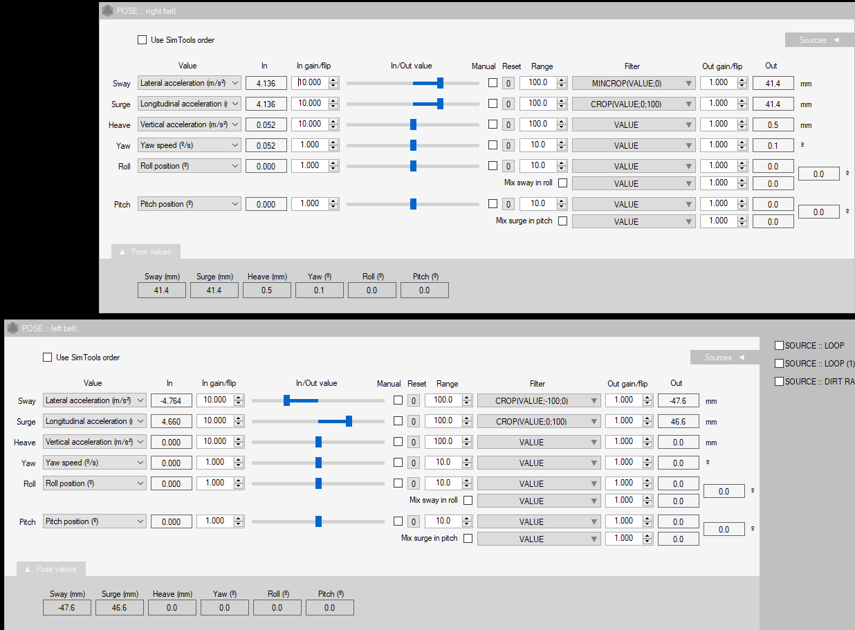

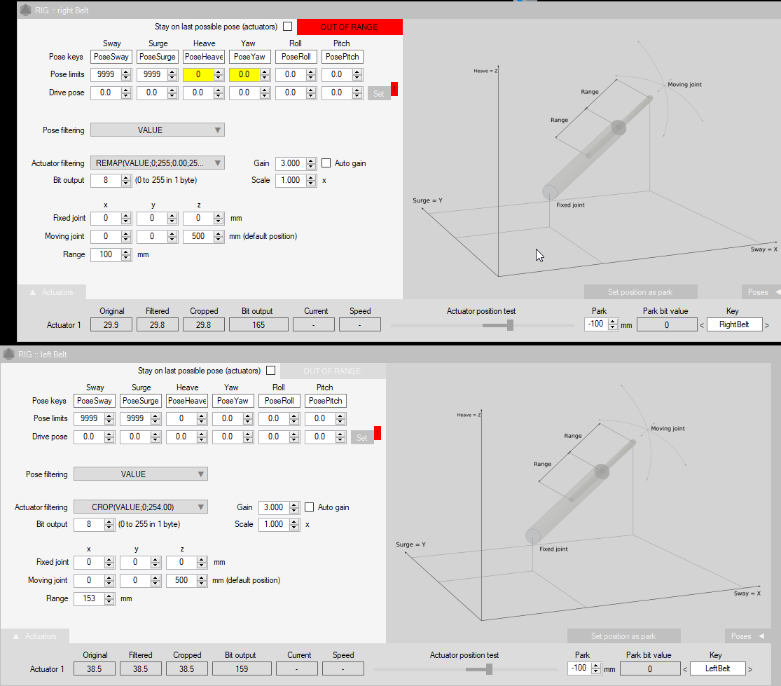

    Serial Setup:
    PTMover send 1 byte in binary (value from 0 to 255) for each Rig Key
    @8 bits, 115200 bauds
    I followed the example Output String: <255><255><LeftBelt><RightBelt>
    To find the beginning of the serial output string, it's advised to look for 2 following 255.
    After some trials, it appears that some times (when clipping) 2 axis are @255 and the serial is badly read.
    I'm ready to loose a little range by constraining the output value between 0 and 254
    in order to free the 255 value and be sure it'll be unique.
    But in the RIG windows, CROP(Value, 0,254) or REMAP(Value, 0,255,0,254) doesn't work... I still have 255 value outputed in serial. :confused:
    Can you advice me @pmvcda, please? I post the screen shots in the following message :)

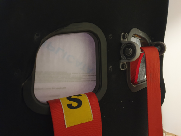

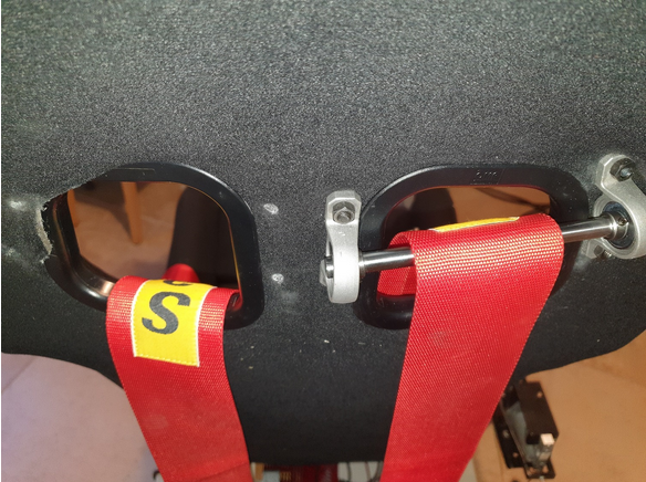

    here is my ball bearing support (12€ for 2 supports)
    they are made of:
    P000 https://www.aliexpress.com/item/32833812473.html
    Zinc Alloy Diameter Bore Ball Bearing Pillow Block Mounted Support
    they allow a big static disalignment as the bearing is mounted like a joint articulation
    and 200mm Ø10 linear shaft Cylinder Chrome Plated Liner Rods
    https://www.aliexpress.com/item/4001294745058.html
    conclusion:
    Pros:
    After some time spent using the harness tensionner, I really like how it help to break correctly (hardest first then decreasing.
    It's really immersive.

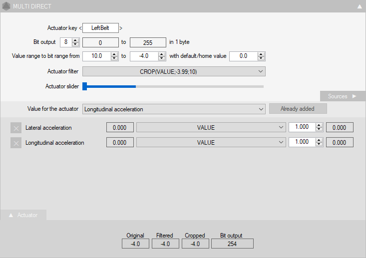

    Why use the pose?
    For seat belts, directs are enough.
    Create one for each seat belt
    Put 8 bits (0 to 255)
    Value range to bit range is what values you want to map to the 256 bit values.
    I used -10 m/s^2 acceleration is bit 255
    4 m/s^2 is bit 0
    Default value is zero.
    I use negative values here, so on acceleration you would feel the belt loosing, but not so much as we have in braking.
    Now crop the value to ensure you don't get 255.
    Since 255 is achieved at value -4, I used 3.99 in the crop.
    So the resulting bit never reaches 255.
    I have bee making changes in the code. And made some small ones in the directs. I think what I say is working. But I remember that 10 to -4 might not work. You might have to use -4 to 10.
    The image is the build I'm working on. That is now corrected.
    Also, use the multi direct. The simple direct might disappear soon, there's no reason to exist.
    EDIT:
    Note acceleration is positive values
    Braking negative
    So I might have swapped the values. Should be between -10 and +4.
    It all depends on what is bit 255 and bit 0 mechanically

  8. RacingMat
    2,237
    21,031Coins
    Bingo! It works like a charm:thumbs
    Here is a video showing step by step how I drive the 2 DOF belt with Fly PTmover:
    thanks @pmvcda
