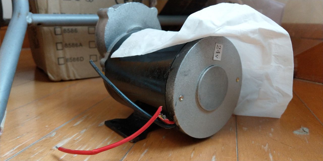

    Hello everyone, am new member reportin-in.
    I'm Malaysian, but working and living in Hong Kong, Electro-acoustics graduate from England 2001, audiophile fanatic since 1989, KE70 swap 4AGE and many mods since 2001, don't know Arduino at all. After many readings (thank you all, amazing you guys) finally figured-out a possible small-floor-area-footprint approach (because Hong Kong no space), hopefully low-cost too (most parts will be sourced from China taobao estimate total US$200 for a 3 motors setup pitch+roll+rear_sway). Also hope to be least metal-works i.e. no welding, no cutting metal sheets/pipe/tubes I hope.... just drilling holes to add nuts and bolts I hope, to screw on motors, to add tie-rod etc etc, simple DIY I hope........ how???? simply bought another rear-seat-frame-rig (in hope to mount all the motors in the center low down as anchor and placed under a regular racing-chair-rig+G29 (entire rig bought used US$260 in Hong Kong 2019).
    parts from China taobao, prices converted to US$, make life easy for you guys.
    1. US$25 motors each 24volts 200rpm 500watts, received one unit for testing, it weights 3kg...... very beefy versus wiper motors, but the spindle is not linear silky smooth, it stops at specific angle..... hmmmmm may be not what we want???
    2. US$2.34 BTS7960 each, but after reading so many blow, smoke and fire...... hmmmmmm
    3. US$6 tie-rod 11cm with arm 5cm, realized too small when received one unit :(
    4. US$4 tie-rod both ends 24cm, may be usable??? considering.
    5. US$13 24v power supply 10amperes, hmmmm sounds like fire disaster waiting to happen.
    6. US$27 rear-seat-frame-rig (without seat)
    7. Arduino Mega2560 US$5 (used parts in Hong Kong carousell)
    8. US$ 0.5 potentiometer (forgot to buy one to test, probably rip one out of an unused amplifer :) )
    9. did I forget anything???

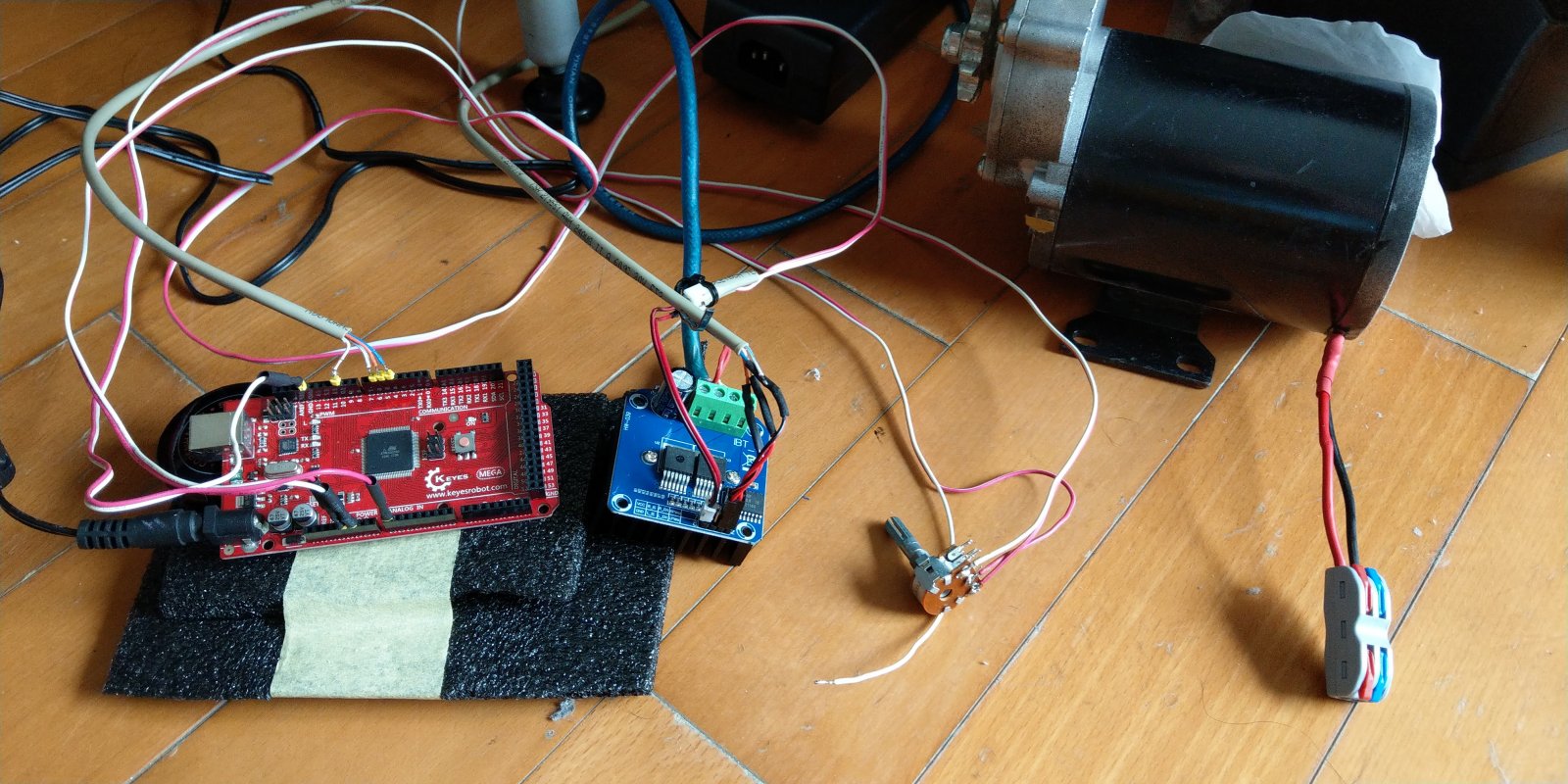

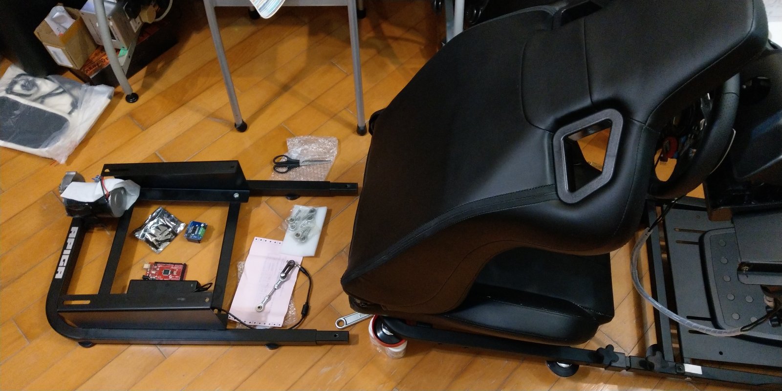

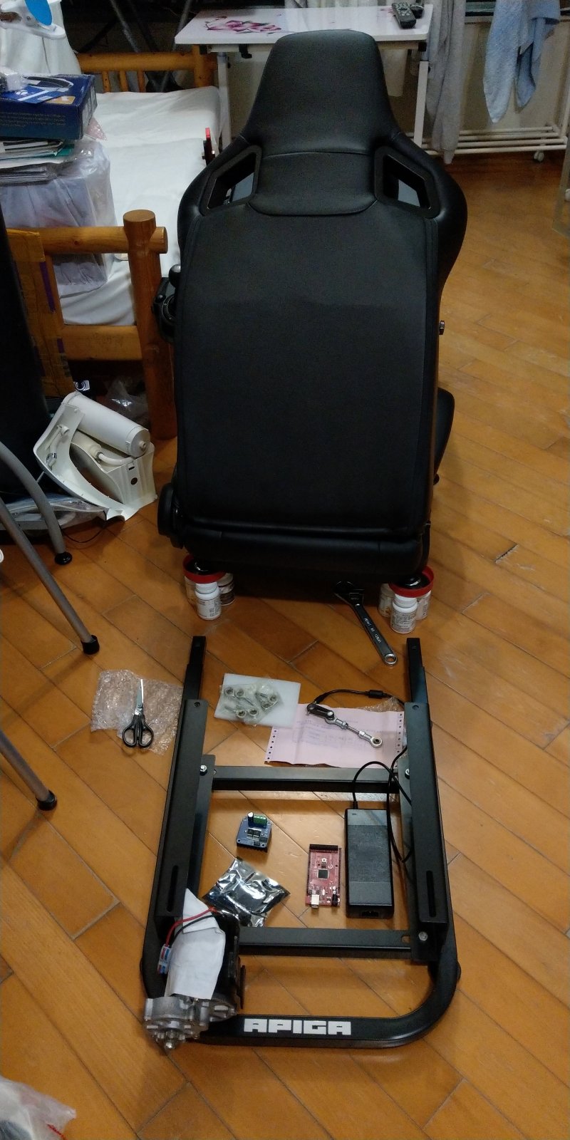

    Tiny progress solder signal wires. Still many to do, next take out potentiometer from redundant amplifier, replace positive power cable for motor, shipping damage.
    Just realized forgot to buy 8 pins socket.
    I was planning to prepare to upgrade to 6DOF, hence bought a Mega2560, then later realize there's no SMC6.

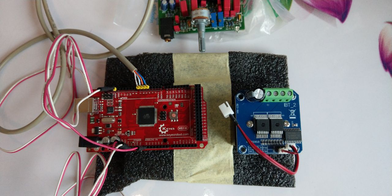

    got 99% wiring up for real, correctly placed pins/wire/signal, not just mock up, am making final checks then power on, god bless no smoke i.e the China BTS7960 !!!!!
    but I'm using external 5V power supply for BTS7960, not sharing with 5V from Mega2560 to potentiometers, hence there's a GND wire not yet connected, seen nearby POT, am wondering if I could just link it with GND of POT with Mega2560 ..... pondering......

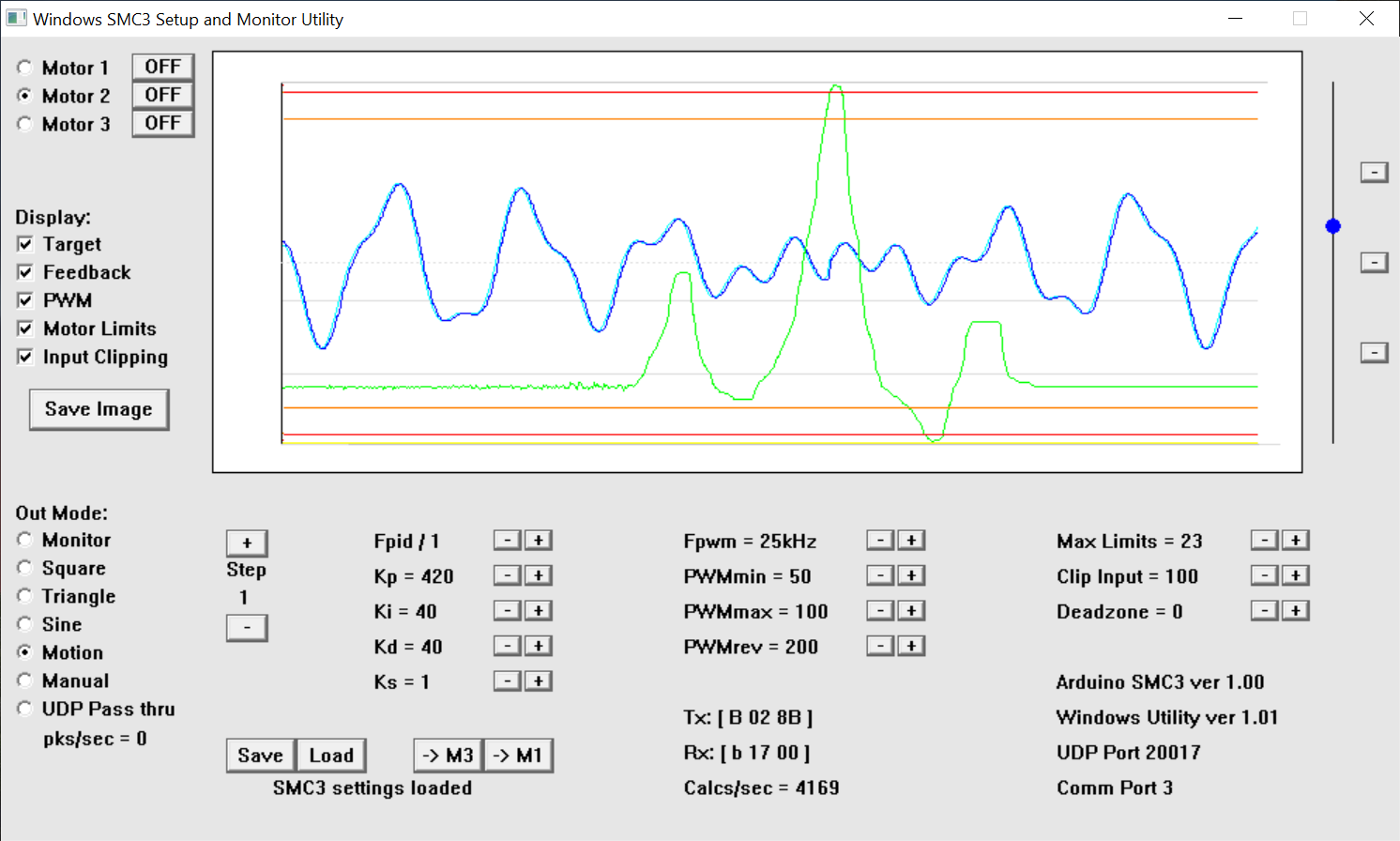

    Hello, got many small quick questions, if anyone can spare me some time to answer, much appreciate, much thanks in advance. Regarding Mega2560, Arduino IDE says upload SMC3 successful, running SMC3Utils shows SMC3 v1.0
    When I turn the POT, connected to motor2, there's good response, seen by the green line, but the motor doesn't move, I think because I haven't setup in SimTools which axis pushes which motor, something like that, I know I have to re-read some instructions seen previously,
    ...........but what I want to ask is when I click on motor_1 and motor_3 and then I turn the POT, the green line also moves...... this is weird to me........ or is it OK?
    ...........hence now the worry SMC3 is coded to UNO_R3, not Mega2560, could this be the problem???
    ...................obviously the screenshot also shows all 3 motors are OFF.......
    ...................there's no PWM signal changes in SMC3Utils.
    and more...... obviously got to do more reading ...........

    Good day gentlemen, thanks @noorbeast your link made my recheck wiring, 【it all works】 is the quick report title.
    Details:-
    1) I wrongly wire ENBABLE and PWM pins, my own fault.
    2) I didn't clear all ZERO in SMC3Utils.exe, sorry. When only set Kp to 500 and PWMmax increase slowly to around 100 or 150, suddenly the motor spins..... hooray....... I think 50 was still no spin, then 100 spin really slowly like 1_rpm but the happinest moment, can't believe my eyes,,,,,, you know...... stumble for a few seconds, was I dreaming??? just work up and not seeing things right??? Then push to 100 and indeed faster and 150 and finally settled on 200rpm.
    After the motor spin, I approch to inspect the messy mockup parts and wiring, suddenly the motor stopped spinning......... then I thought must be a loose connection and started slowly touching / moving bits of parts and motor spin again...... so
    3) my own mistake/hiccup, the power cable to motor was intermittent bad connection, my own fault.

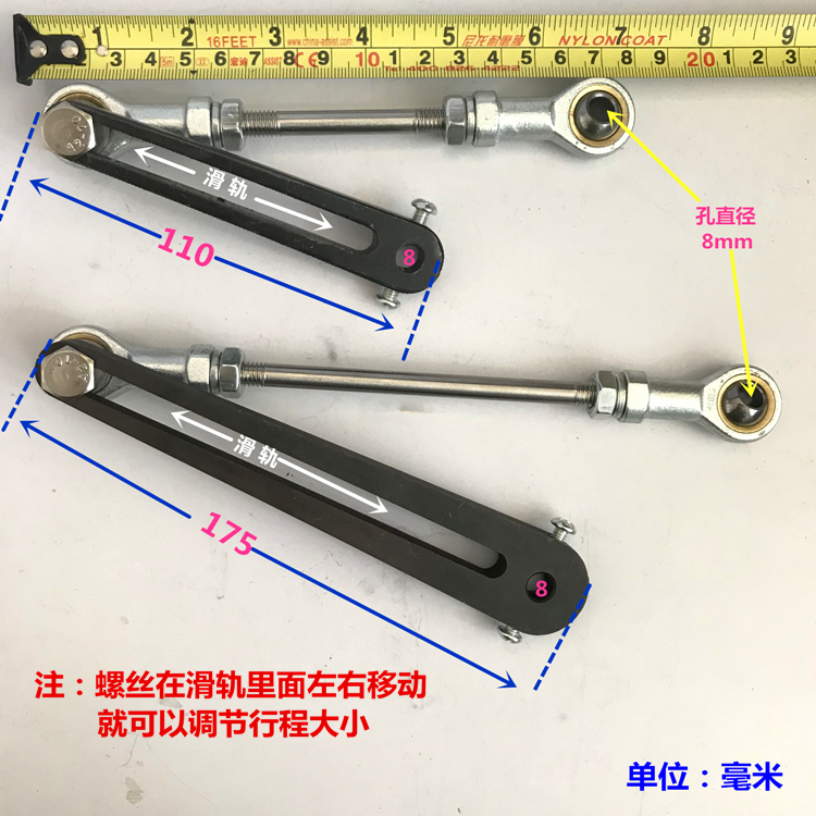

    hello again gentlemen, I've got a big important question needing advice : which arm LENGTH would be recommended for 6DOF motor rotation type, not pushrod actuator.
    I found below 2 choices, US$9 each for 110mm arm LENGTH versus US$11 each for 175mm, so cost is not the question here, but sensible dimensions to allow 6DOF, considering tie-rod angles needed I suppose ???? my head going to explode visualizing what LENGTH I need......
    vertical imagination is easy enough, am considering when motor rotate angle from bottom -180degrees up to maximum heigth +180degrees, assume I buy the 110mm arm, then the race-chair-rig from bottom -110mm will rise to 0mm height (motor 90 degrees) then up to maximum height +110mm (motor +180degrees). I get total 220mm travel from bottom to top, a lot lor, more more than enough, overload I think. All the motors rotate simultaneously, ok, I think easy imagination, but then horizontal???
    For Horizontal when move side to side (SWAY), how ah ???? I don't understand yet. Only 2 motors responsibile to move SWAY I think or I thought, but the other 4 motors although no need to move, but also need to move in order to make way for the 2 responsible motor....... ohmy head gonna explode thinking about it.....
    so the quick question still remains, which arm length is sensible suitable not overboard overkill. I'm worried the 175mm will be too much...... or because I don't understand and didn't consider enough some neccesary room / freeplay (wrong word, I don't know the right vacabulary).
