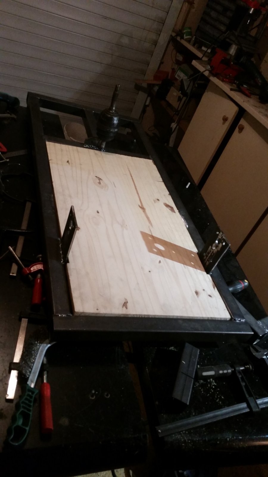

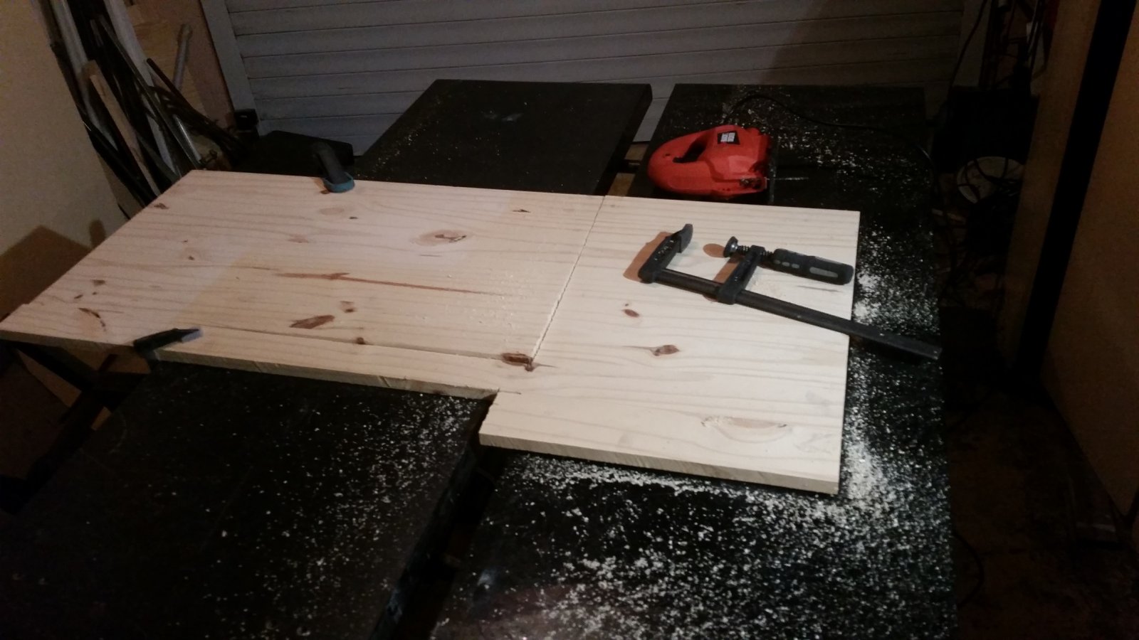

    Cutting the wood to make the support for the electronics parts

    Making supports for the wood board

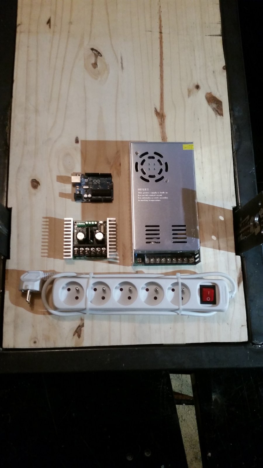

    Implantation of the electronic parts

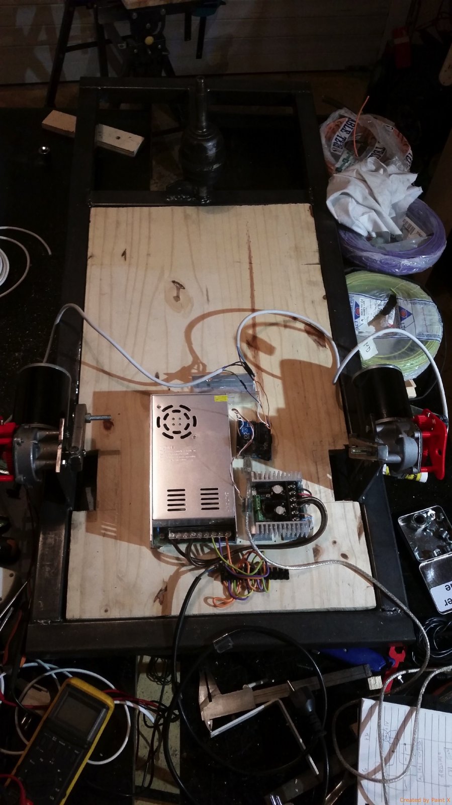

    Wiring the Sim

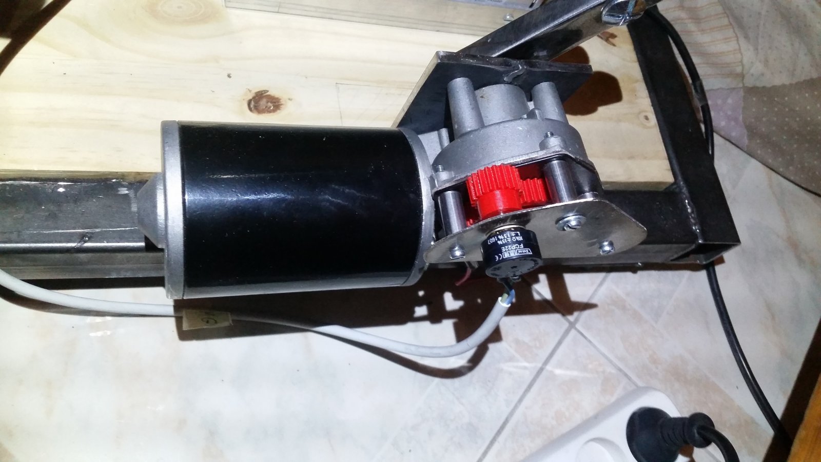

    But now I've a problem with the motor arm, they are turning around the shaft so I'll buy others. I will change the U-Joint too I have some movements in Yaw axis that I want to remove.

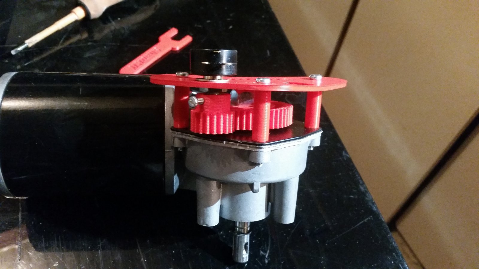

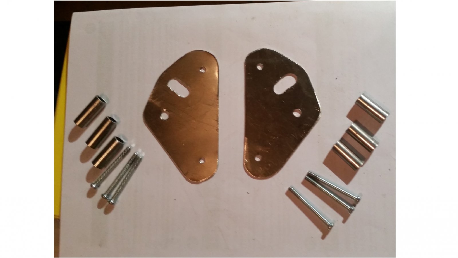

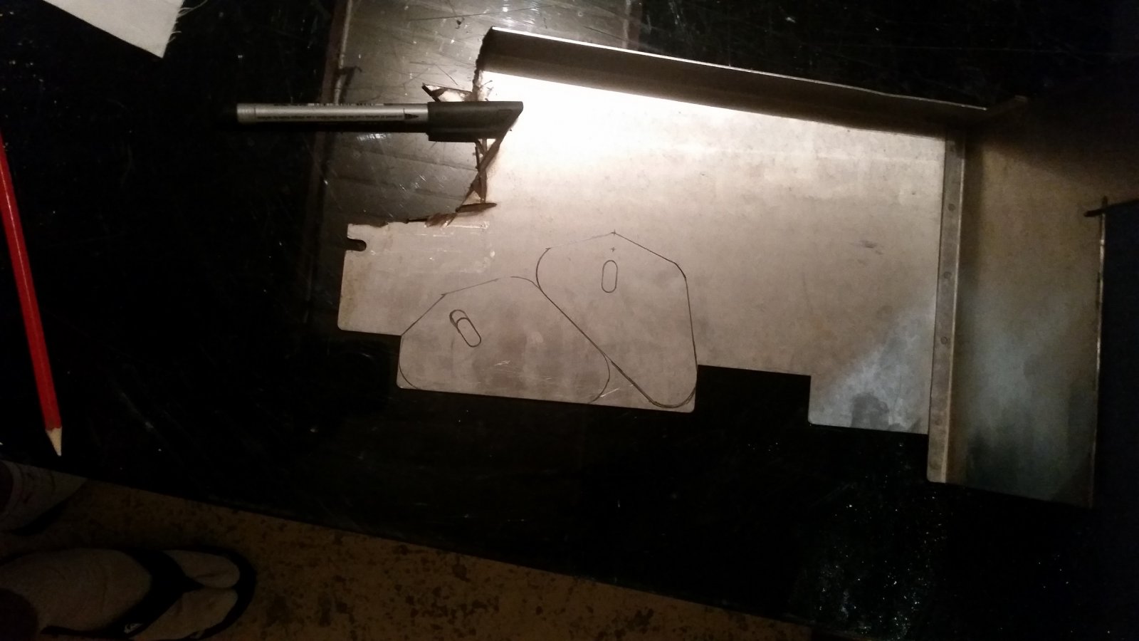

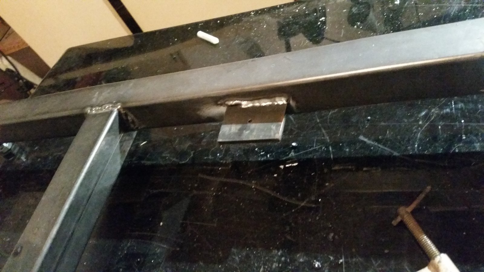

    The position sensor brackets were not strong enough for me, so I build others with metal.

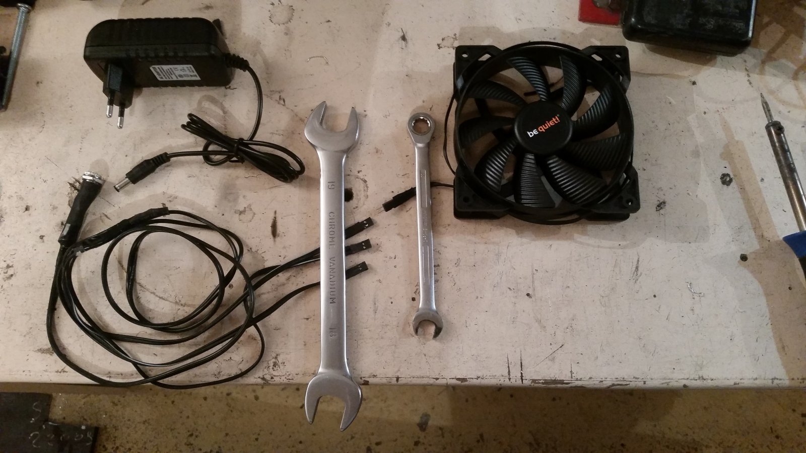

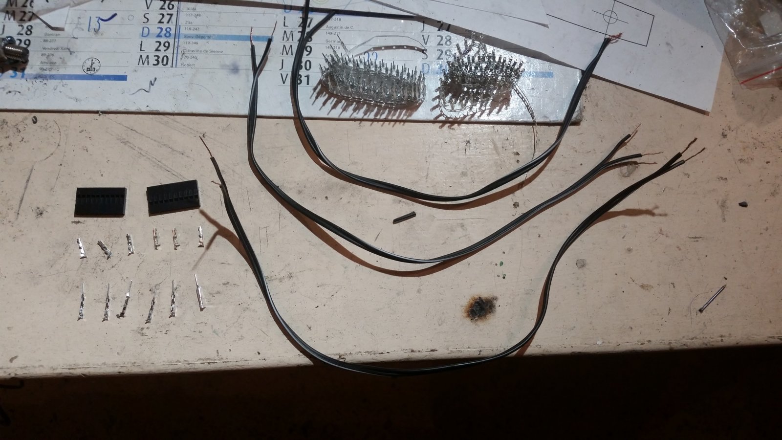

    Soldering of the wires for the 3 fans: one of 120mm for extracting and 2 of 60mm for injecting fresh air

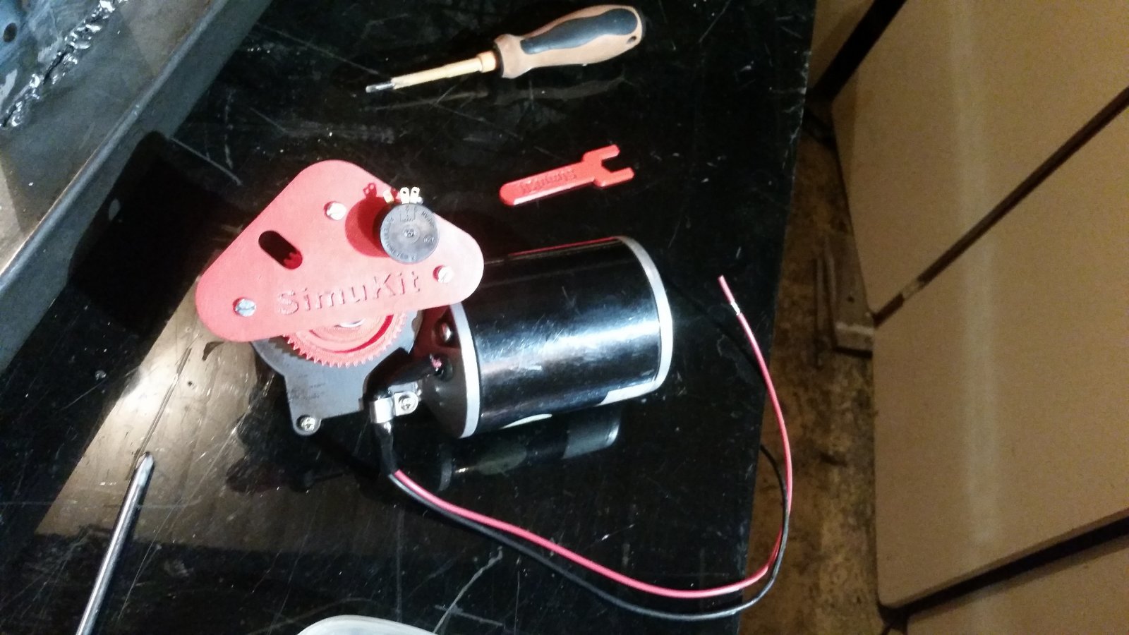

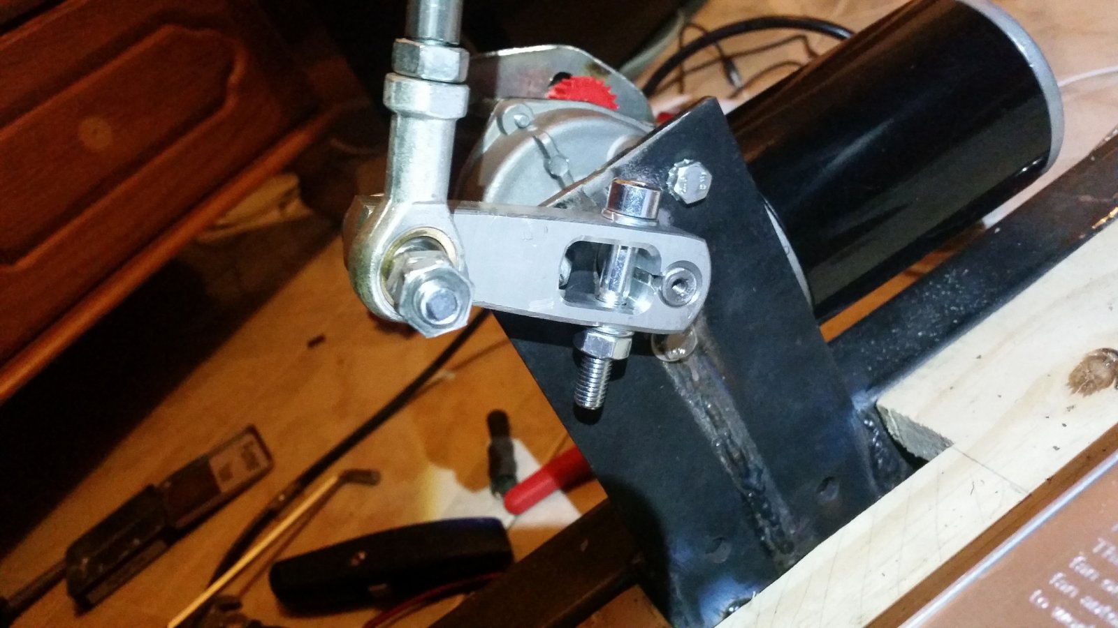

    Installing the new Simukit arms
