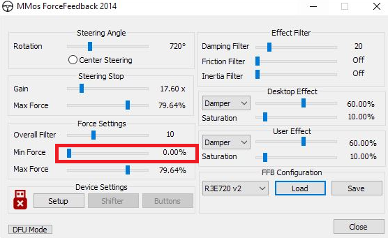

    thank you for answering, I am very interested to use a direct drive with the my1020, I will use a 320mm steering wheel because I like the GT and stock cars, with that measure will not be too weak? now I use a t300rs and I notice it loose but I'm sure it does not reach even half of 7nm.
    The step effect of the magnets is noticeable? with mmos can you give a minimum of constant force so that you do not notice the force of the magnet?
    Could you help me make my wheel? by here or by email if you prefer
    And with the 48v motor can I give the 50A to 12V as in its 36v motor? Would not I give more torque with the same amps? or your engine gives more than 50A?

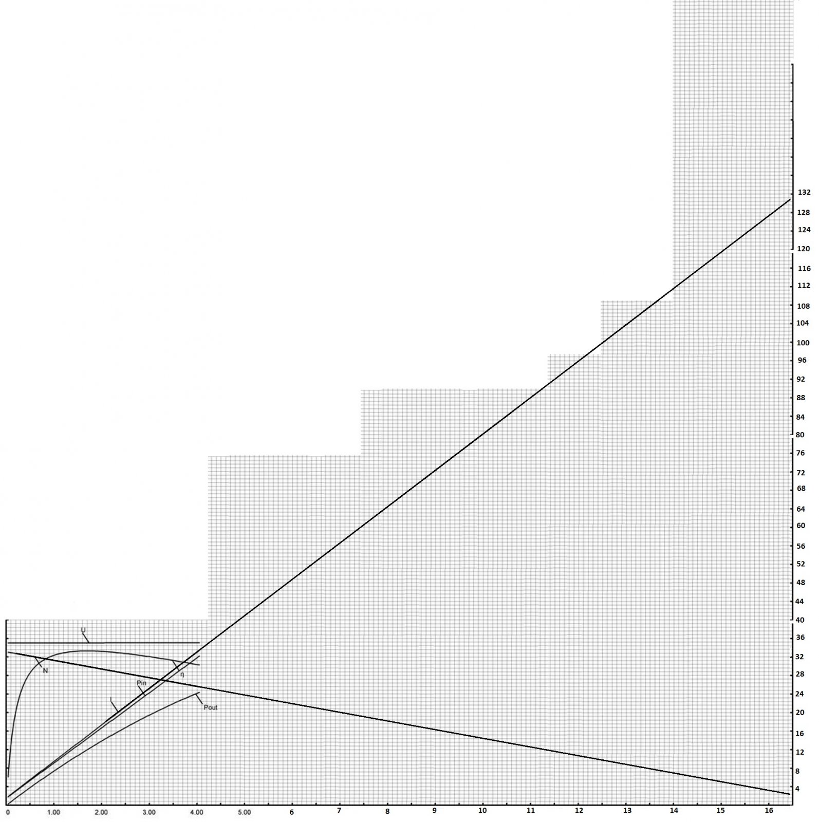

    HA! Good spot, that is an uneducated statement. I was reading the graph all wrong. The MY1020 is a decent motor but requires a hefty power supply.
    I must have been reading the wrong line in the performance graph or just had a complete brain fart. Either way ignore that statement
    In this link you can find the chart: https://www.motiondynamics.com.au/unite-my1020-1000w-3000-rpm-48v-dc-motor.html
    You can see the rpm line "N" slowly decreasing and by reading the bottom torque numbers you can imagine the motor getting to quite high torque by the time it gets to zero.
    I've extended the graph here, The bottom line displays torque and the right hand side is the current draw.
    As you can see, in theory the motor could get to around 17Nm of torque at stall @ 48V ~132 Amps.
    However this graph is not 100% accurate, I've only lined things up by eye.
    This kind of amperage would obliterate the winding inside though, and very quickly.
    Running this motor at 12V would cut that current down quite a bit but still too high for the much thinner windings of a 48v motor to handle for extended periods of time.

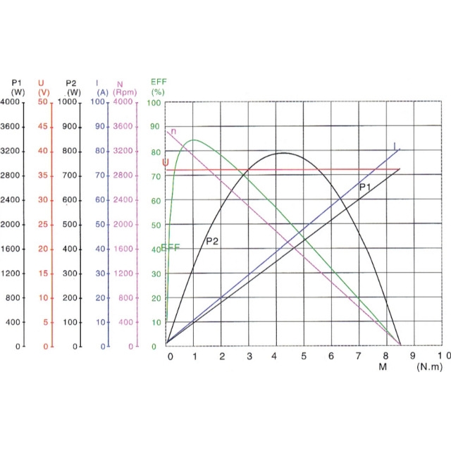

    The motor I am using is here:
    https://www.motiondynamics.com.au/xyd-6d-450w-24v-2600-rpm-with-chain-sprocket-en.html
    It actually has a full graph shown to begin with which helps.
    You can see the blue "I" (current) goes up to about 80 amps as the pink "n" line goes down to 0 rpm along with torque heading towards 8.5Nm at stall.
    I'm still doing testing on my unit and will report back when I am finished. I'm currently doing 12V tests just to make sure I don't fry anything.
    Even these graphs may not be totally 100% accurate though, you could consider them as "typical" performance and real world values would be different.
    These are cheap Chinese built motors.
