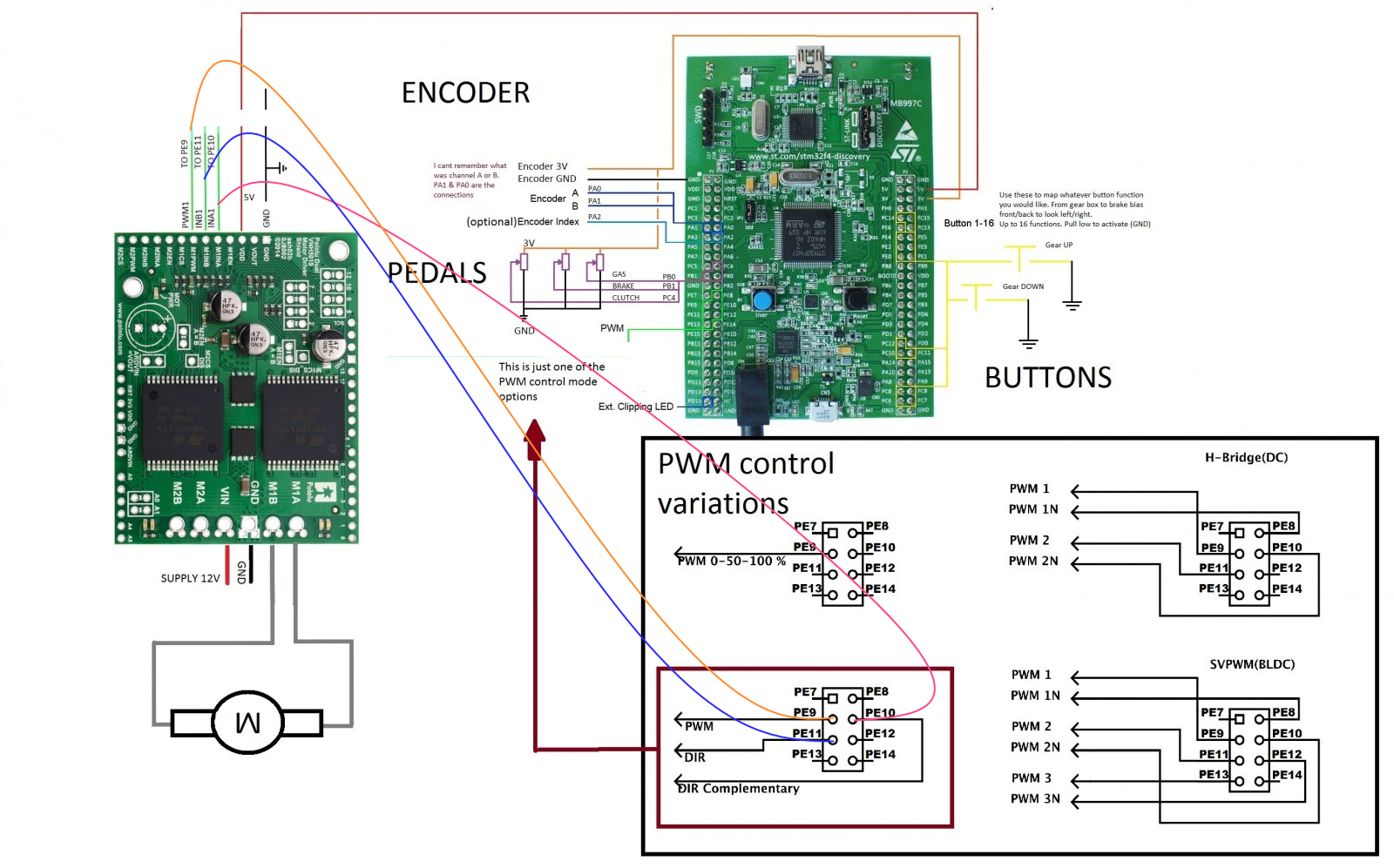

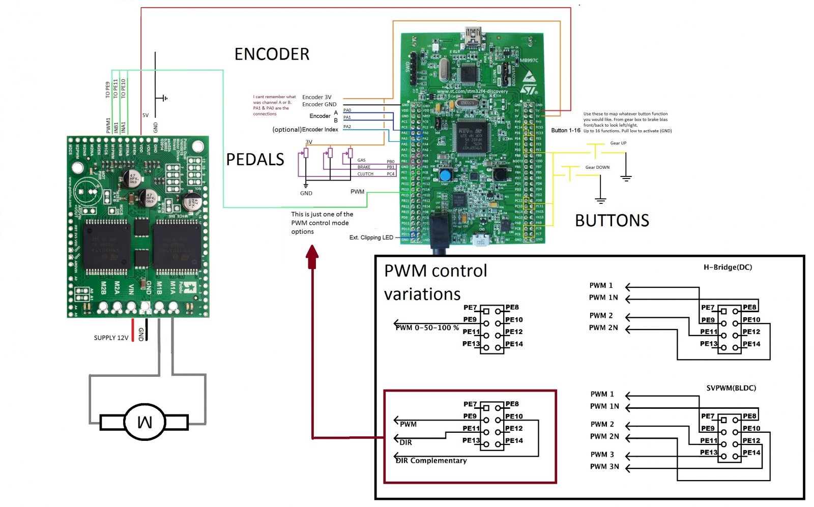

    OK. After a long wait.
    Just remember the motor controller side of things will be different if you have a different controller but still pretty much the same.
    To choose the mode as pictured you must start the MMos utility and in the setup section you must use "PWM & DIR" mode.
    I suggest to download the picture to be able to zoom into the detail.
    In other news my encoders arrived. I 3D printed some gears and will test them out soon.

    +3,098 / 31 / -0
    @Alexey thank you very much for the diagram. At least using this few components we can pimp or even build from scratch any wheel...

    The diagram if you are using a motor driver like the VNH5019 from Pololu:

    @ quick readers, the INA, INB and PWM require separate wires.

    Thank you @RacingMat but imo this should be clear on the diagram if you read the text, probably some dudes could trouble with it.

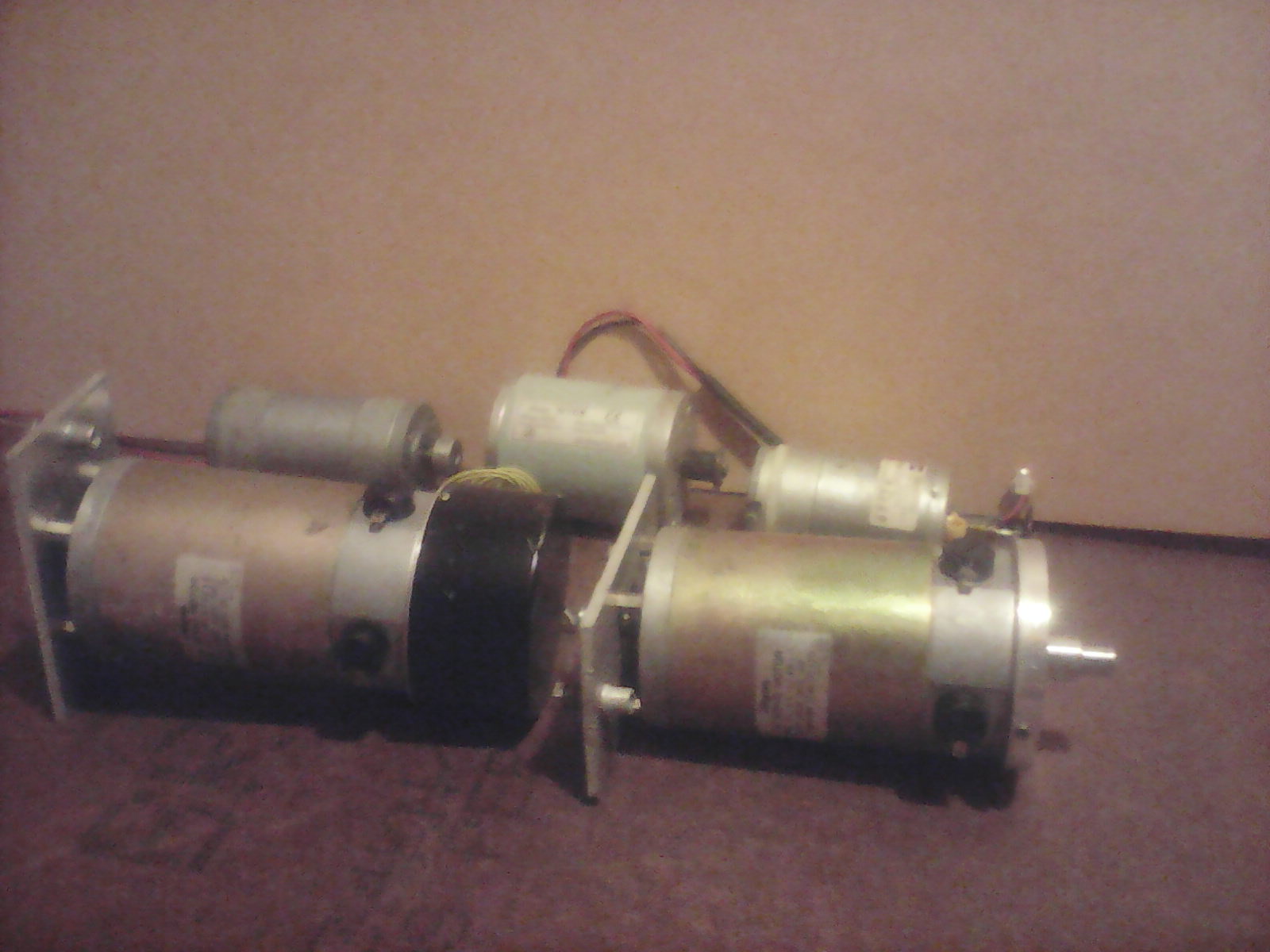

    @Alexey
    Maybe I could help you a bit by offering you a motor that is a lot more suitable for a steering wheel.
    DC servo motor Tamagawa TS3081N74E18 if you want to look up specs but it is a custom run which is approx 1/3 longer in size.
    It has a holding brake on the rear which is removable.
    Motor is the front ones and I have included the 100w scooter motor and a couple of old large printer motors for size comparison. Biggest difference between scooter motor and servo motor is there is no digging while spinning motor.
    I can also resize either end of the shaft on my lathe if desired, currently 12mm.
    One end a plain shaft with 29mm diameter PJ 3 groove pulley. The brake end has a keyway aswell.
    I can spare one as I have about 50 of them.
    You pay post, motor weighs around 3.5kg.
    PS. I would offer you as well Pit, but post to Switzerland would get expensive.
    Cheers Andy

    @OZHEAT very friendly action, but as you assumed rightly the cost of the delivery is more than twice of a "secondhand" motor...in turn we should offer you a new camera :)

    I'm guessing your line of work is something to do with machining/automation?
    I would love to have access to that king of gear, last time I touched a lathe was 5 years ago.
    Thank you very much for your kind offer but at this moment I'll sadly have to decline. It seems that the motor is 24v and I have no power supply to power it. I do however have a 180V DC supply wink wink nudge nudge ;).
    It's not that I couldn't just buy a 24v supply but I've promised the wife I'd stop buying stuff for at least a month.
    Cheers

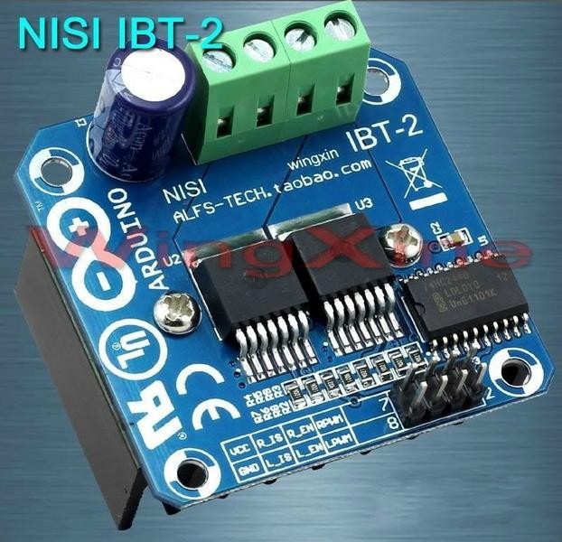

    Hello everyone.
    Although long since I registered, I think it's the first time I write on here. My name is Vincent and I have known this project thanks to my Merchane friend, who is also a member of this community and I can only say that I find wonderful.
    I have a 2Dof simulator and suffered a lot with the damned Monster Moto Shield (MM), burning several and found the solution when I decided to change it for two h-bridges IBT-2.
    These support 43A and bring a large sink and built.
    You can find it in Aliexpress looking "BTS7960 43A" is of much higher quality than the MM I assure you, you notice anything but take it out of the package and at first sight, since the mountain on my simulator will not have returned to have problems and it's been almost two years.
    Alexey, I hope soon your problem solutions with h-bridge and thank you very much for sharing your project.
    A greeting.
    • Informative Informative x 3

    Was it the original motomonsters that you were having reliability problems with? or just the known Chinese copies?

    Hello pipis 2015.
    The truth is that all were brought from China, I remember that there were four, but the IBT-2 also were brought from China and the difference is brutal.
    The MM were cooled with a heatsink with thermal paste and a fan at all times and always ended up burning which has not happened again since install the IBT-2.
