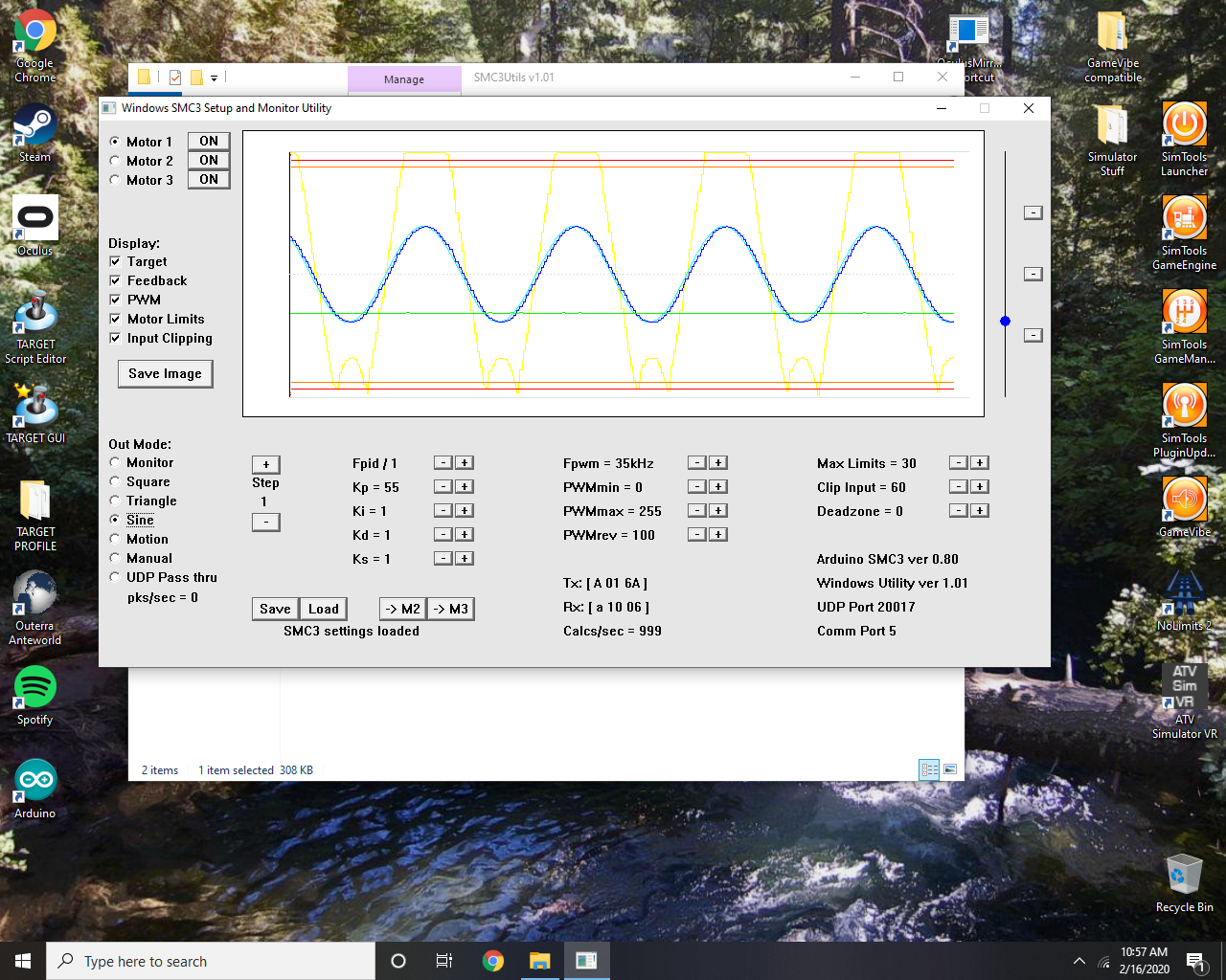

    Hello, again. It's been a long time since I posted the final BOM and build details on my 6 DOF rig. Here is the original thread.
    In the interval, I bought a new home, and the simulator was disassembled, moved, reassembled, worked well for a few months and was then disassembled and moved about 12 feet straight up (into a loft), where it stopped working completely. The main problem is no movement from the motors - either through Game Engine or SMC3 Utils. I don't even get the usual twitch when I connect the USB hub to the PC after powering up the motor controllers.
    Brief overview of my setup for those not wanting to dig through the build thread:
    6 crab pot puller motors
    3 Arduinos with the SMC3 sketch, driving 3 Sabertooth 2X60 controllers, each powering two of the motors.
    Power from 6 LED power supplies, all in parallel with each other and a 12 V battery.
    What I've tried so far:
    - Checked continuity on all power wires
    - Cleaned all contact/connection points
    - Confirmed correct connections from hall effect sensors to Arduinos, Arduinos to motor controllers, and motor controllers to motors
    - Replaced USB hub (as I was getting a "Last USB device connected was not recognized" from Windows 10.
    - Rolled back all of the Windows 10 updates that were installed when I turned on the PC after moving the simulator
    - Changed baud rates on all Com ports (1 is the USB hub; 3, 4 and 5 are the Arduinos) so that they matched at 9600, then 115200, then back to 9600. The baud rate in the Game Engine interface settings is 500000, which I recall being the original setting, but I tried matching that to the Com port settings as well, and then switched it back.
    - Uploaded SMC3 sketch to all Arduinos again
    - Isolated each Arduino/motor controller pair by connecting directly to the PC without the hub to see if I could get any pair of motors to respond.
    When I run SMC3 Utils for any of the Arduinos, I get a display that looks like this (again with no motor movement):
    I've been away from this project for a while, so troubleshooting isn't as instinctive as it used to be when I was up to my ears in it. I was hoping to find a simple, single problem that would explain the lack of motor response as I can't imagine all three Arduinos and Sabertooths having failed at once. If anyone has any ideas, I'd really appreciate them! Thanks for wading through this.

    Thanks for the replies, guys. @Markku Lorenz, at last check, I had 12 V at each motor controller, and the controllers are all showing one, green LED indicating ready with no faults. I don't have any measurable voltage coming out of the controllers during output testing in Game Engine, however, leading me to believe that they are not receiving signal from the Arduinos. However, @BlazinH, I am using that sketch, and in SMC3 Utils, I see a yellow line (albeit wonky) which, I believe indicates the PWM signal from the Arduino. So I'm kind of lost at this point.

    use smc3 with h-bridge and never with Sabertooth if the same operation from the photo can be seen pwm min 0 raise this value

    I reinstalled SMC3_SPS-softstart on all three Arduinos. Com ports are all set at 9600 baud. In SMCUtils, I can see the green feedback line change when I physically move the lever arms on the motors, so I know the hall effect sensors are working. However, none of the PWM settings in SMCUtils will make the motors move. What I see is similar to the screen cap above. When the sine wave hits the target line, it seems to trigger a couple of spikes of PWM in a "downward" direction, giving that funky looking waveform.
    I disconnected the Sabertooth drivers from the Arduinos and set the dip switches to put them in analog mode per the troubleshooting directions. That resulted in all motors free running, so I know that the motor drivers can pass voltage to the motors. The problem seems to be with the Arduinos or the software somehow, but I cannot for the life of me figure out what would have gone wrong basically all at once to take me from a fully functional sim to where I am now.

    Hey Squonk, sorry about my earlier advice. If I understand the screen grab, coms look fine. What is the yellow line? That it flat tops and has inverted bottoms really has me wondering what it is.
    Is 35kHz PWM the proper frequency? Also, as BlazinH mentioned, maybe best to work through the SMC3 tutorial? Since it was disassembled and moved, it’s almost like a new build for sorting things? I think PWM max is also typically set lower so accidental or reversed movements don’t break thinks with full-force movements and only set back to 255 once sure things are good?

    Hi, @Zed. Thanks for your reply. The yellow line represents the PWM signal from the Arduino to the Sabertooth, as far as I understand it. And, yes, it looks funky. I did go through the SMC3 tutorial again after reinstalling the sketch on all three Arduinos, but I cannot get any motor movement no matter how I adjust the PWM max/min. As for the 35KHz, I don't know, but I don't seem to have an option to change it in SMC3Utils. I never made a note of that frequency in my original set up, so it may or may not be correct.

    Hey Squonk, if that yellow line is PWM, that’s not PWM. Something is wrong. Also, where is zero volts on that trace? PWM won’t go bipolar either. What you should see is a square wave of varying duty cycle as you give it numbers from 0 to 255 or however the software is configured. From a regular Arduino it would be at or near OV on the bottom and 5V on the top. Best to just do a web search for PWM if you aren’t familiar or don’t already know.
    The only way you get a sine wave like that is by having some kind of RC or LC filter on the output and measuring on the side of that filter (the load side) opposite where the Arduino connects.
    But again, I’m not familiar with Sabertooth or the SMC3 utility. Software can smooth a PWM signal into that waveform too. I’d look deeper into what that waveform is supposed to look like in SMC3 utility because that definitely is not a traditional PWM signal. You may also have hardware issues if something got miswired.

    Thanks, @Zed. PWM is what it's labeled in SMC3 Utils. Either way, it's the line that represents whatever the Arduino is sending to the Sabertooth. Tonight, I set up one of the simulator's Sabertooths on my kitchen table, uploaded the sketch I've been using on the simulator to a spare Arduino, wired up a Hall effect sensor that I could just turn by hand and attached a spare motor. Everything works exactly as expected. So, I'm trying to figure out what could be different on the actual simulator that would result in none of the motors moving. I have to assume it's wiring at this point, but I can't think of a common point, and it's difficult to imagine that the wiring to all motors went flaky at once. At least I now have confirmation that I have the correct sketch.

    That’s good news, Squonk! Just as a question, do you see that funky sine wave in the working system or do you see true PWM? You got me curious.

    Thanks, @Zed. The yellow waveform on the table top set up is still a very analog looking signal. I guess hardware is always a possibility. What's confusing, and frustrating, is that the rig worked briefly after it was moved to the loft and set up, but then stopped and has not responded since. That, to me, indicates a single point of failure, but I can't think of what that would be. So, for now, I'll pull each Arduino/controller/motor group and recheck all wiring.

    But to keep from wasting effort, double check that PWM signal display. I’m not familiar with that software and you do have sine selected. Maybe there is filtering or something where you aren’t supposed to be seeing true PWM square waves. It could also be a clue to what is going on if you are. That inverted part of the bottom of the sine wave is especially funky to me. I could be way off base on the sine/square thing.
