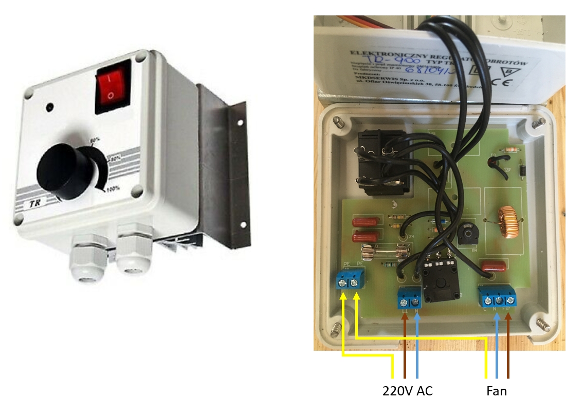

    Since I do not want to mess around with high voltages, I decoupled the 220V circuit completely from the Arduino side. The way of my choice is a ready-to-use speed controller for 220V fans with a potentiometer, which I connect to an RC servo.
    Here is a picture of the speed controller box that I got from ebay. It is capable of handling 900W, which should be more than enough also for really big fans.

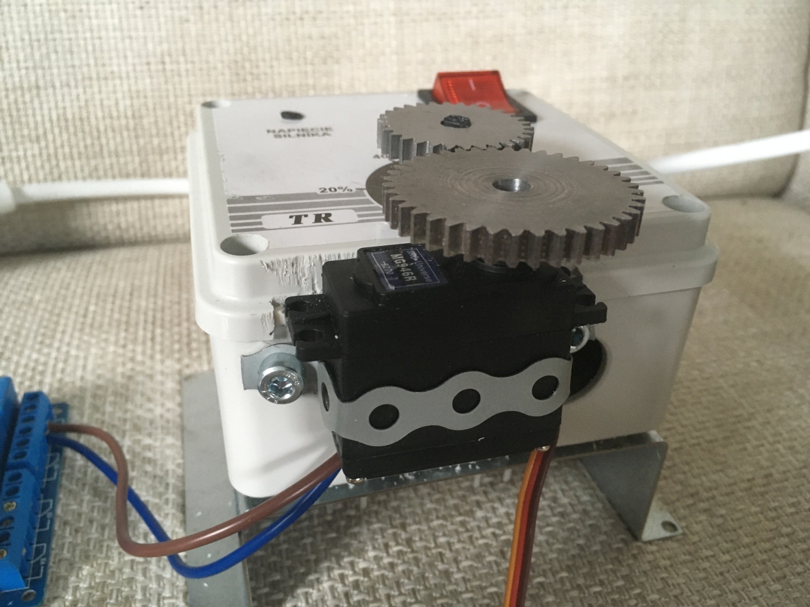

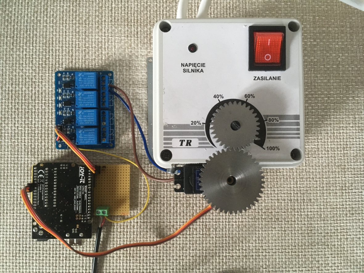

    I replaced the turning knob with a cog, put a second cog onto an RC servo, and mounted the servo to the outside of the speed controller box. Here is how this looks like.

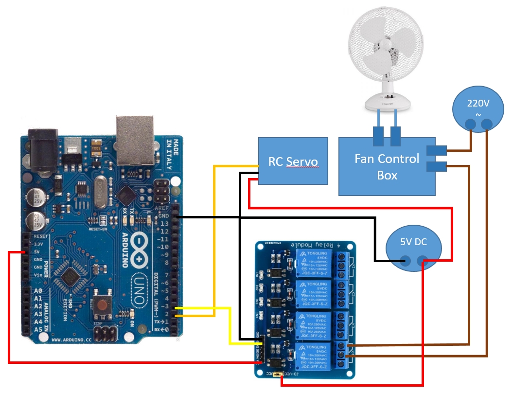

    In addition to the servo, I use a relais for powering the speed controller only when the Game Dash speed value exceeds a certain minimum limit. The reason is that very small speed values result in a humming noise of the fan.
    Here is the simple wiring diagram:

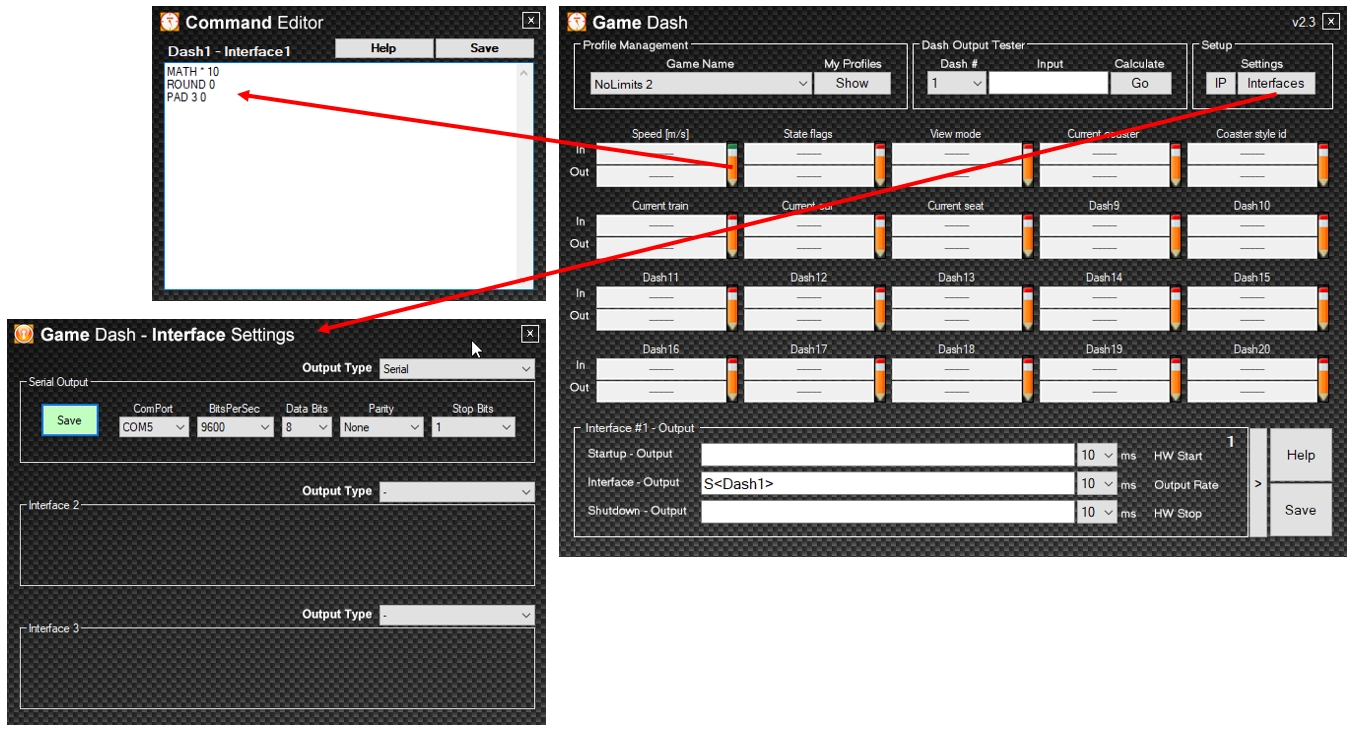

    These are the Game Dash settings for No Limits 2:

    I have also attached the Arduino code. Credits go to @SilentChill, from whom I borrowed the ReadData() function that provides the connection to Game Dash. In fact I took his entire wind simulation code and replaced the MonsterMoto part with a simple servo code.
    If you want to try this setup, you may need to adapt the constants for the servo range in order to align the servo rotation range to the rotation range of the potentiometer.

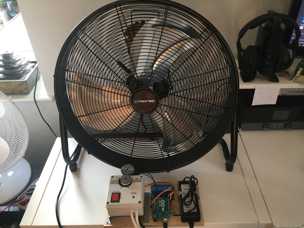

    A week ago I bought a rather big one:
    It has a diameter of 50 cm and a rated throughput of 6.562 m³/h. It runs with 220 V and has 120 W.
    Before this, I was using two 12V Seaflo blowers.
    The Seaflo is really powerful, probably similar to yours. When you position your nose 5 cm in front of it, it literally takes your breath away.
    My current big one does not have this effect, but I like the wide field of wind that you get with it. And with a distance of about 1 m it still produces a considerable storm.
