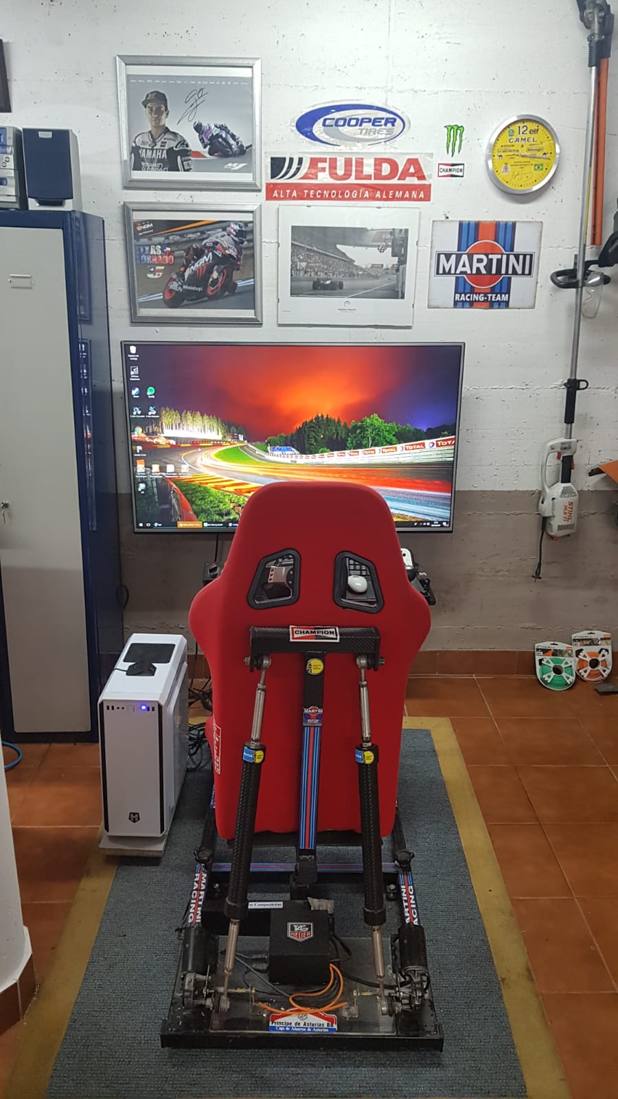

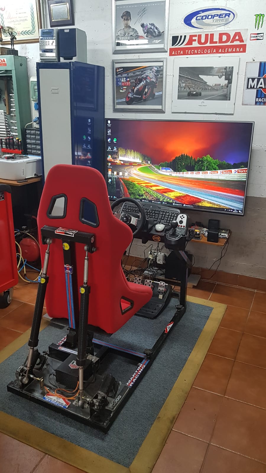

    My story started several years ago. My father and I, created a 2DOF simulator with Arduino. Back them, we used the software XSIM and it was working really well until a couple of years ago, that the software started to give more problems than fun-time. Here are some pictures of the SIM:
    Sadly, my father passed away last year and as a personal project, I decided to make the simulator work again.

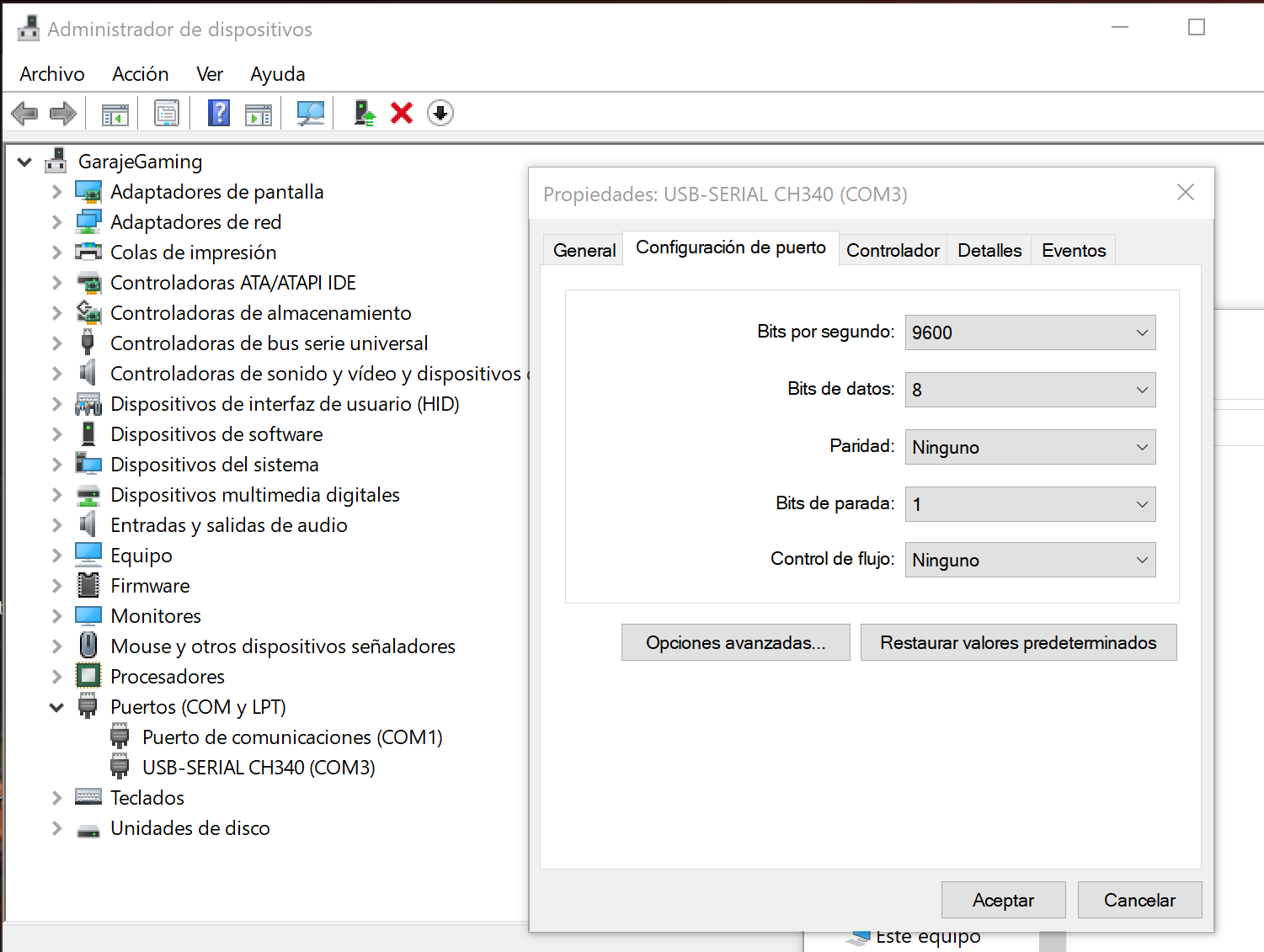

    The drivers and the configuration of the Arduino looks like this:

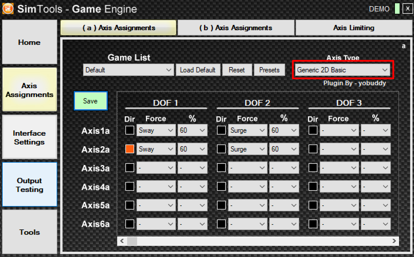

    Based on the setup guide, I configured the 'Interface Settings' like this:
    And for the Axis, I used Generic 2D Basic preset:

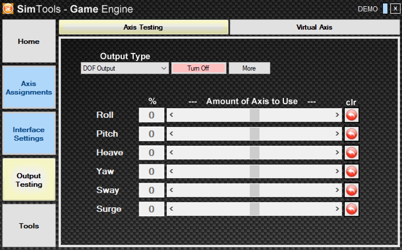

    When I click on the 'Output Testing', I am able to connect to the DOF but when I move the axis nothing happens...

    First off with the current version of SimTools it is best to use English Local for the language settings: https://www.xsimulator.net/community/faq/simtools-language-setting-bug-change-to-english-local.233/
    For SimTools 2 in the Interface Settings instead of axis defined like this <Axis1> it now has designate grouping for a or b for each axis assignment, like this <Axis1a>

    So then the interface output should be L<Axis1a>R<Axis2b>?
    Regards!
    21,915
    153,101Coins
    +11,117 / 56 / -2
    No, the interface should be L<Axis1a>R<Axis2a>

    hi, try to set bits per sec to 9600 and do the same in device manager com port
