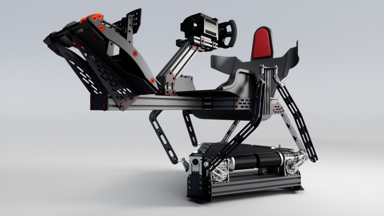

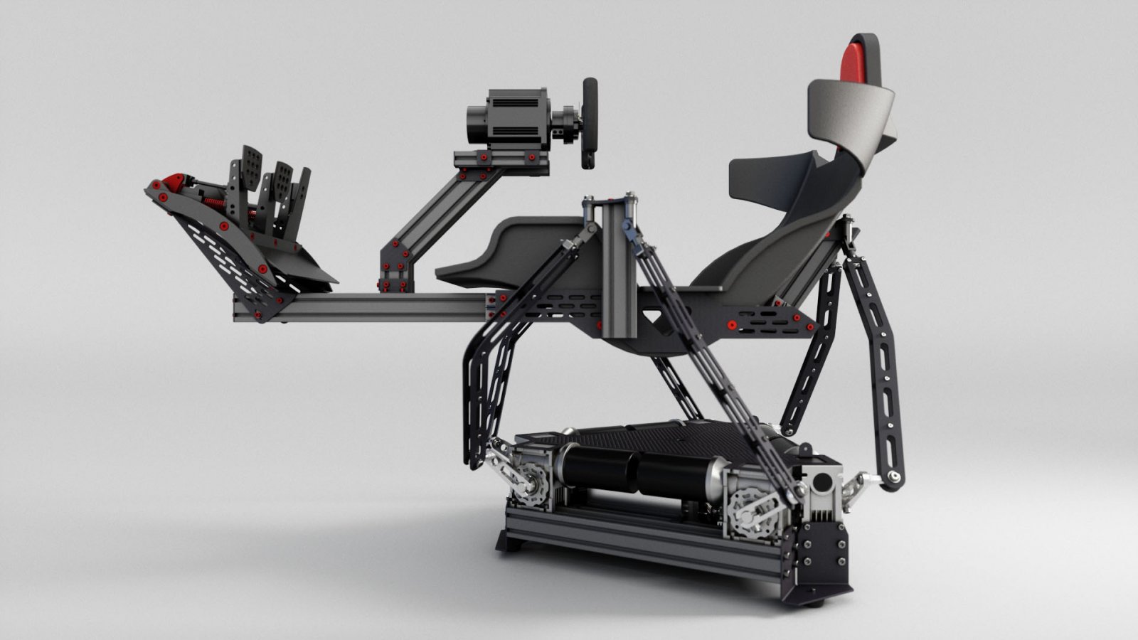

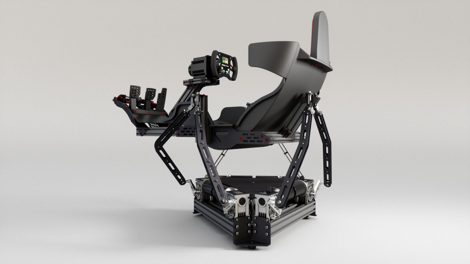

    Some design changes during lockdown 3 incorporating an f1 style seat

  4. RacingMat
    2,234
    21,102Coins
    +2,095 / 21 / -2
    great!
    don't forget the dead pedal to rest your left foot
  5. XaviAlonso
    XaviAlonso Member
    Dec 10, 2015
    30
    España
    103Coins
    +7 / 0 / -0
    Amaizing, but, you considerer when the sistem go forward and declined to front plus your weight dont fall ? I think plus inertia's the leverage are a little close to the limit.

    Nice render :thumbs will likely require outriggers for stability, or just fix it in some manner to the floor.
  11. early_m
    early_m Active Member
    Jul 28, 2016
    346
    Chelmsford
    905Coins
    +362 / 5 / -0
    Yes there's only so much a 3D model and calculations can tell you. Will build it and combat any balancing / stability issues by incorporating a solution into the next revision
