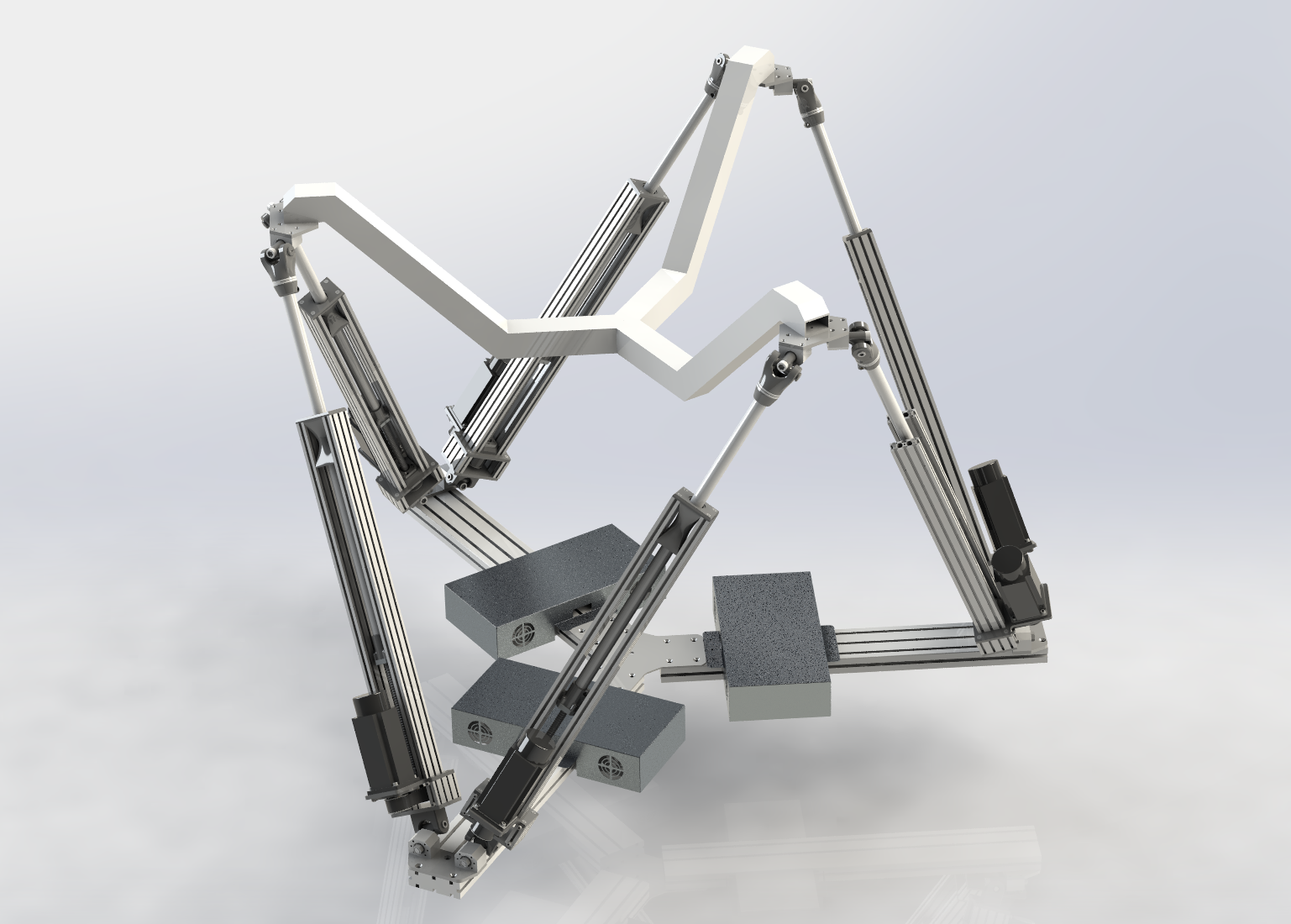

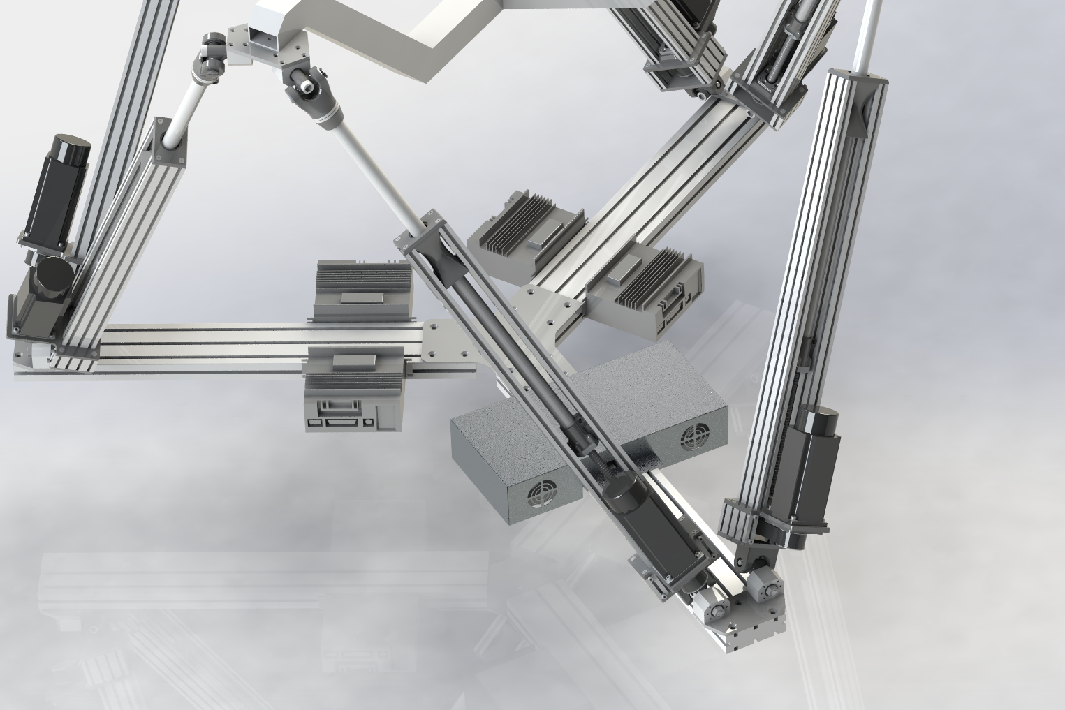

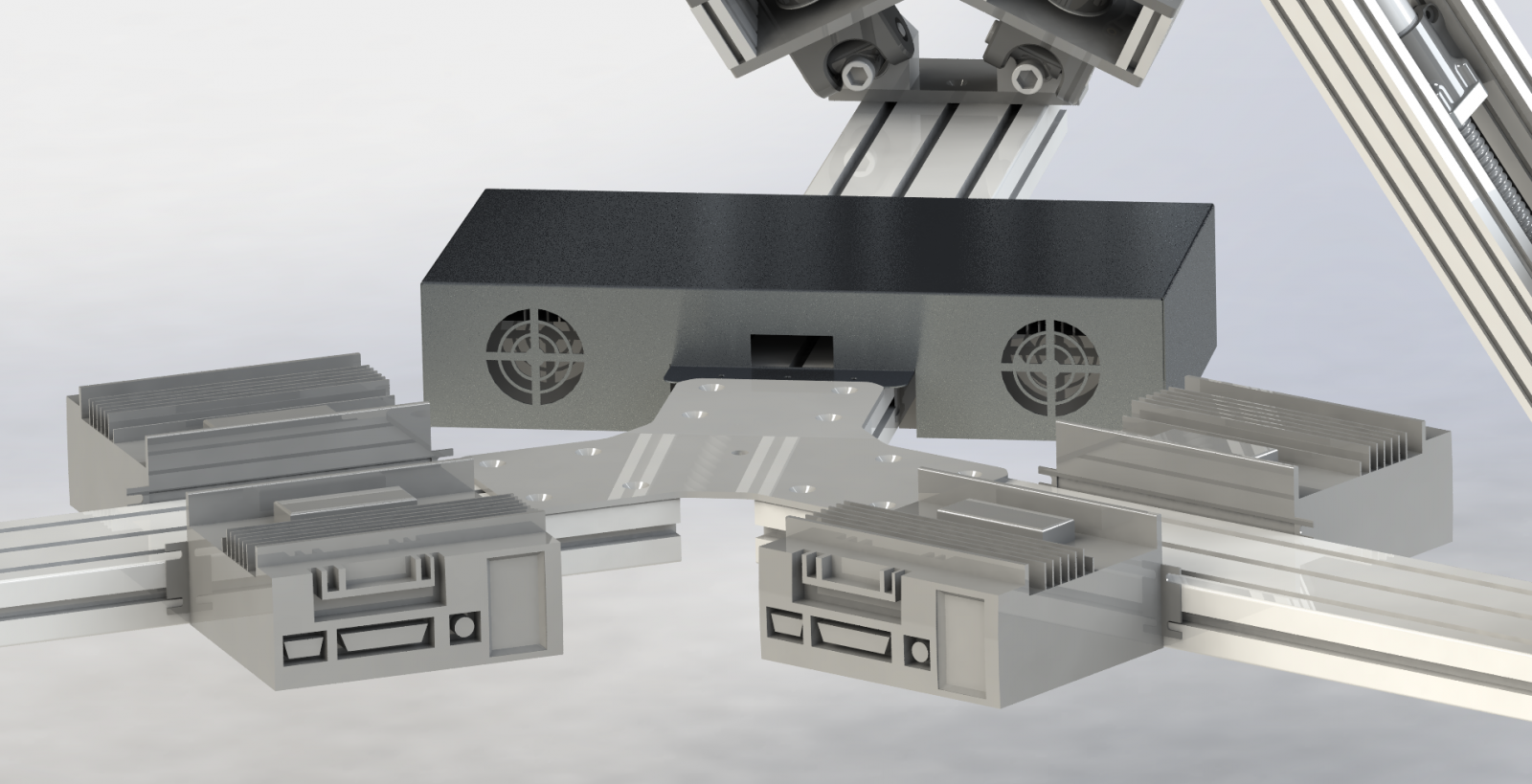

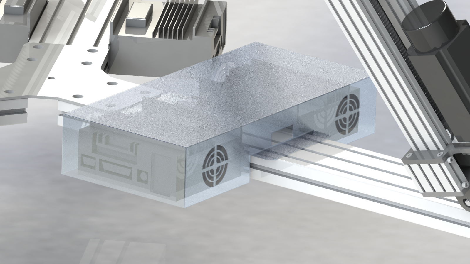

    Hi @Dirty !
    Now in this thread, as I am doing my research on the full parts I need while I wait from vendors to deliver.
    Do you think having the servos UNDER the rig would have problems? I think having shorter "noisy" cables would help... right? I would replace the power cables to the motor for shielded ones, but I think shorter would also help...
    Maybe an enclosure grounded to the motor ground could work/help?
    And another "casing" as a guide for cables with aluminum metal duct (like @Dschadu mentioned)
    I did this quick model to explain...
    Let me know. Also maybe @Thanos could give me some feedback if time permits :)
    I wonder if Aluminum is a good shield. I google it but could not find that much straight information about it...
    Thanks all!
