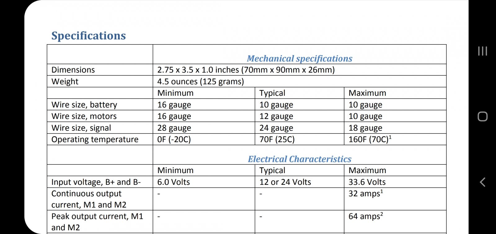

    The sabertooth drives will have a max current draw. Use that to size your wire. Add a little buffer for safety.

    Sorry, could you tell me, in that table am I looking at the 'Maximum amps for
    power transmission' column?
  4. cfischer
    Sep 7, 2015
    398
    Colorado
    2,837Coins
    +275 / 1 / -0
    No for chassis wiring. These numbers are for steady state. Short bursts of current above these numbers should be ok. If you over load the wire the result is heat. Too much heat and you get fire.

    I've just checked the sabertooth spec sheet and handily they've included this info

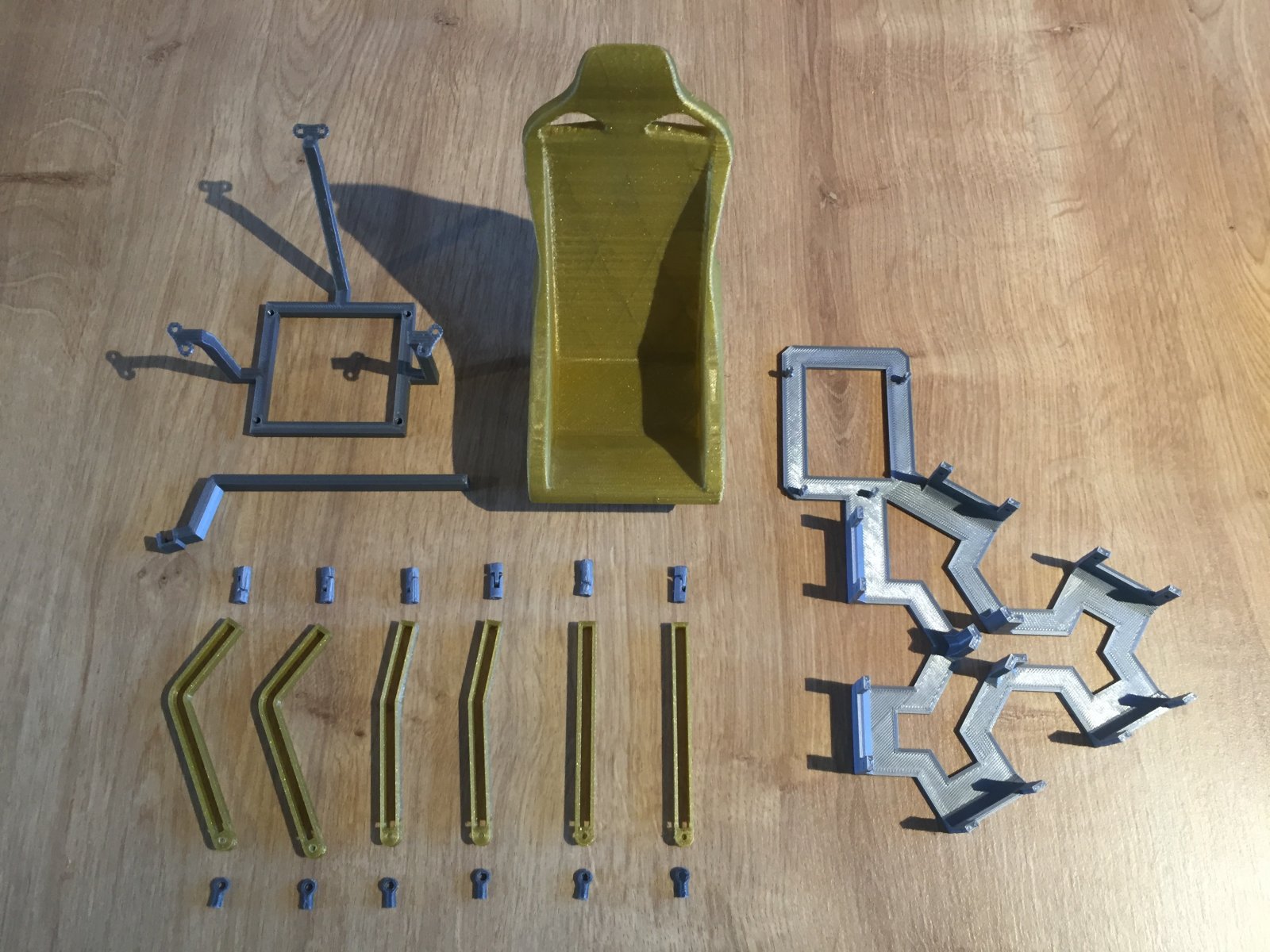

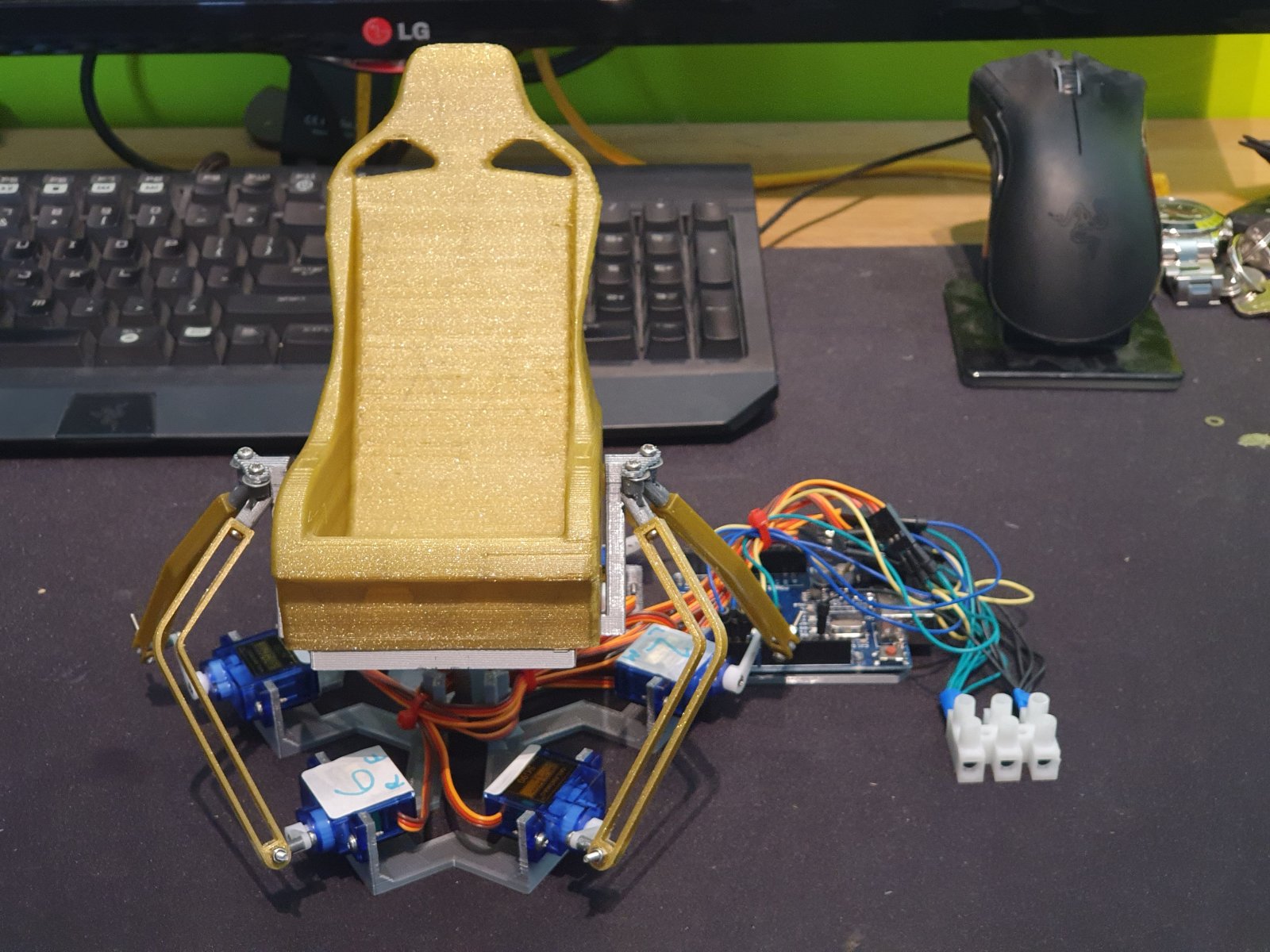

    Made a 1:6 scale model just for fun and to experiment with setting up the DOFs.
    I'm thinking of setting it up so that pitch/roll is used for acceleration/cornering in order to have the feeling of gforce. The sim will be used with VR. Anyone got any experience of this?

    Looks great !
    What board did you use to control 6 motors ?
    I find tilting the sim to simulate feels a bit fake
    Surge and sway feels more relaistic imo
    With sim tools you can edit the dofs so you can add it bit of pitch and roll to any axis you want

    used a single ard uno.
    Thanks for the info on pitch/roll.
    Ideally I'd like the initial surge to happen and then the sim starts to pitch to continue the feel of acceleration - not how you'd do that or of kts even possible?
    When you say edit the dofs, do you mean simply change the values so, for example, surge is slightly pitched instead of horizontal?

    my susggestions
    firstly get each dof working as it should
    for surge get the rear 2 actuators to drop a bit and the front 2 to raise a bit
    i am not sure you can get the motion to move first and then apply a different motion - however in my experience the sim is always moving when you run a powerful car
