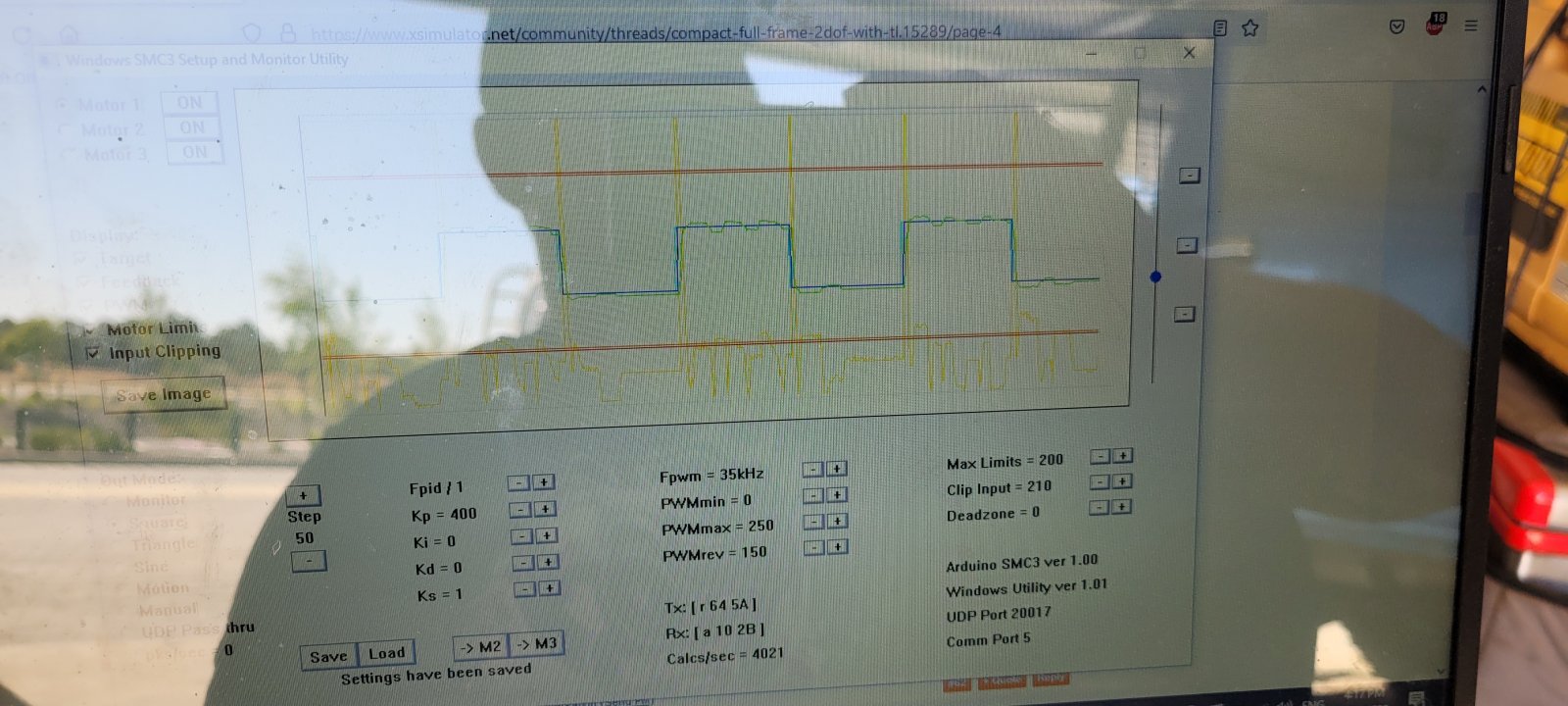

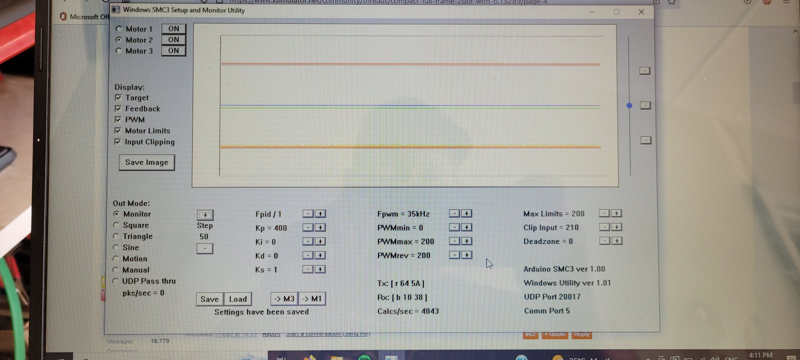

    Try increasing kp to 400 and dropping PWmax and PWrev down, say to 200, then rerun the test and post that.

    Yep will do, came across another problem which may contribute.....motor wires to number got bloody hot,
    Will upgrade the wiring to the motors tomorrow morning try your suggestion and report back
    Thanks for your help mate, greatly appreciated!!!!

    When you do can you please also report at what value PWmax starts to move the motor, as I am just taking a wild guess.

    Ok will do, have upgraded the motor wiring and going to redo the pot wiring aswell and mount the control box properly to eliminate any possibility of errors there,
    Also should my pwmrev match the pwmax?
    And what frequency would you recommend?
    Cheers

    For testing the Fpwm at 35 should be fine.

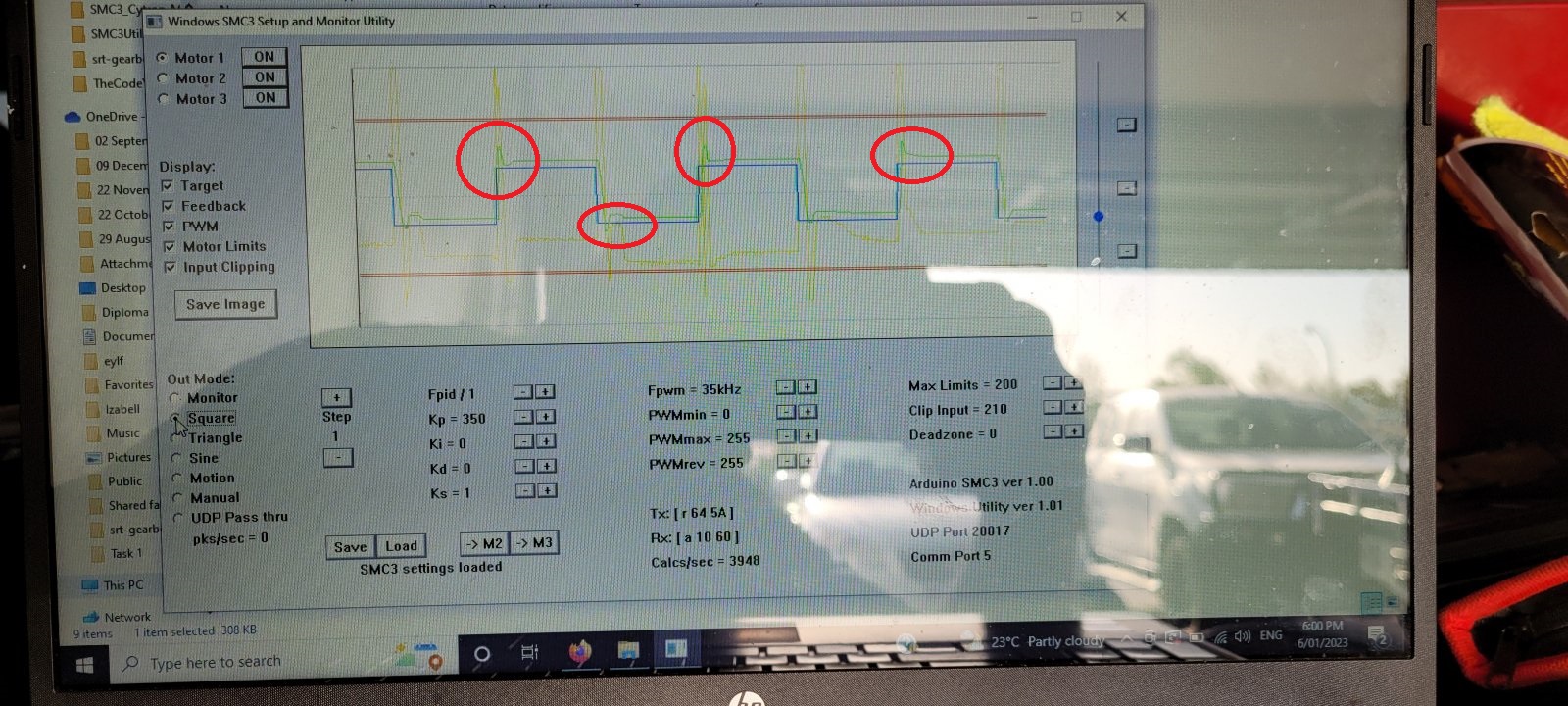

    The PWMrev value depends a bit on how the hardware reacts, it will likely end up as the same or a bit less than PWMmax, but tuning this stuff is all about watching the graphs and seeing how the rig responds. For example, in your earlier posted picture there are clear overshoots, which indicate SMC3 settings need to be refined:

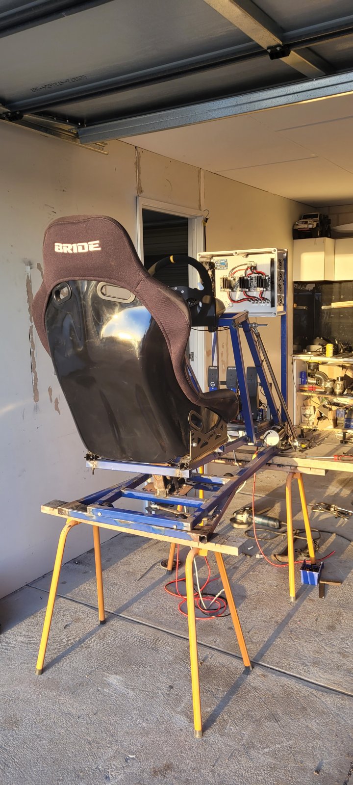

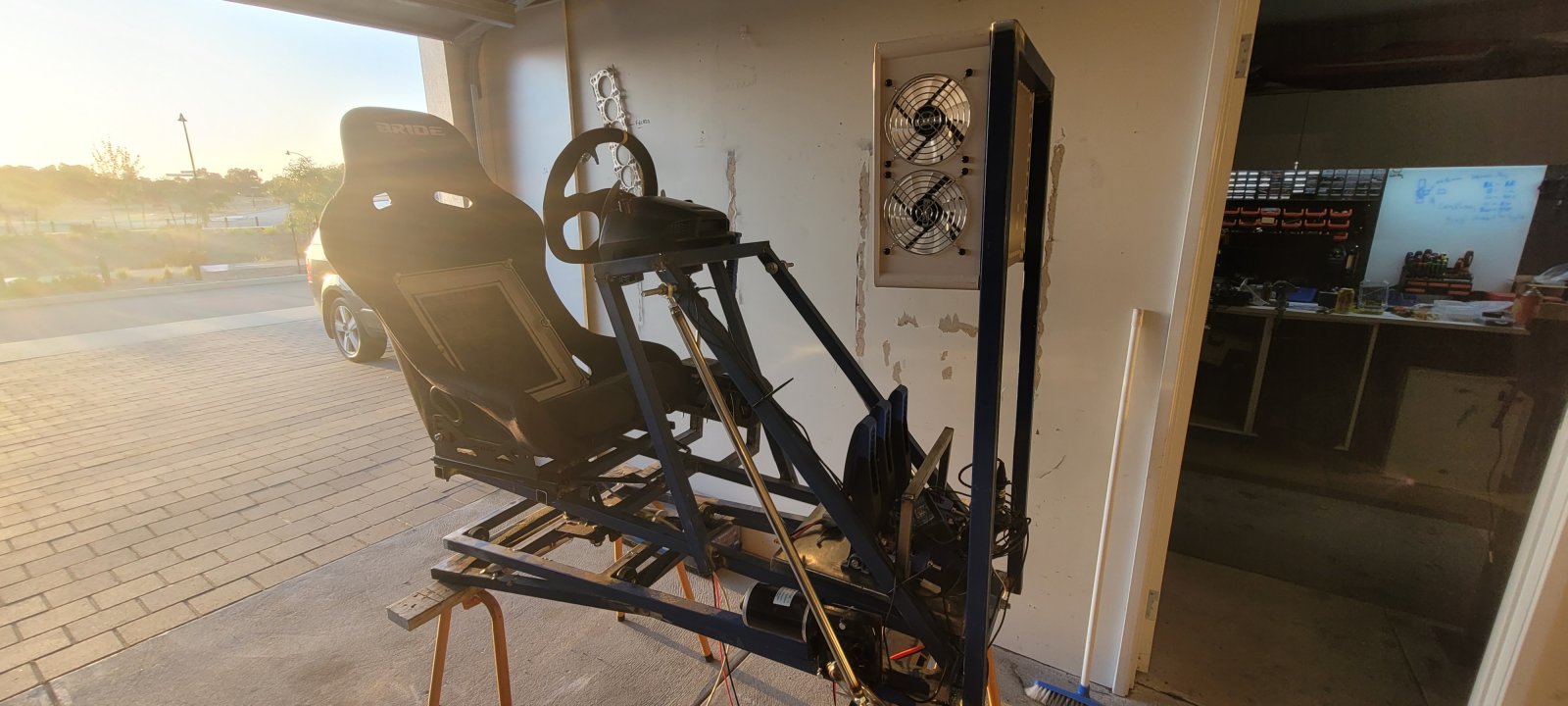

    @Rav3n87 WOW!!! 3D PRINTING GENIOUS!! is the seat 3d printed as well? BRAVO SIR! BRAVO!

    Haha cheers @Rodeo5150 if your interested in any of those projects they are from Lebois racing @Lebois

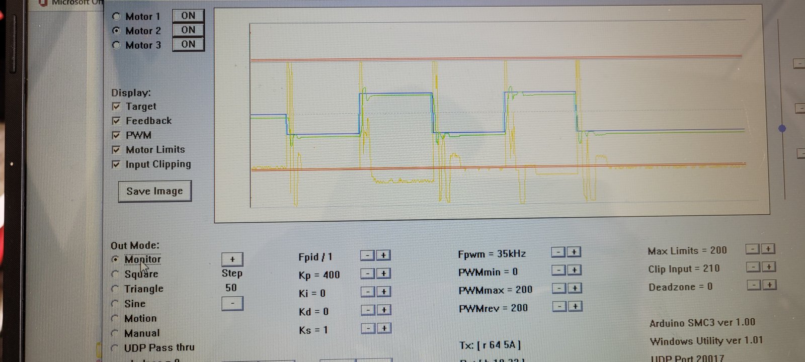

    Ok sooooo here's some videos,
    Seems no what I try it's crap
    I'm starting to think these gearboxes are garbage and I need the 50:1 or 60:1s expensive lesson possibly but I guess shit happens,
    Motor 1 on right side (sitting in sim)
    Came up to level at pwm 50
    Motor two was closer to 80, I believe because of a little extra weight on that side
    21,723
    152,051Coins
    +11,063 / 56 / -2
    Have you tried a smaller lever CTC, I see you have the holes drilled for it?
    Left motor seems way too soft, what are the SMC3 settings and square wave reactions for just that motor?

    Ok still a little wobbly and the graph shows the wobbles
  13. noorbeast
    21,723
    152,051Coins
    +11,063 / 56 / -2
    Motor 1 is closer but both look to need refinement.

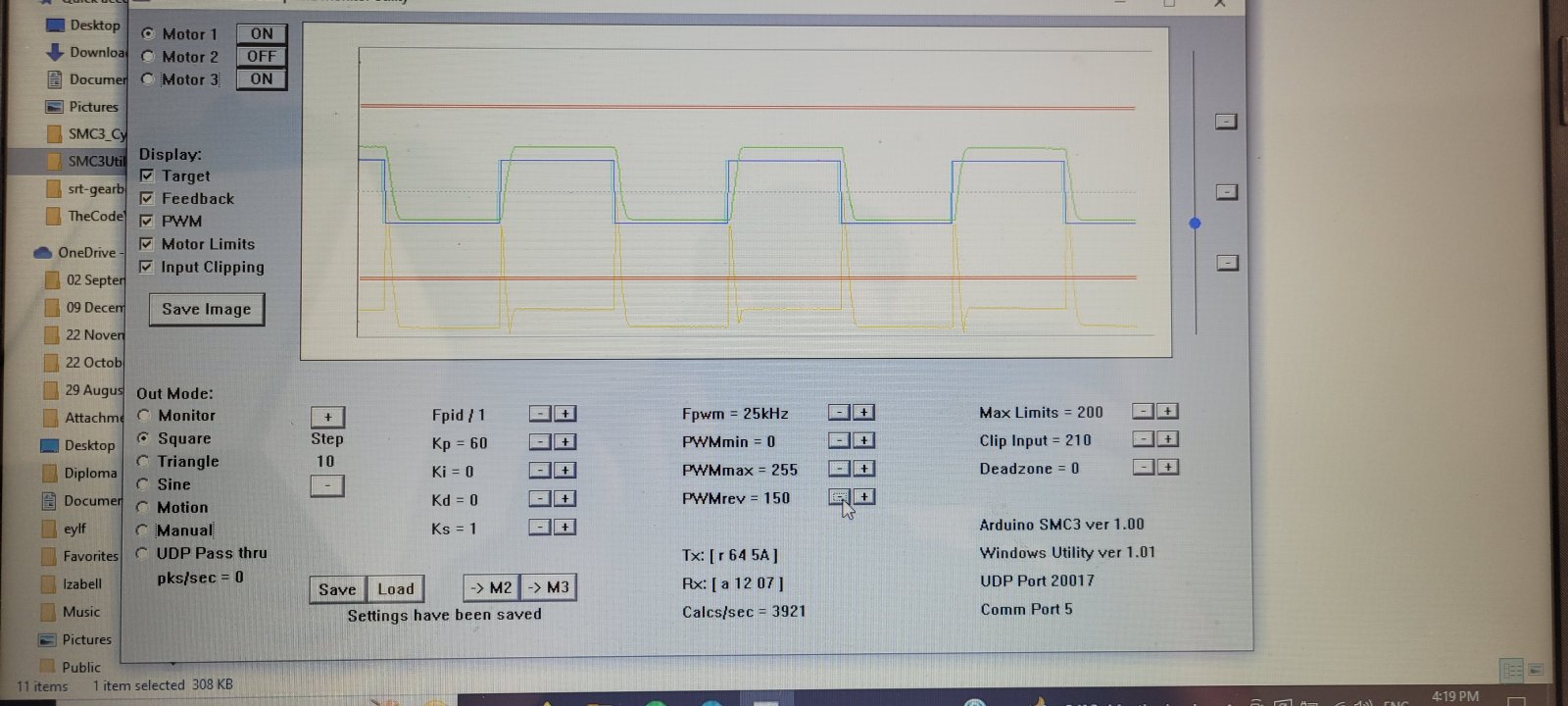

    Had a small spot of luck maybe,
    Are you able to have a look at the graph, I can't turn the kp up any higher than 60 otherwise the issue comes back,
    Not really tracking the graph to well on the down stroke
  19. noorbeast
    21,723
    152,051Coins
    +11,063 / 56 / -2
    The down stroke has mass and inertia, so much harder to control.
    At what PWMmax value does the motor start to move with these settings?
