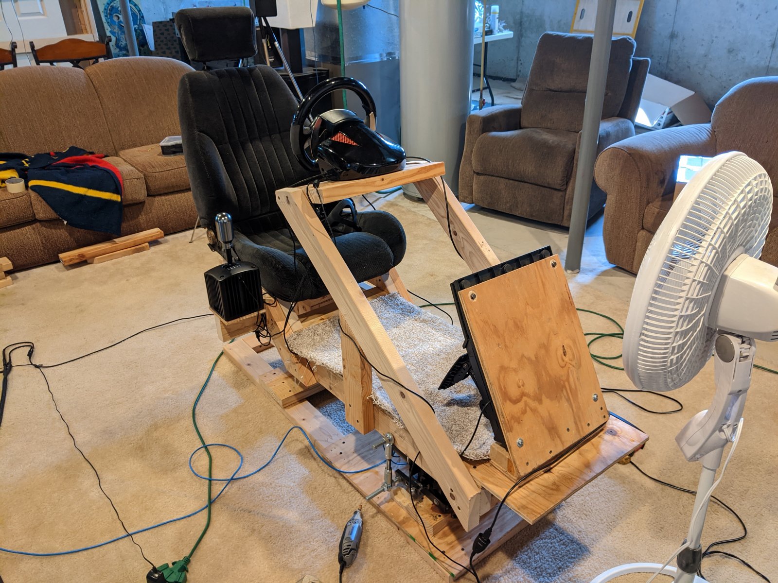

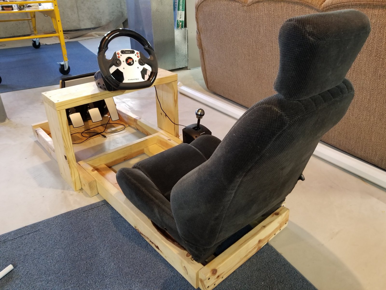

    Hello all! I am finally getting around to starting my build thread for my 2DOF motion sim. I've always loved racing games and since the N64's Top Gear Rally, we've had a racing wheel and pedals. My brother and I went in together on a Fanatec CSR wheel and pedals/shifter to play on Forza 4 many years ago and it has held up very well. We built a "rig" to play Forza in - the picture below. My uncle broke the H pattern CSR shifter so I upgraded to the clubsport shifter and once I bought an Oculus Rift, I purchased Project Cars 2 and started to research motion sims.

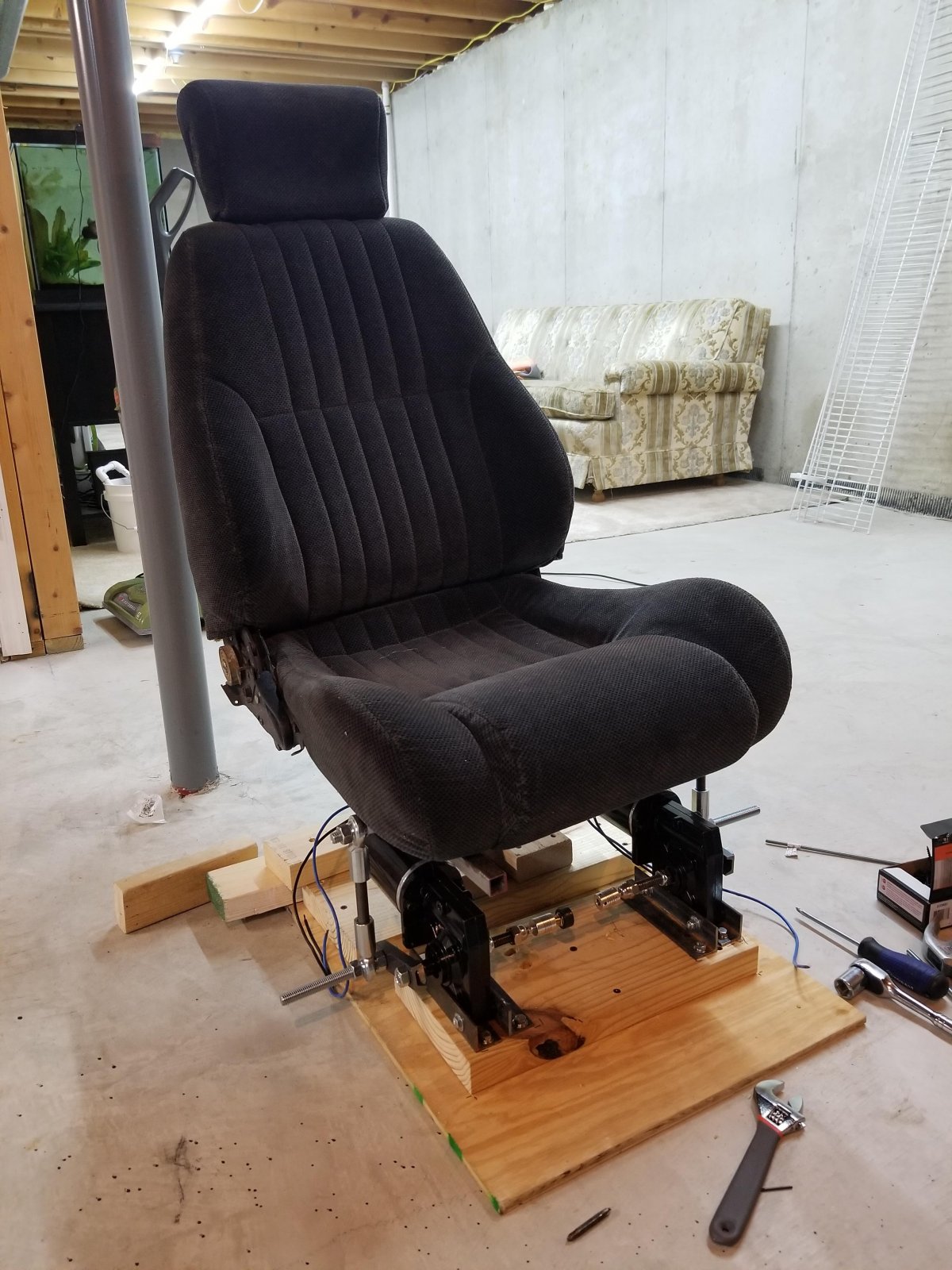

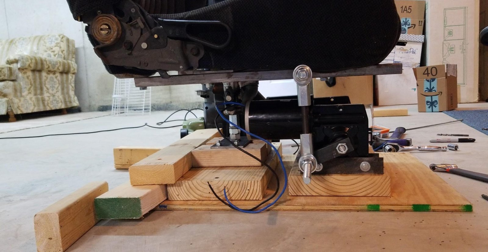

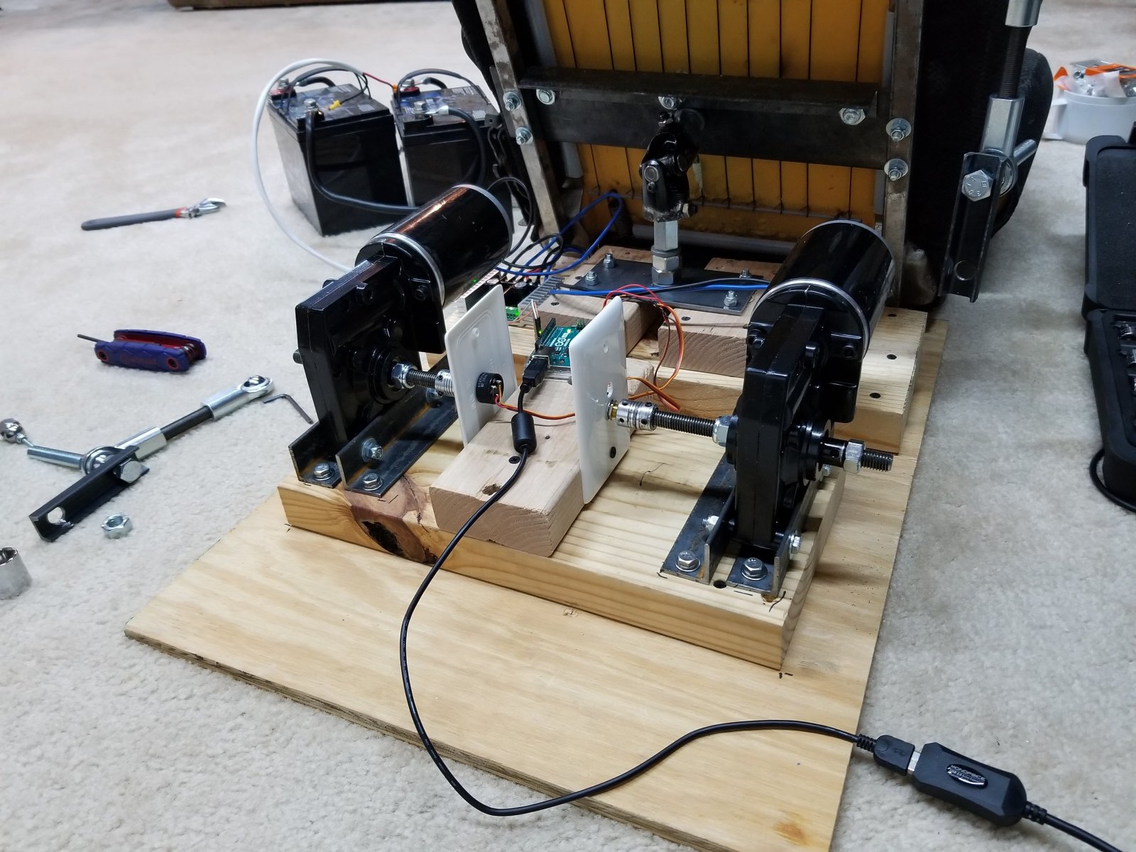

    So it turns out that you can't get much done when you have a puppy recovering from neuter surgery and you also go out of town for Christmas and New Years! That aside, I've made some progress on the build. I am currently using a U joint off Amazon that I secured with bolts. I am either going to have to add a panhard rod or rethink my attachment scheme.
    I started working on the electronics side preparing the arduino and sabertooth. I was having trouble getting the computer to detect the sabertooth with the DEscribe program until I ran across a post in a thread (help I do not know what to do Arduino + sabertooth) by @auryza. I grabbed a different cable and it worked like a charm! It turns out the microUSB cable I was using wasn't high enough quality. I probably won't get much more done tonight but I hope to have something moving by the end of the weekend.

    I was able to get everything wired up tonight and got the motors moving in SMC3. I am a little confused about that though because the motors wouldn't turn when in Monitor out mode but it would in other modes.

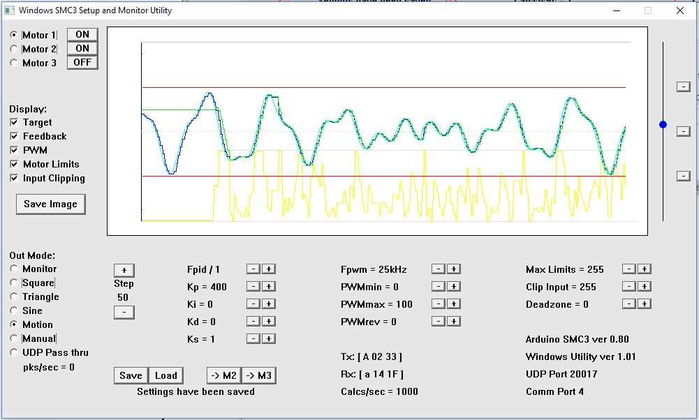

    I saw that thread and I haven't updated to 2004 yet. I had the DOFs in the assignments not at 100%, that helped but using the sliders, it's still twitchy and the motors aren't moving at the same time.
    Below is what both motors look like in SMC3, which I think is acceptable?
    I guess I will try tuning the DOFs starting with surge in pCars tomorrow.
  16. noorbeast
    21,594
    151,227Coins
    Kd = 400 does not look reasonable, SMC3 should be fully sorted and behave as expect before moving on to SimTools configuration.

    I had Kd at 0 before and it was nearly an identical sine wave. I tried to find what the wave should look like but I could not find any posts with screenshots of a "good" tuning. I have read your layperson PID thread and my sim seems like it reacts perfectly in SMC3 but I don't know what "perfect" is either.
  18. noorbeast
    21,594
    151,227Coins
    I would expect Ki and Kd to be 0, Ks 1, try the steps in the guide:
    8. Set Kp to about 400
    10. Do the above for each motor

    I've done those steps in the guide multiple times, each time it has come out to look like this:
