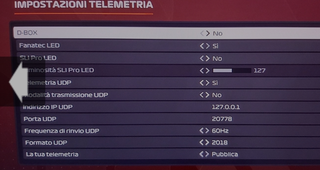

    Only "pitch" works, ive tested all other functions under all UDP types and nothing works except Pitch when using Legacy UDP. I'm currently using 2DoF, PT Actuators. Any help?

    i attempted to calibrate the tuning center in monza, still got the same result. the tuning center is gathering data in all DoF, but my actuators do not respond to anything except "pitch" values. ive tried isolating each DoF in the axis assignments, only pitch is responsive

    UDP FORMAT legacy mode NOT 2020 and f1 2020 dx11

    I'm running DX11 and Legacy format, calibrated tuning center in monza, still doesnt work. i cant figure out why tuning center is displaying values accross all DoF, but those values arent transmitting to the actuators, aside from pitch

    Have setting like this?

    Have select 2018?

    Yes select 2018
