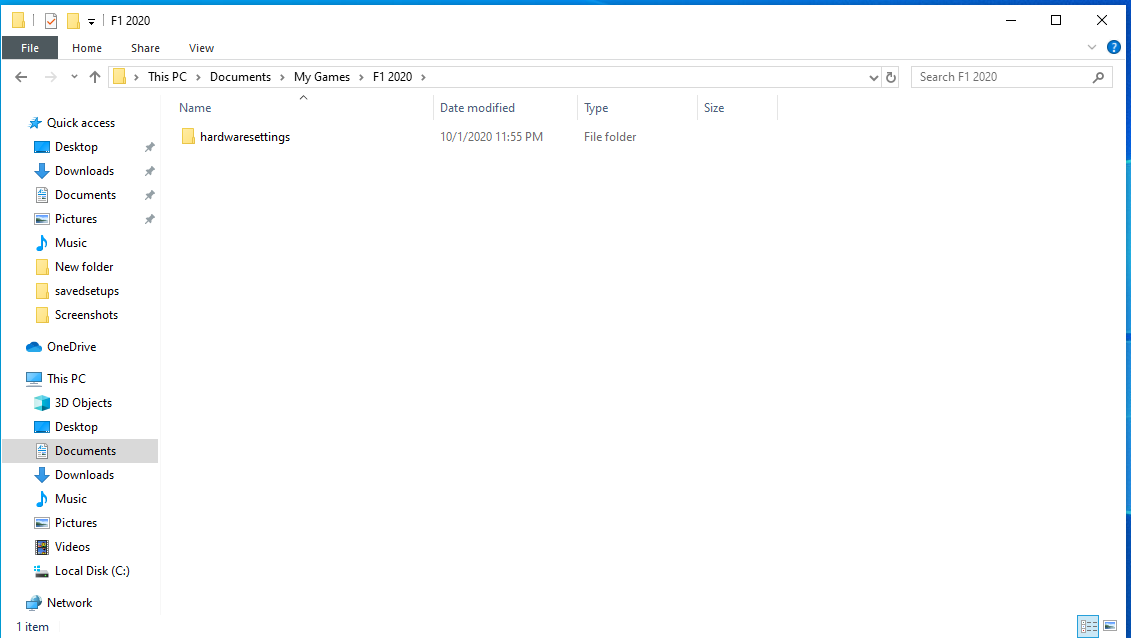

    hello, so i already finish my short grand prix (3 laps) and try to patching after that, but still not patched yet. I check document/games /f1 2020 nothing in the folder except folder hardwaresettings. What kind of file should be generated when I play one race to be used by simtools to patch? Is it maybe because the file not generated even after I complete the race? thankyou.

    if I'm not mistaken once the game is patched in that folder, no file is generated. just turn the engine green and the manager is enough.

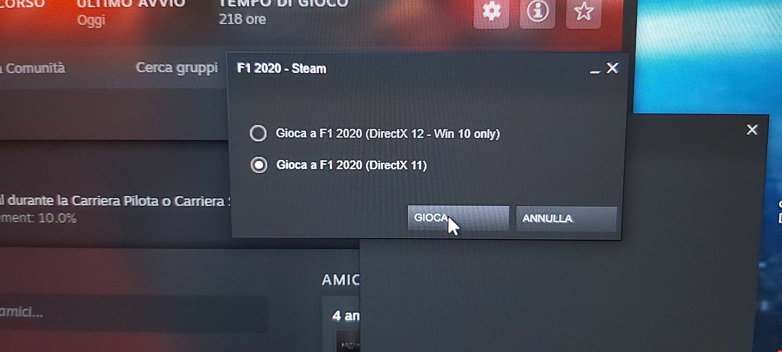

    It only works in the direct x 11 mode of the game and telemetry in legacy mode. Check this out.

    Hi Bruno and good morning everyone. I abandoned this game for a couple of months, not being able to run simtool and simhub at the same time, despite Bruno very patiently trying to explain and re-explain how to do it. I don't like giving up and now I'd like to try again by following these instructions that Bruno posted.
    1) in simtool I remove the pach for F1 2020
    2) In documents / MyGames / F1 2020 delete the hardware settings config folder.
    3) leaving off simtools and simhub Start F1 2020 and take a ride in this way the hardware settings config folder is recreated
    4) In simtools from Gamemanager I make the game patch
    5) Edit the simhub file Simhubwpf.exe and change in the telemetry options of the F1 2020 game following Bruno's instructions
    Is it correct to do so?

    Hello, yes perfect !

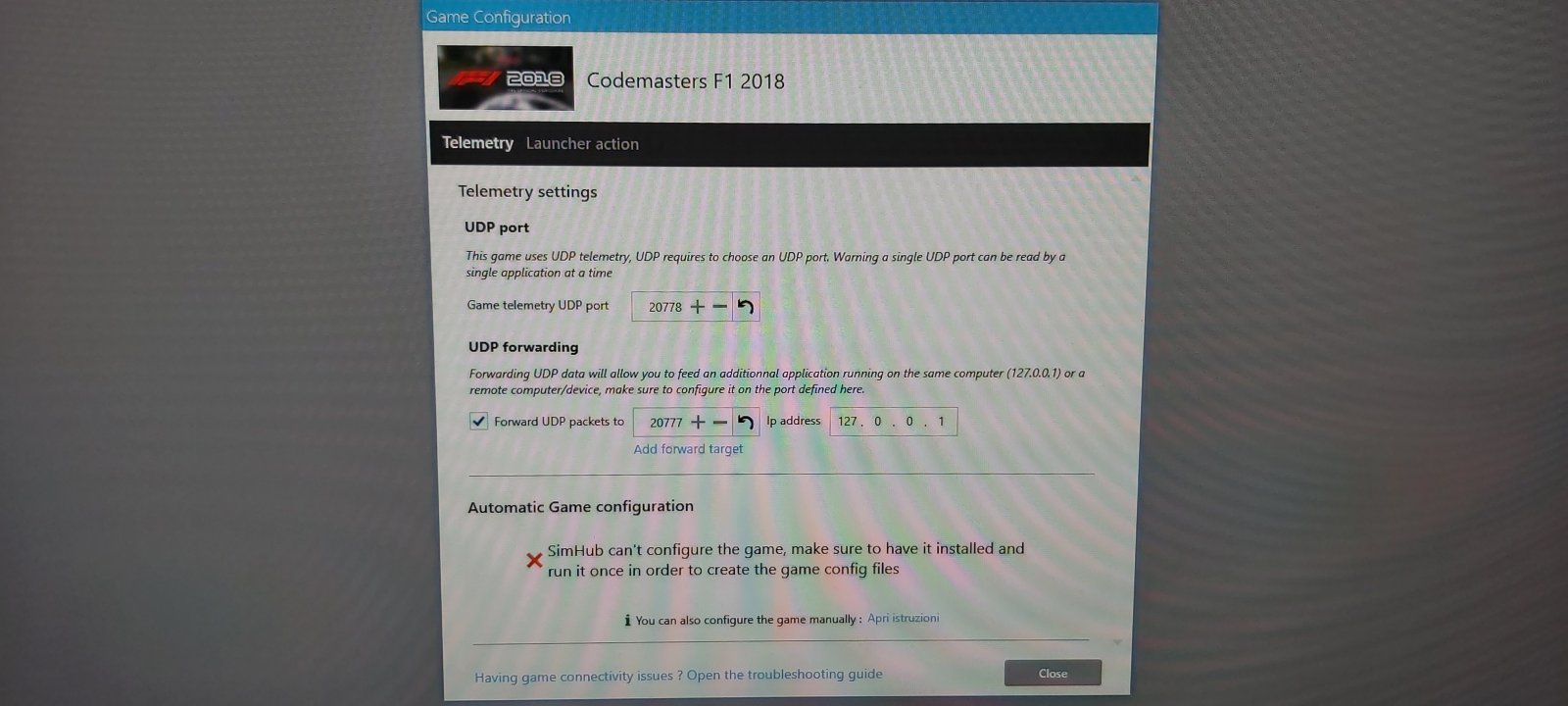

    thanks for alla information.
    i followed alla istruction of Bruno.
    simhub and simtool work togheter only select in simhub f12018(game).
    i try with same setting with select f1 2020 on simhub but not work.
    i don't undestand, a voi funzionano anche selezionando f12020 su Simhub?

    I must see. If i have last version I select f1 2020 on sim hub and it must work? With same parameters (f1 2018 telemetry on game and public)?

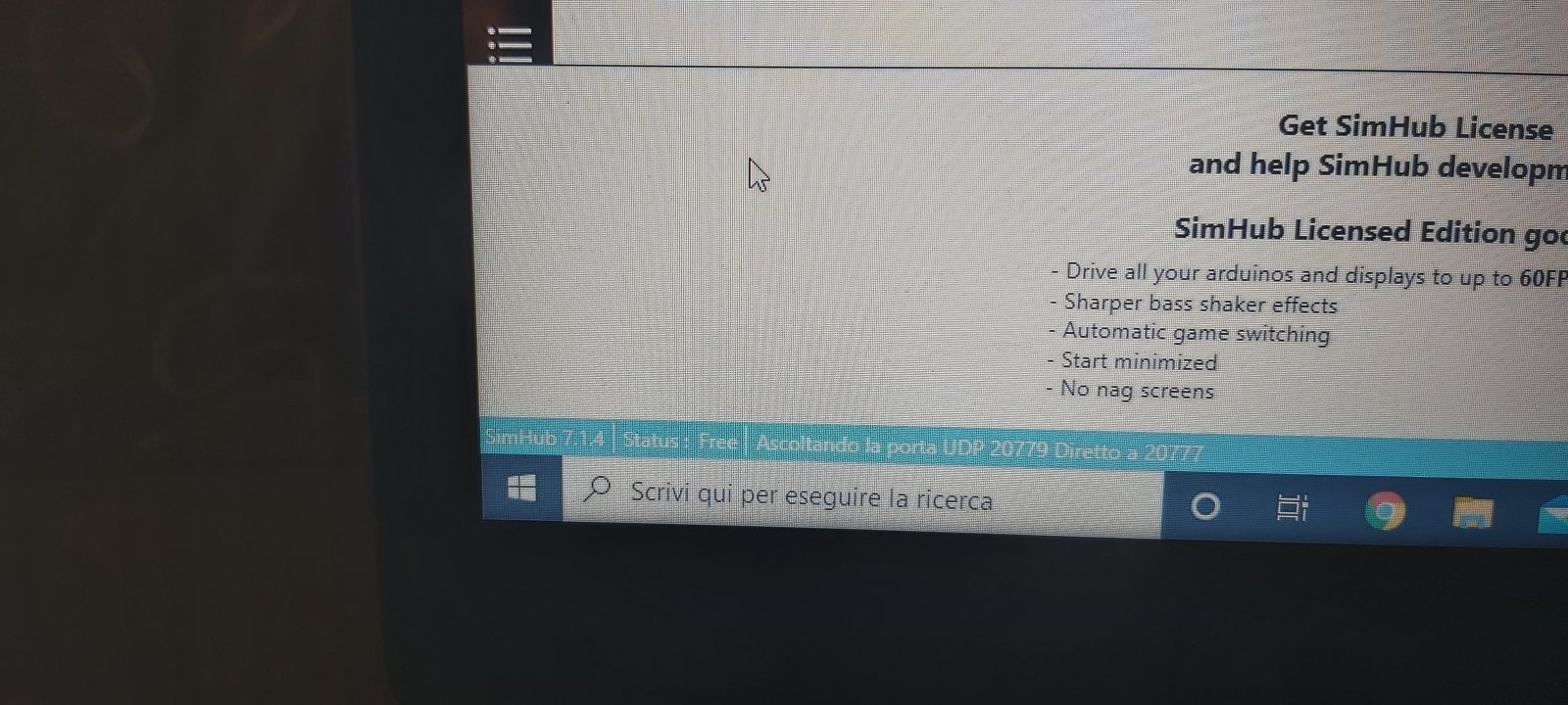

    This is version of simhub

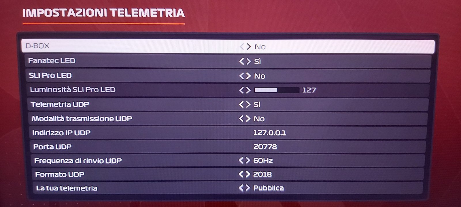

    to help everybody., im posting simhub configuration and telemetry on game to make simtools and simhub work together.
    copy file attachment on simhub installation folder and after that set all parameters like photo
    have fun

    I made these settings and everything works without problems

    You must made setting on simhub to f1 2018 not f1 2020. If you want setting same settings also f1 2020 on simhub
