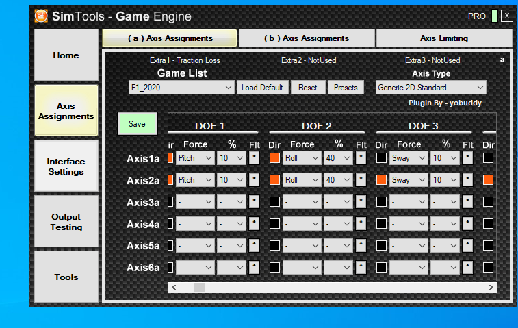

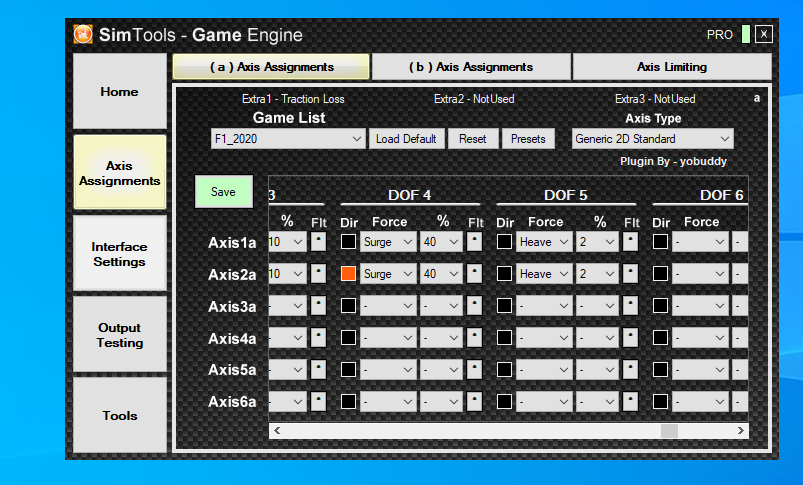

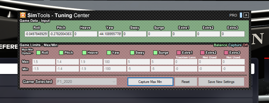

    Hi all
    I installed the plugin for F1 2020 and I correctly set the telemetry in the game, but I have a question in the tuning center (values calculated by the game) I have these values:
    Game Engine values:
    Question for those who have tried and have no problems, are my values correct? because from my point of view I feel little roll, but when I touch a curb I fly from the seat =).

  10. yobuddy
    51,679Coins
    +5,204 / 19 / -0
    It depends on what sim you have a bit, but maybe give it a try with just surge, sway and heave to start with.
    Surge and Sway at 50% and Heave at 10% or so.
    See what you think...

    i tried your settings but i feel that the sim is moving around like no sense.
    btw i have 2dof sim, i'm still trying to set the value correctly.

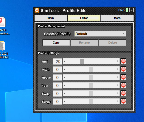

  13. alexdraco
    alexdraco Member
    Aug 8, 2018
    85
    278Coins
    +34 / 0 / -0
    i have heave on 2 and i set on the profile editor -50 because when you touch a curb you fly but once again im flying what i can do?

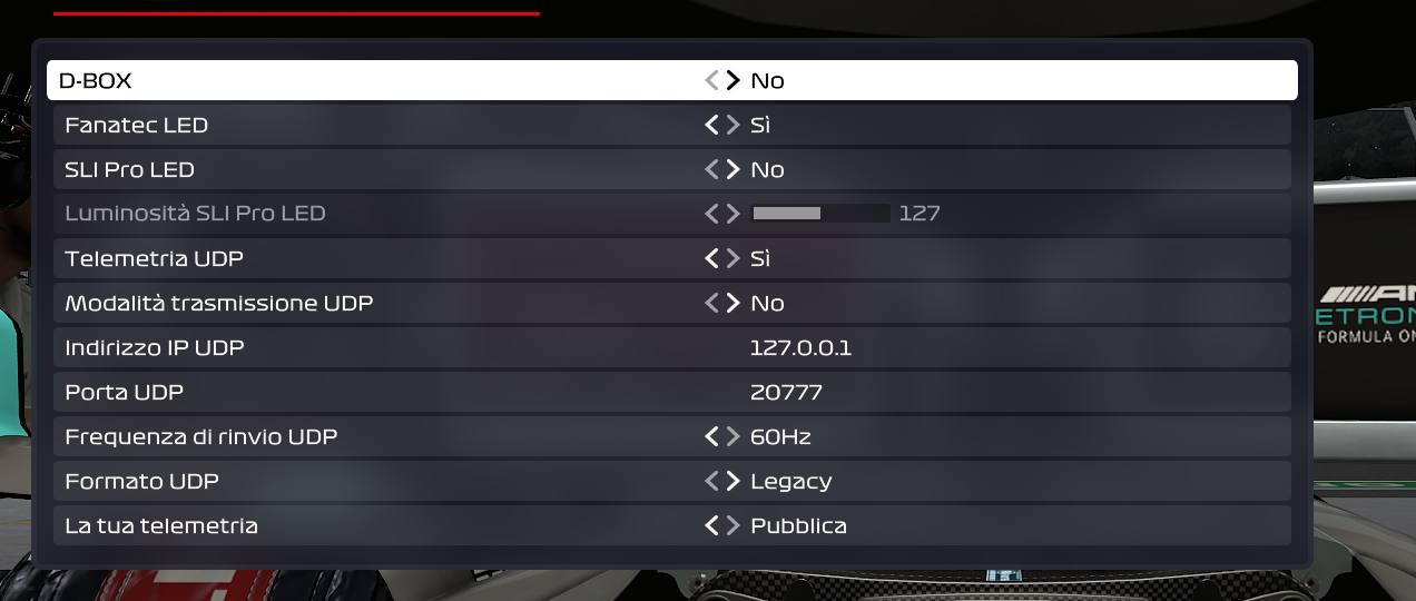

    I have also noticed this, in the single races it is fine but in |My team| there is not motion.
  16. alexdraco
    alexdraco Member
    Aug 8, 2018
    85
    278Coins
    +34 / 0 / -0
    For my team you have run the game on dx 11 and set the UDP format to 2020, for any races (grand prix,online) you have to set UDP format to legacy =)
