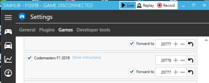

    Ok, now it works, the problem was that I use simtools and simhub, both are on the same port.
    But now, I do not know what to do to make it work 3dof and bass shakers.
    If I change the port for sumhub and add the line in hardware_settings_config, after starting the game my line with simhub port will be removed automatically.
    Any ideas ?

    It does not work, I wrote it with my firts post, I add new line at hardware_settings_config, and when I start the game my new line (UDP2) be removed automatically from hardware_settings_config.
    At game settings we can add only one port, I think it is the problem. Game can't read two diffrent port.
    At other codemasters game, like dirt, dirt rally 2 etc, everything work fine, I add UDP1 for simtolls, UDP2 for simhub and it works, but at F1 2019 it does't work.

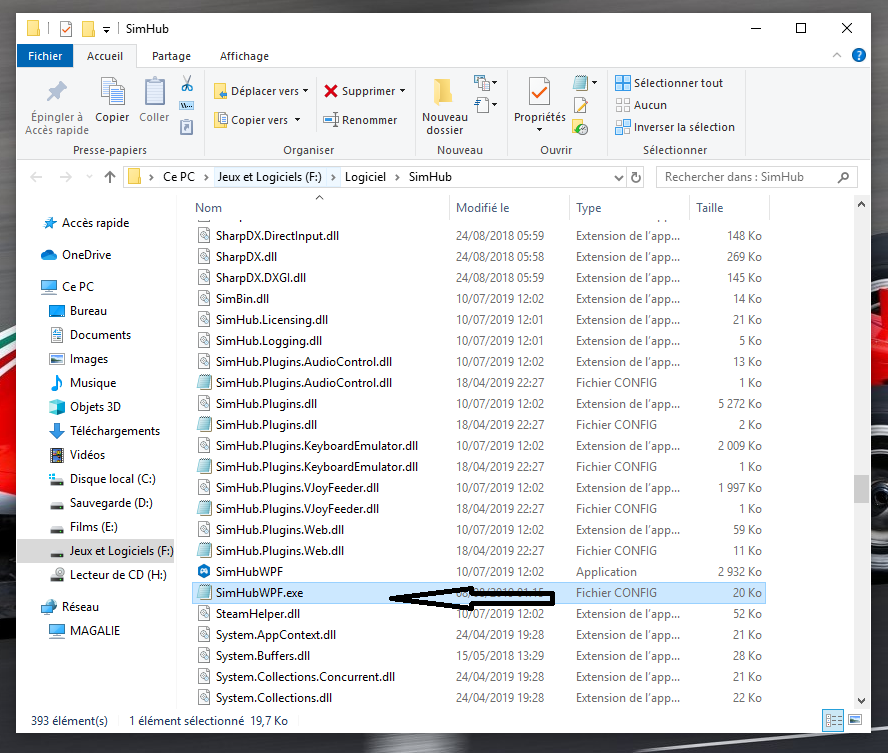

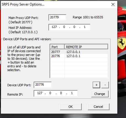

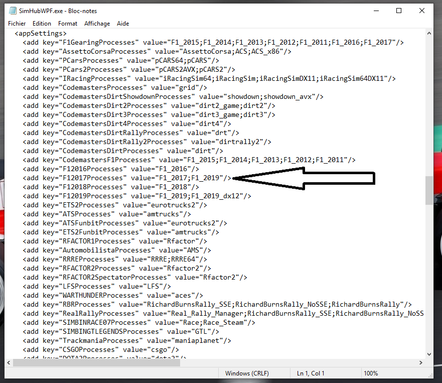

    Hello, I found a software to run simtools and simhub at the same time Sim Racing Proxy Server good guys.
  18. DoubleM
    DoubleM Member Gold Contributor
    Jan 2, 2018
    46
    Amsterdam
    - 23Coins
    +20 / 0 / -0
    Can you explain how? F12019 legacy mode and simhub F1 2019 ?
  19. bruno1210
    bruno1210 schumi06
    Jan 4, 2015
    134
    103Coins
    +12 / 0 / -0
    first you have to start configuring the game are the same settings as simtools except that you have to change 20777 by 20779.
    It is necessary to modify the port of simhub also origin 20777 by 20776, then to open the text file of simhub like the photos.
    To finish open Sim Racing Proxy Server as in the photo and always open simtools first.
