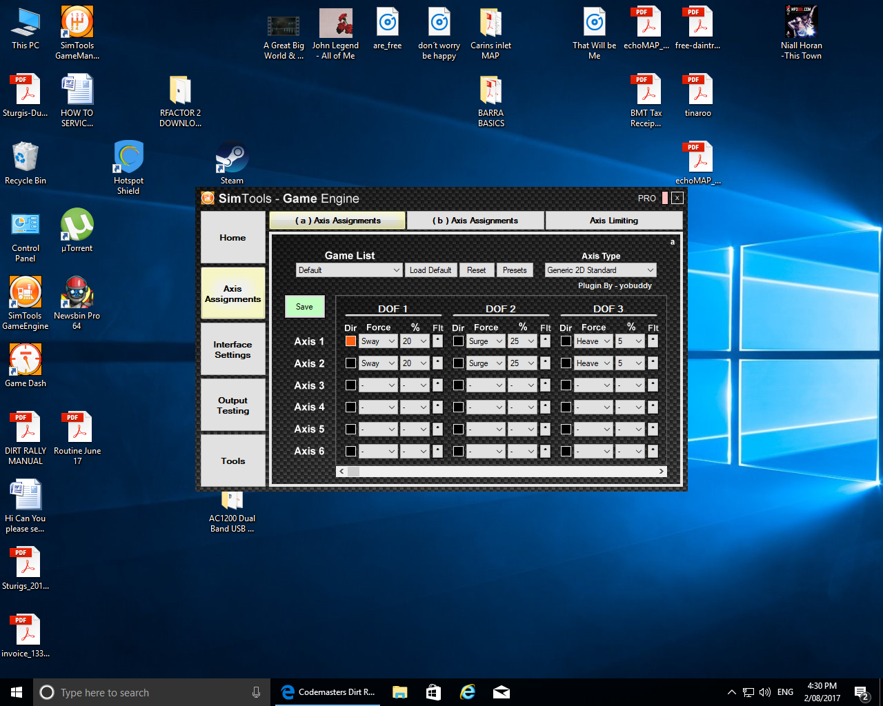

    If the virtual axis output shows inverted output for sway, is the problem in the plugin or my setup? From what I read in the manual: a turn to right should swing the virtual sway axis to the left.
    It goes to the right it seems, maybe I should test again to make sure because it was really late last night, but I'm pretty it sure about what I saw.

    If its wrong Direction JUST go into Sim tools game Engine ,Change direction in sway DIR look at Pic, I hope this helps Domenic

    These are the default SimTools expected movement directions: https://www.xsimulator.net/community/faq/which-way-to-set-simtool-axis-movements.230/

    Okay perfect, sway goes same direction as the turn, thx
