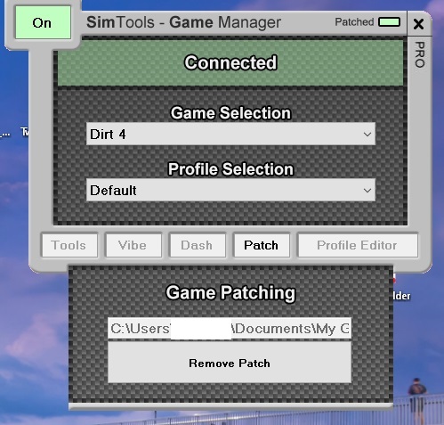

    for Dirt 4 , I believe the Game already patched for dirt 4 folder and still no feed back , by the way I'm using Dirt 4 version 1.0 and the plugin for v 2.0, is that a problem? and if it is , is there is Dirt 4 v1.0 plugin?... thank u
    22,159
    154,570Coins
    +11,190 / 57 / -2
    The game plugin version is independent of game version, so is not the issue.
    Please post pictures of all settings, including the Tuning Center while Dirt4 is running, to check for game data.

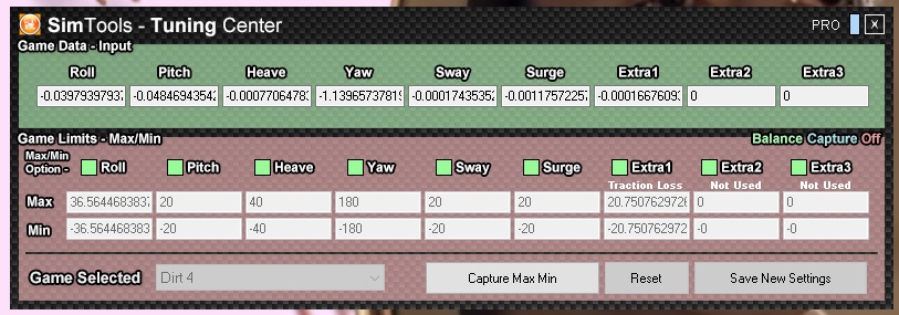

    hello guys , Dirt 4 start giving feedback i think ,but but so small amount witch is barely make the stepper move but i cant see it moving because I u can see in the image the feedback amount so small ... [​IMG]

    22,159
    154,570Coins
    +11,190 / 57 / -2
    Yes there is game data, but your TC values are too high.
    You can Capture Max Min, drive around a lap and don't hit anything, save and then tweak the values from there.
    See the motion profile tuning tips in the FAQs: https://www.xsimulator.net/community/faq/steps-to-create-a-motion-profile.228/
