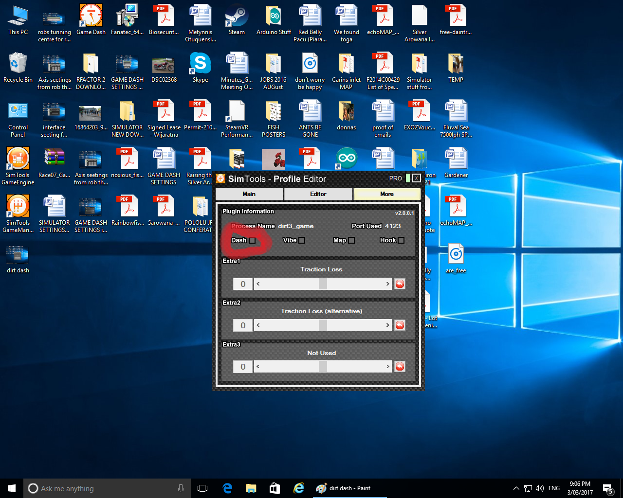

    Can some help me please
    doesn't seem to work with Game Dash ,its not present in Sims tool profile editor .Work fine before with sims tool 1.3 version .Look at picture ,I have added pic of Profiler Thanks domenic
