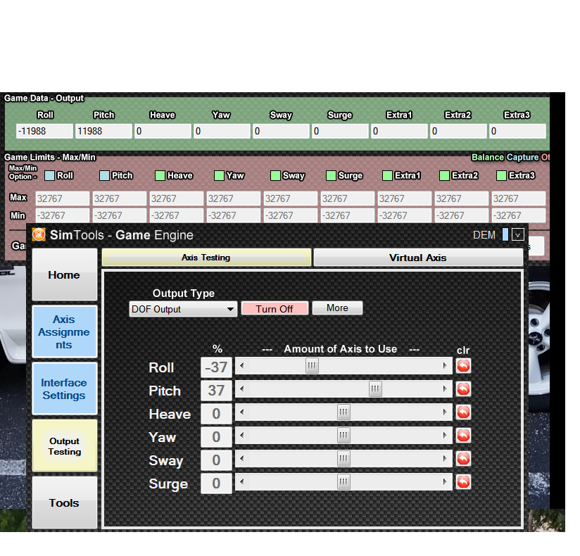

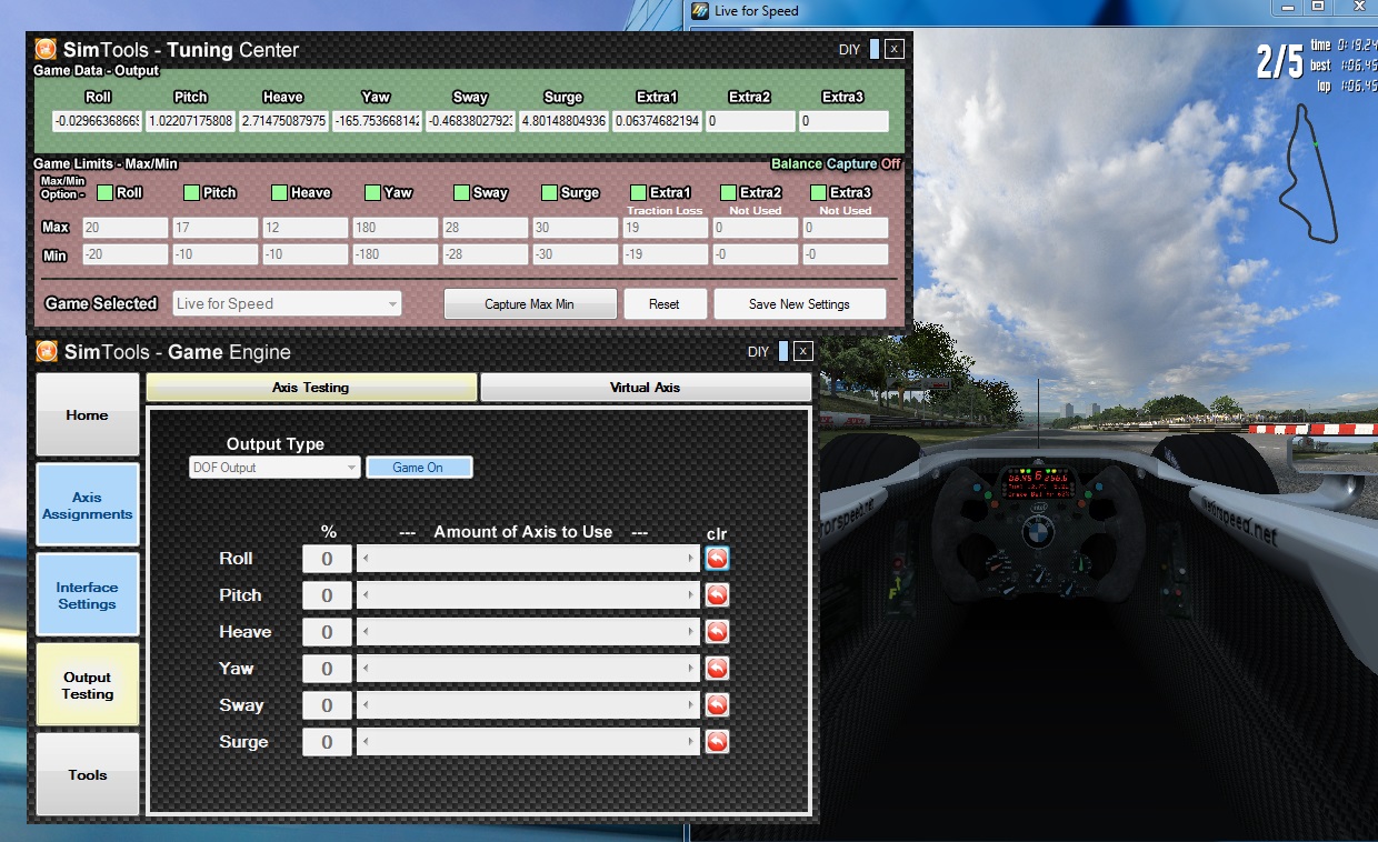

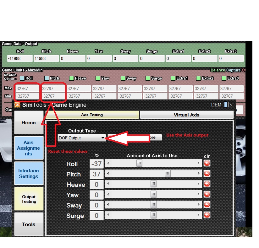

    one more test please as you use only 60% of the roll & pitch in GE ...
    Do the following :
    Where is that XPID thread ?

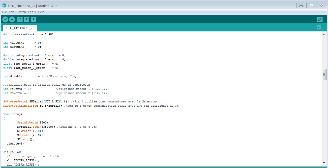

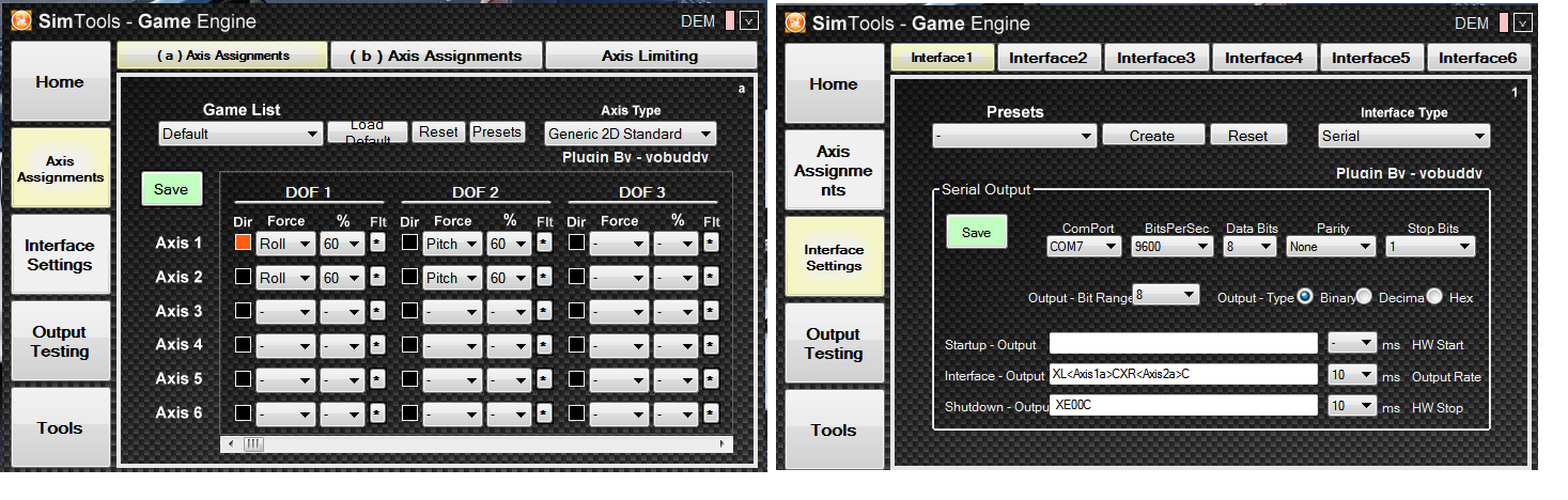

    @Wanegain's Arduino code for 2 DOF...I have follow this one to the dots...And I have not been successful as a simple as its looks...just to be save I have remove my old arduino uno and sabertooth and replaced with a new arduino uno out of the box and a brand new sabertooh 2x25...just to eleminated any hardware malfunction..and still the same outcome...!!something is not right...arduino does come on but no data is receiving or transmitter....

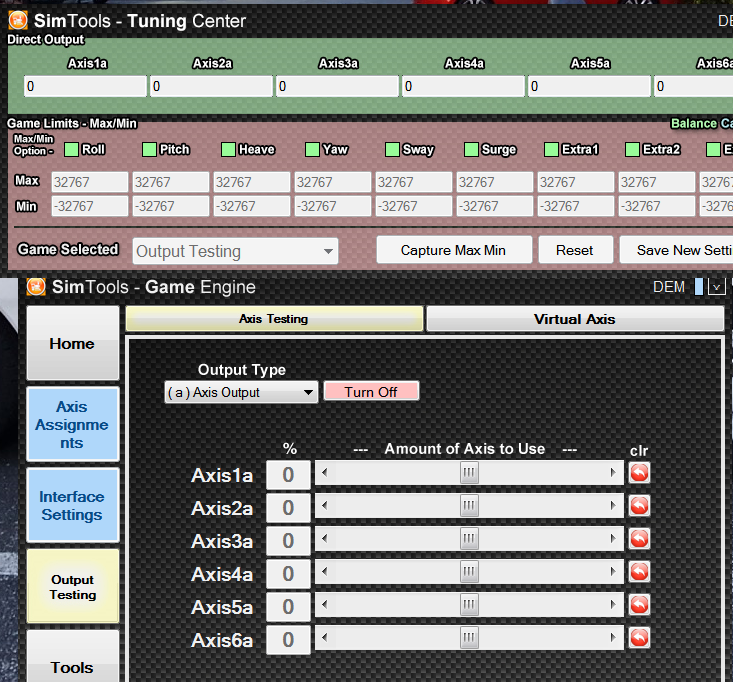

    I dont understand... does values are there cuz I move the slider (show in the screen shots)...it will be (0)out as it center...that dont make any diferences...even with the Axis output selected...

    this one is wrong too ...

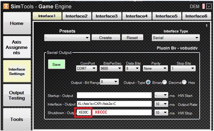

    just look at my screen shots...is been corrected...

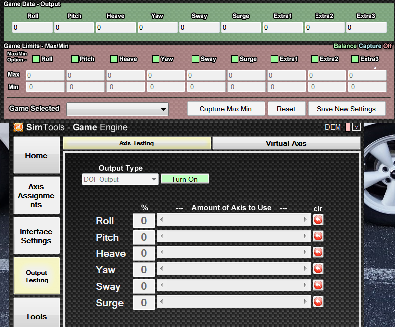

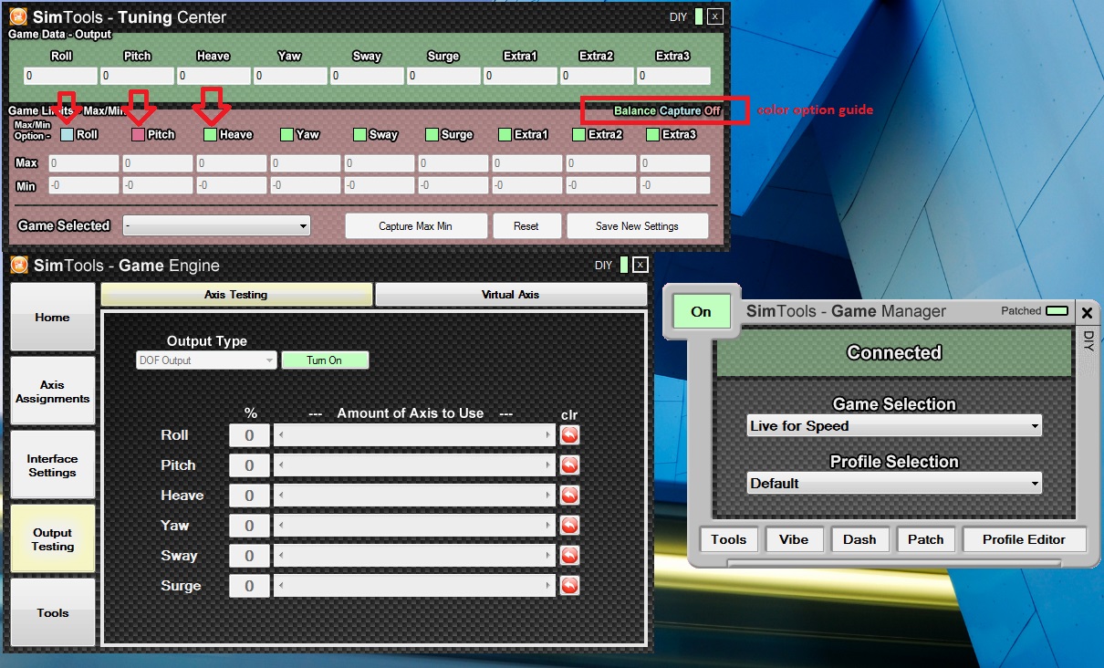

    also the reset value botton or any of the botton doesnt work..the only things I can click is the Max/Min Obtion on the tunning center.....

    The line where (Game Selected) and all the botton ...I dont have acces to it...why? Dont know...

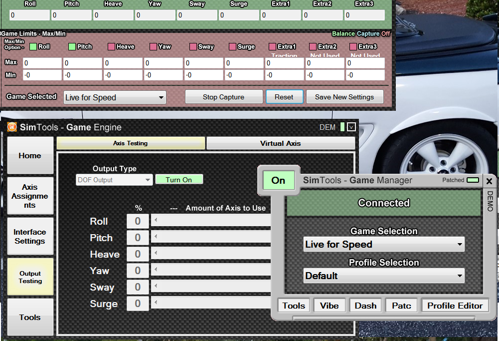

    they turn on with a game selected ...
    when capture Max Min is ON ... the forces box colors varies as green means axis is having a balanced around the center forces ..
