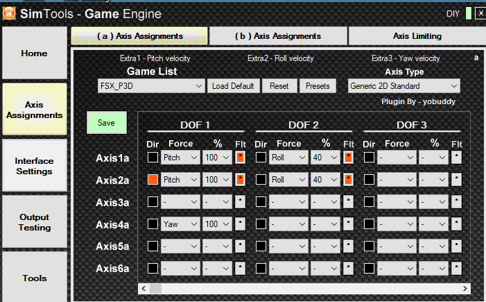

  3. Les Call
    Les Call rotax 912
    Mar 13, 2018
    19
    retired
    UK
    81Coins
    Hi Noorbeast .The rudder pedals work perfectly in FSX on the ground and in the air when the game is running .After your comment regarding the high value in the tuning center i reset all to 10 as i can refine this later. Now this is what is happerning when i start the game .I choose the aircraft press FLY NOW as soon as i do this the YAW motor moves in one direction and stops there at the max i have put in the axix asignments if i put 10% it moves 10% if i put 50% it moves 50% .whatever % i put in it moves to that position and stops. When i exit the game it slowly moves bach to its reset position as does the other two motors i have added a pic of both interface setting and the axix assigment page. T Screenshot (108).png Screenshot (112).png Screenshot (112).png hanks .

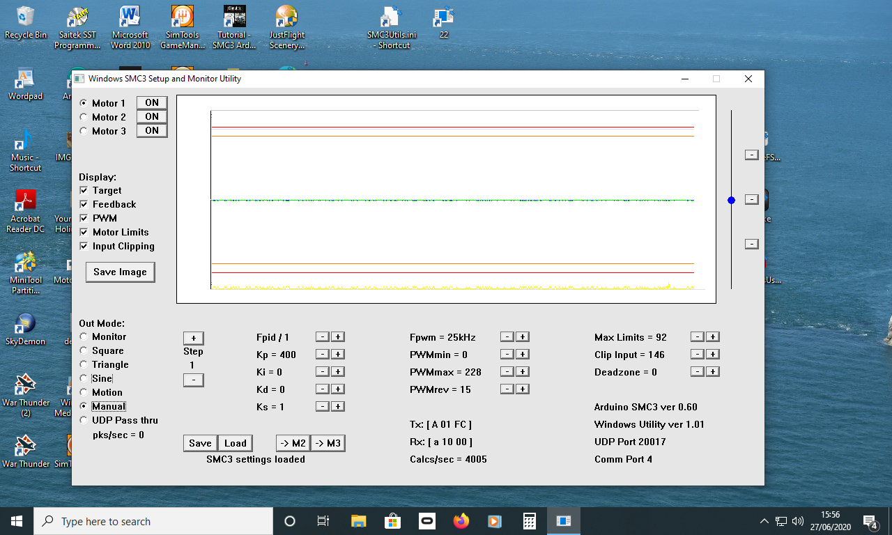

  5. Les Call
    Les Call rotax 912
    Mar 13, 2018
    19
    retired
    UK
    81Coins
    Hi .Noorbeast .Well i checked the other two motors to see if the numbers matched on the SMC3 to the yaw Arduino and they did so at that point i changed one of the existing motors on the rig that i know works fine for roll and changed it to com 4 and the YAW settings ran the game and it did exacly the same thing as the other one moved in one direction and stoped .Exited the game and the motor slowly went back to its start position took a picture of the SMC3 using the YAW Arduino and moto board Screenshot (113).png
