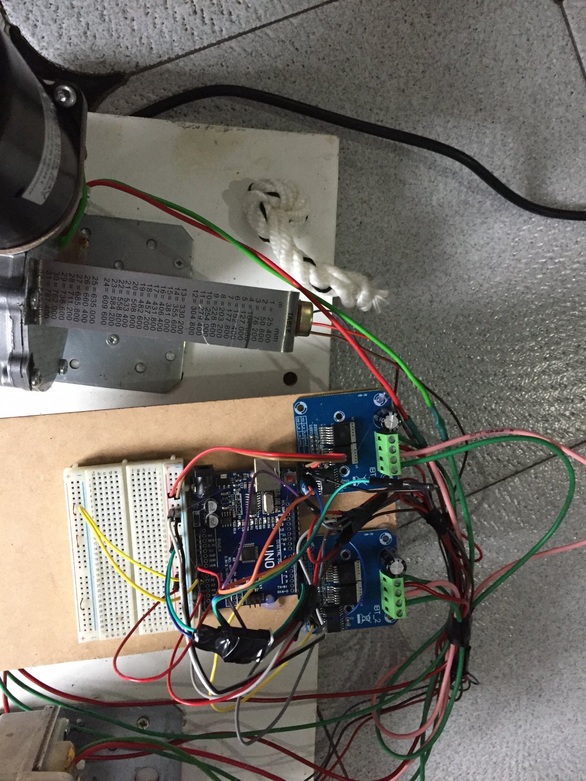

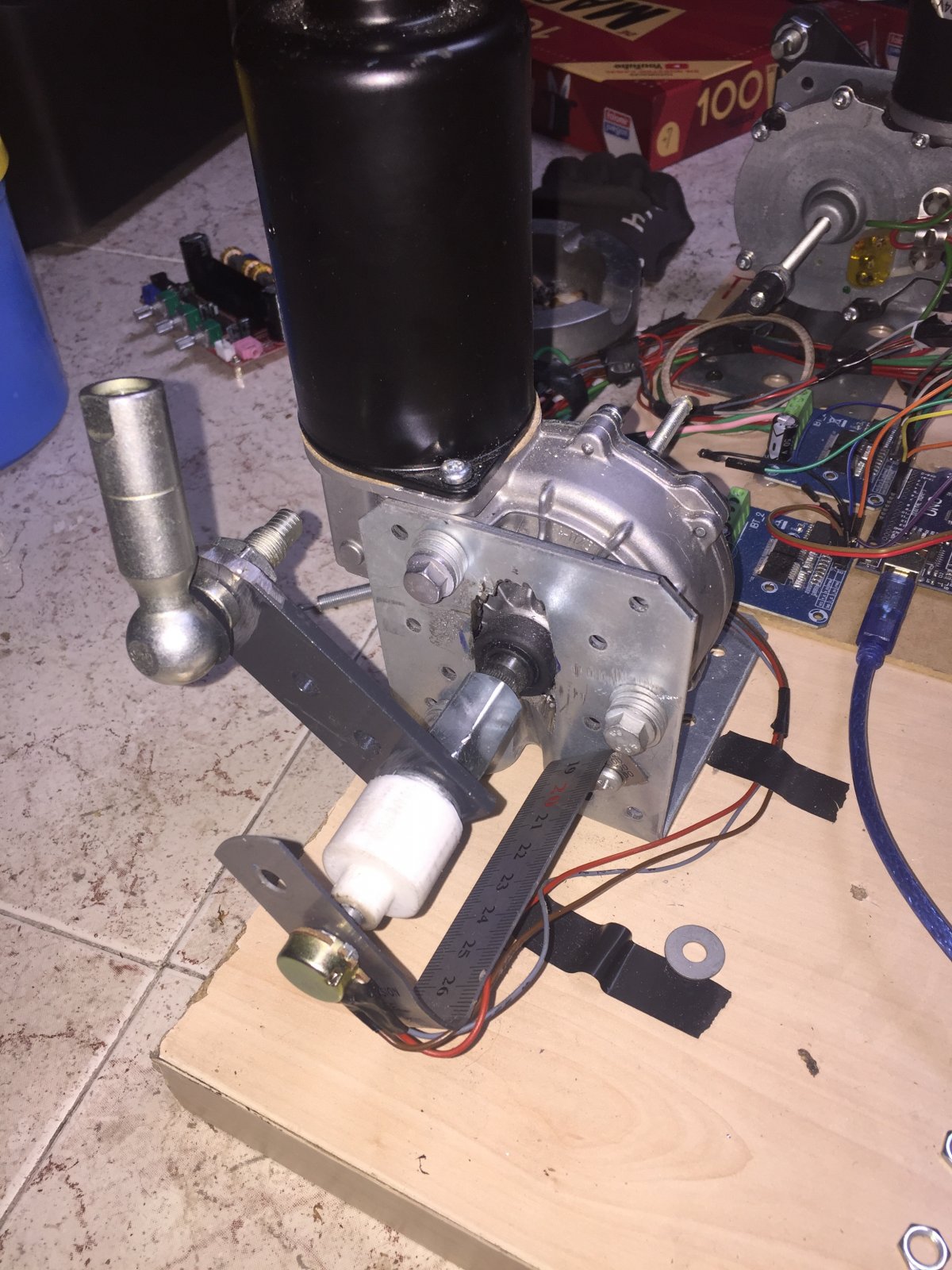

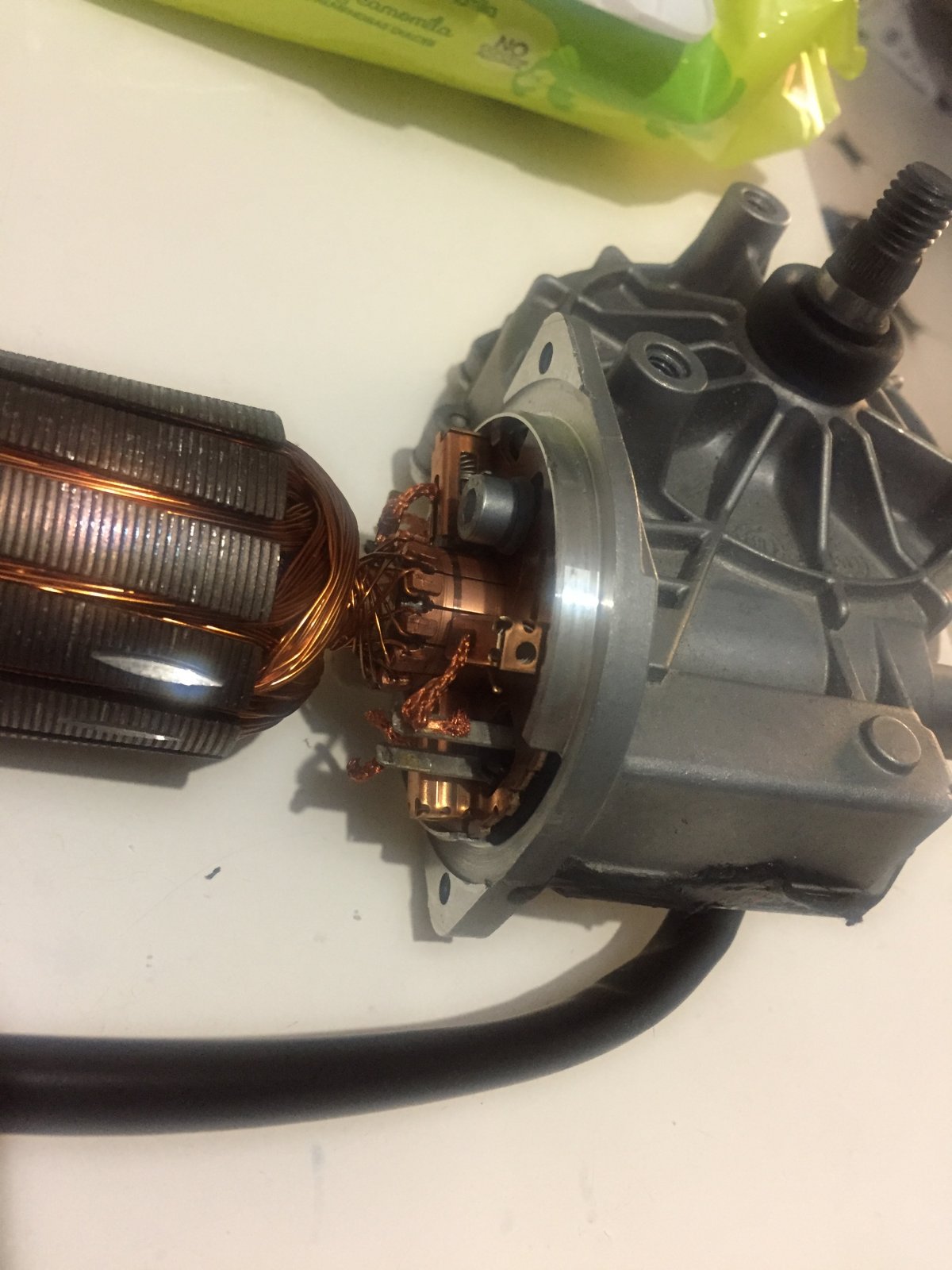

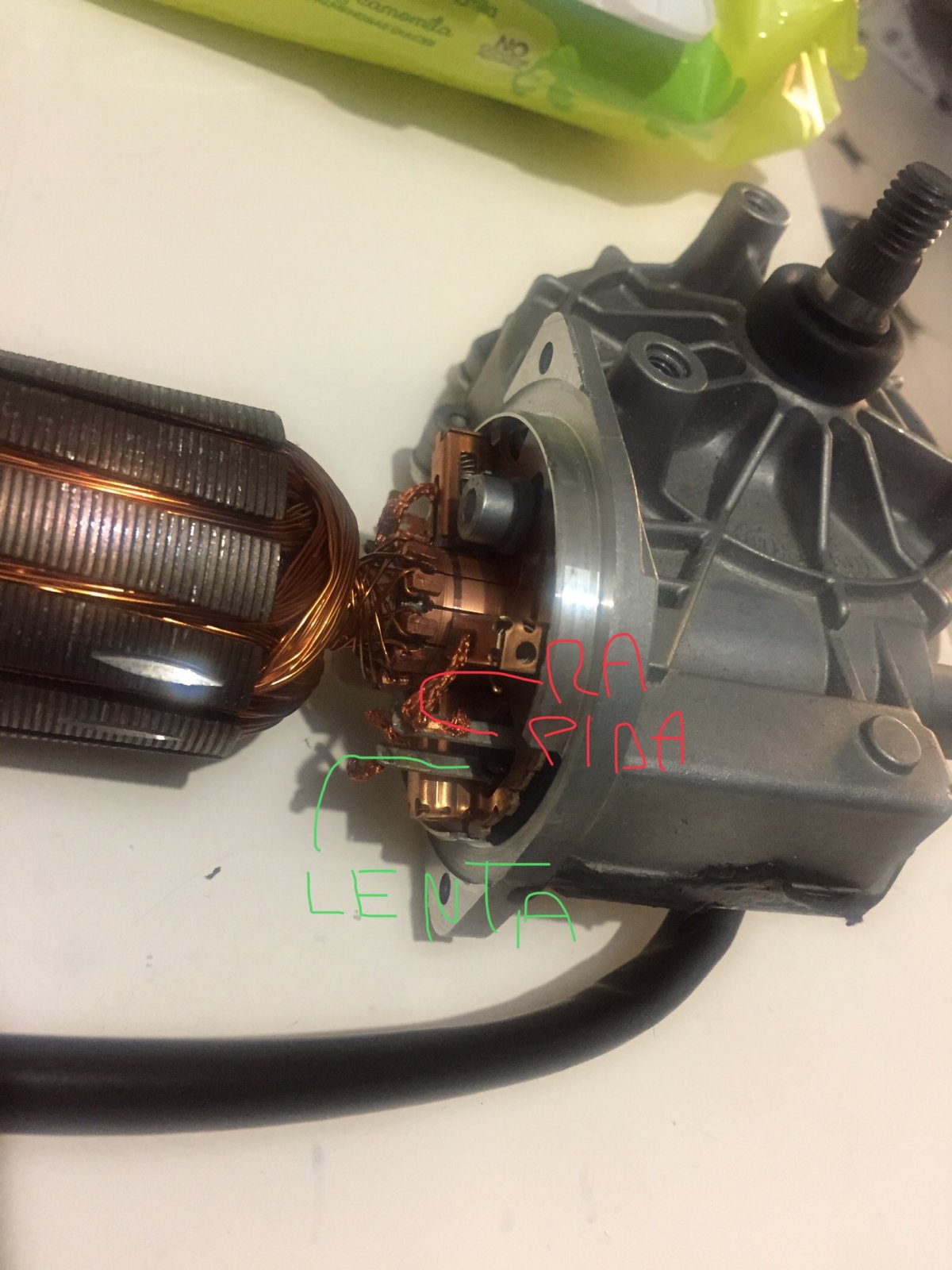

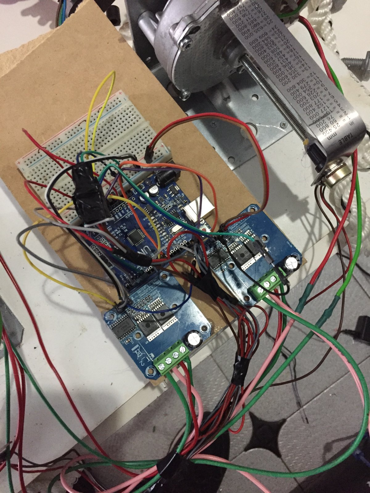

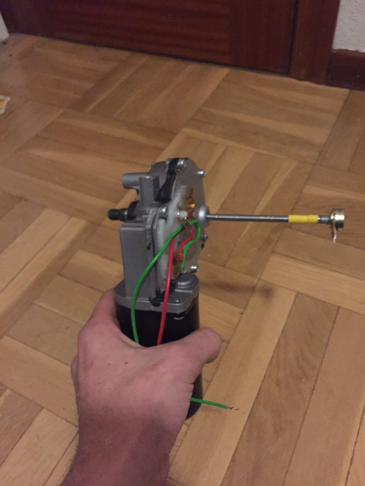

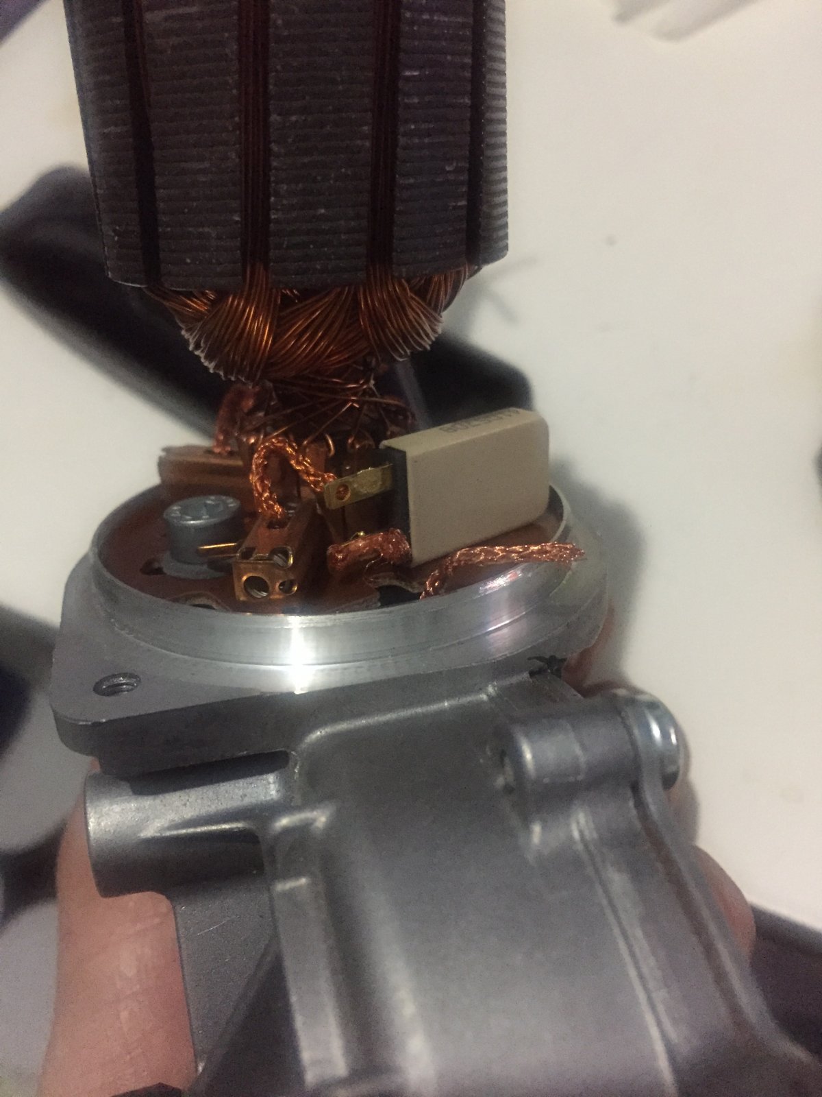

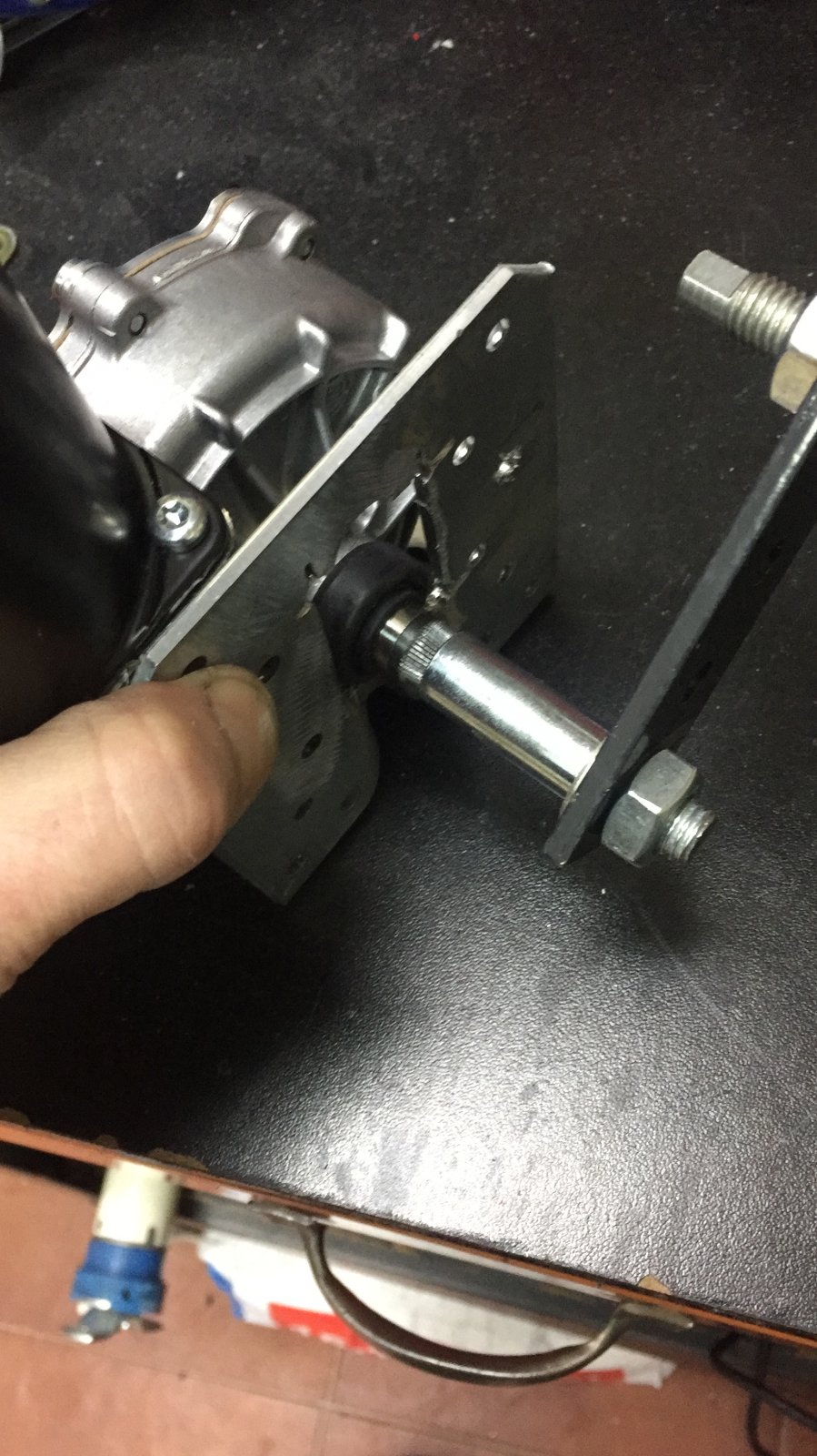

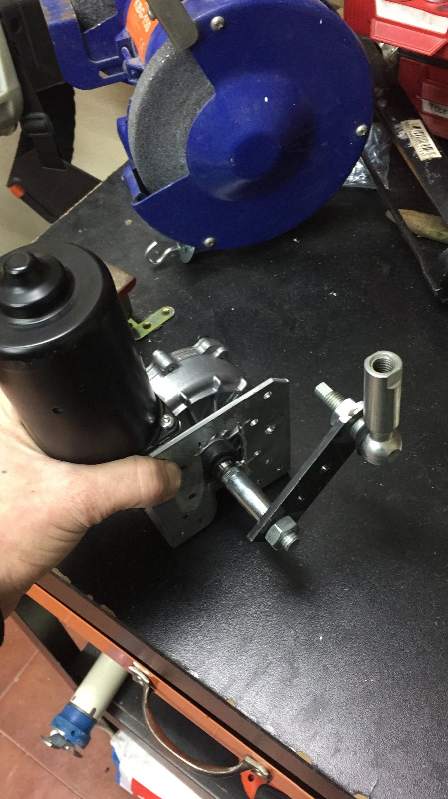

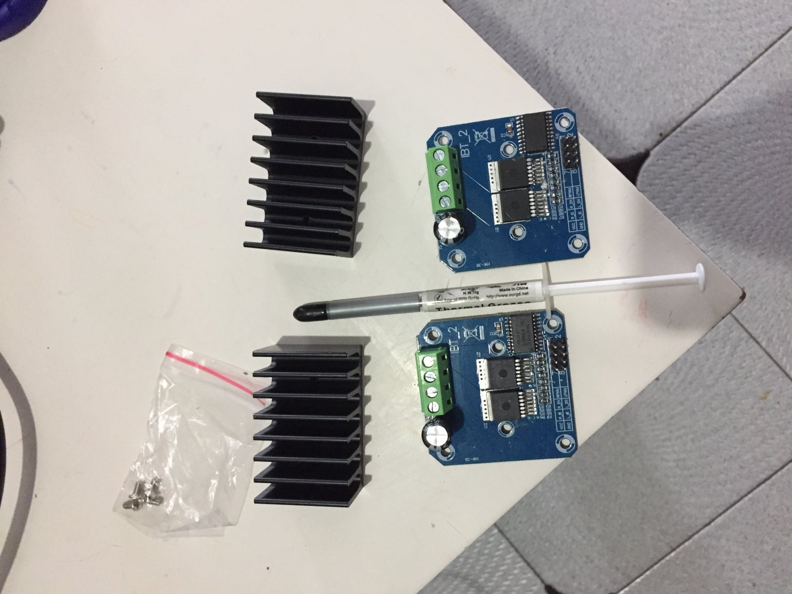

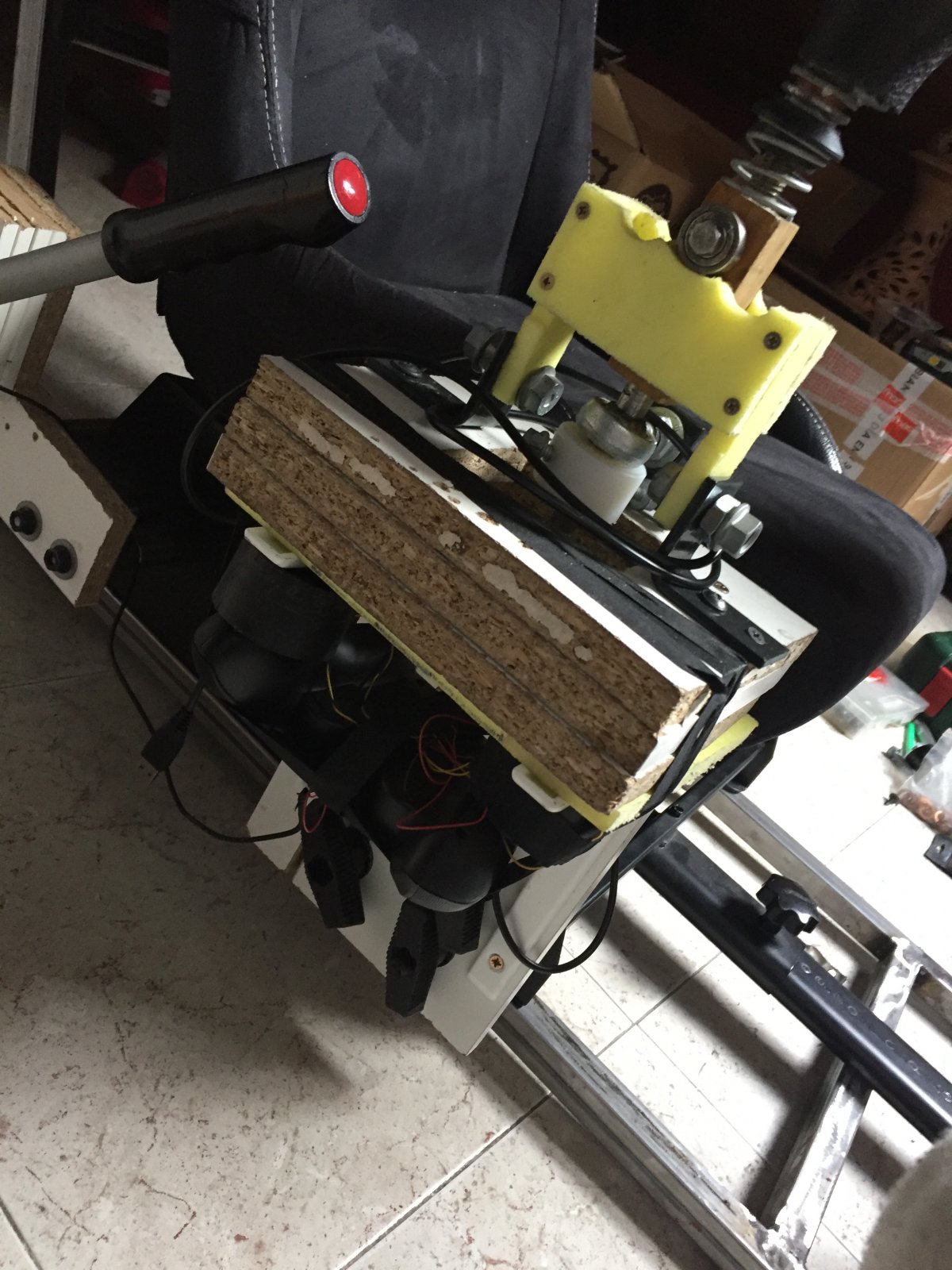

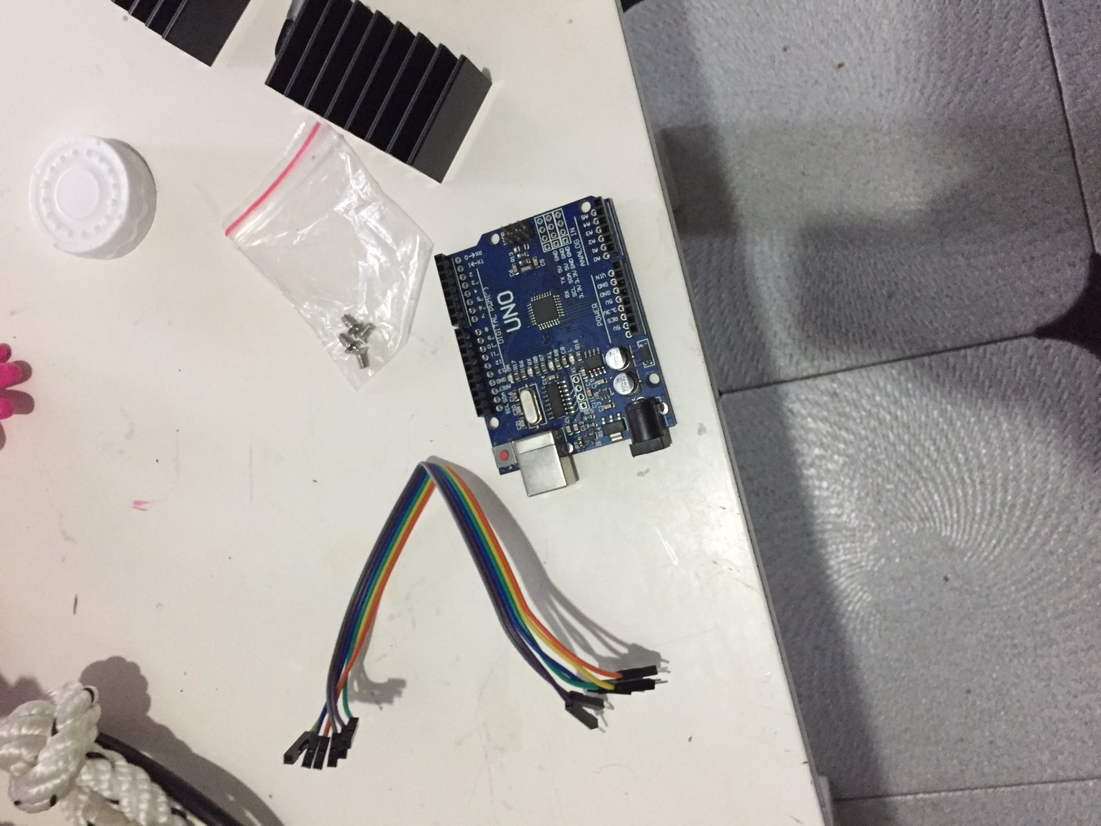

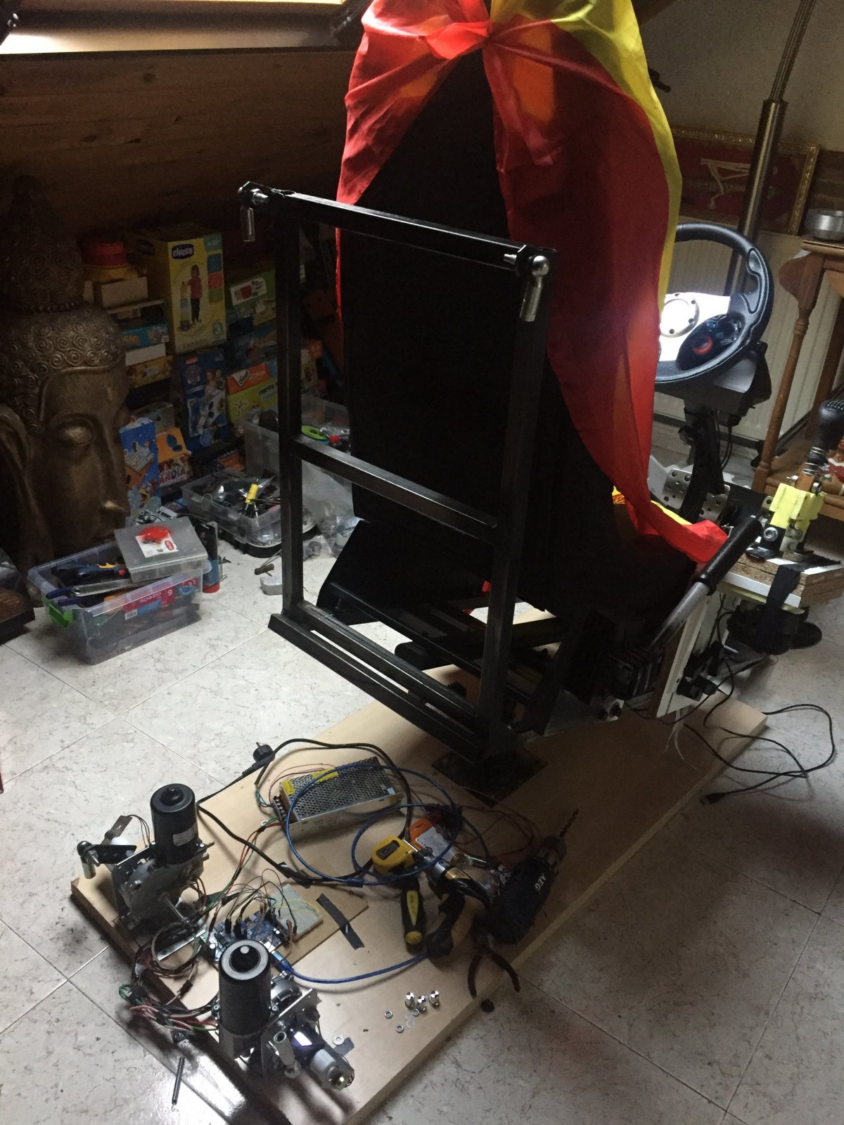

    The first thing is to thank the xsimulator team for the great work. this is my Progress of this 2dof I accept suggestions and ideas I am starting with electronics, I have used an Arduino R3 one, two ibt2, two 10k potentiometers, two 24v truck engines and a 12V 15Ah power supply that is currently provisional For tests

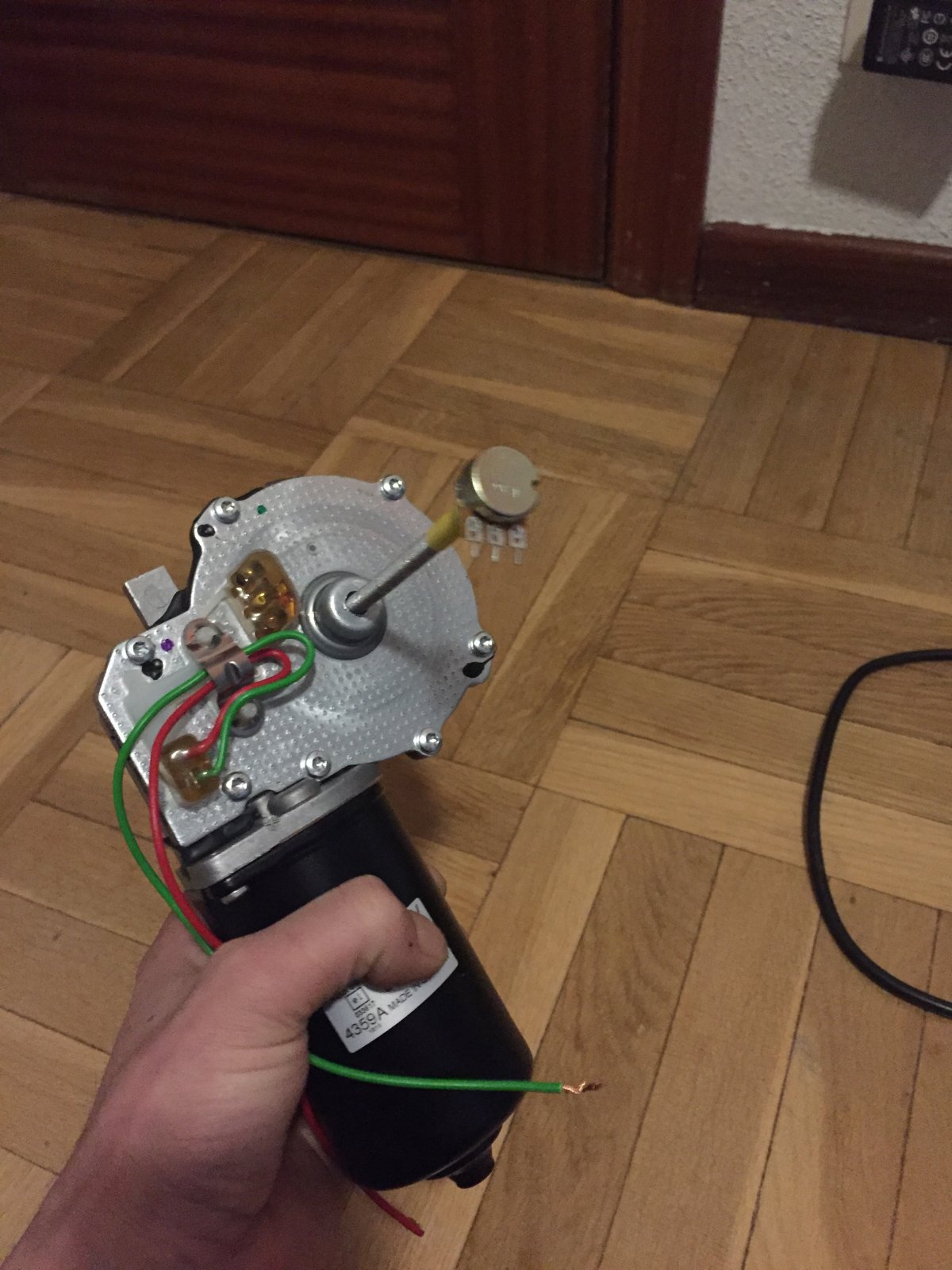

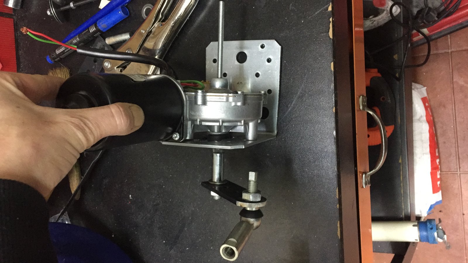

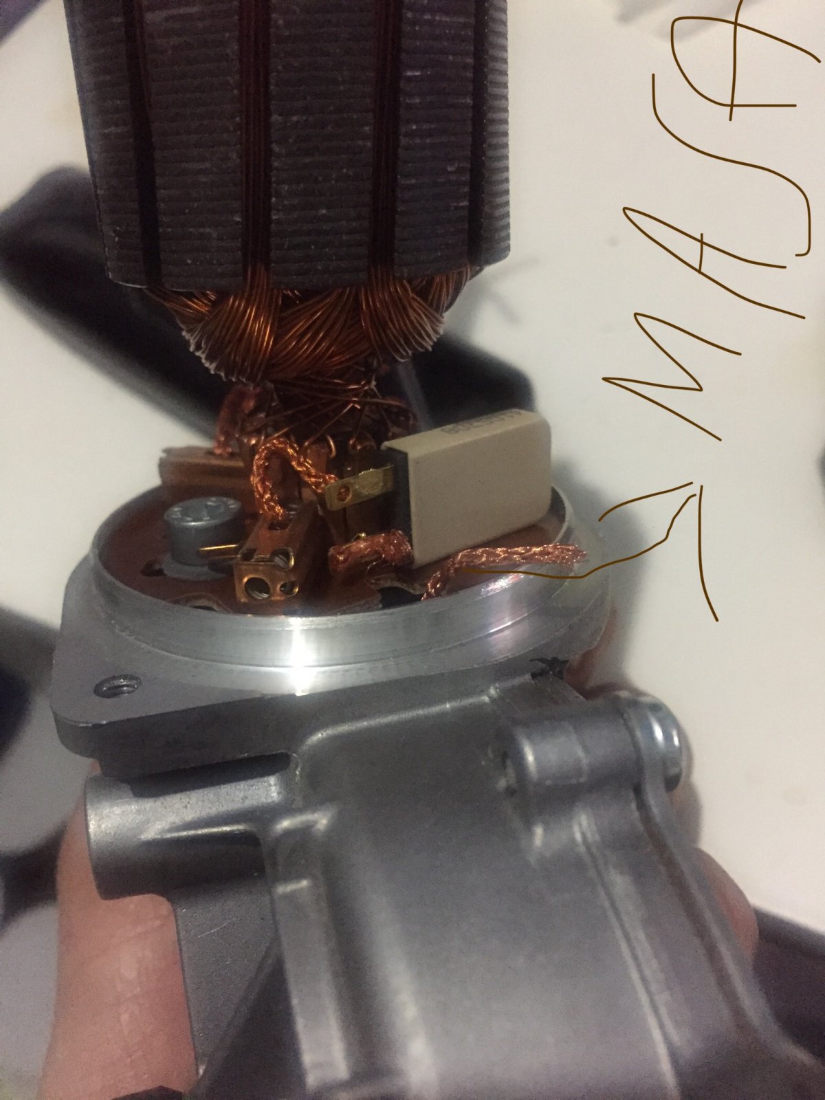

    The engines are truck the first thing I did is isolate the mass of the chassis and detect the high-speed cable

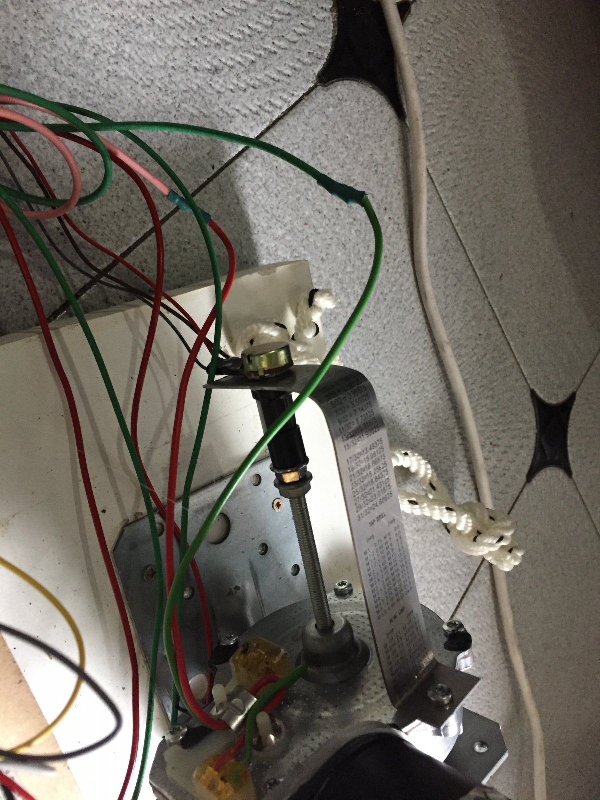

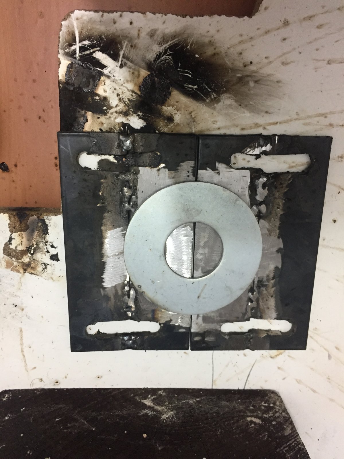

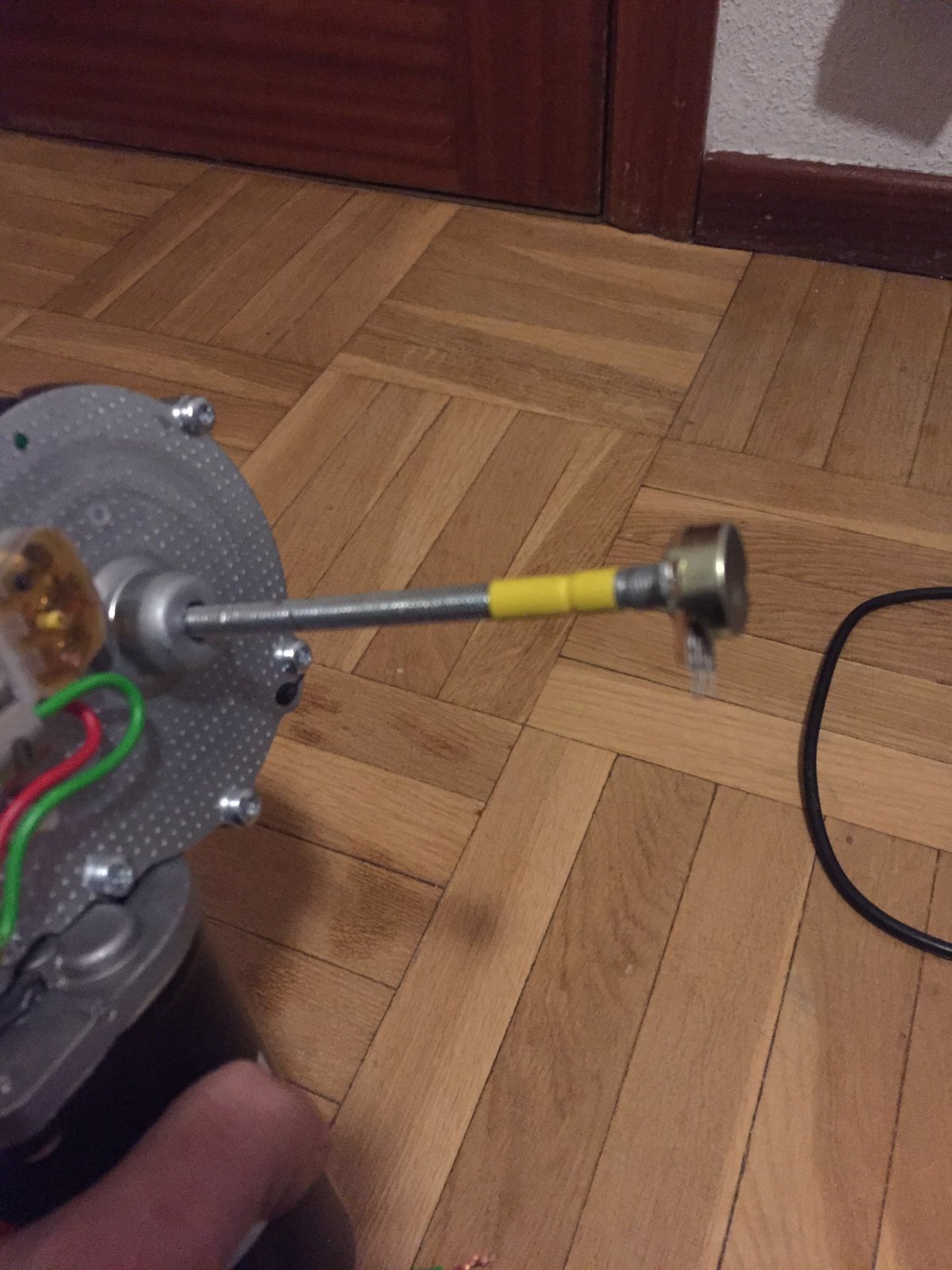

    Already prepared the engines, I made a drill on the opposite side of the axes and passed a threaded male to place a bolt to rotate the potentiometers, take out a screw from the chassis and fix a plate to hold the potentiometers, this fixation is provisional I want to improve

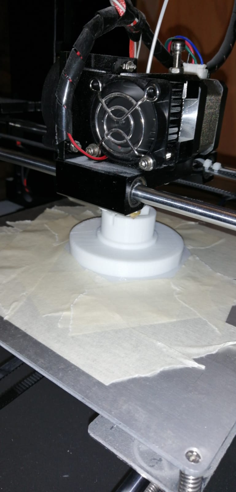

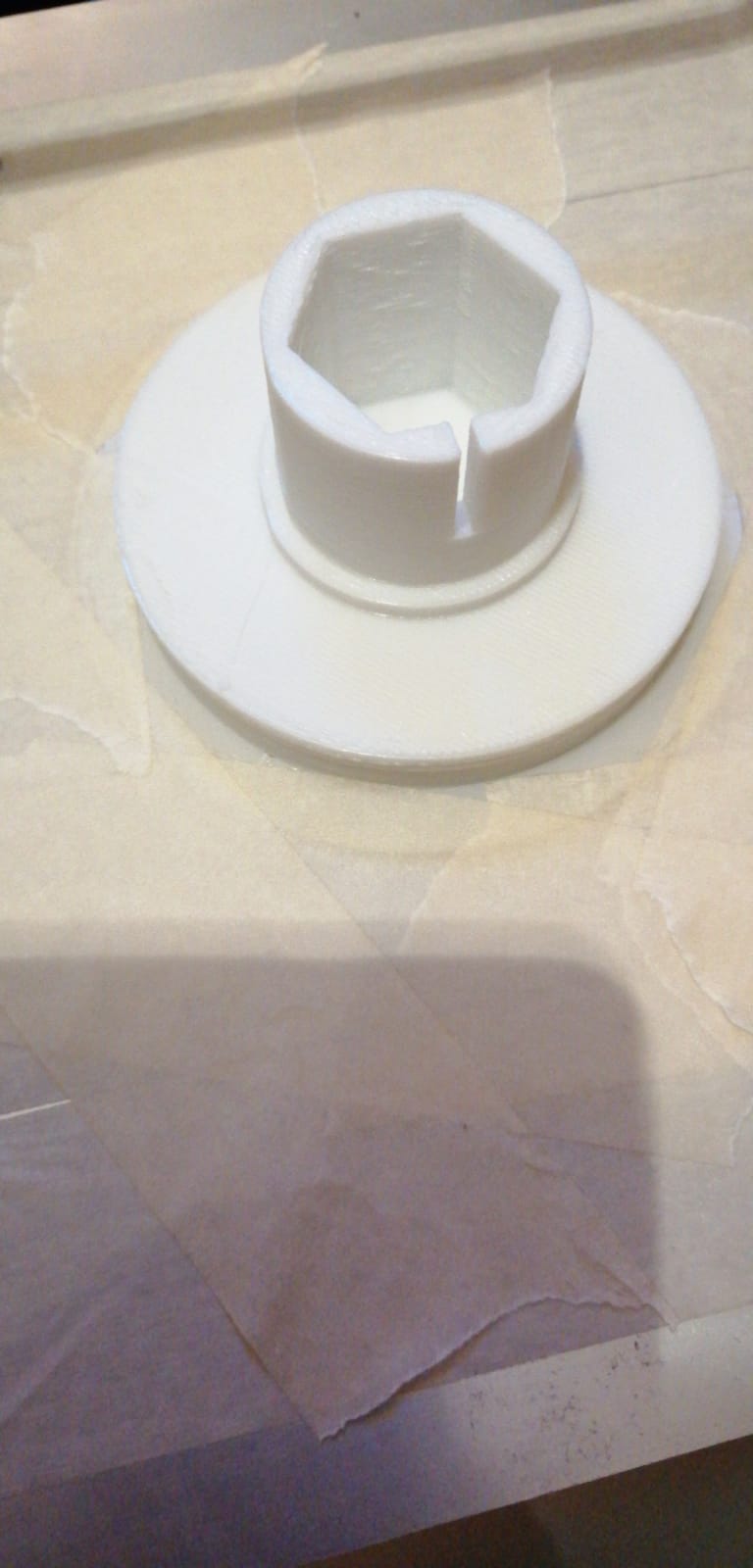

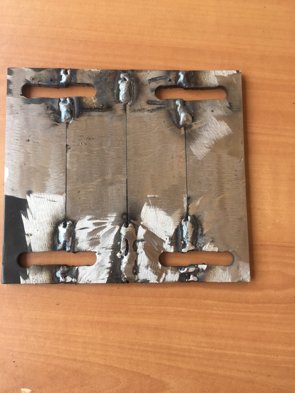

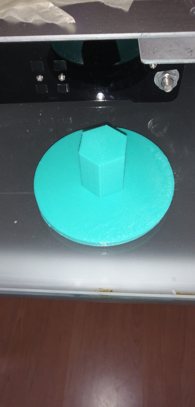

    to fix the plates on the motor shafts I will use a threaded bolt and a stud, the articulables take them out of a gearbox, they have a thread pitch of 10 mm

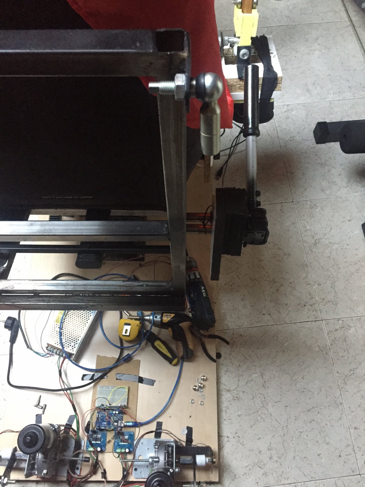

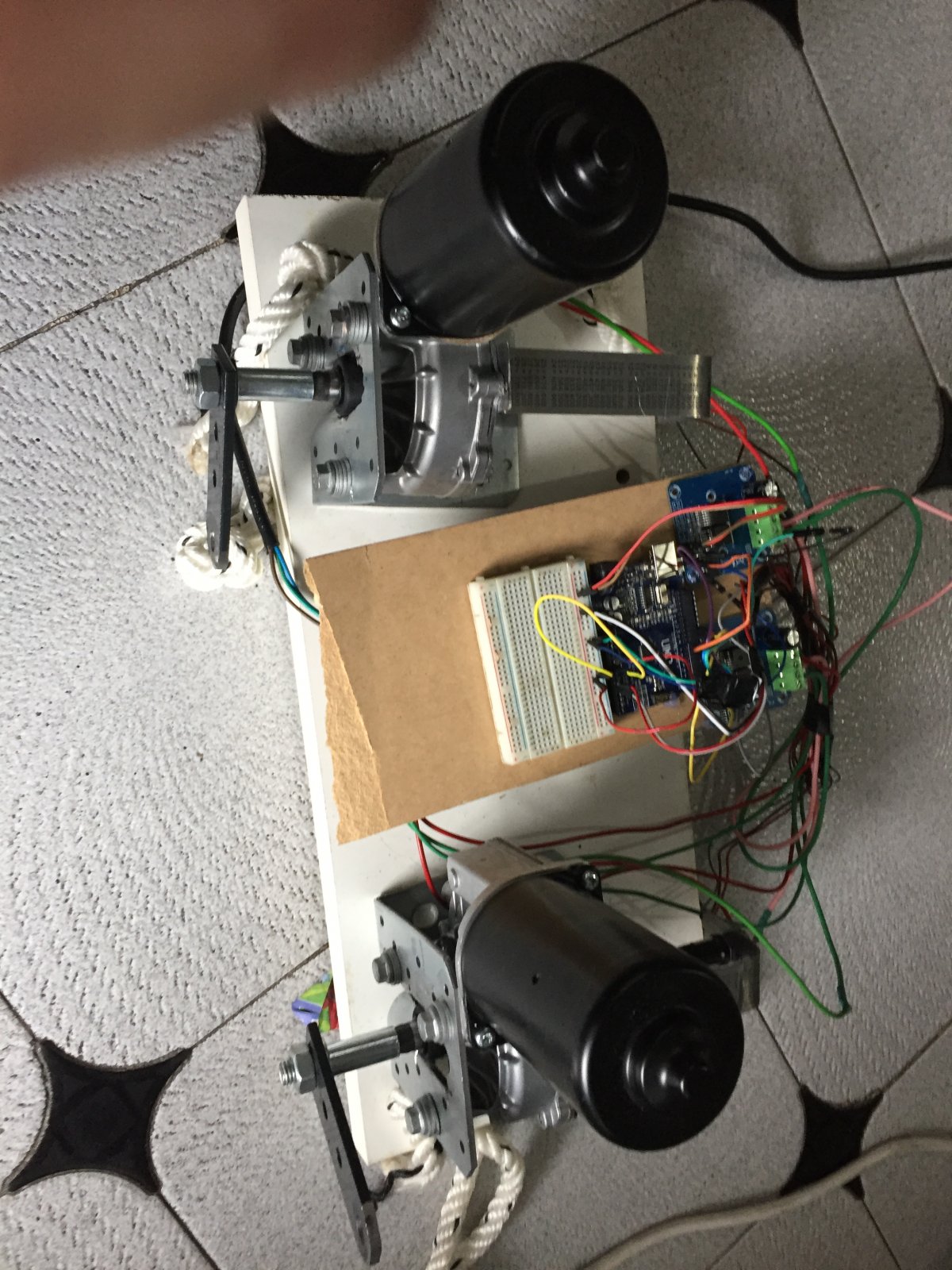

    then I put the electronics up the program on the arduino MODE2 connect the ibt2 and mount everything provisional on a table to be able to do the tests
    the engines work perfectly with the SMC3Utils v1.01 program
    I need to have the simtool license to try in a racing game

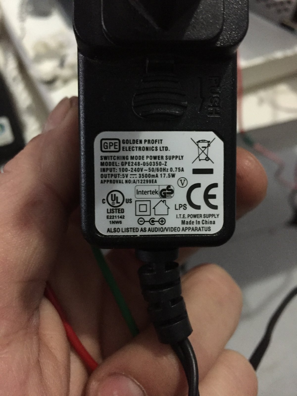

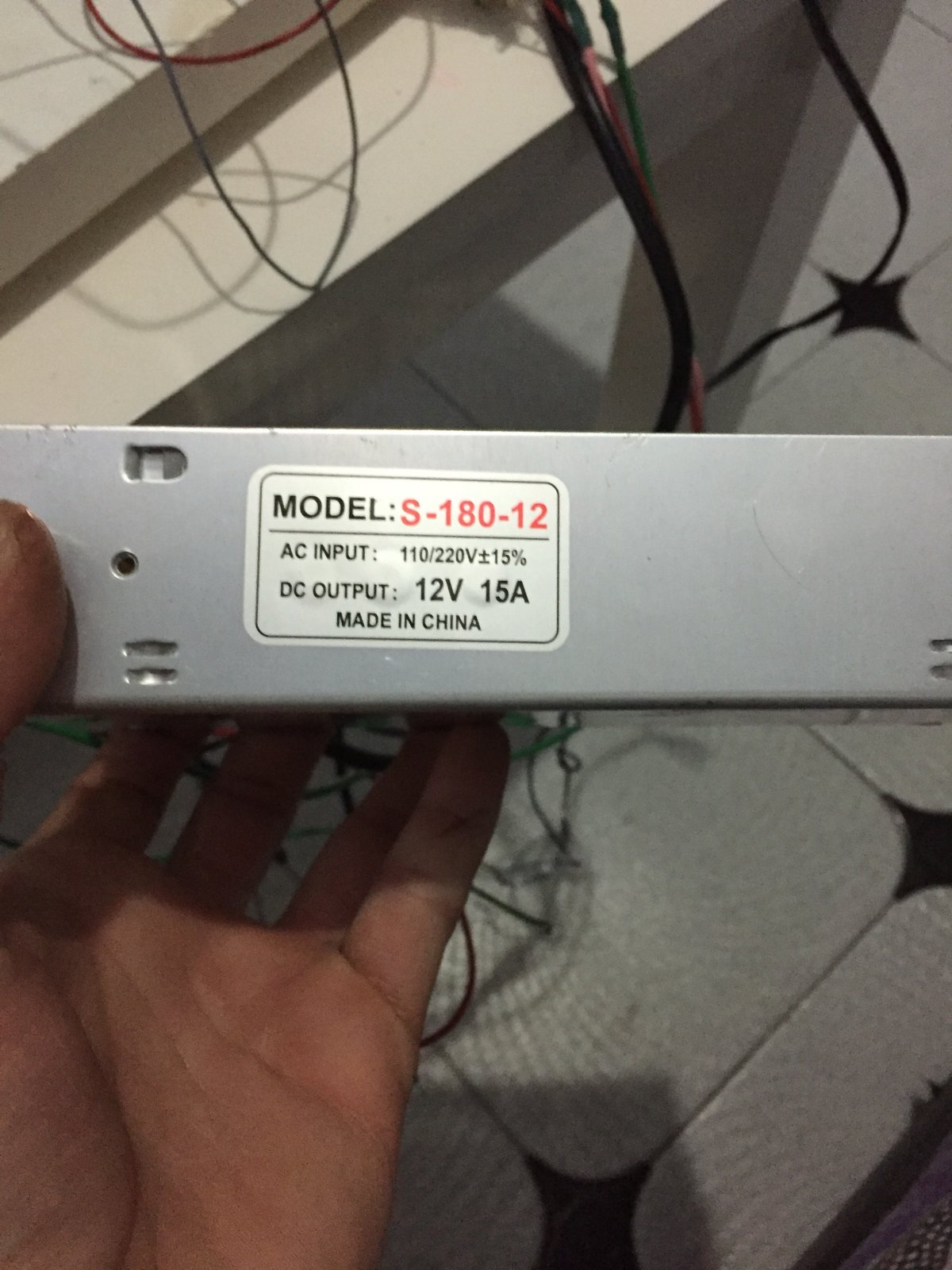

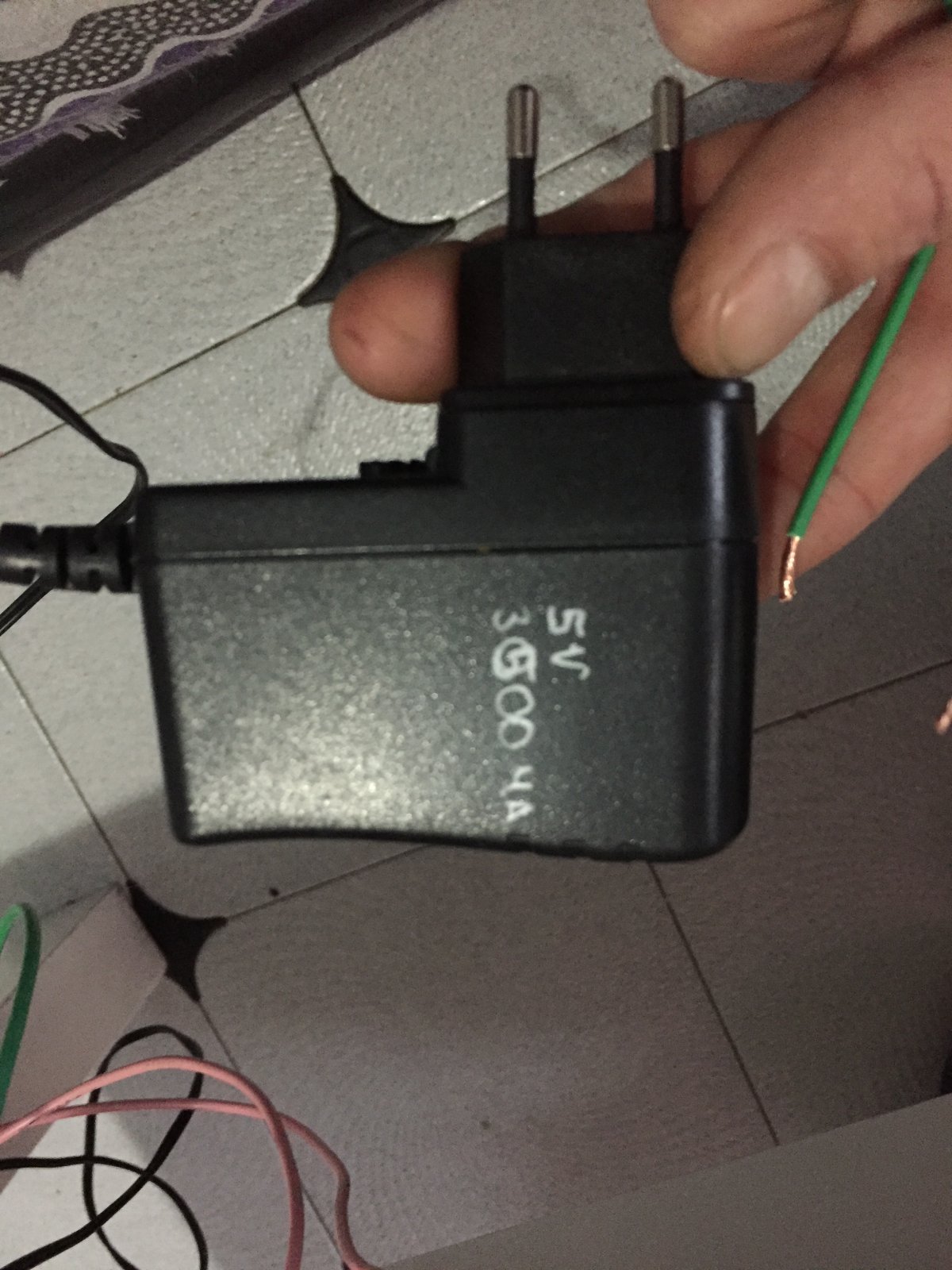

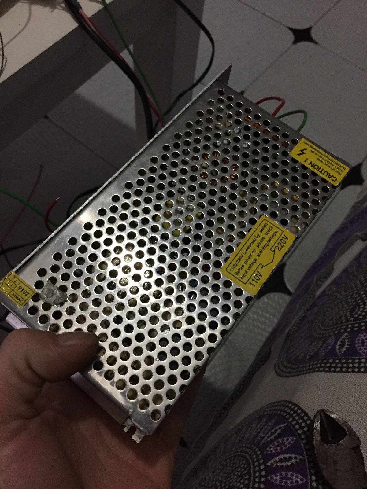

    I am using a 12V 15Ah power supply that seems to work well and another 5v 3500mha power supply

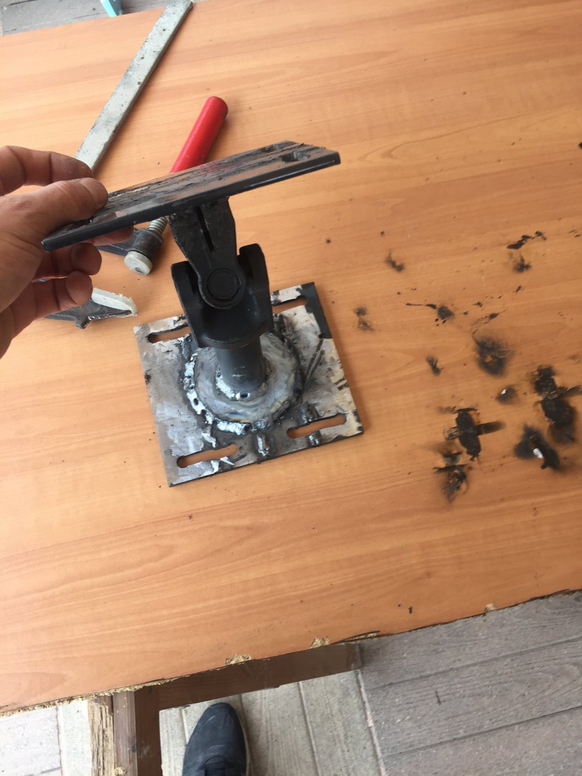

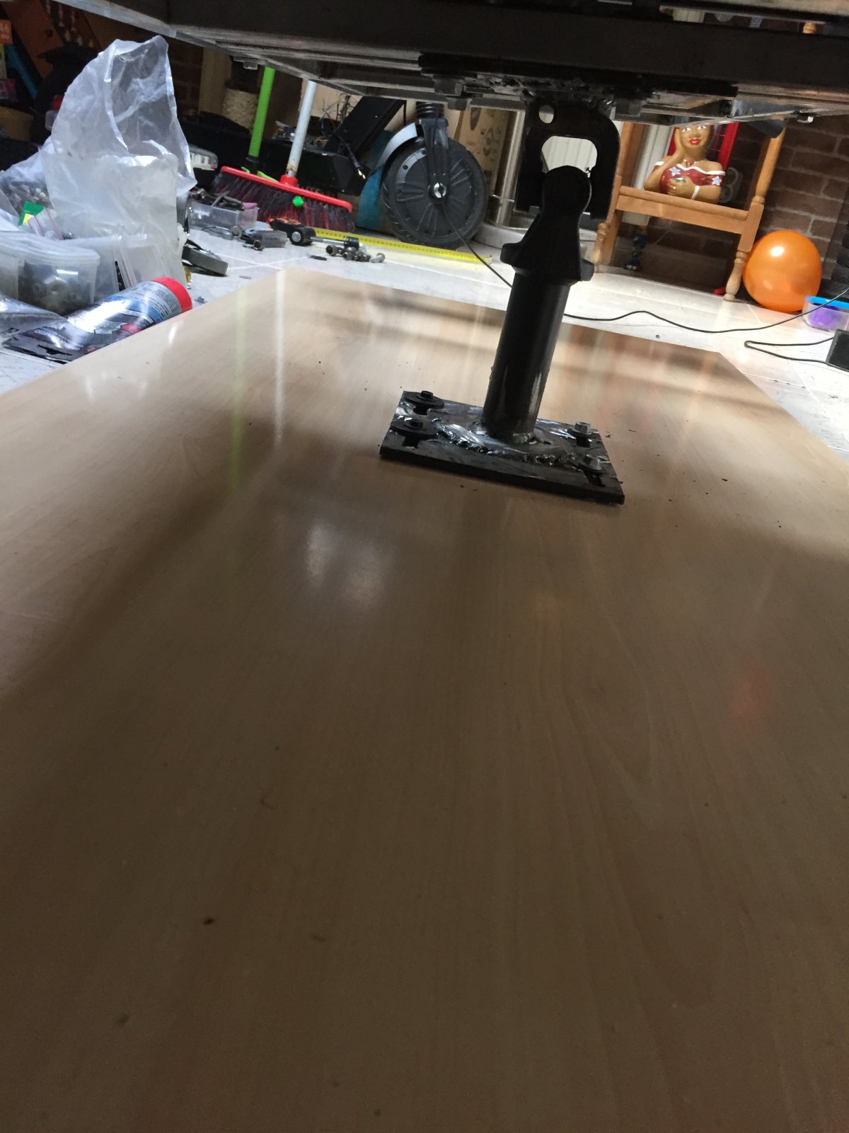

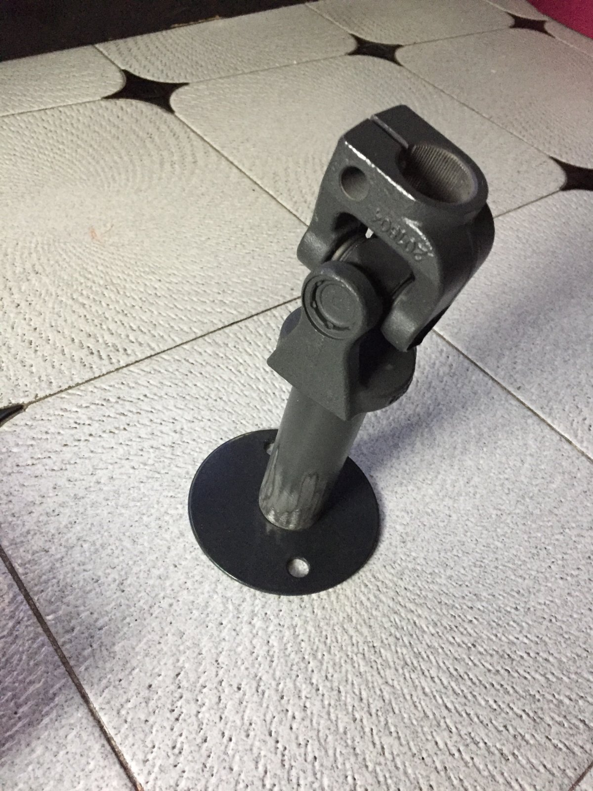

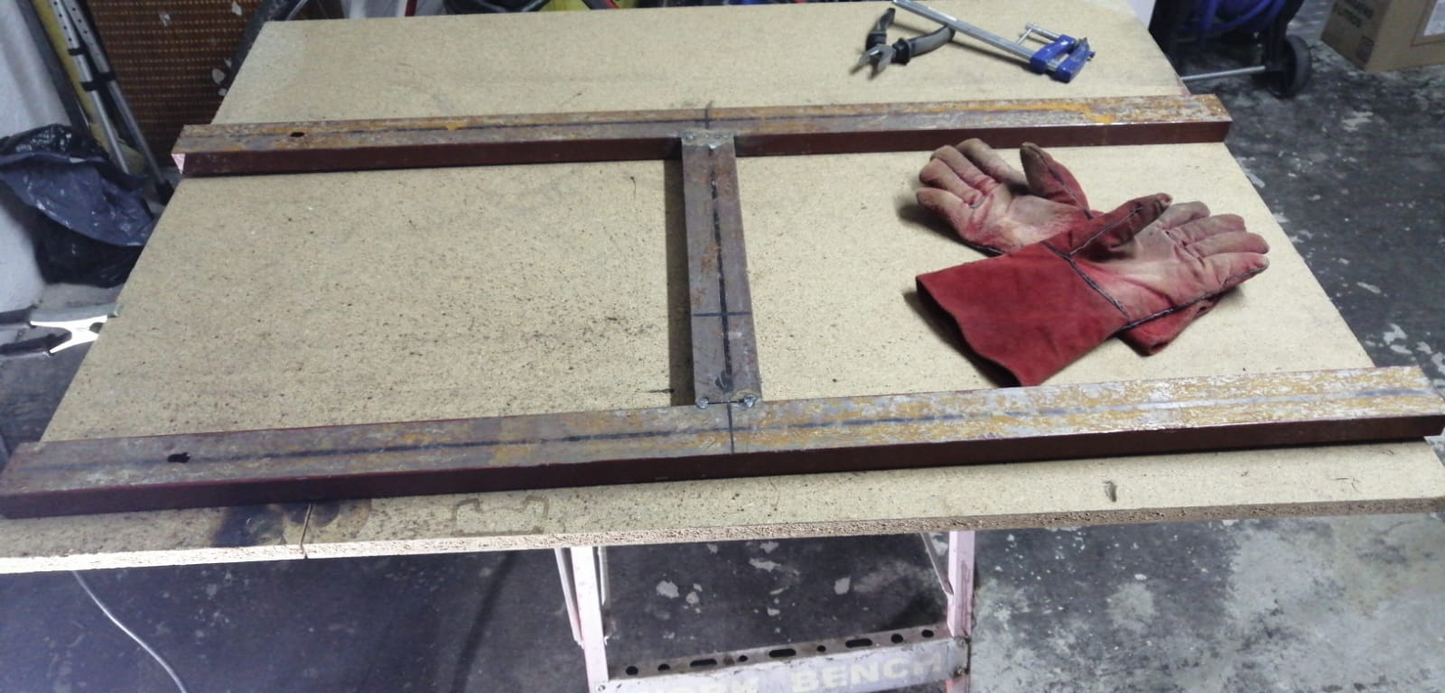

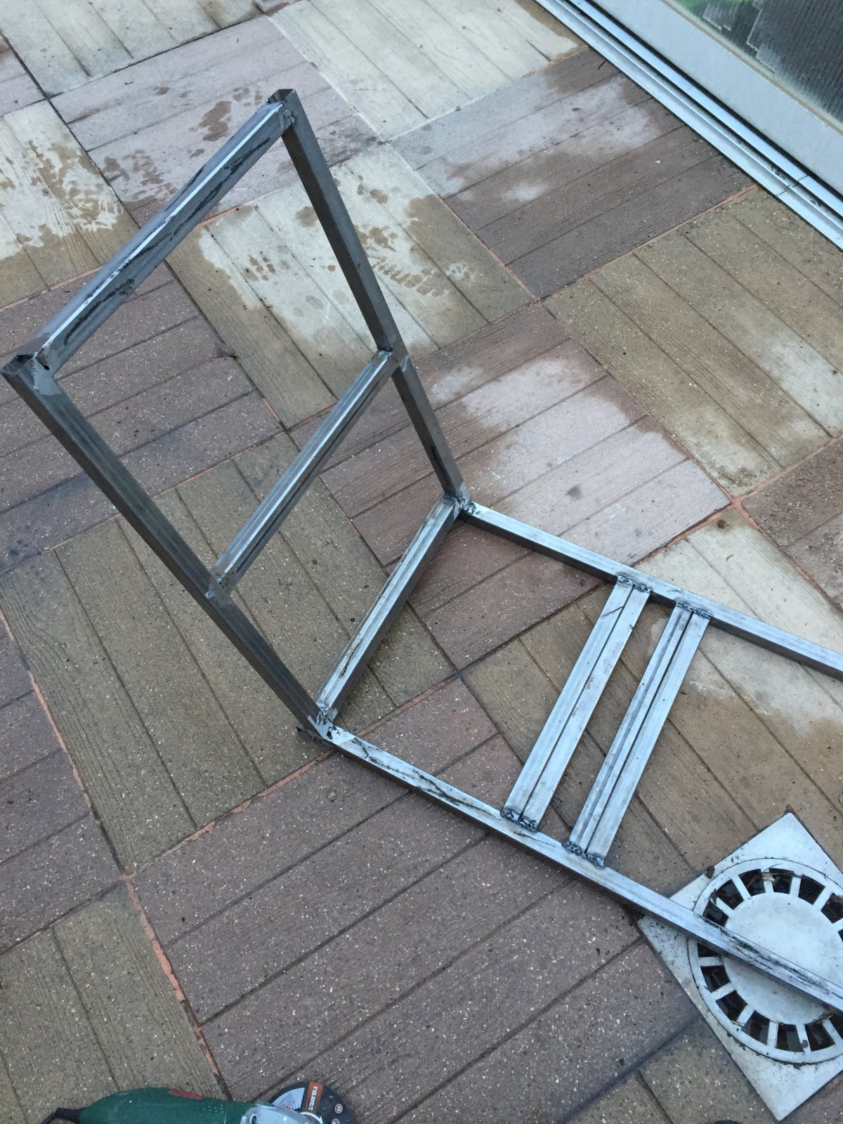

    I have not finished the structure yet I am using iron slats and for the central axis I will use this piece IMG_3084.JPG STFQ8845.JPG

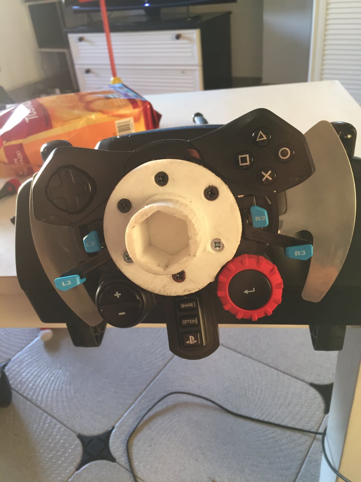

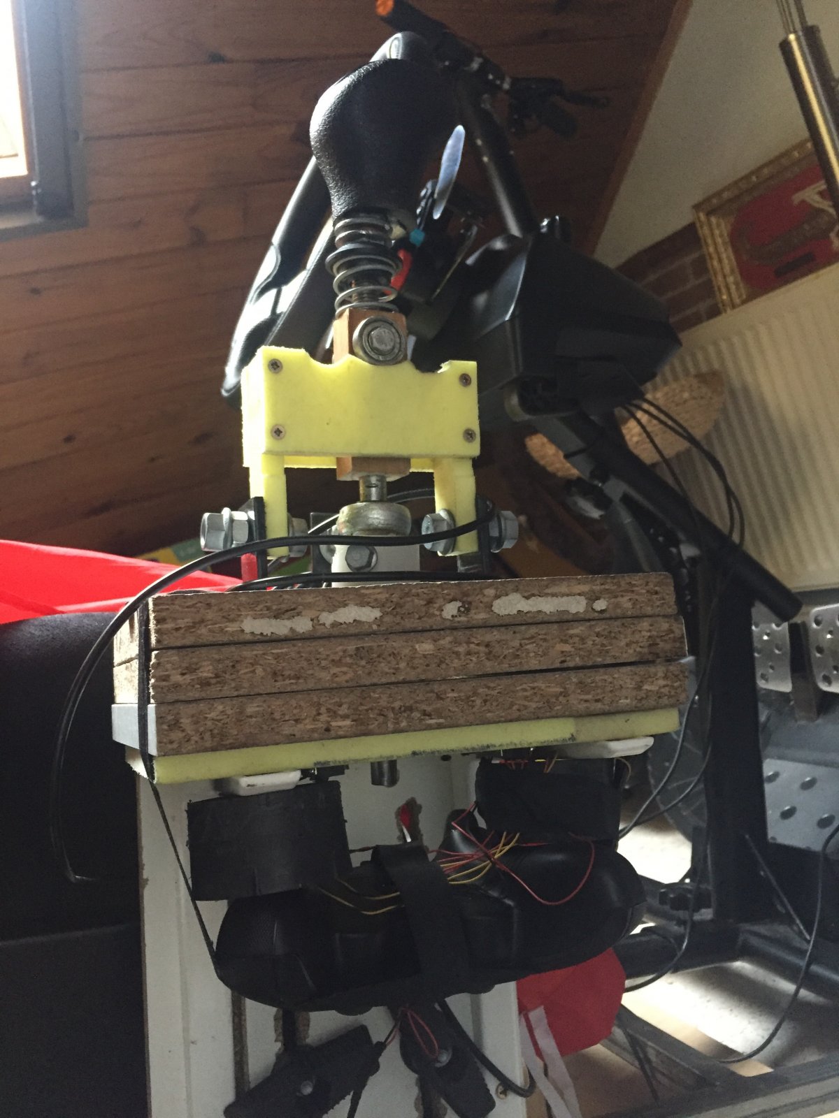

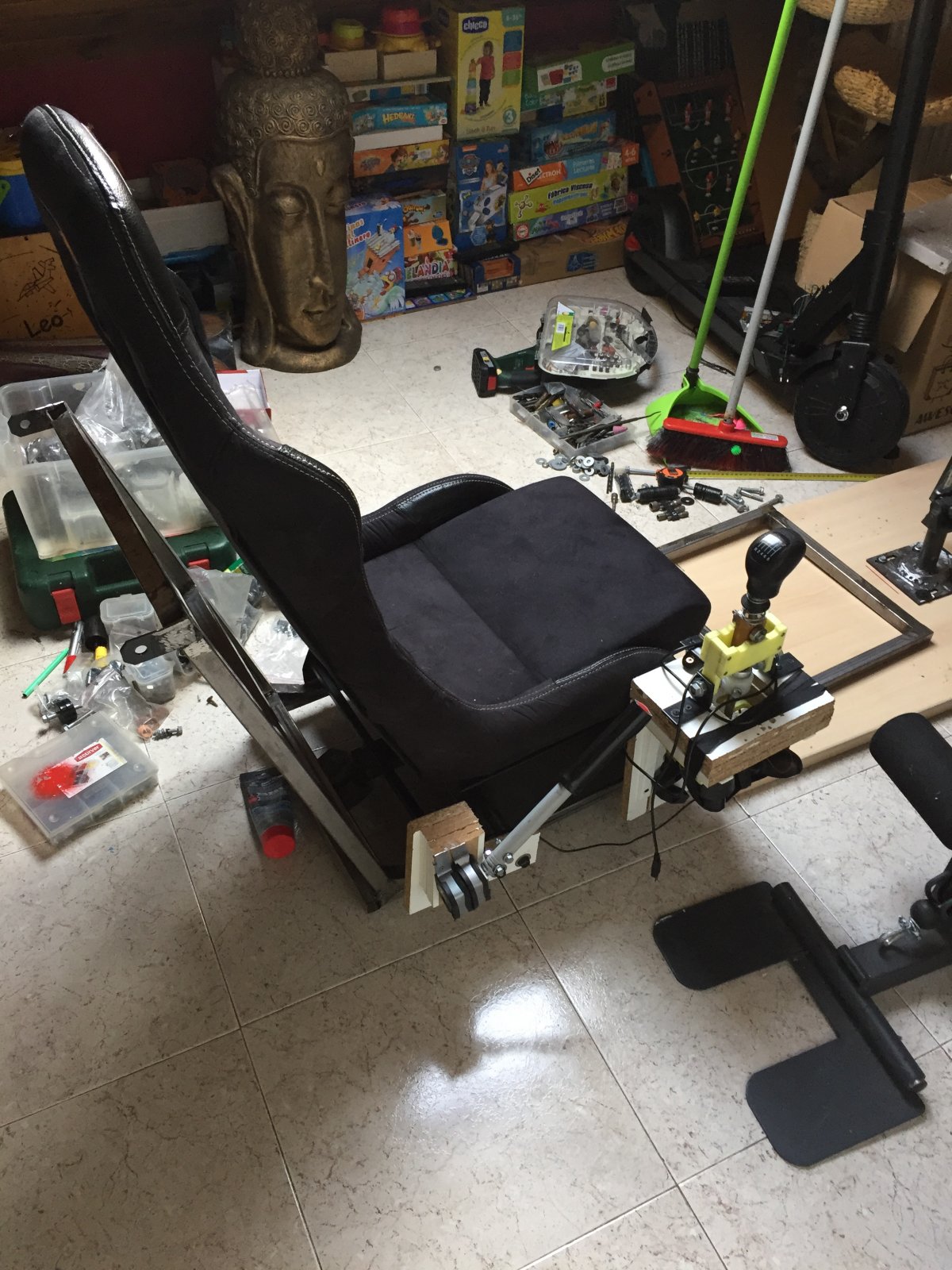

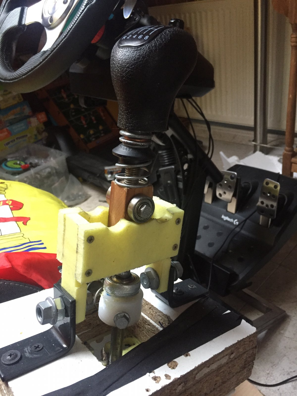

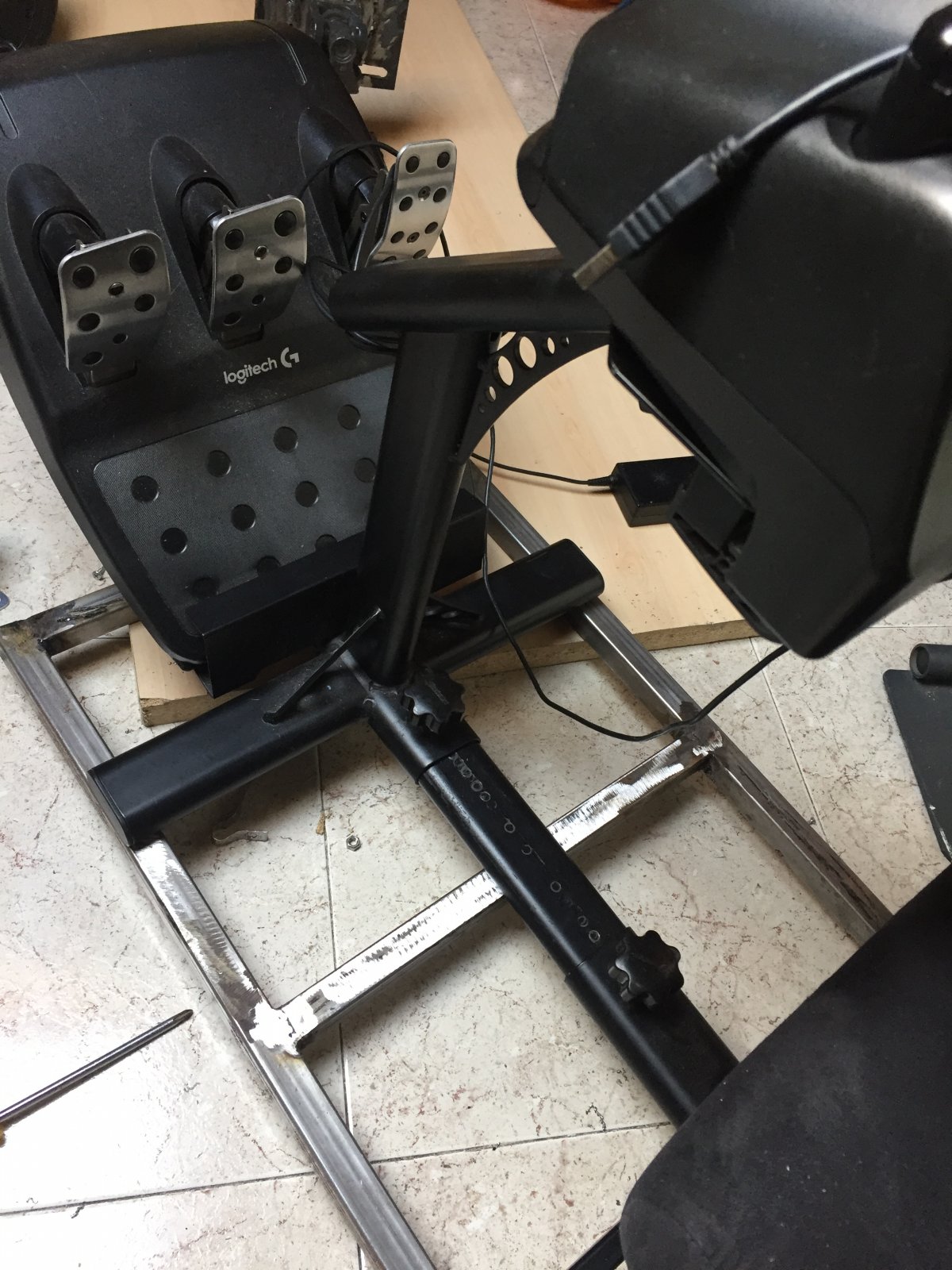

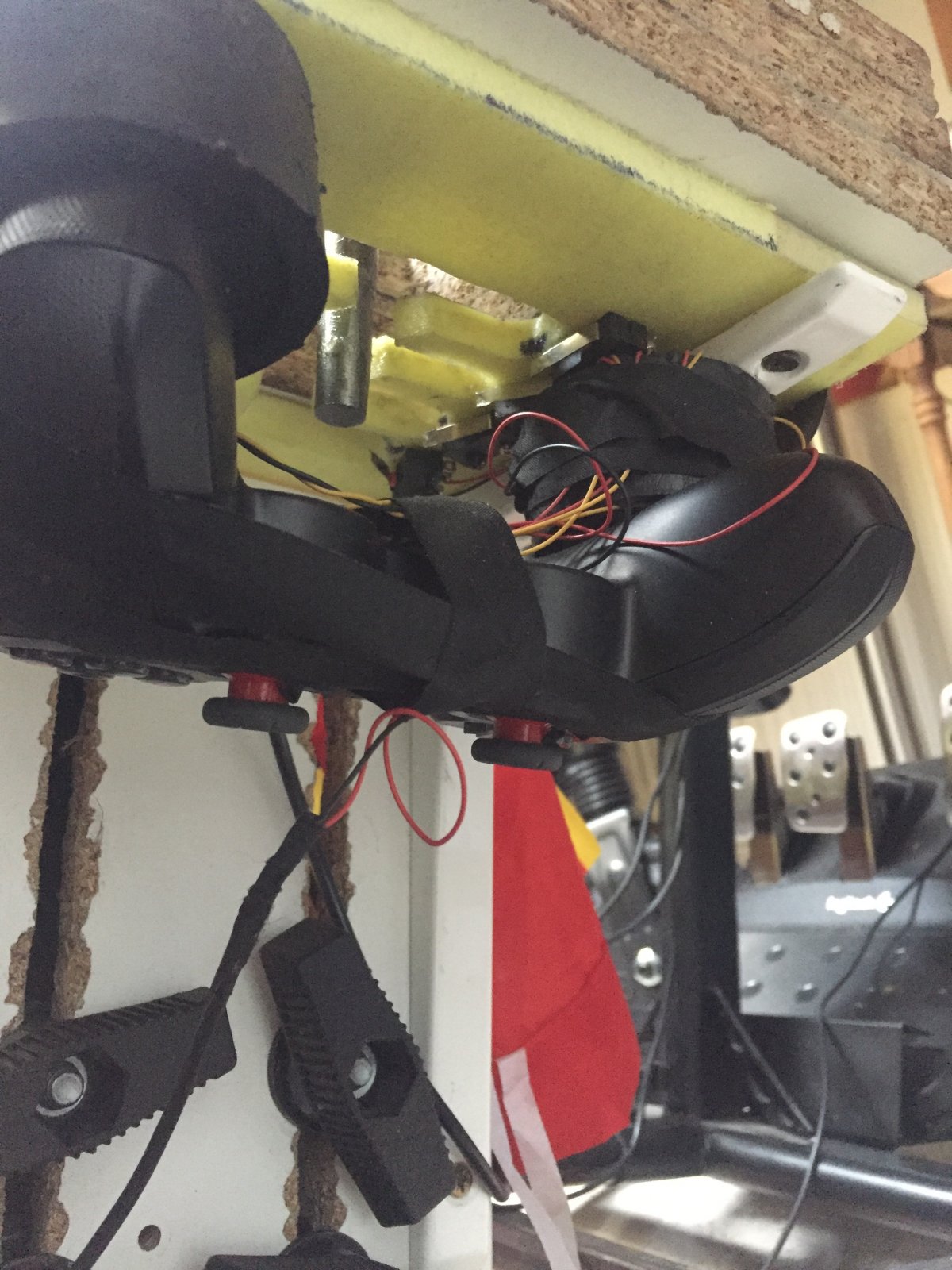

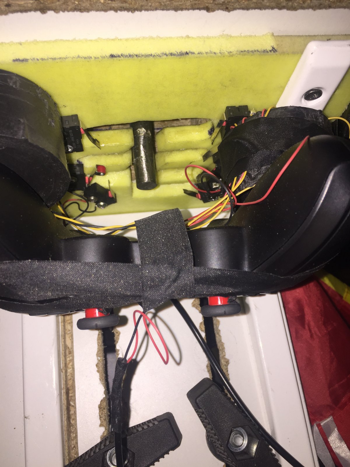

    hello

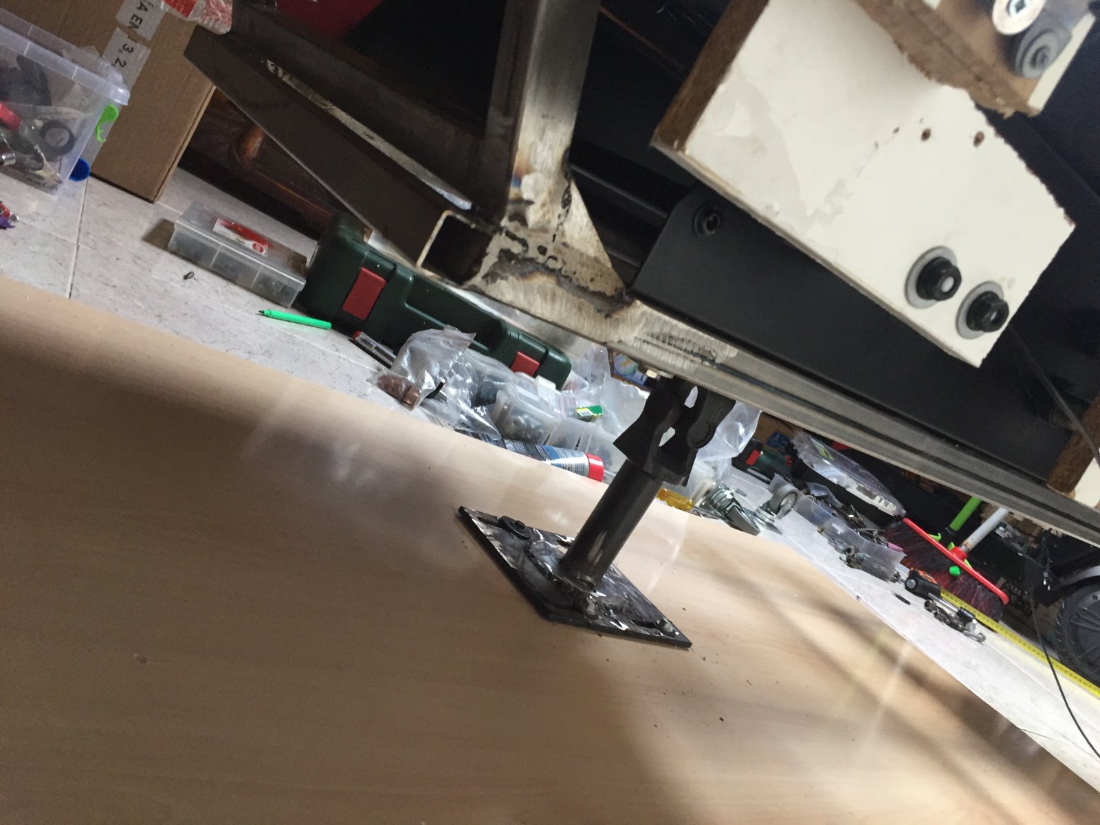

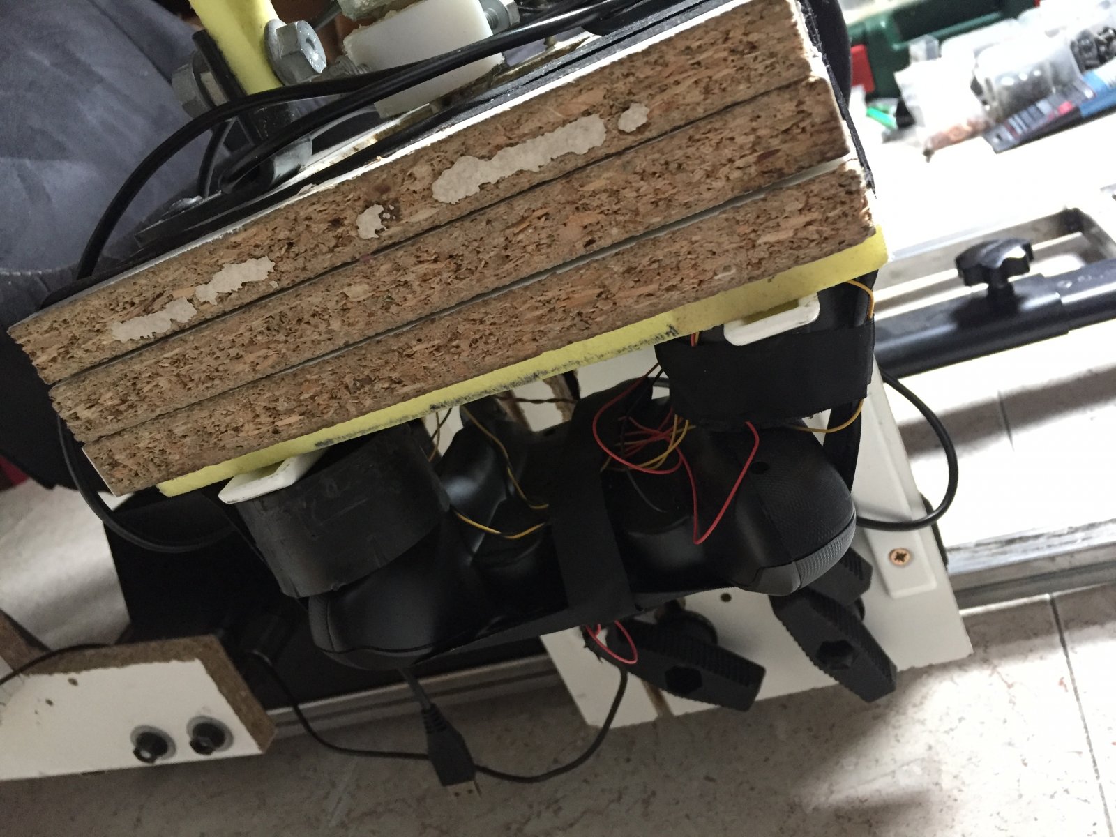

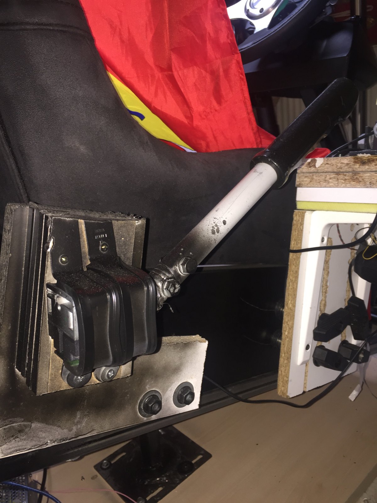

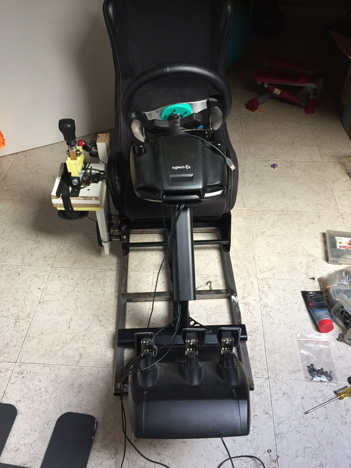

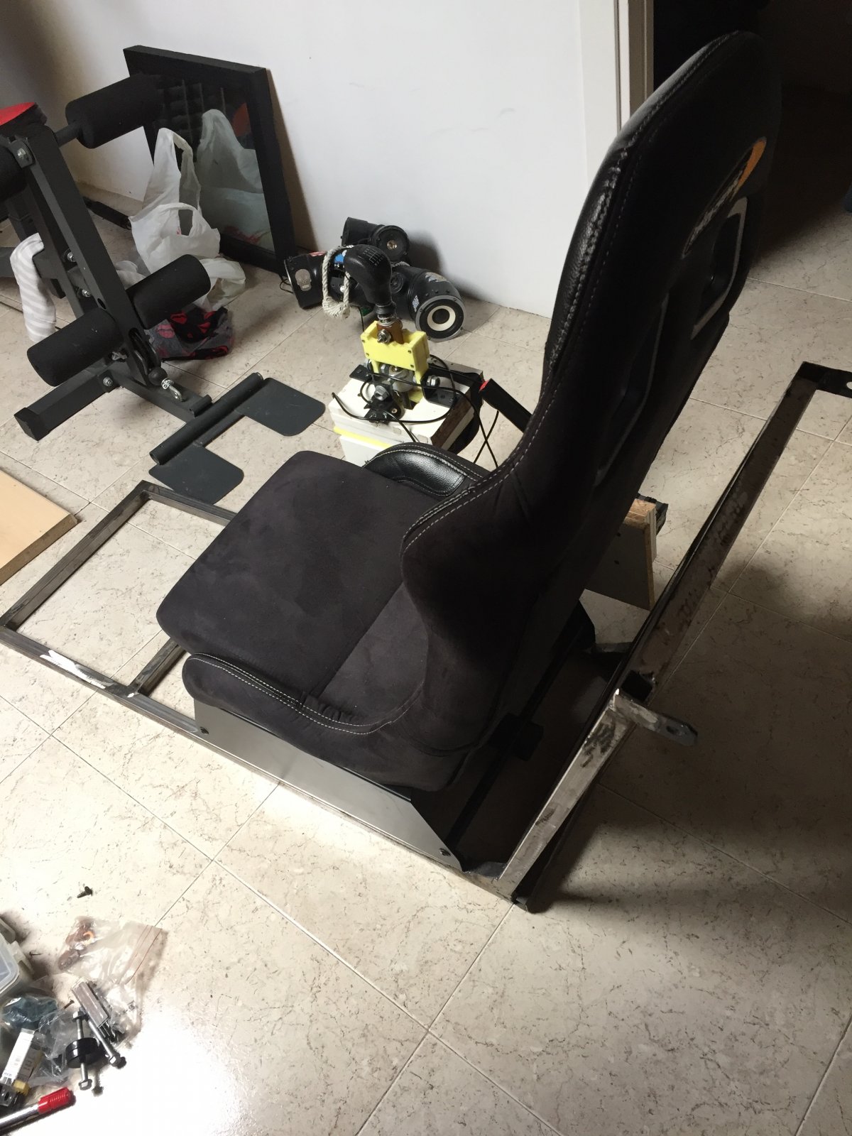

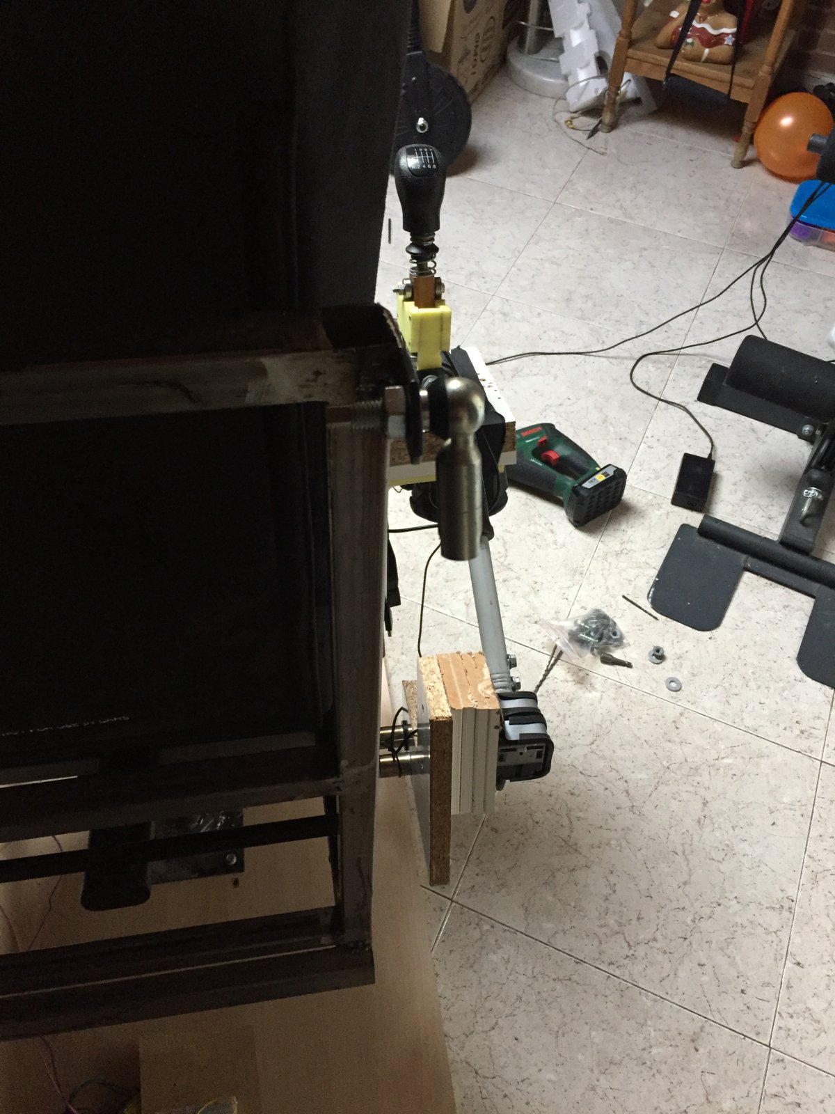

    these are the advancements h shilter and homemade handbrake
    B8A9F5D2-F195-4251-92DC-071C45570462.jpeg image.jpg image.jpg image.jpg E9F48BB5-2A34-4514-96C6-24A3F9FC00C5.jpeg 42DA07CB-92F2-4E82-9664-4076B7EA3094.jpeg image.jpg image.jpg

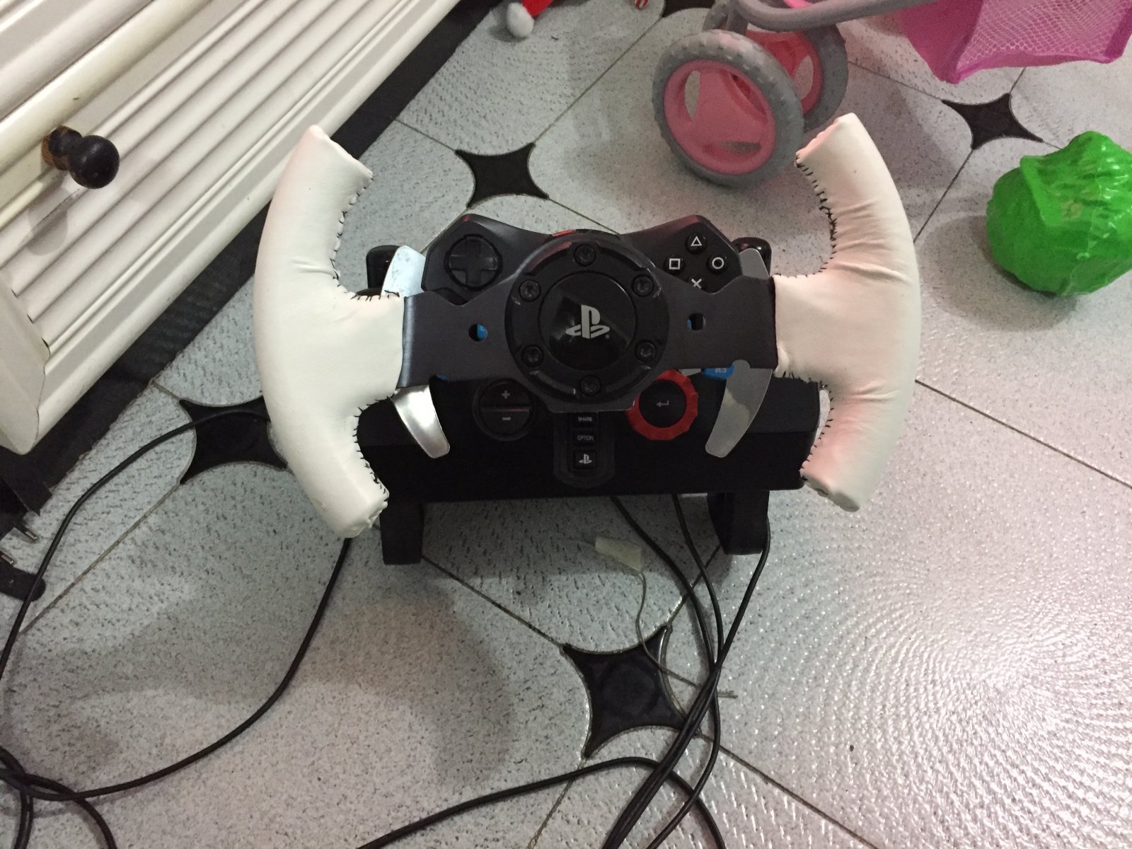

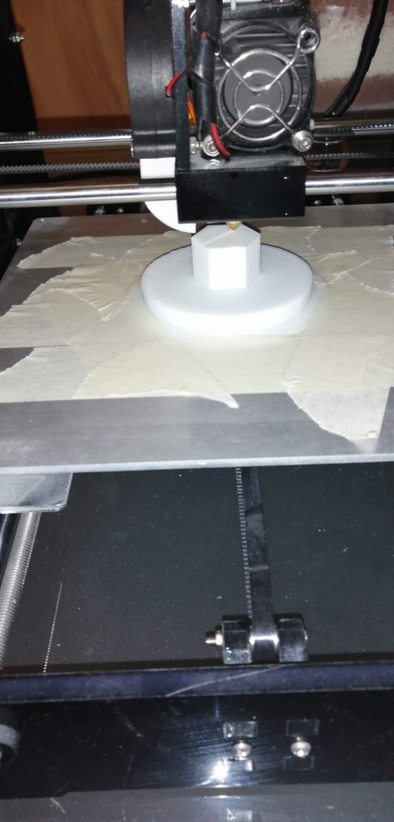

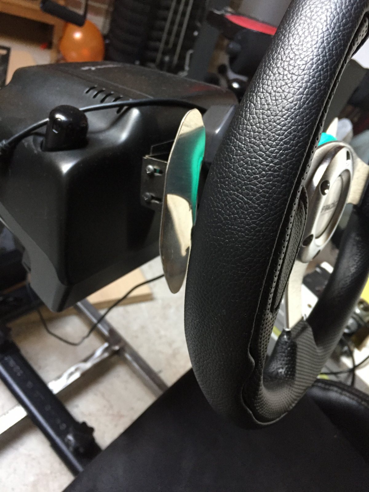

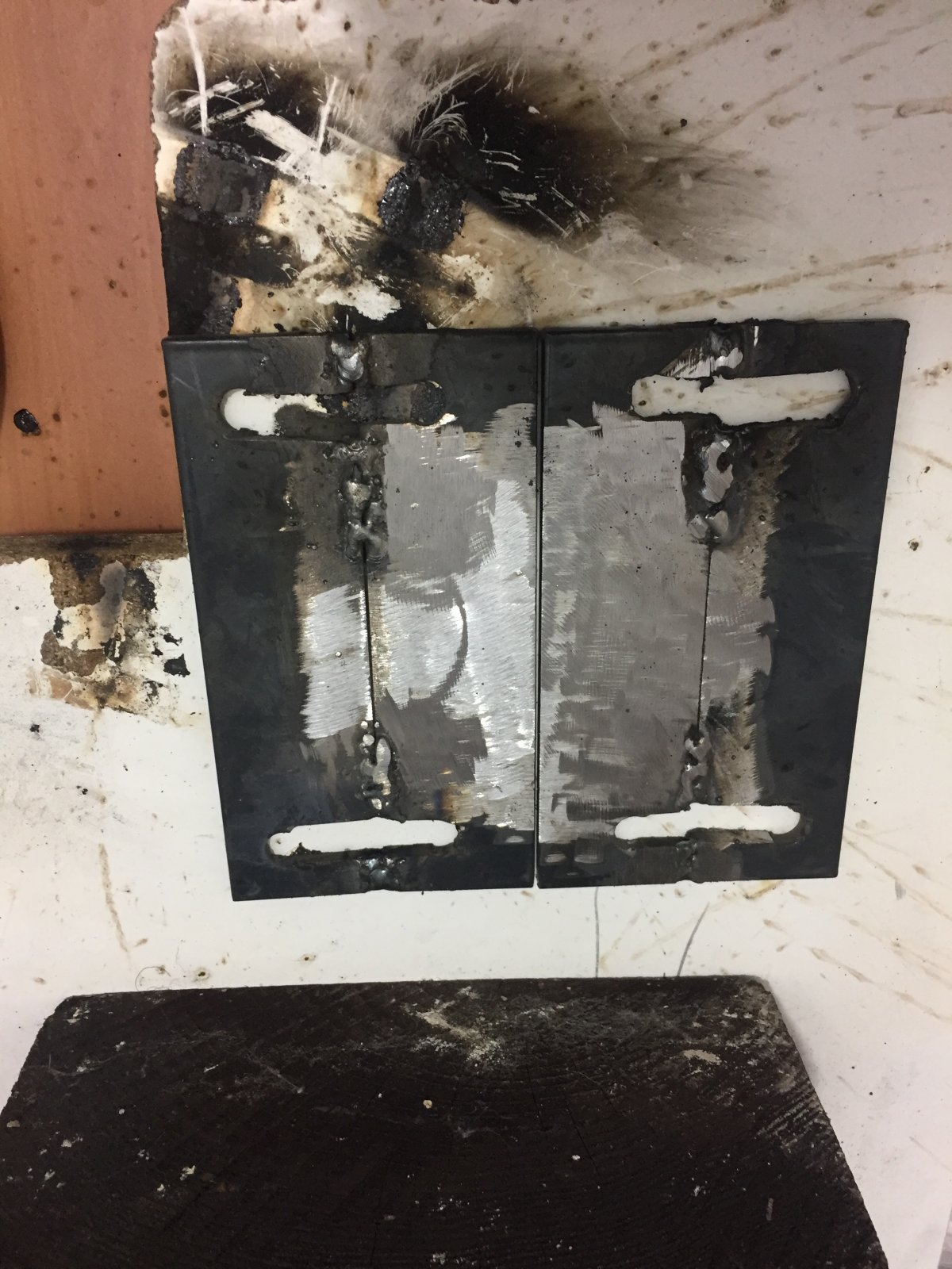

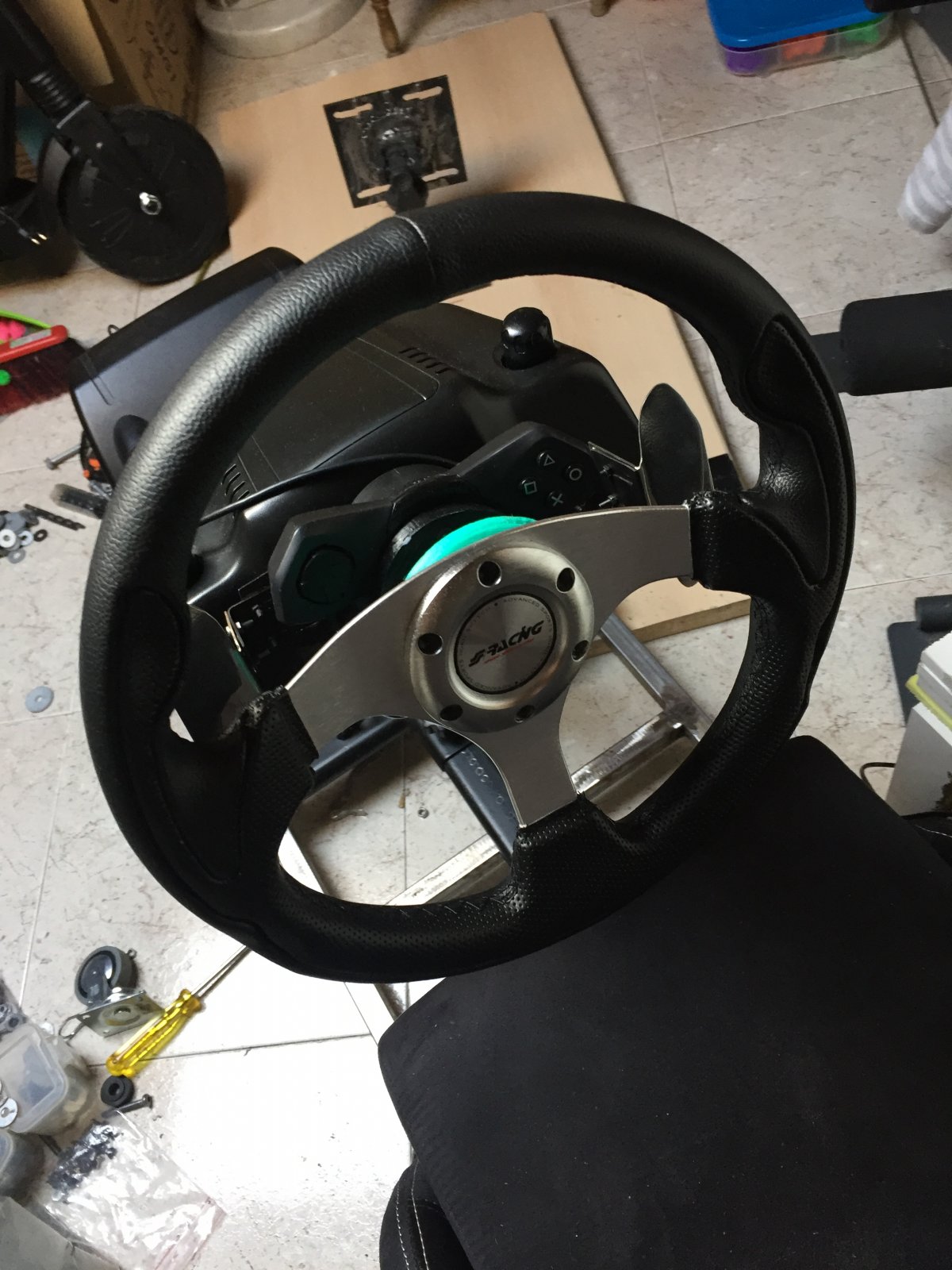

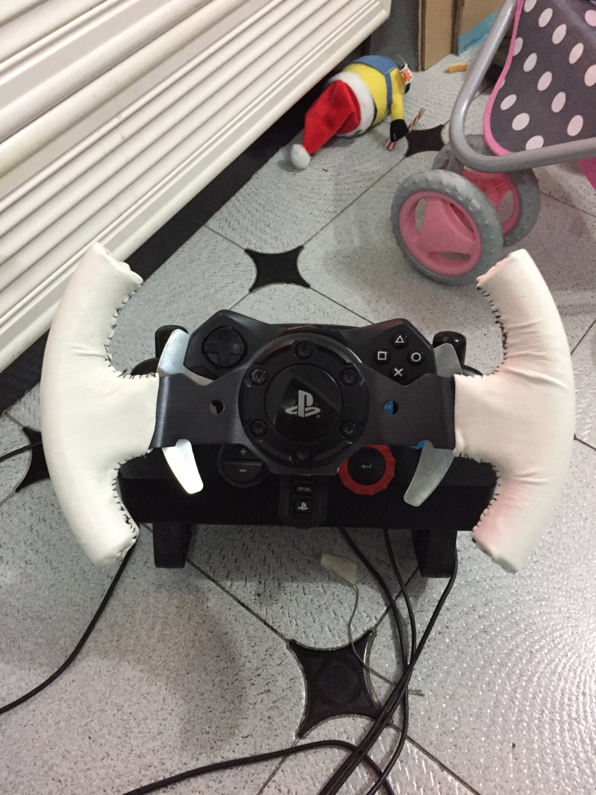

    G29 steering wheel modification and paddle change sport steering wheel adapter
    28046E6E-60FA-4BC6-8410-4FD7B064F511.jpeg 19806B68-D816-4E8D-A493-3F36B6E2FEDE.jpeg 3651AA2D-FD1F-4E69-92FC-E556082FA8C6.jpeg 8B6B2247-FF6E-497D-A3AC-6AED2DB42C30.jpeg 3BEA0438-4197-44CC-BF6F-7EFD888964E4.jpeg 9A21665A-3521-44EA-A5C0-A07F93671B2A.jpeg CCFFA147-E33A-4415-8559-4605053DEC82.jpeg 321393E2-EEE0-424A-BCEA-4AD6EA377B39.jpeg

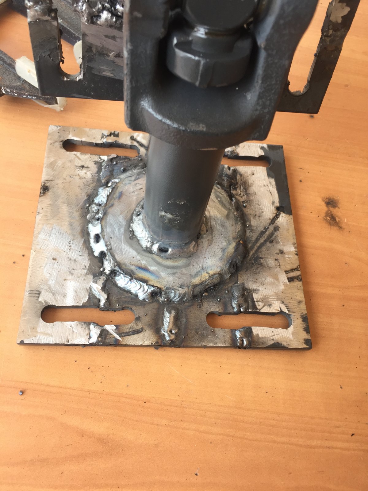

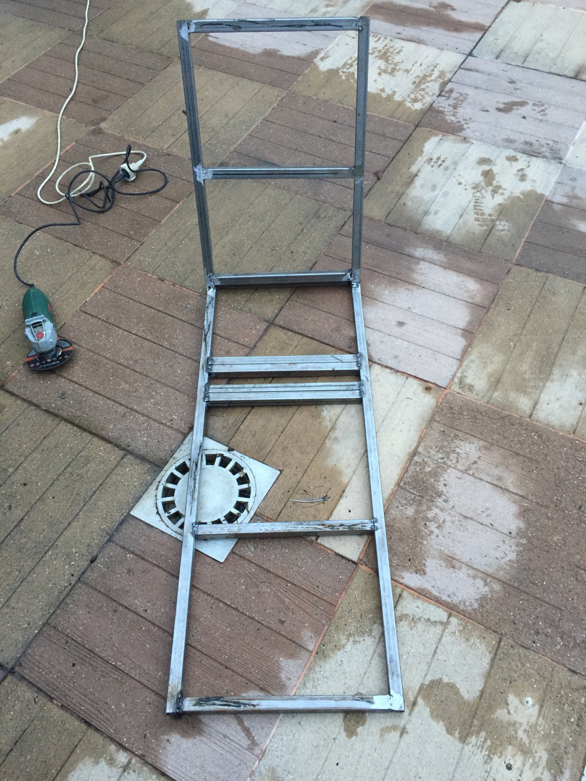

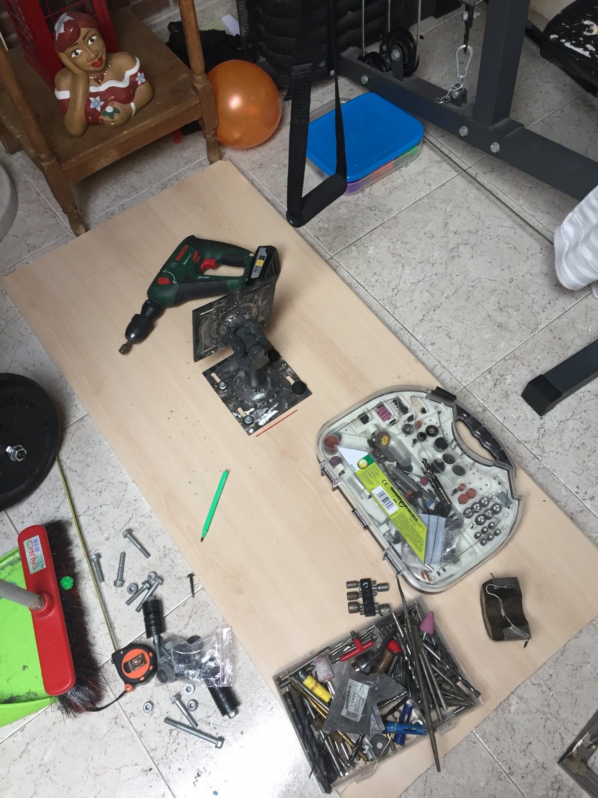

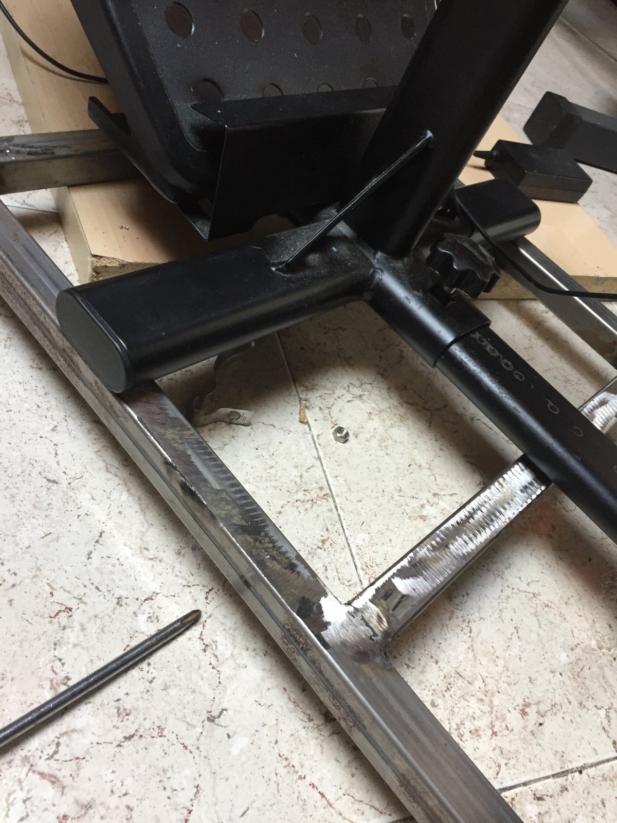

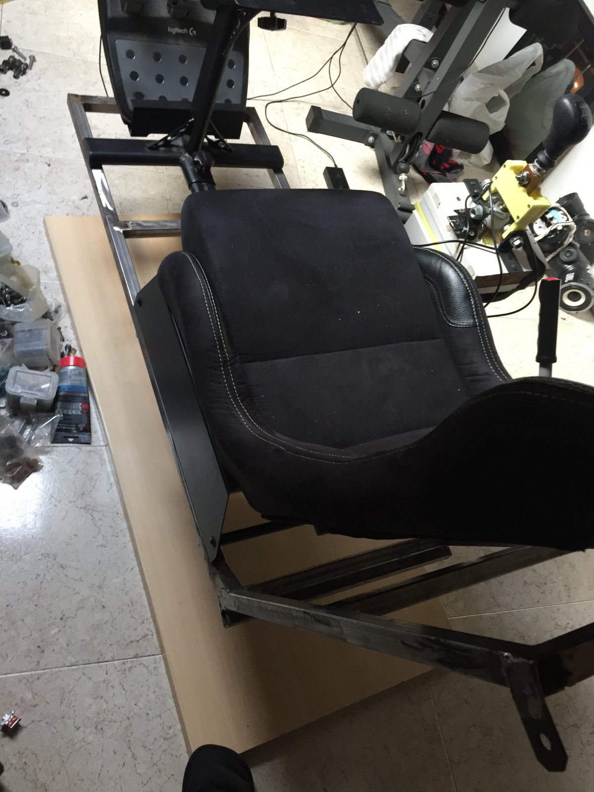

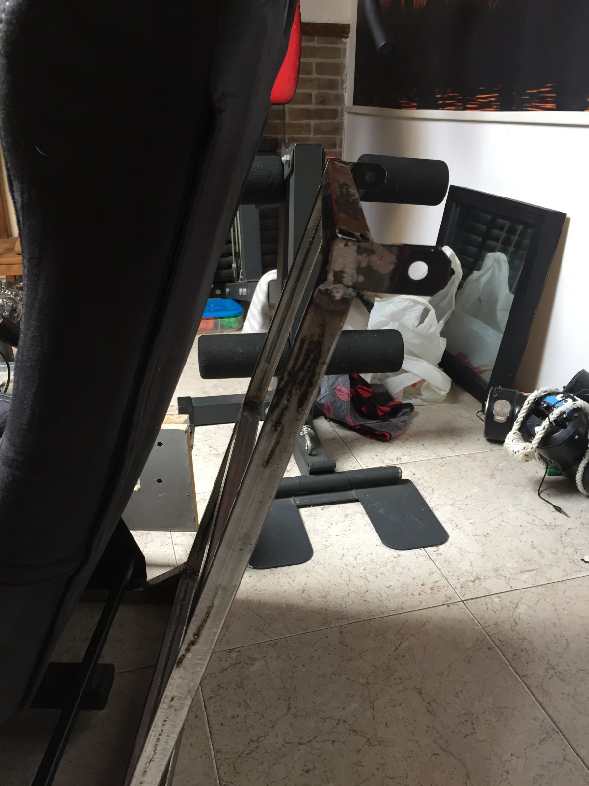

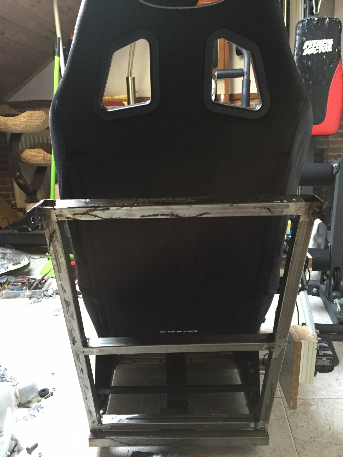

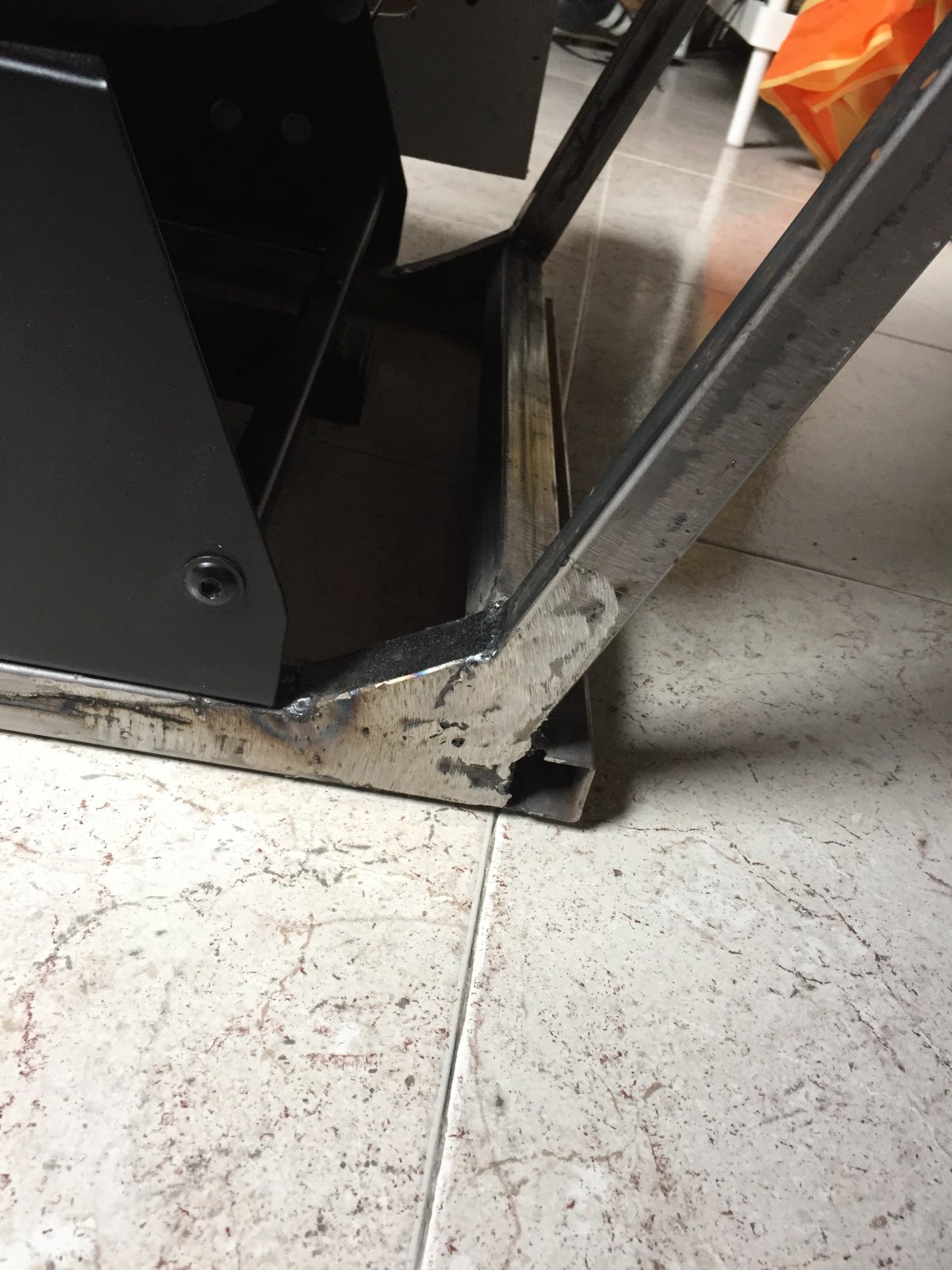

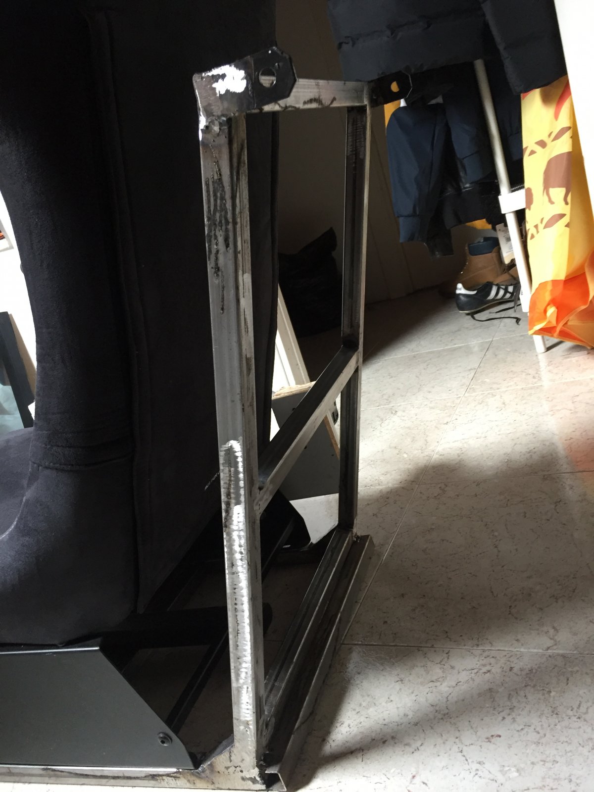

    the base is a wooden plank the seat is a playseat the structure I have made with 2x2 iron slats
    26F0AA9A-C983-4A0E-A5E1-25877FF71623.jpeg 4B83B014-78DF-46C8-A167-19B576198773.jpeg 8910CC2F-3F1C-492D-BF90-B853FAE53659.jpeg FFF7C9AD-42C5-436B-9CB1-3F771E6DCFF8.jpeg 71894F42-80F4-4716-994F-9CF0F8F24009.jpeg 7A486277-2711-42BD-9AD0-CDC586F2A71F.jpeg 8E2D896D-C20D-4DD5-8380-0D42A19A7C68.jpeg A2379AE2-7E55-42C0-957A-51844F2B3FEF.jpeg 1050C002-FDCC-4CBE-98F6-D623D6BBF5BF.jpeg AA343F81-943B-4992-BEA6-419D9CA9CE2A.jpeg 17CDE6CC-D1A0-4EB0-A592-7DB4CF4F2161.jpeg 5A1A0815-12BC-48C8-83FF-B89CBFC91CA5.jpeg B0F67A8D-92D4-44EE-8111-8FADF8E39391.jpeg CD861DA4-7690-4AA5-A4CA-247489C0EBAF.jpeg 83D38766-B31B-408F-9EFE-BB3FE70F1386.jpeg 921FF1C6-229C-48CD-BF19-8665911D597C.jpeg 9AF46326-703E-4016-B0D6-3E783B759645.jpeg 42DA07CB-92F2-4E82-9664-4076B7EA3094.jpeg E9F48BB5-2A34-4514-96C6-24A3F9FC00C5.jpeg 9AEA1D12-4EB1-4A61-8835-20B59F07EA8F.jpeg 16491E7B-9341-4A0A-B942-0ECE2BB9C6F4.jpeg 5AE96B19-98FA-40F3-AE71-3A2E19D97B2F.jpeg image.jpg image.jpg image.jpg image.jpg
