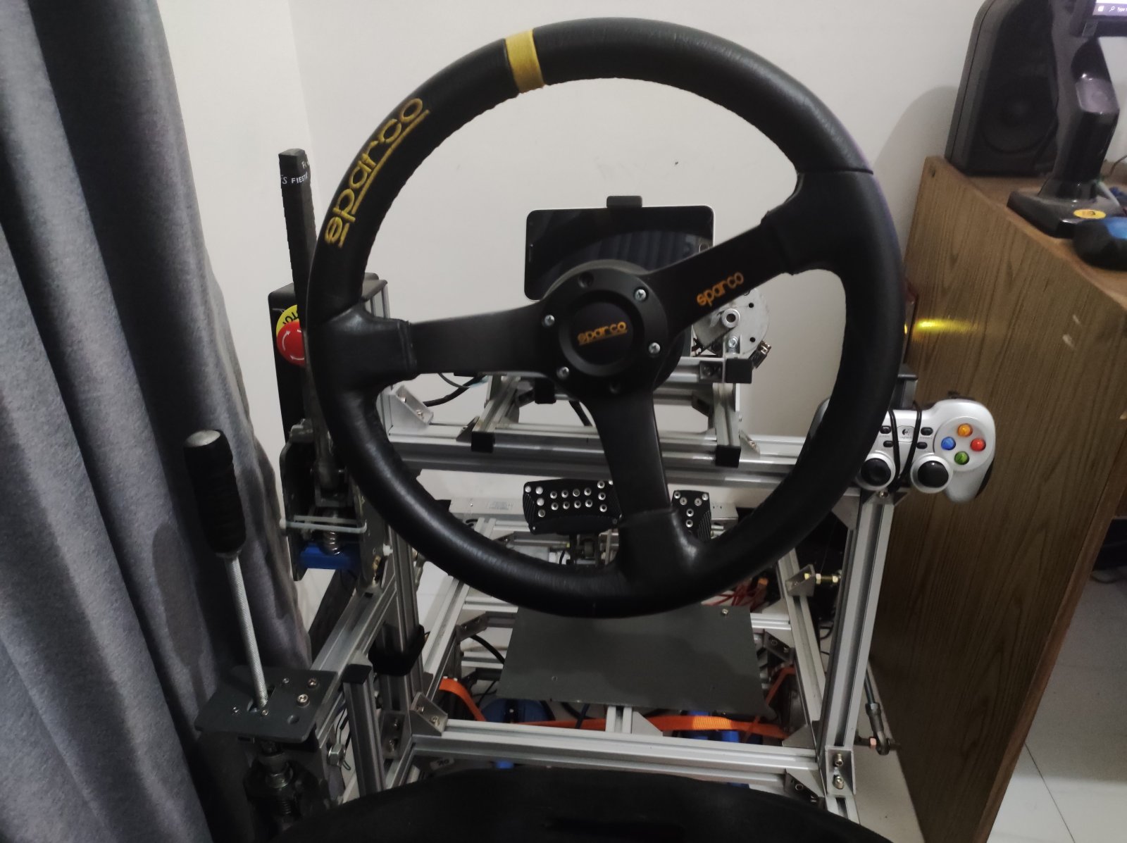

    Another update.
    Done another rebalancing, got the seat a little bit to the front.
    I realized that when my brother help me, he's not seat in proper posture. He's got awkward posture lean to the front and this is make my rig balance off.
    Another thing I do is revised my lever length as @noorbeast advice. And I get help from my neighbor to weld my motor lever and He's a bit of a OCD person so I got literally 40mm both of them. Which is nice!
    And now after playing an hour, my engine and motor driver barely warm.
    I can say my motion rig is done and I'm very satisfied with the result.
    Thx again @noorbeast and everyone in this community. You're the best!
    Cheers!!

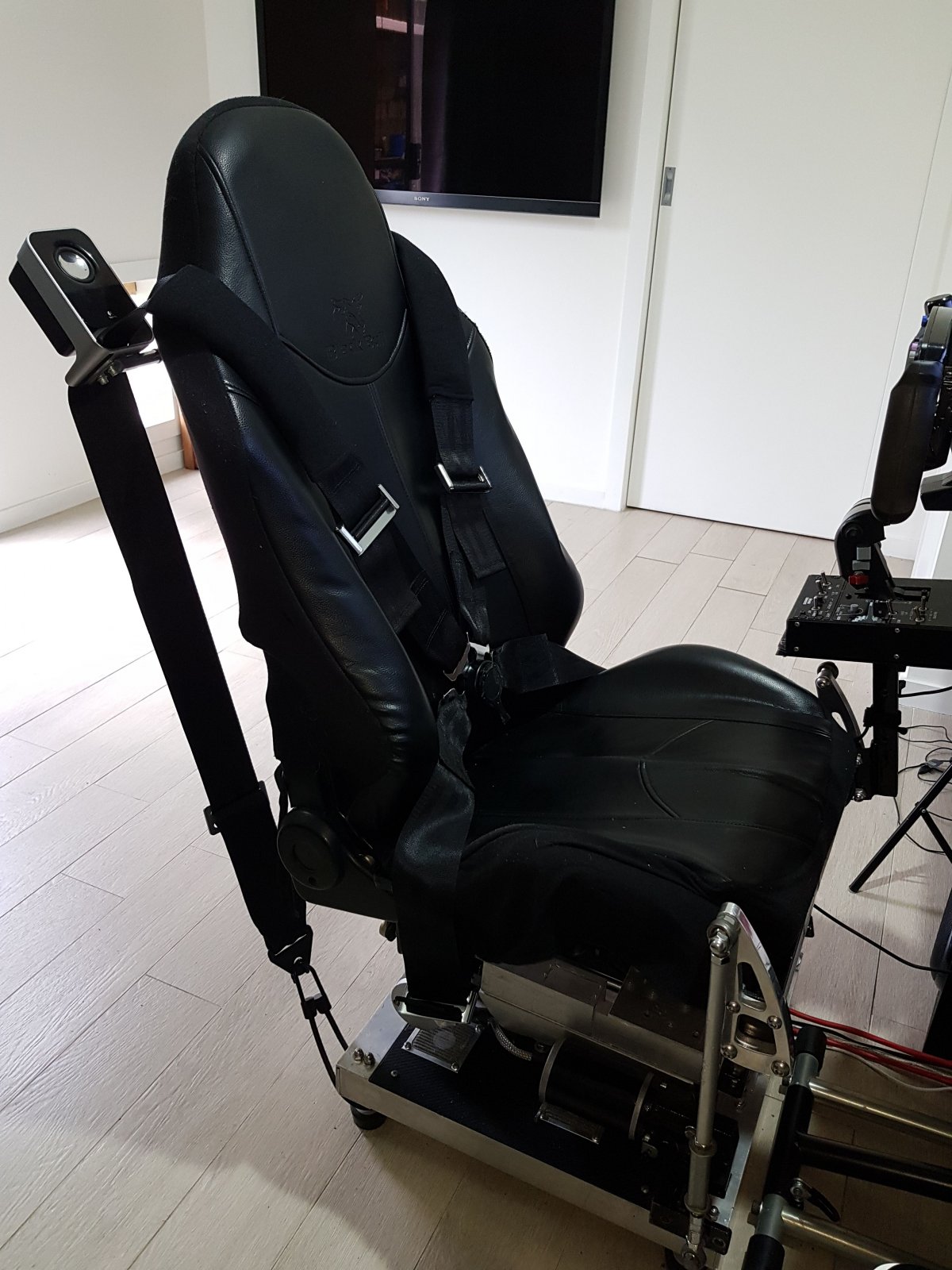

    Yes leaning away can throw off the rig balance, it also reduces the fine motor cues.
    The best thing to do is add a cheap 4 point race harness, personally I use a 5 point harness on my rig but 4 is adequate and much more convenient. What that does is keep the user in position, but it also can add additional motion cues if the shoulder straps mounted via elastic cords or springs. That way the harness tightens or loosens slightly as the rig moves.

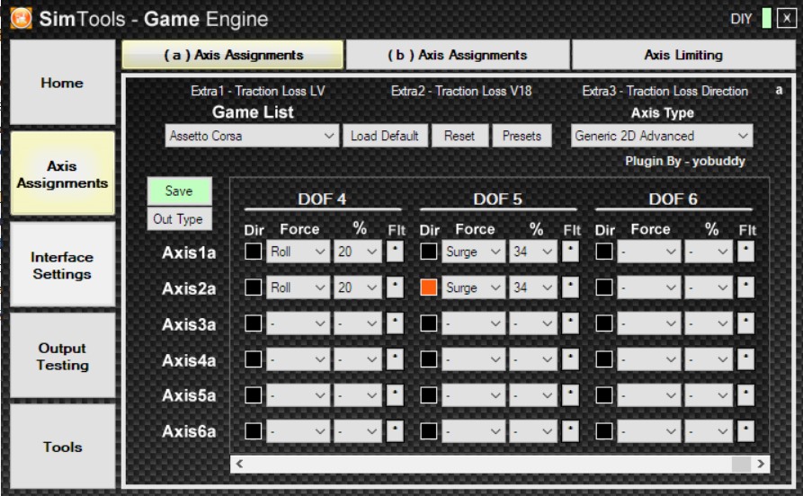

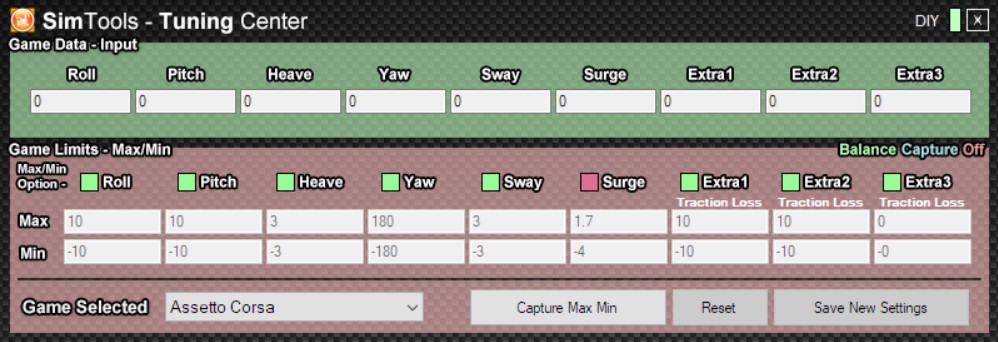

    but before I do, I have a question. Which settings should I change to make the surge effect get a big travel when decelerate. I think it's necessary to get more immersion. But I can't get it right. the accelerate effect is nice and gear shifting really snappy, but the decelerate I think it's not enough.
    any suggestion @noorbeast ?

    What car and track(s) are you using in AC to tune your motion profile?
    My main suggestion is temporarily turn off all other axis and focus just on the surge effect for initial tuning, then tweak after the best settings are found and other axis are enabled.
    The other thing you can do, after you have nailed the best generic profile settings in a medium range car and track, is make variations of it to suit particular cars and tracks using the Profile Editor in Game Manager.

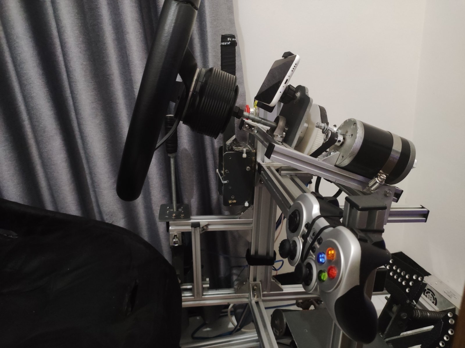

    Some game play video.
    My 2dof rig sim been finished, but in next future I'll upgrade my DIY pedal&hand brake using almunium material and I'll add dedicate monitor to it.
    Some question, it's better to attach the monitor to the rig directly and moving with the rig, or it's better to get a monitor stand?
    Because the limited space, I have a plan to get a small ultrawide monitor, maybe a 29inch.
    Some input will be appreciated. Thx!
    21,723
    152,051Coins
    +11,063 / 56 / -2
    Plenty of members attach monitor to rigs, but keep in mind a monitor is not designed for the vibration and jolts a rig generates.
    Personally I consider VR a better option to mounting monitors on a rig, though VR also has its pros and cons when it comes to motion rigs, particularly for large axis movement rigs.

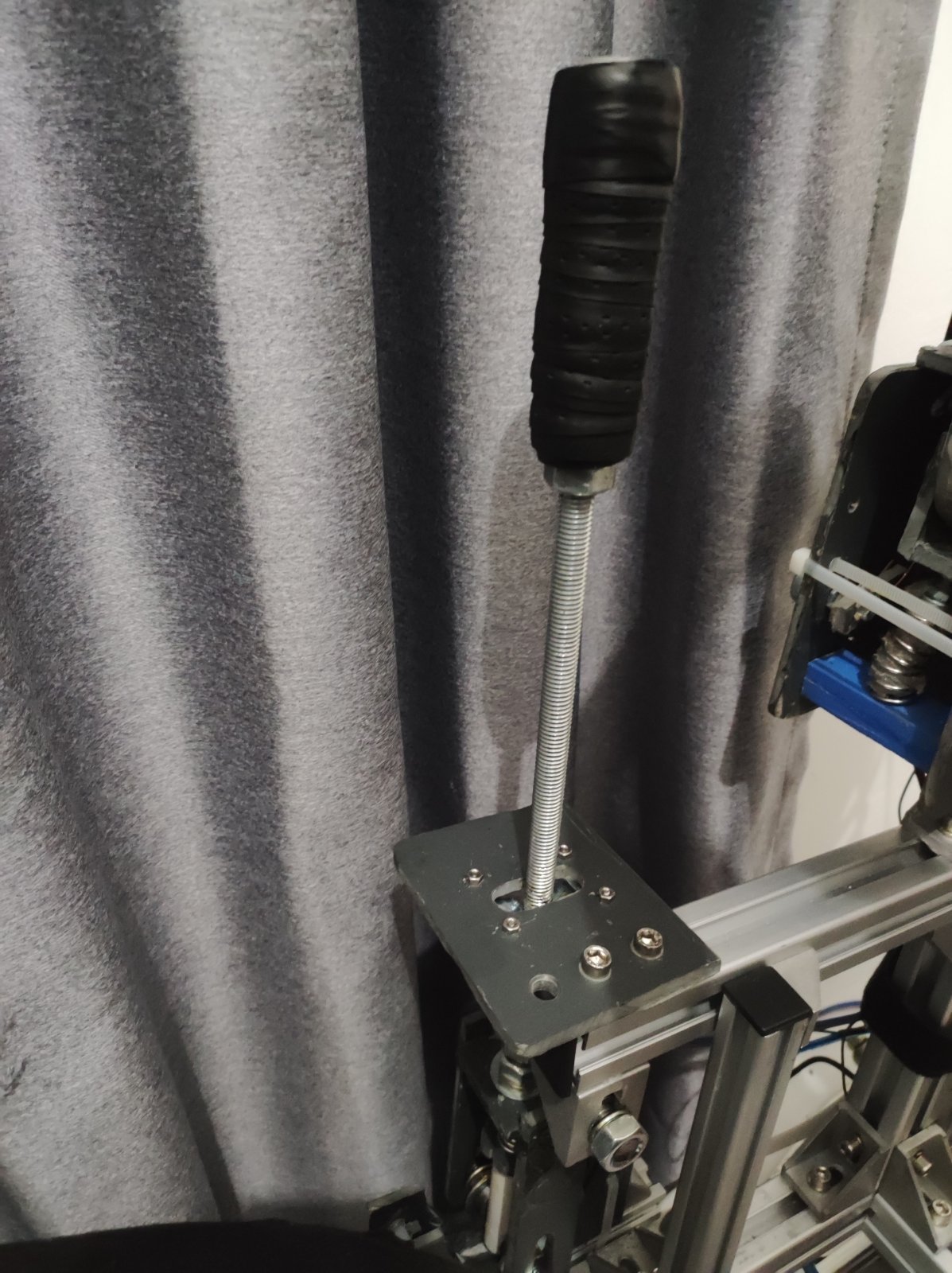

    Minor update to my 2dof.motion rig.
    Build a new sequential shifter.
    And do some adjustment on dash sim.

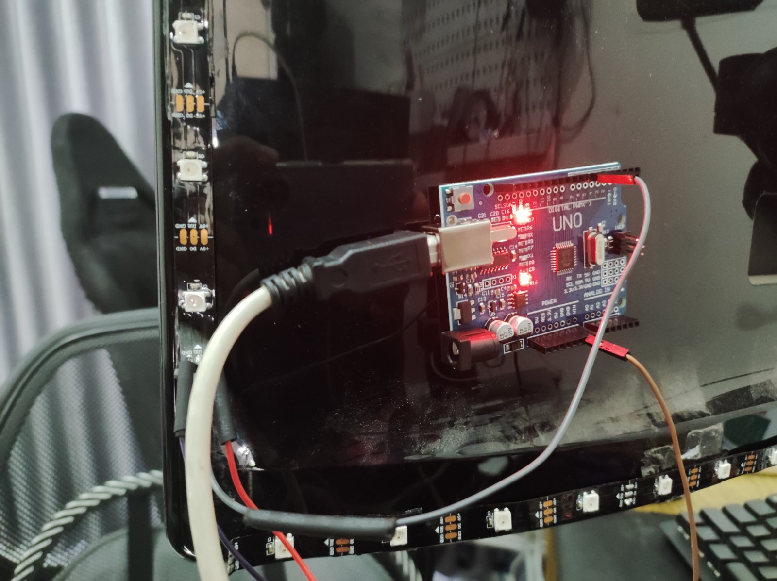

    Another update.
    Little experiment with my DIY ambient light.
    Give a more immersive experience on lighting.
  18. itsumairu
    itsumairu Active Member
    Dec 13, 2021
    210
    Psychologist
    Indonesia
    440Coins
    +92 / 2 / -0
    2DOF, 3DOF, DC motor, Arduino
    this is a short video on how it works.
