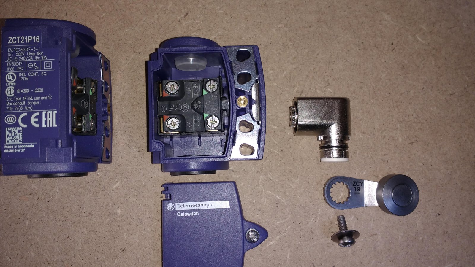

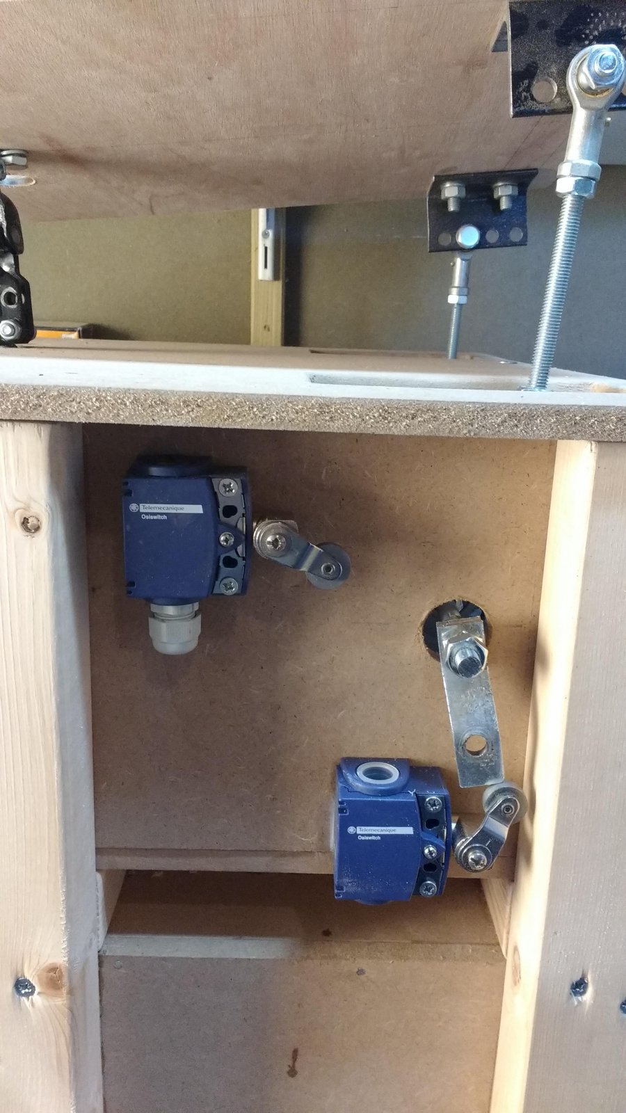

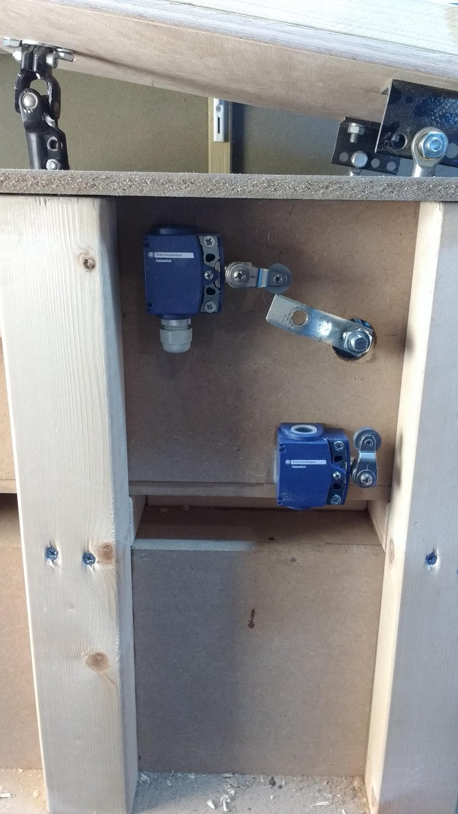

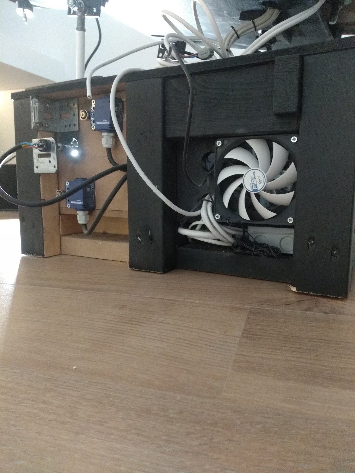

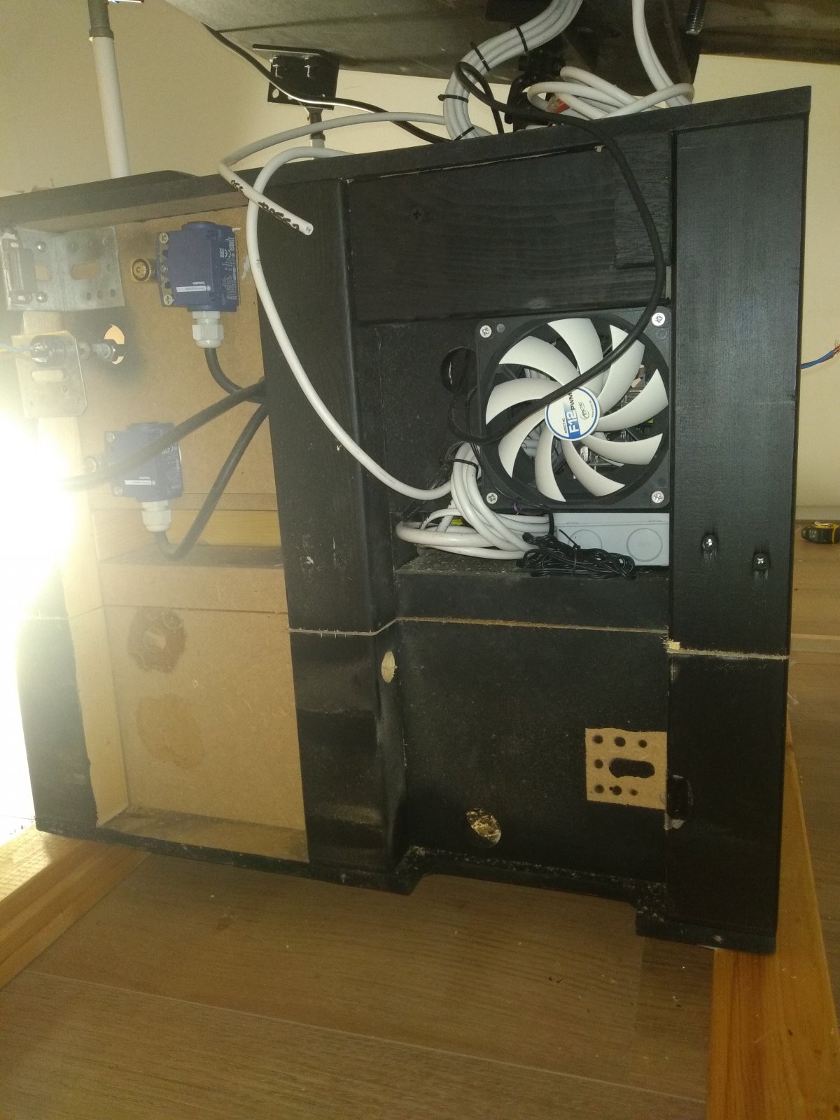

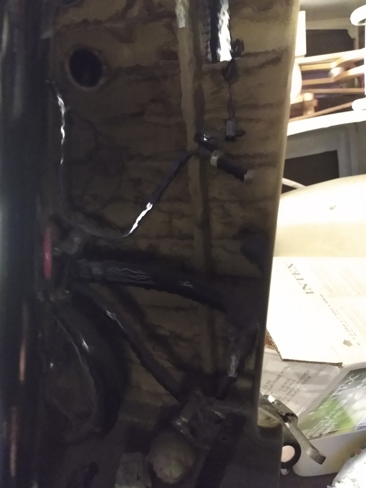

    Putting some safty switches in there.

    Working on the sim again...

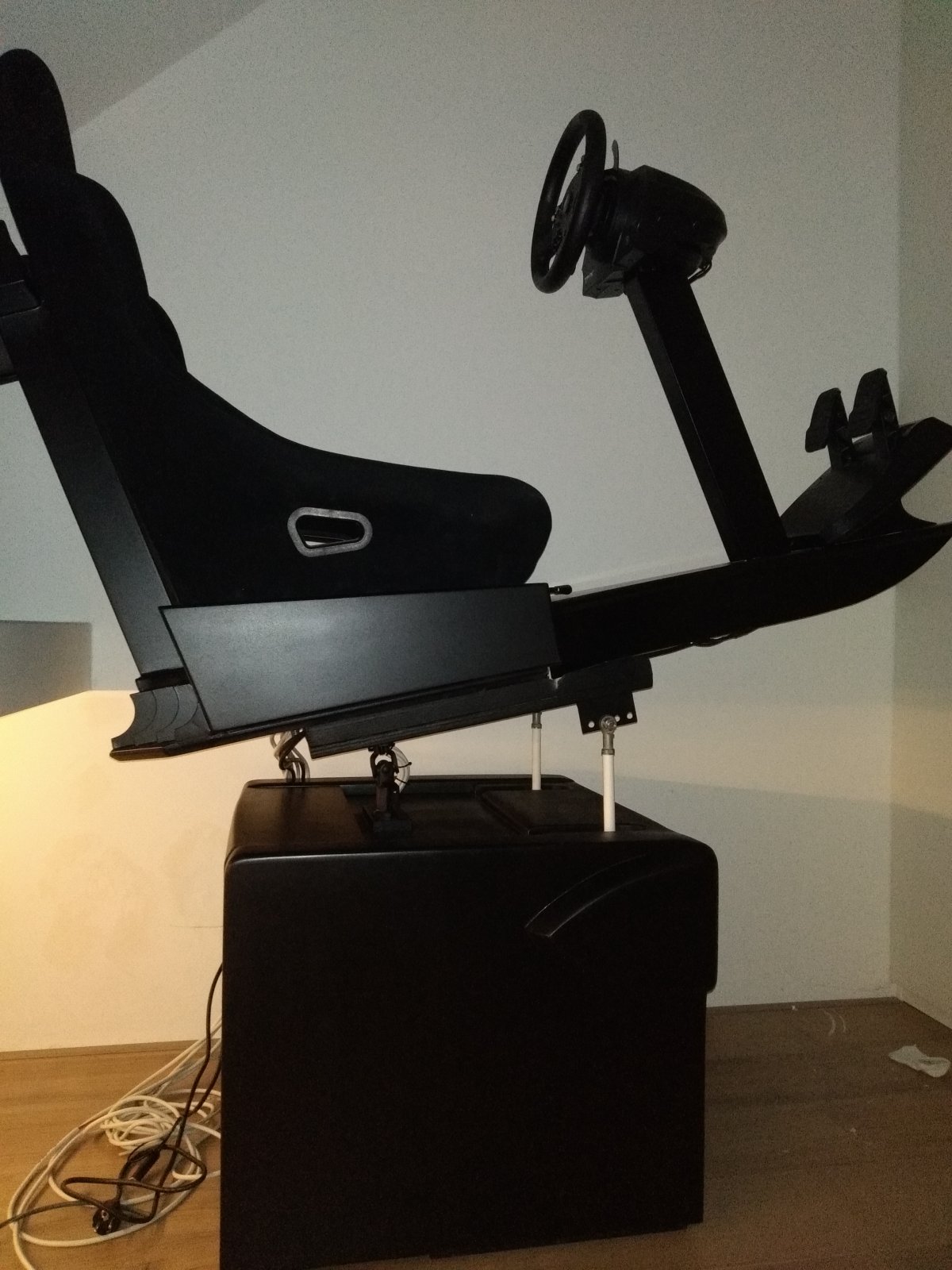

    IMG_20190531_103132431.jpg Ones you go black you never go back

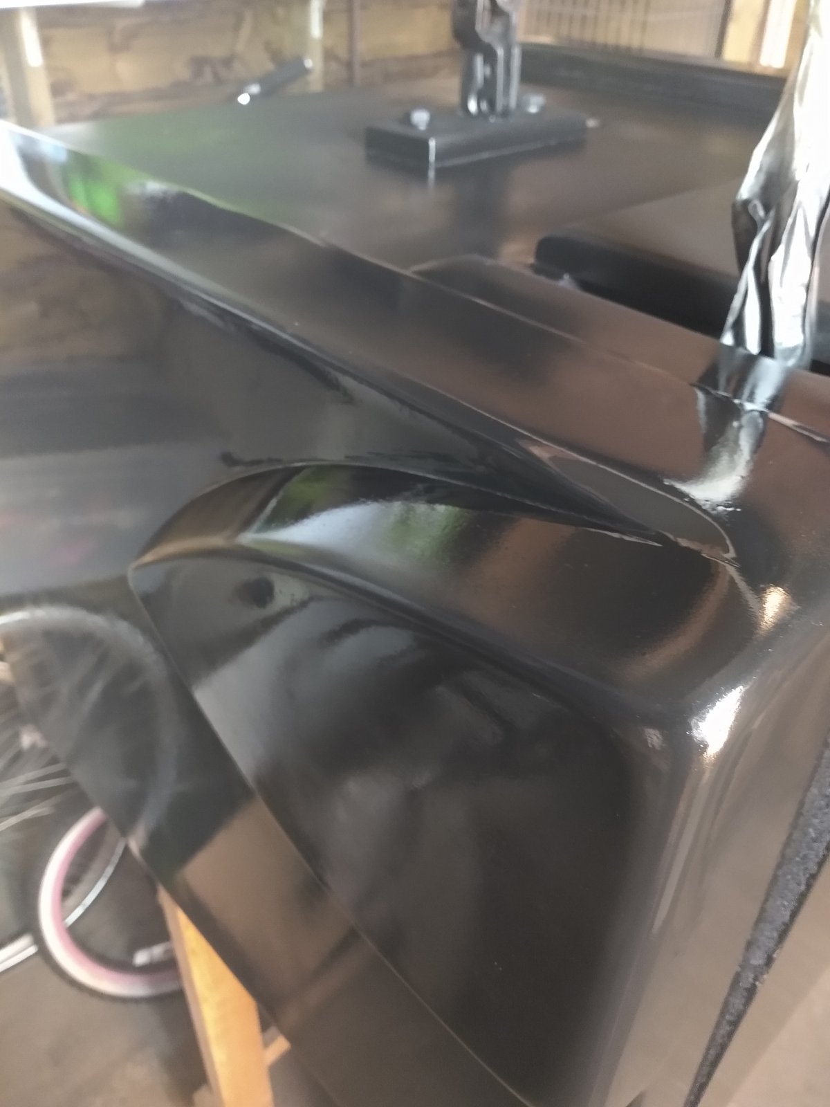

    Layer numbero uno!
  11. Brie69
    Brie69 Active Member
    Jul 1, 2018
    100
    Beverwijk
    2Coins
    +88 / 0 / -0

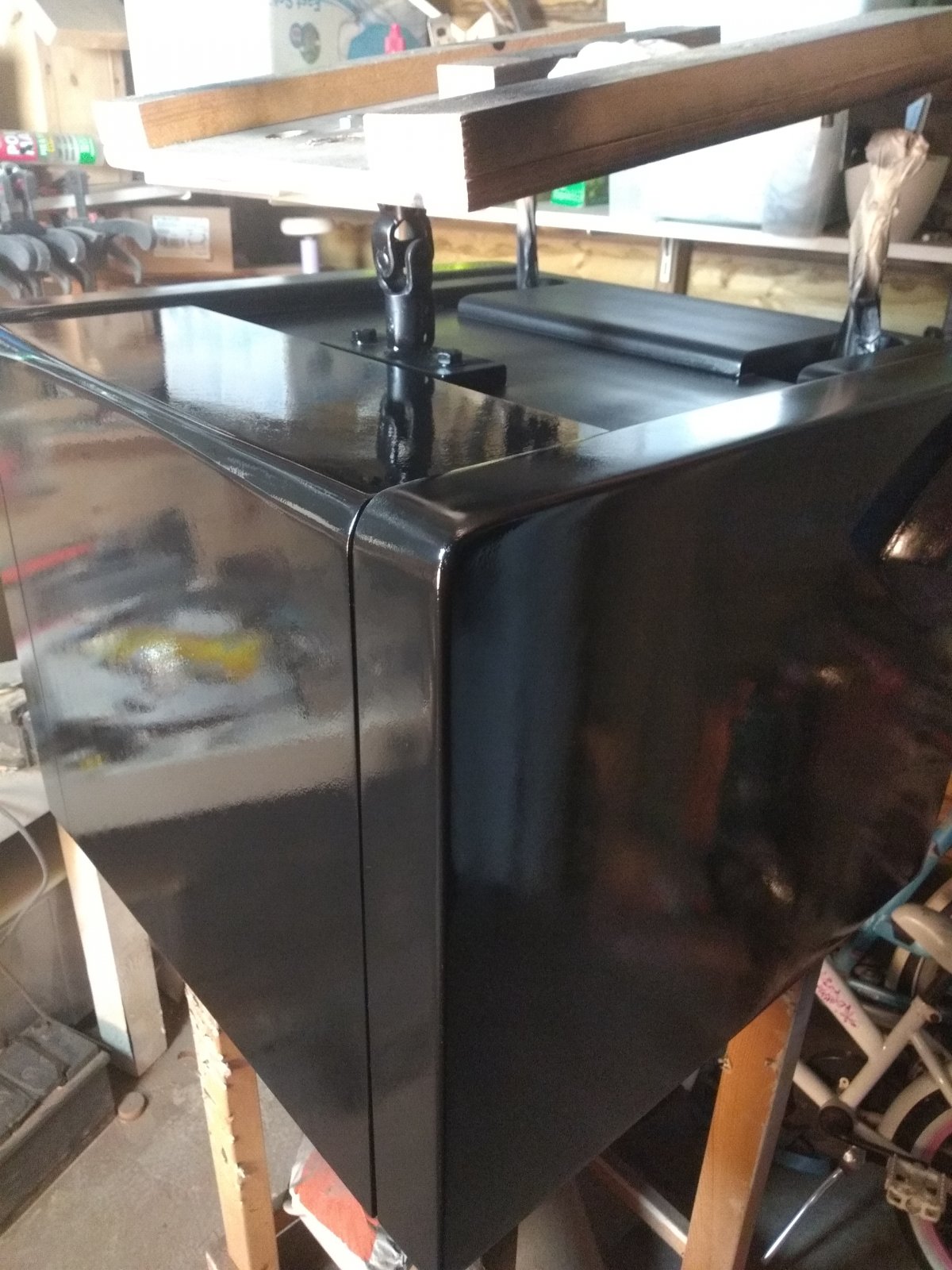

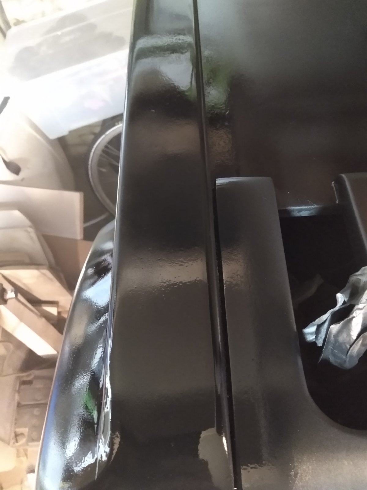

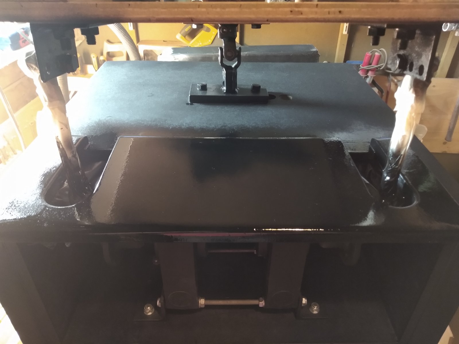

    Caution the Last Layer of Wet Paint (for now)

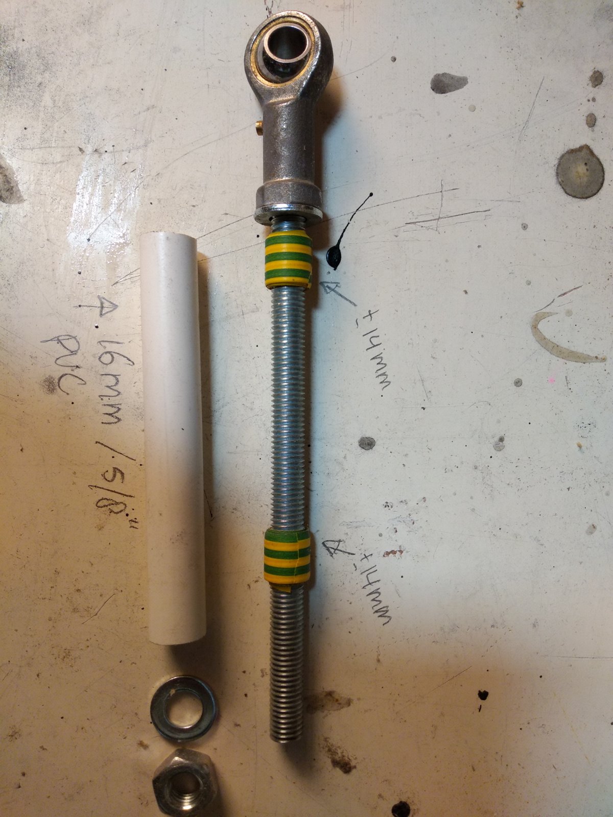

    Maybe handy for others
    In this way the PVC pipe stays exactly in the middle

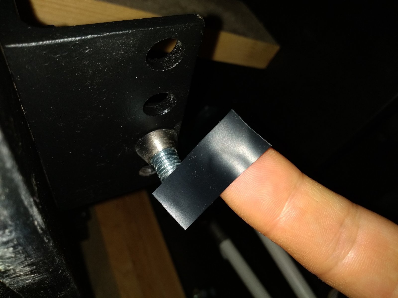

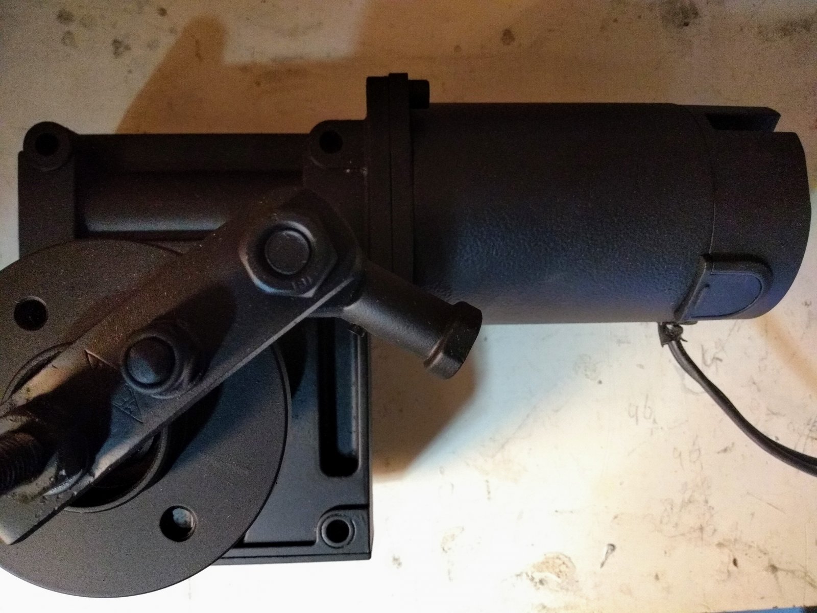

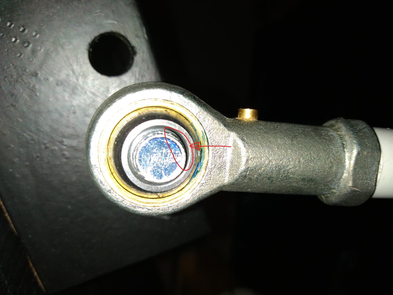

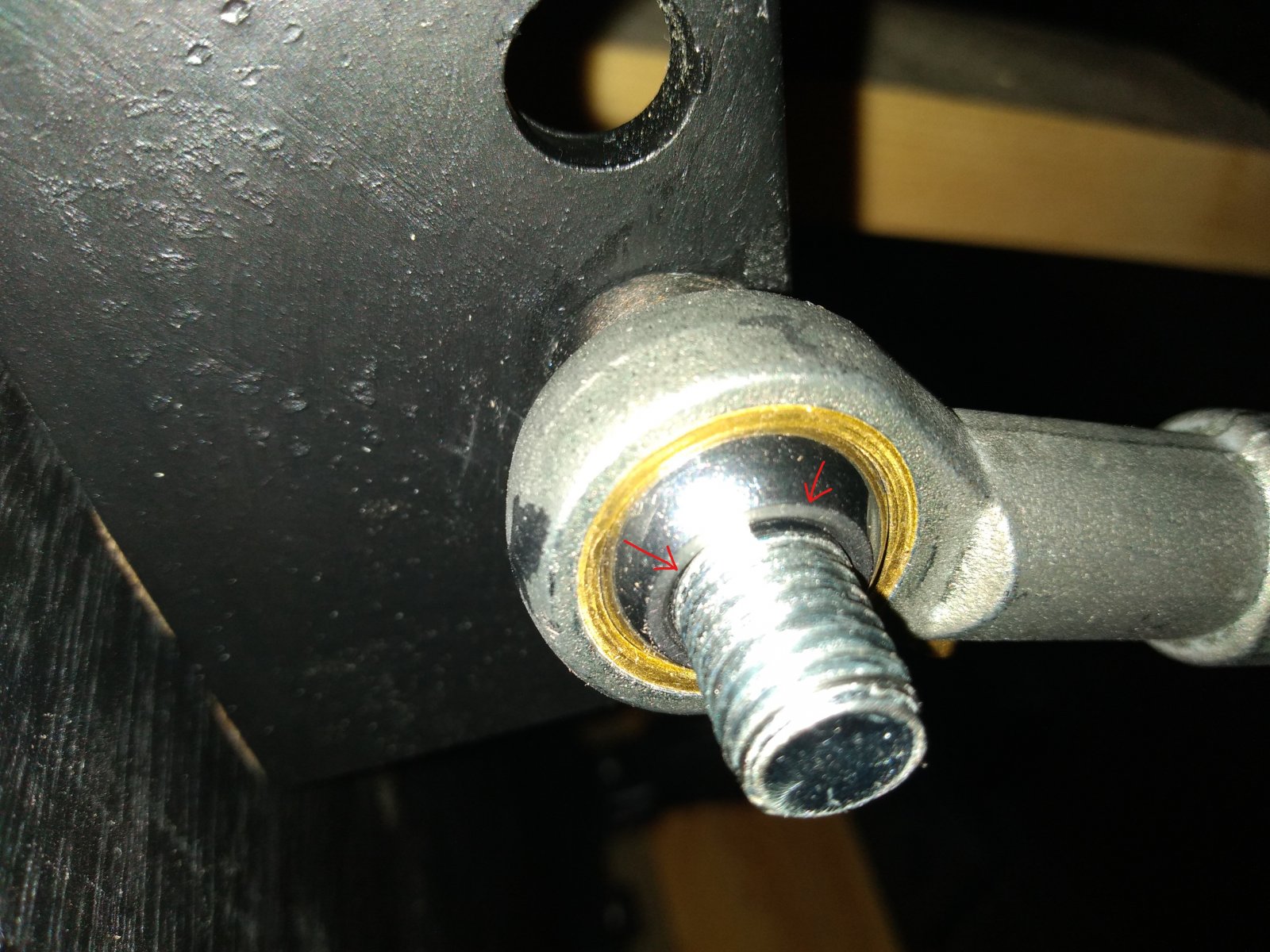

    I have now noticed that these arms make a noise due to the small play between the M10 thread and the rod head when moving.
    To solve this problem, you need approximately 2.3 cm of insulation tape. Cut the tape neatly with scissors and do not pull it off the roll. Otherwise the tape will shrink again.
    Stick the tape around the thread end. Make sure that the end and the beginning of the tape do not overlap.
    Now place the rod head on the M10 thread with a circular motion and light pressure. Do this carefully so that the tape does not curl.
    Where the red arrows are on the photo was first the play which is now replaced by insulating tape
    If you now pull the rod head, in the direction that the engines will do, then the annoying 'click sound' has now completely disappeared.
    ps. Do this of course with every rod end
    Hopefully I could help someone.

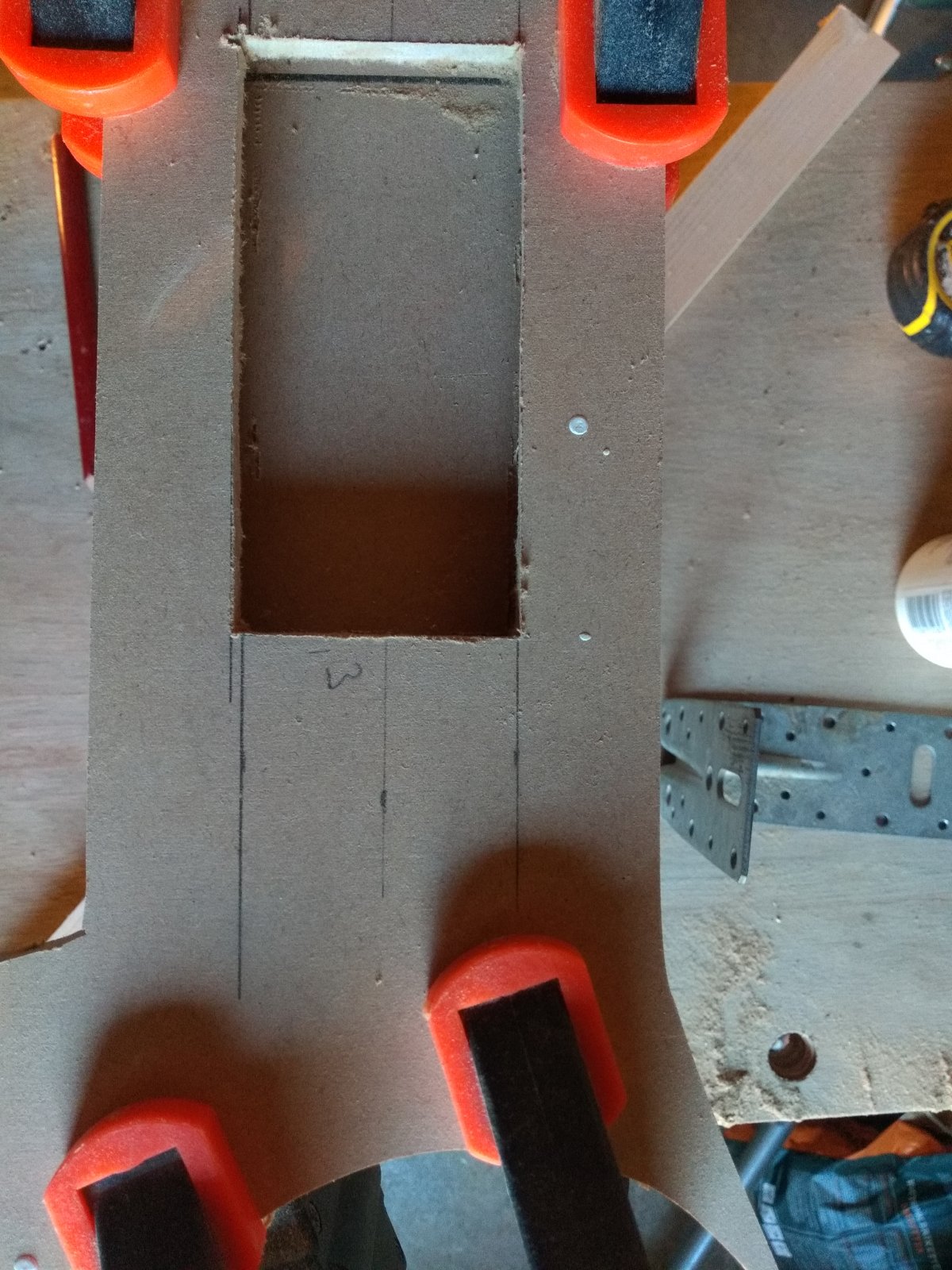

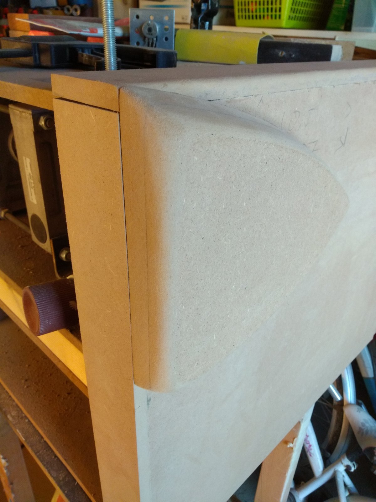

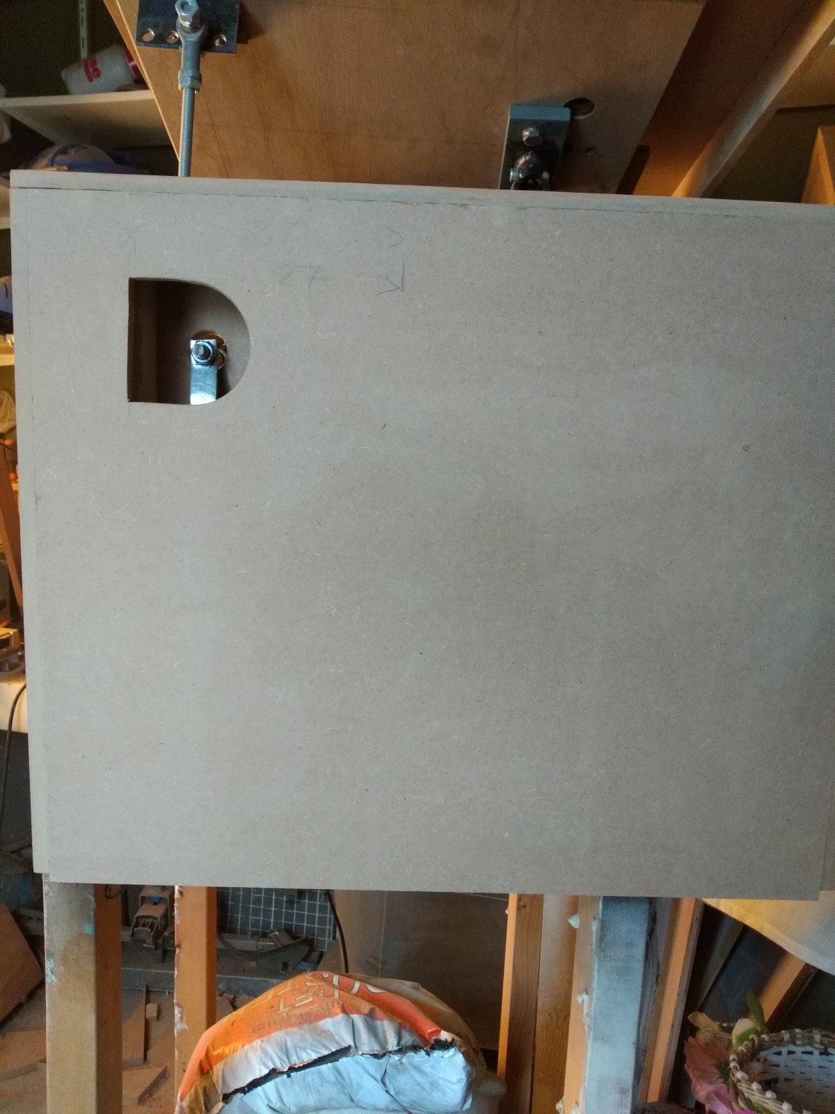

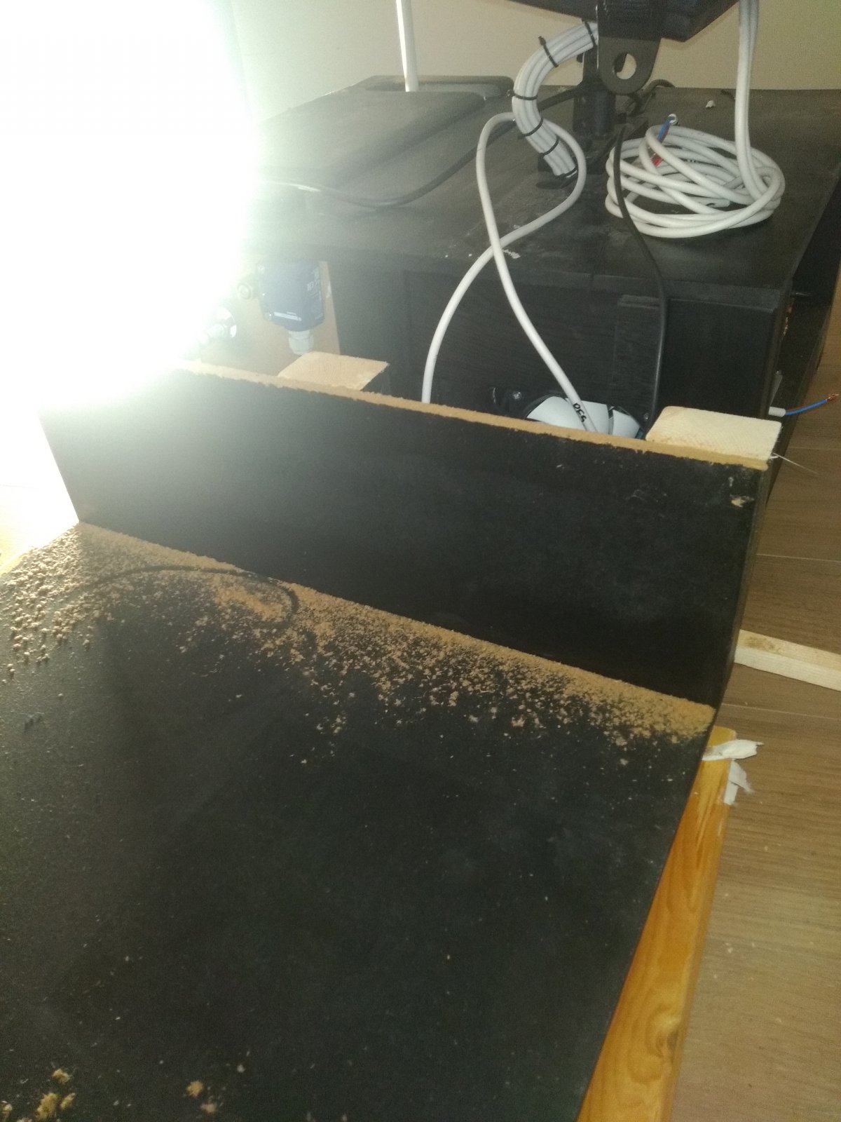

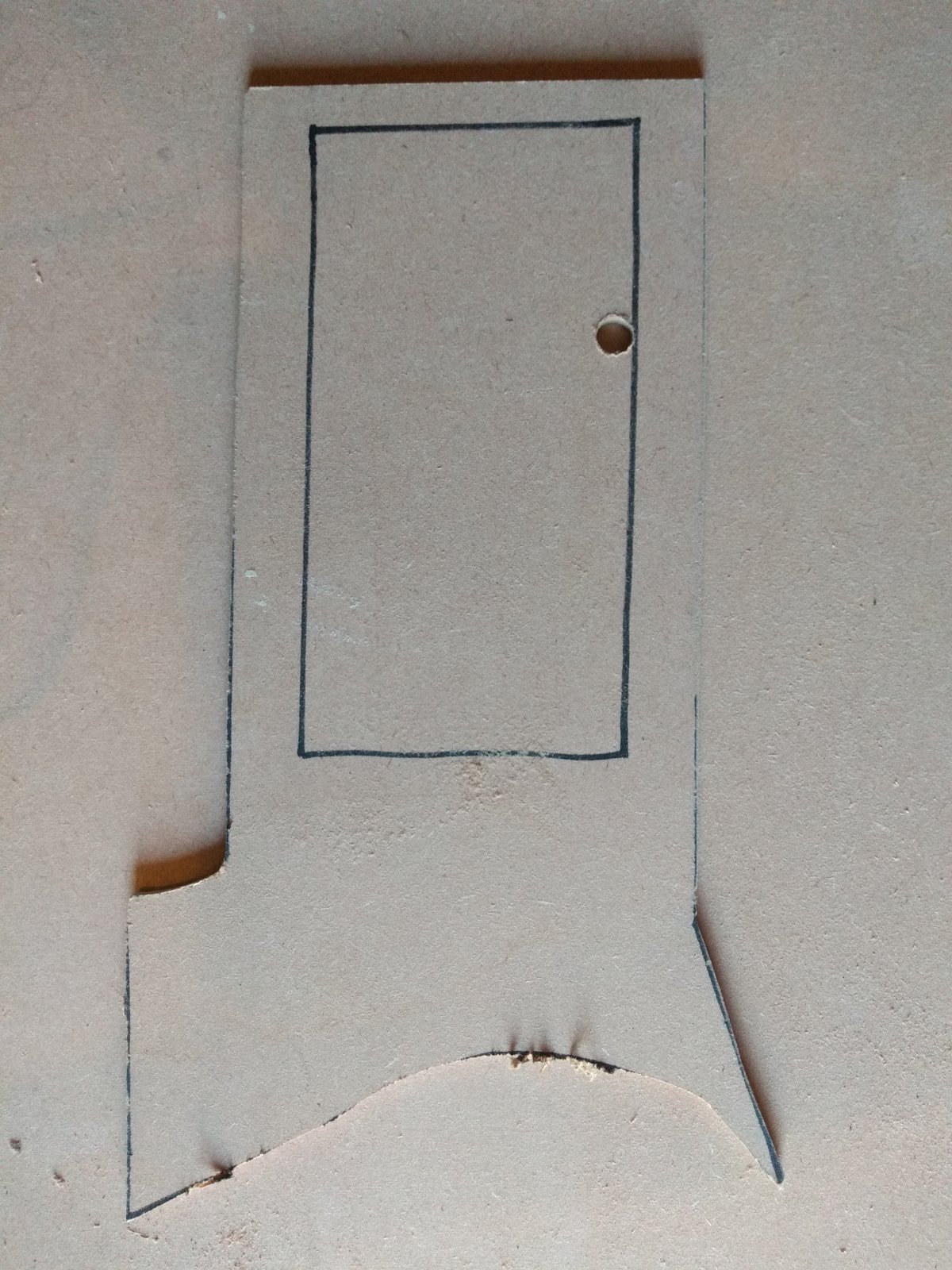

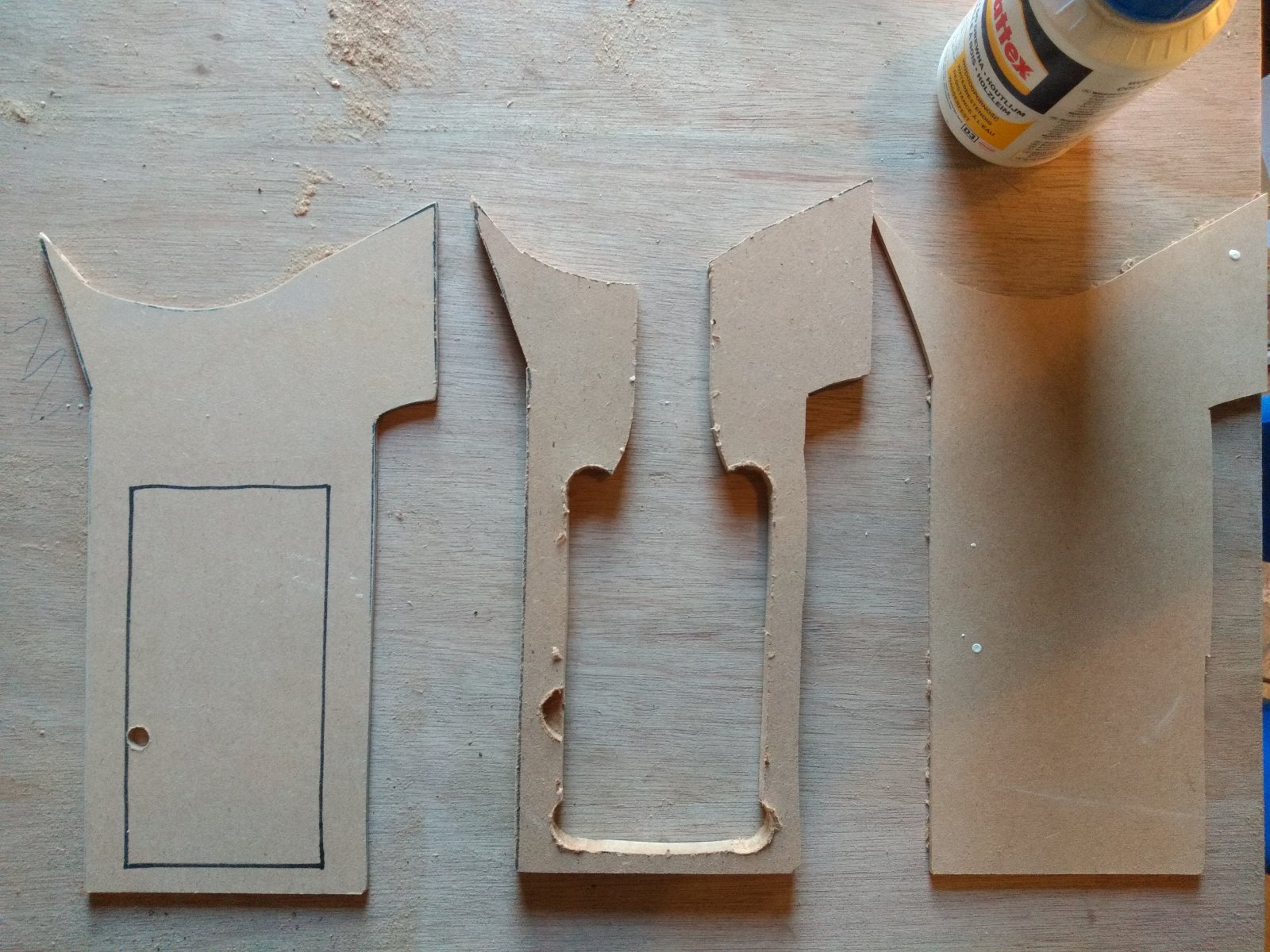

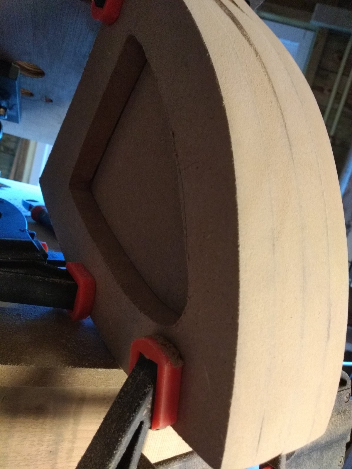

    I found the base a little too high, so I did some sawing work

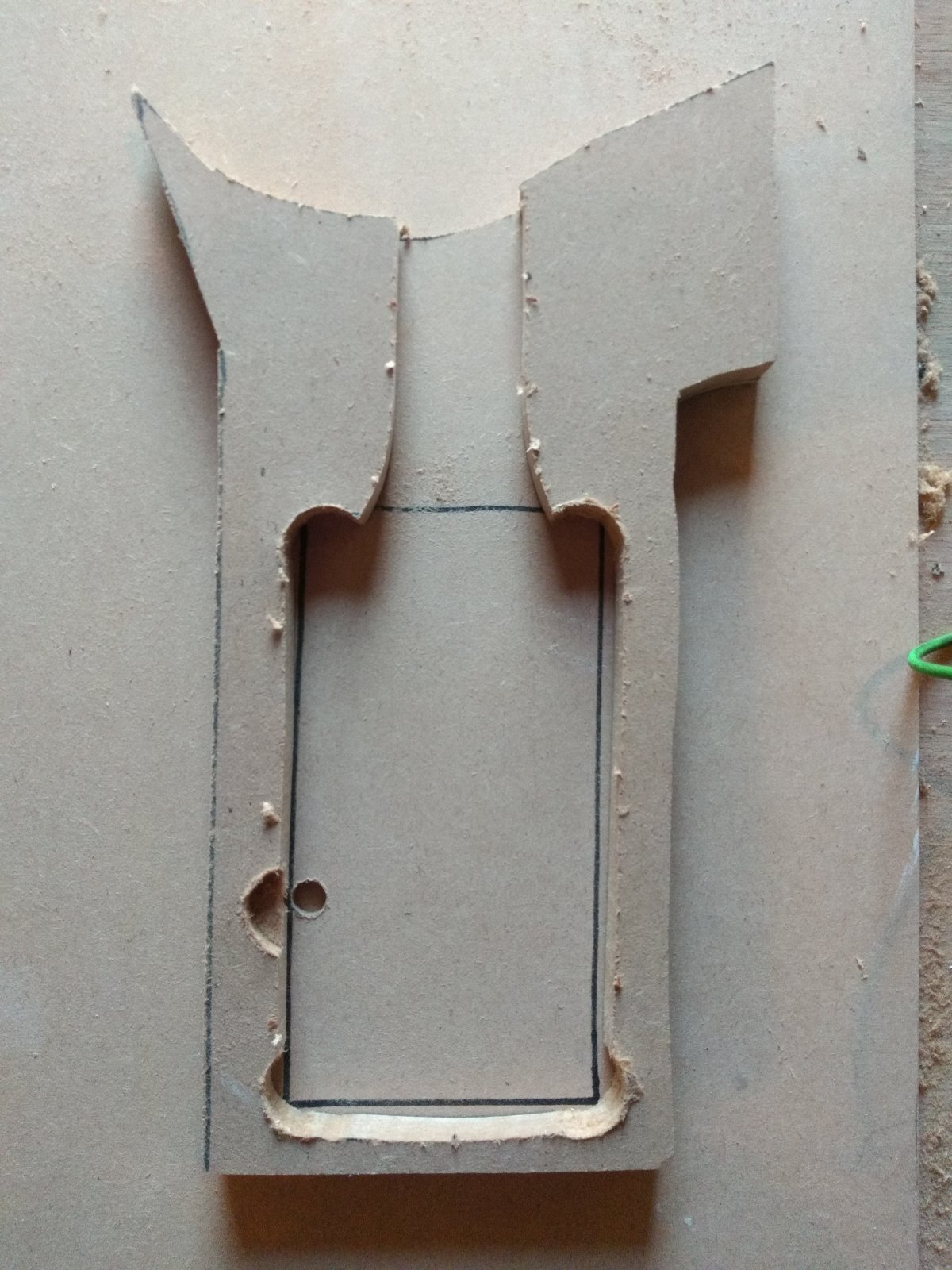

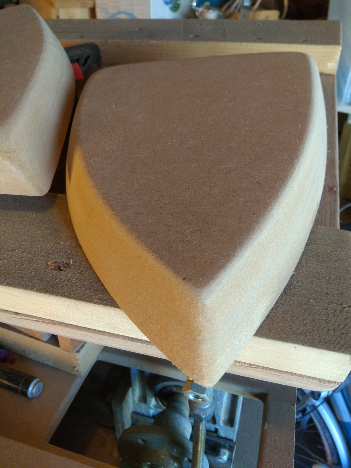

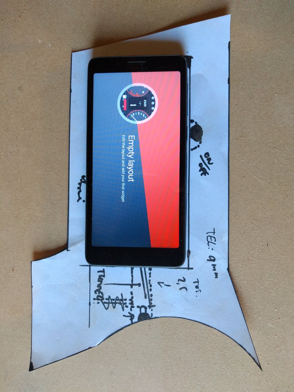

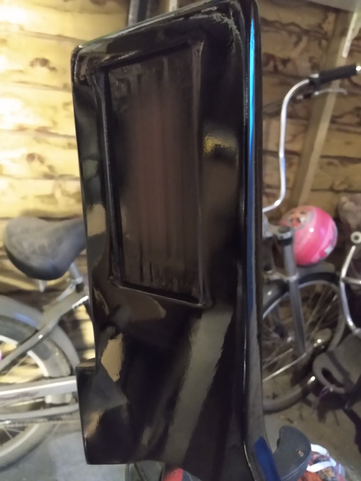

    I am currently working on making a small digital dashboard
    1a.jpg IMG_20190914_095430212.jpg IMG_20190914_095455526.jpg IMG_20190914_095516570.jpg IMG_20190914_100429962.jpg IMG_20190914_104125051.jpg IMG_20190914_110903107.jpg IMG_20190915_200332958.jpg IMG_20190915_200609589.jpg
    Waiting for the paint to dry....
  19. Brie69
    Jul 1, 2018
    100
    Beverwijk
    2Coins
    +88 / 0 / -0

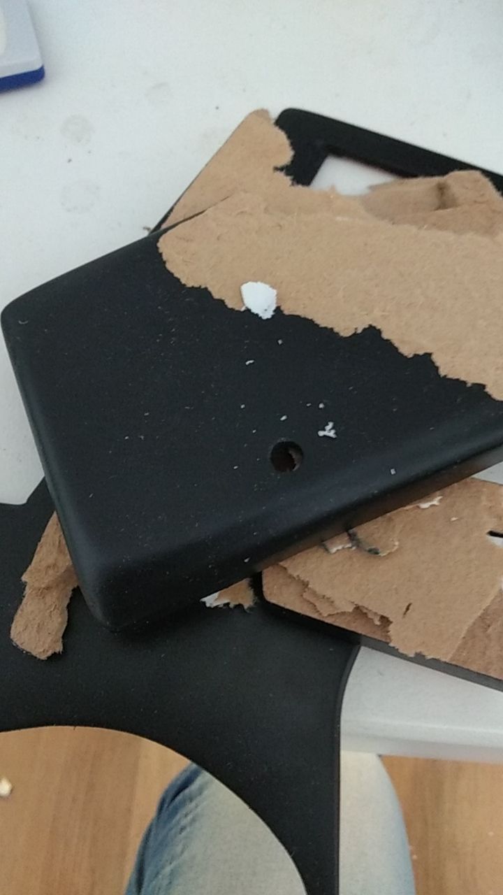

    Unfortunately, the angle of the screen was not good enough.
