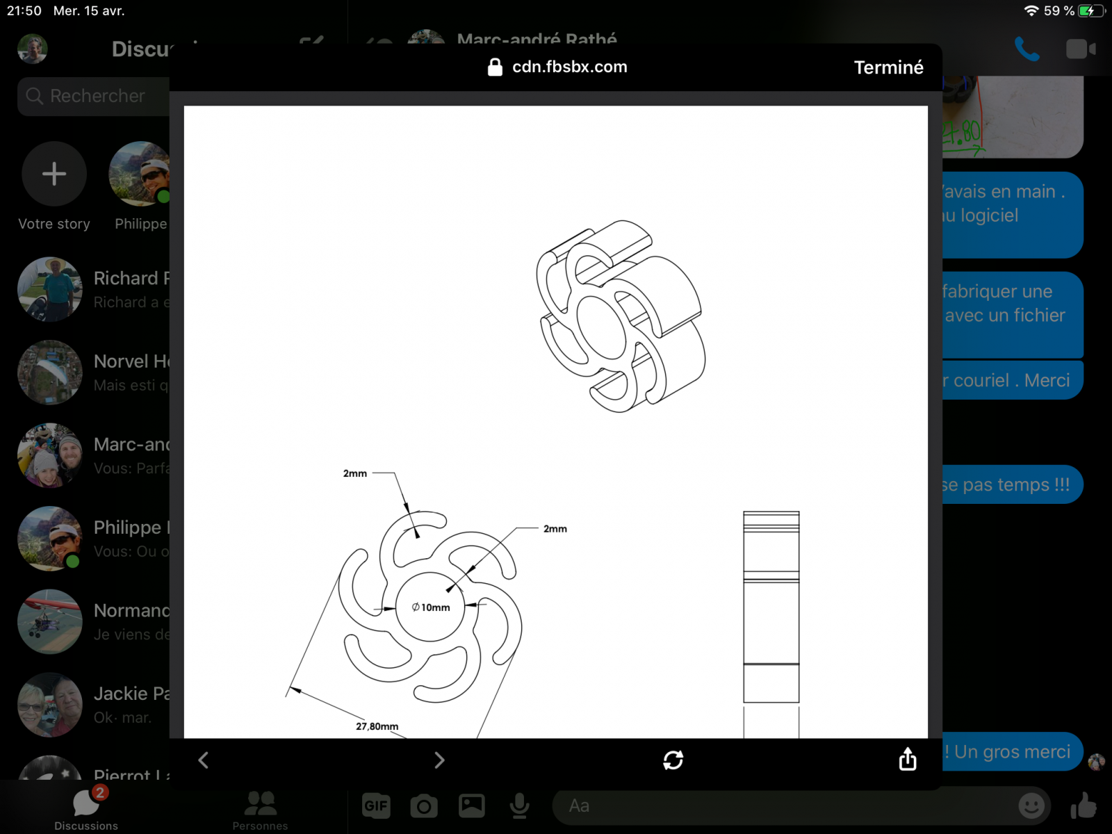

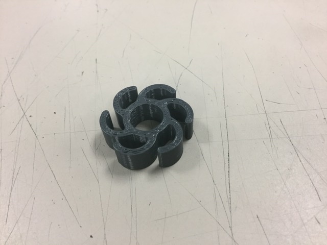

  5. pmvcda
    pmvcda aka FlyPT
    Nov 3, 2010
    2,296
    Portugal
    16,036Coins
    +2,746 / 18 / -0
    Similar to what I made, the idea is to work like a spring, and round to easily rotate to both sides.
    Mine is petg, with 2.5mm from what I remember.
  6. Flymen
    May 19, 2018
    355
    Montreal, Canada
    2,503Coins
    +196 / 2 / -0
    DC motor, 6DOF
    Ok , thanks
    I did a wall of 2.0 mm finaly , it seem like good and flex !
    Used : ABS M30 ( where I work ) ;)

    I want to ask what it is and how it is used? I found to same it in the drawings @Silent Chill .thanks
  8. Flymen
    May 19, 2018
    355
    Montreal, Canada
    2,503Coins
    +196 / 2 / -0
    DC motor, 6DOF
    This wheel is a guide fix at the top of the ballscrew, it prevents the rod from vibrating( anti wobble ring) in the tube when the bearing travels in the low position and when the coupling is misaligned !

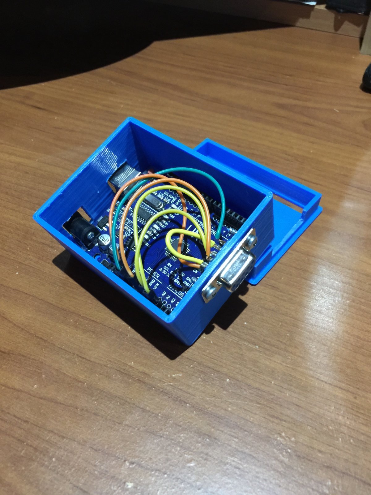

    FB930E9A-C05C-4617-ACA5-9B1793B406C9.jpeg New blue box for my arduino uno !!! G27 pedal don’t fit with the New steering !!! I must pass Db9 to USB

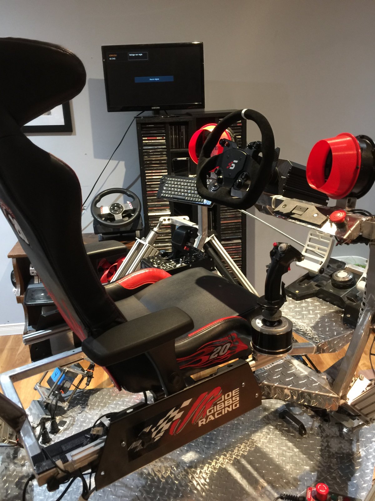

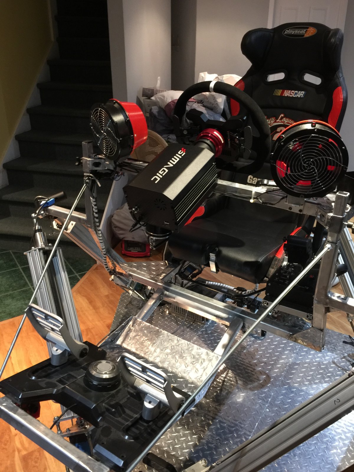

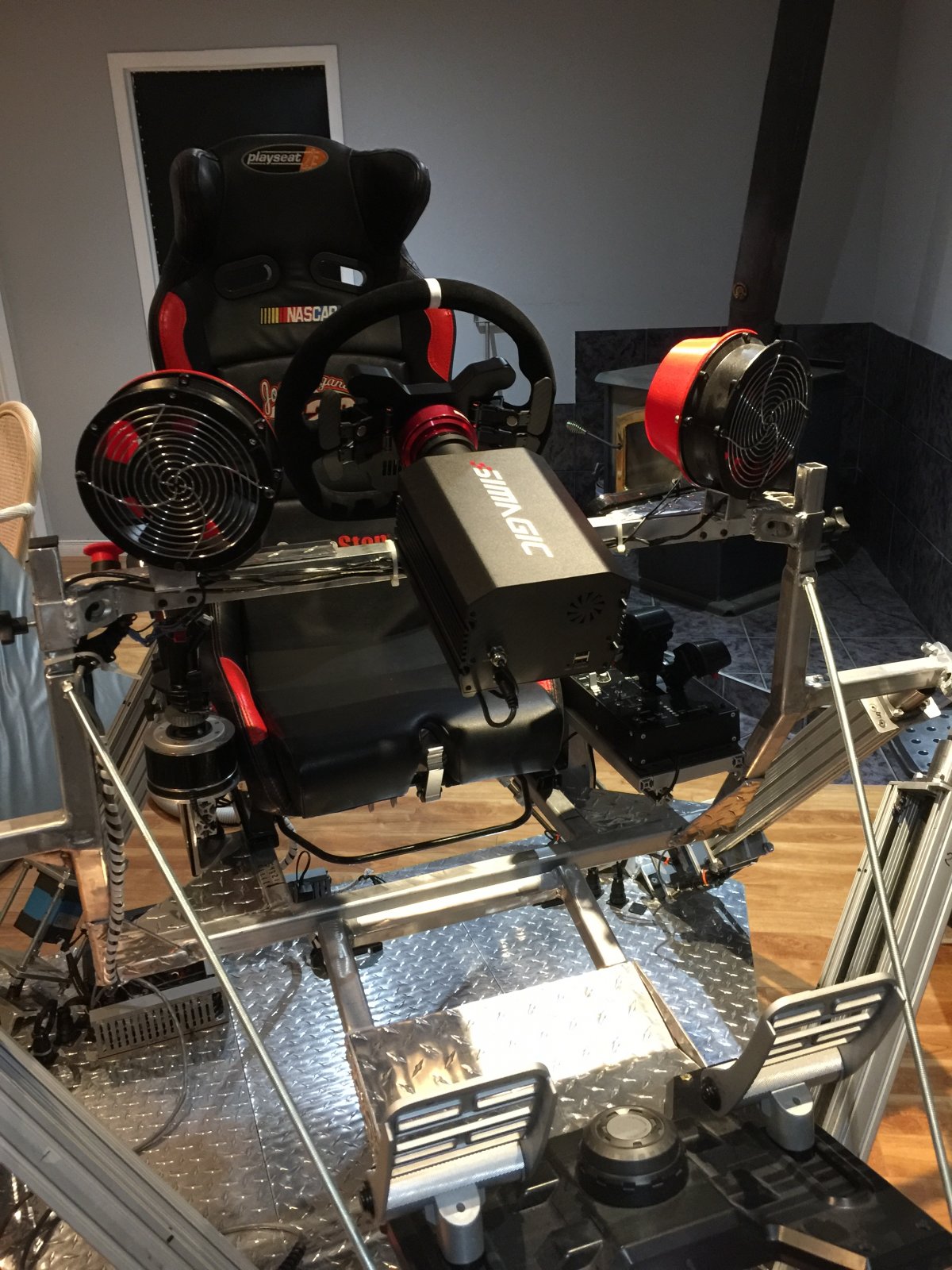

    New ajustement ,COG is 4 inch back Now because this motor is heavy 30 lbs , Clean up of wire and cable !
    Baby is ready again ! Miss only pedals who missing code for arduino uno !!

    is that fan for wind simulator ..if its that so your build fantastic!!!
  18. Flymen
    May 19, 2018
    355
    Montreal, Canada
    2,503Coins
    +196 / 2 / -0
    DC motor, 6DOF
    Yes , is those two fans who blow on me !:grin
