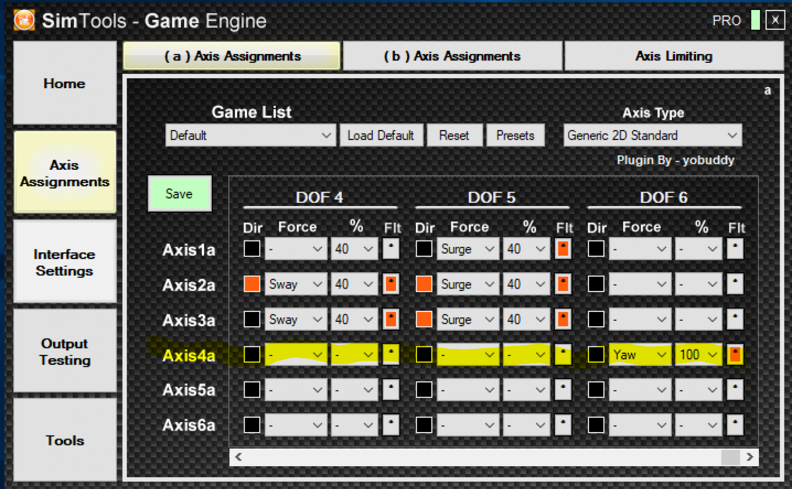

    Now that I have a little more time to play with the sim, I found that it has two kind of major issues which I am not sure how to fix:
    1. On start up and shut down of a game, there were a bit of a violent movement in the motors. My guess is that the motors had to move to some initial position but why is it done so violently. It is scary for people who wanted to try it.
    2. Since I have mapped the yaw motion to the fourth motor (traction loss motor), it is found that lot of time the sim would yaw to the left or right even though the car that I was driving was constantly moving straight ahead. That is odd.
    Would someone know how too fix these problems? I am looking to @jjanu , @Wanegain ,@yobuddy for help here.

    Sounds like your simulator does not center when SimTools is started?
    I ask because if it was centered, it would not move at all when the game is started, because your system would already be centered.
    Does your sim simply drop to its lowest position when the game ends?
    Maybe the interface is powering down between games?
    Do you mean when used with a traction loss output from a game plugin, or yaw output?
    For traction loss, you can add a bit of DeadZone and this will disappear.

    Hi @yobuddy,
    As far as I can tell, the sim rig started in the position where all the motors are centered as in the attached picture of Simtools game engine output testing. But when the game started the rig would violently snapped to some position that is not necessarily centered. If this can be soften it would help a lot.
    My motor on Axis4a is mapped to Yaw motion on DOF 6 of the Simtools game engine axis assignment. You can see that in the attached picture withe the high lighted axis4a. Do you think that my mapping is incorrect?

    The problem is Yaw is just a compass heading, use Traction Loss from a game plugin (maybe try Live for Speed) and it will work much differently buddy!

    that was it. Thank you @yobuddy. After I remapped the axis4a motor to Extra1 (traction loss) then both problems disappeared. It was my ignorant as I didnt know what extra1 extra2 and extra3 for so I didnt try to use them.
    To make the movement on the sim a little bit less forceful, I also went into the Simtools game manager profile editor and reduce the "Main Level" setting to about 25%. I am not sure if this is the right thing to do but it made the sim a lot more gentle to ride on.

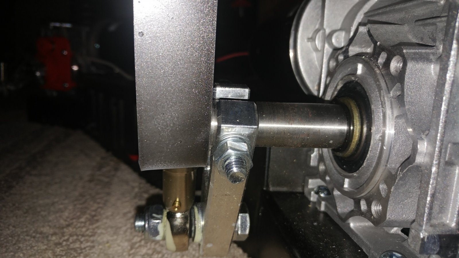

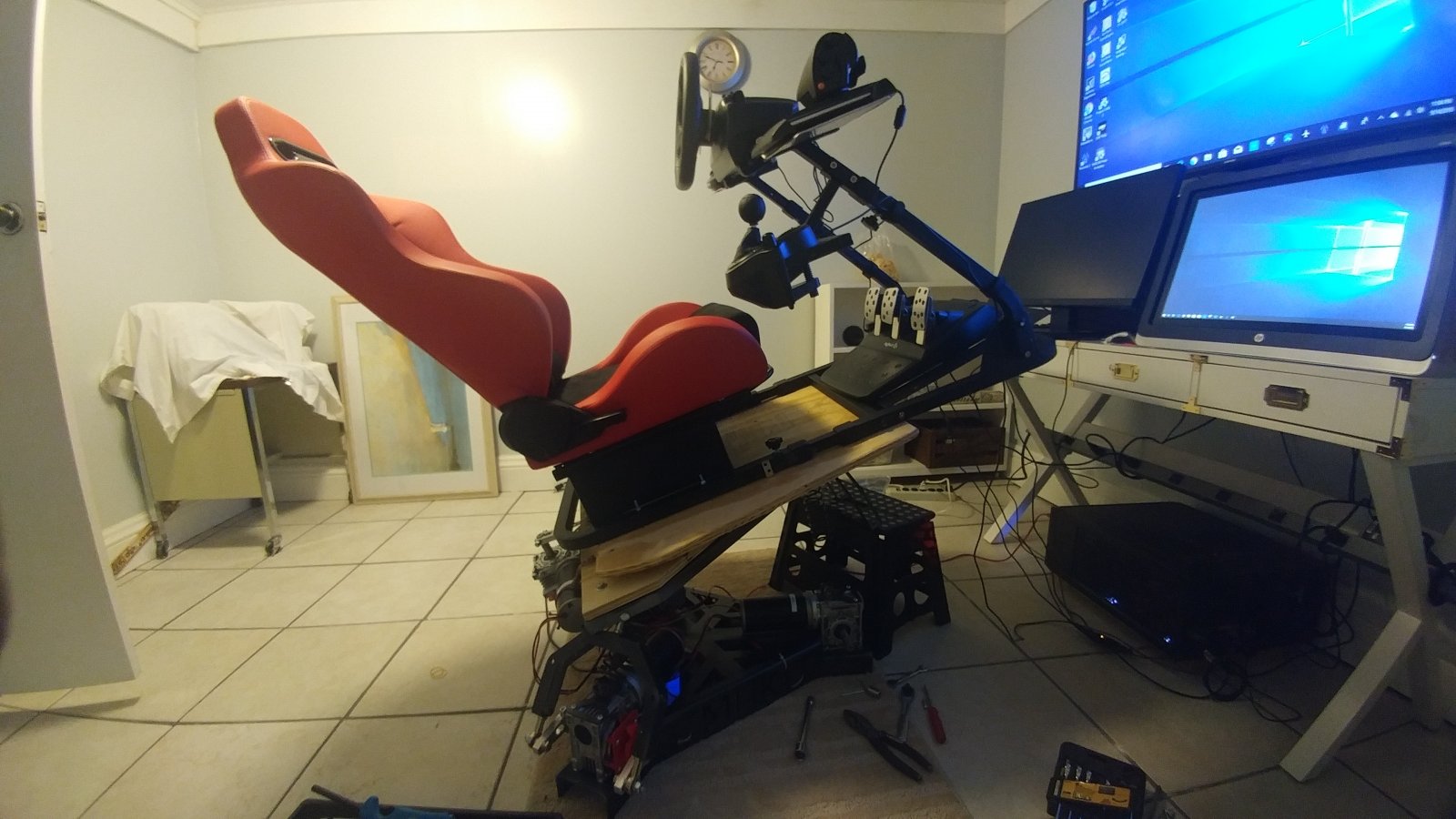

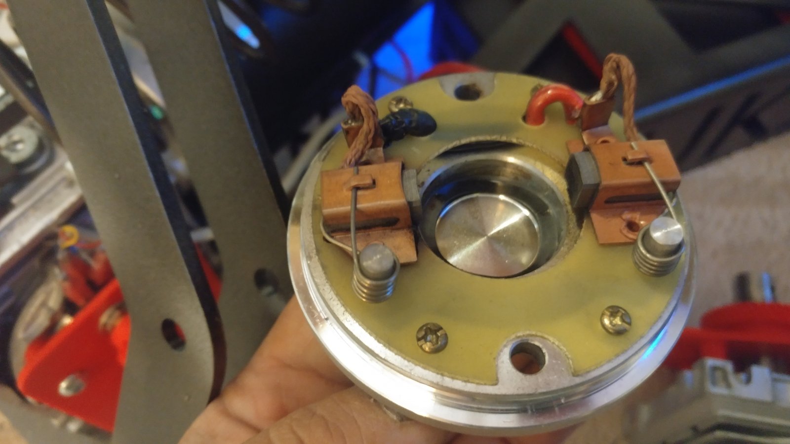

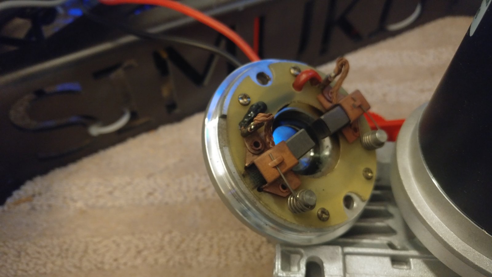

    I am very sad to report that my motor on axis1a had died today. This is a motor that I was having problem with from the beginning where sometime it would spin by itself. The motor is set to operate in the forward manner but once in a while it would spin and work in the backward manner. Previously when it spin to the backward position it was able to spin out to the forward position and work again. But this time it stuck there and I didn't know about it until I smell something strange. It turned out that the motor is so hot that it may have burned its internal wiring.
    I turned off the rig. Waited for hour for it to cool down and turn it on again. But this time there is no sign of life on the motor.
    In the pictures you can see that it had moved to the backward position prior to dying. The second picture show the forward position of a motor at rest.
    @Wanegain, would you know if there is some warranty for the motor? Could you help me with this? Thanks.
    This is especially unfortunate as I was getting so close with the built and was starting to enjoy riding on the rig. :(
    22,045
    153,866Coins
    +11,152 / 57 / -2

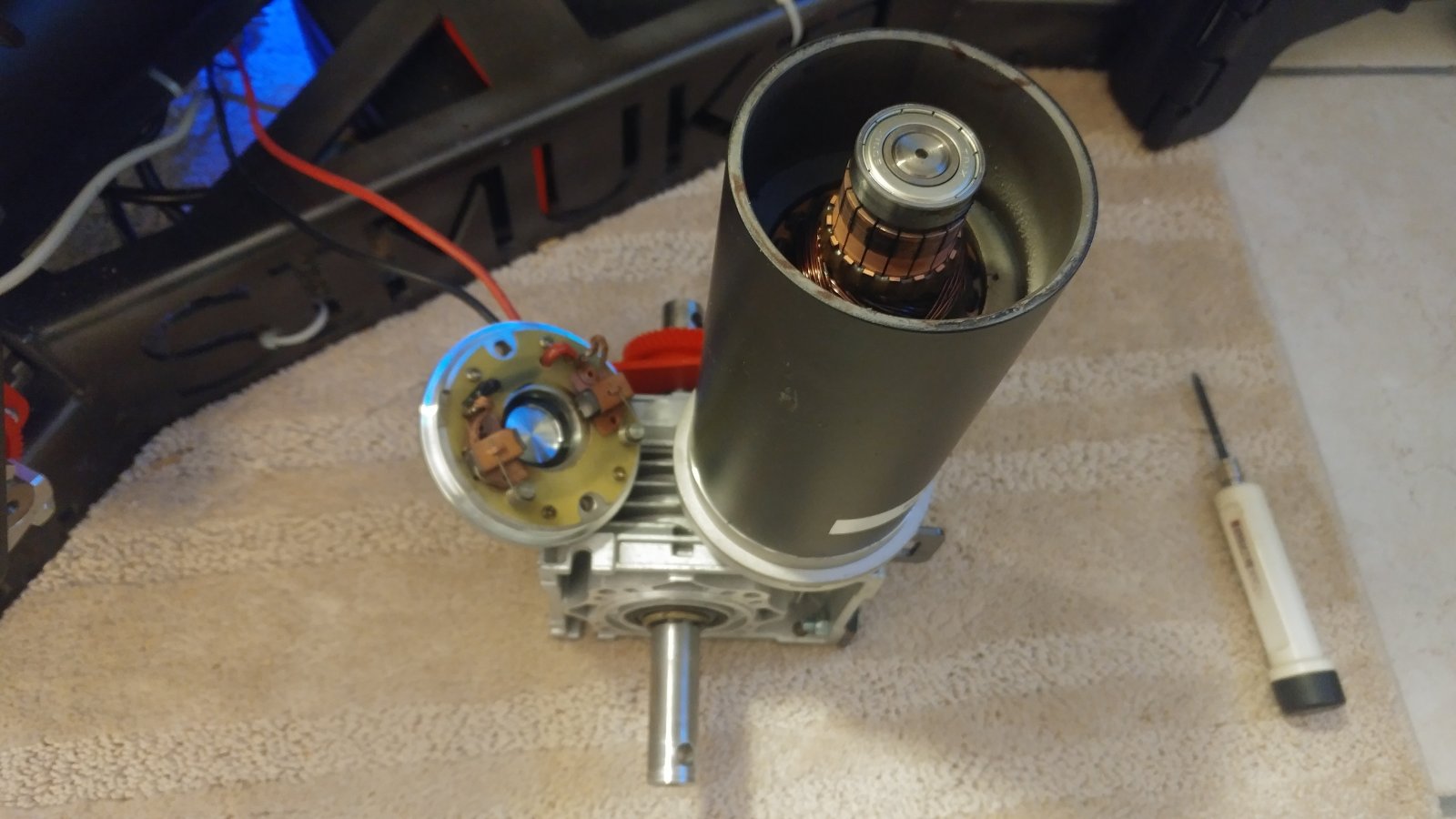

    A motor should not over rotate, hence you need to also check your pot and associated wiring settings.
    If there is no warrenty then you could strip the motor down and check simple things like the brushes.

    This motor was one of the odd one from the start. I have tried several things like:
    1. Replace the pot
    2. Replace the pot wiring
    3. Add a few drop of epoxy glue to secure the gear to the motor shaft
    4. Tighten the screws on the pot gears
    Nothing worked. Once in a while it kept changing from the forward to the backward position.
    Now that the sim is all assemble it is going to be a task to remove the motor. Especially in order to access the sabertooth the base of the sim has to be turned upside down in order to get to the motor electrical connection.

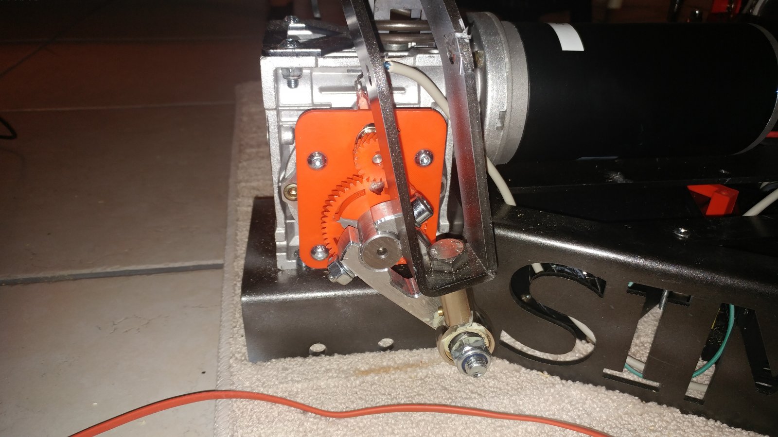

    @noorbeast @Wanegain , I think I know the reason why the motor was burned:
    When the motor got into the backward position and then when it tried to rotate around to the forward, it got stuck because a little bit of the motor shaft was in the way of the U-shape arm that connect the motor to the platform. See picture. The design doesn't allow for a very big gap between the two of them and the production may have a consistency issue where this U shape arm is more closely touching the motor shaft than the other two U shape joints of the rig.
    To avoid this problem from happening again I have added several more washers to the connection between the U-shape arm and the crank shaft in order to increase the separation between then. It would be better if simukit can redesign this arrangement to avoid the problem in the future for other users.
    I also modified the arduino PID sketch so that it wouldn't send continuous power to any motor for than one minute to avoid the burning of the motor.
    Now come the good news: by following @noorbeast 's suggestion, I opened up the motor and saw the problem. It was caused by the carbon brushes burned and stuck inside its housing so they cannot make contact with the motor anymore. I was able to loosen them so that the springs were able to push them out again.
    It was not fun to take the motor out to fix the problem. It took me several hours but I am just happy that it is working again.

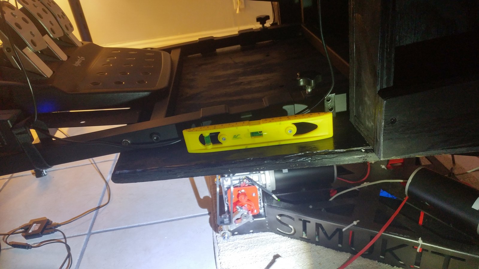

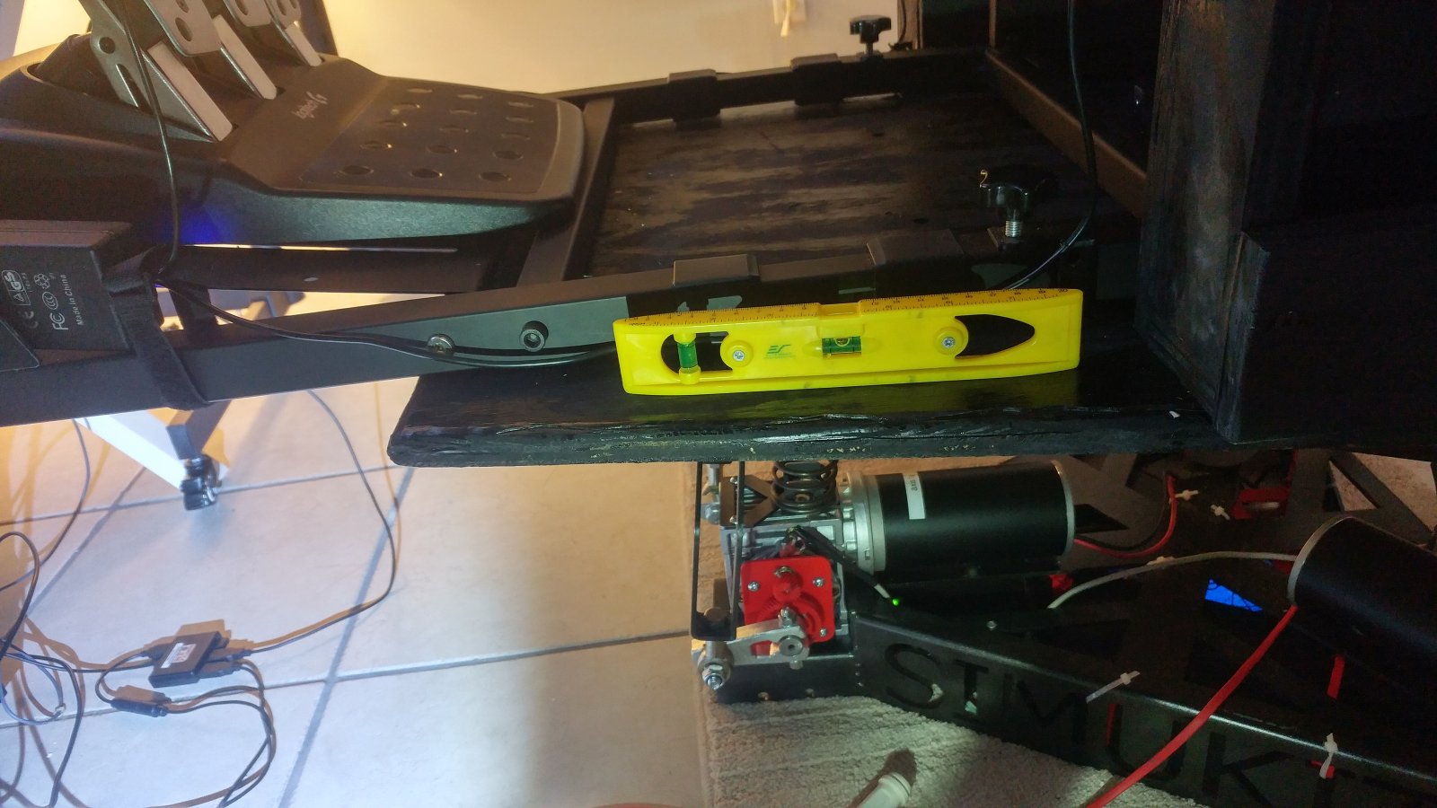

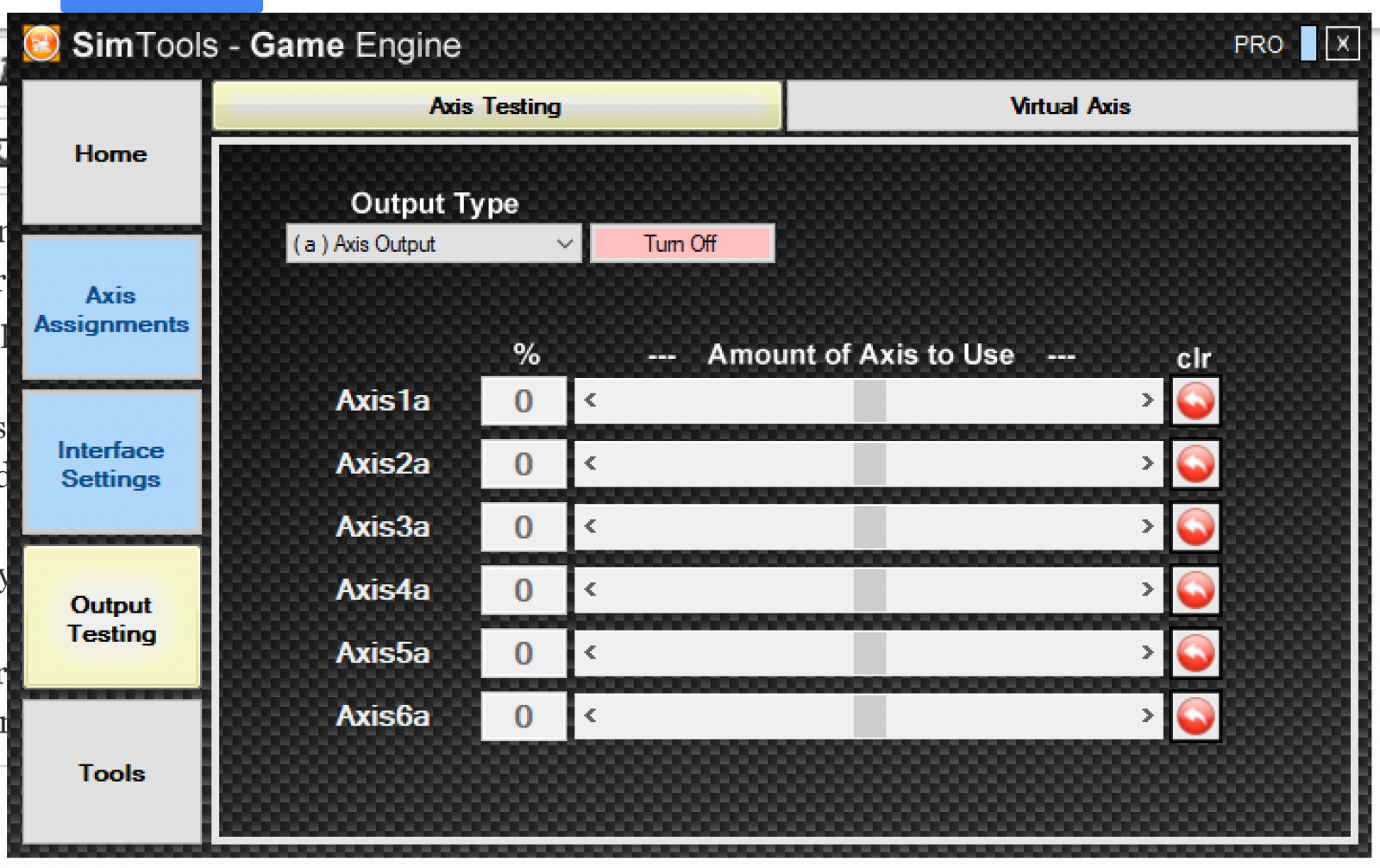

    The problem of axis1a motor sometime went crazy and spinning by itself have frustrated me to no end. I replaced the pot wiring connection the second time, checking carefully for cold soldering and that didn't help.
    So I decided to do an experiment with the help of simtools output testing. The procedure is like this:
    1. Put the rig in idle position where all output levels are mapped to zero. Use a bubble ruler to check that the rig is perfectly level. See picture.
    2. Move the axis1a output level to the extreme 100 or -100. Then clear ('CLR') it back to zero.
    3. Repeat 2. A few dozen times.
    4. The result is that the motor's idle position kept on lowering after every 2. And eventually it is so low (see picture) that an extreme -100 level would cause it to go backward and start spinning. Which was exactly the problem I got during playing with the rig.
    The interesting thing was that if I went into 'Axis setting' and limit the output level for axis1a to 85% from 100% then the problem went away. I can execute 2. As many times as I want and the rig's idle position remain perfectly level.
    Anyone want to take a guess if this is a hardware or a software issue? @Wanegain , @yobuddy have you some idea?
    Since the problem went away by a change in software setting I am incline to think that it might be a software issue but I cannot be very sure.

    It could be your motors are not able to stop exactly when they need to.
    So they slightly go past where they need to be causing the pot to turn slightly.
    By using a bit of axis limiting, you are avoiding the problem as the motor never moves to the actual limits of the pot.
    It's my best guess anyway :D
