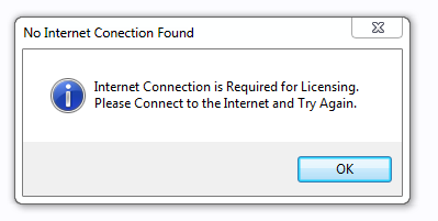

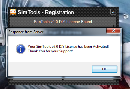

    I entered the wrong access code
    I registered from the desktop
    success
    It works
    Thank you very much for help

    Just to be clear the key is not different between SimTools versions and I just want to confirm you are using the latest version of SimTools v2.5.1?
    @yobuddy can you also please have a look at what may be the cause.

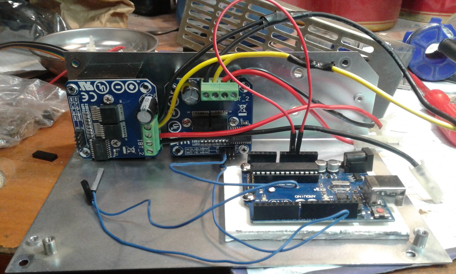

    Controller
  5. tadeusz
    tadeusz New Member
    Nov 4, 2025
    34Coins
    Controller
  6. tadeusz
    tadeusz New Member
    Nov 4, 2025
    34Coins
    without controller 12V

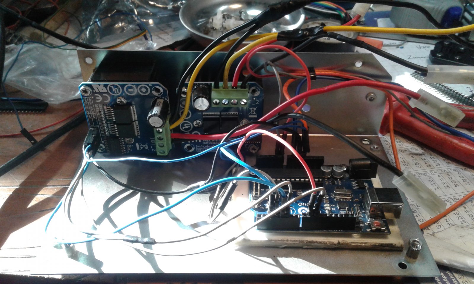

    without controller 24V
  8. tadeusz
    tadeusz New Member
    Nov 4, 2025
    34Coins
    with load :grin

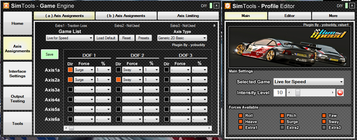

    Hi
    I have a problem
    with the settings in the Sim Tools Game Engine
    I have a feeling
    that most of the settings in
    Axis Assigments
    -Filter doesn't work
    best regards
    T.M.

    Filters are not really relevant to the Default profile.
    For a specific game profile you should first fully refine the motion profile prior to messing with any filters, and then judiciously use filters for their intended purpose, as per the SimTools manual: https://www.xsimulator.net/communit...with-the-official-simtools-documentation.117/

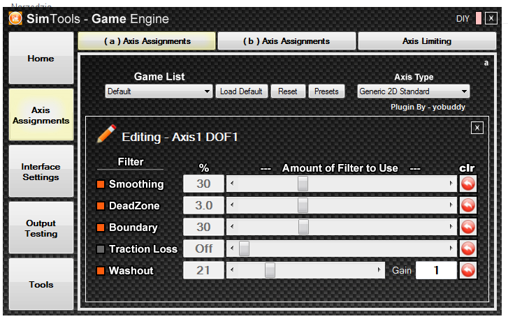

    Hi
    The options in Sim Tools really don't work
    This happens at
    sim tools settings as in the photo
  16. tadeusz

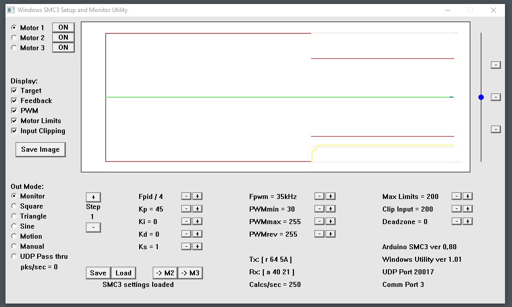

    Parameters Arduino:
    Dedzone 10
    Ks1 = 1;
    long Kp1_x100 = 700;
    long Ki1_x100 = 20;
    long Kd1_x100 = 80;
    int Ks2 = 1;
    long Kp2_x100 = 700;
    long Ki2_x100 = 20;
    long Kd2_x100 = 80;
    int PWMout1 = 0;
    int PWMout2 = 0;
    int PWMout3 = 0;
    int PWMmax1 = 40;
    int PWMmax2 = 40;
  17. noorbeast
    22,048
    153,884Coins
    +11,154 / 57 / -2
    Why are you messing with the SMC3 code, as that is not how it is configured?
    Why have such a low Intensity Level set in SimTools, as that basically makes it ineffectual?
    I can't access the video, so perhaps check the permissions are set to public.

    Hello
    Sorry I published ...
    I set the low level to show that this amount has no calling for action
    I have one question
    Is what I set in SMC3Utils v1.01
    affects the operation of SIM TOOLS?

    Here are my settings for car driving (assetto corsa)
    But these settings are very dependent on your hardware.
    If you want to know my opinion.... you should read this thread carefully.
    There you will find the complete knowledge you need.
    In the second post, you will find all parameters explained you need to set.
    And to your question: NO...don't touch the arduino code! simpley upload and forget. If you want to change some values...always use the smc3 utility. That is exactly what it is create for.
