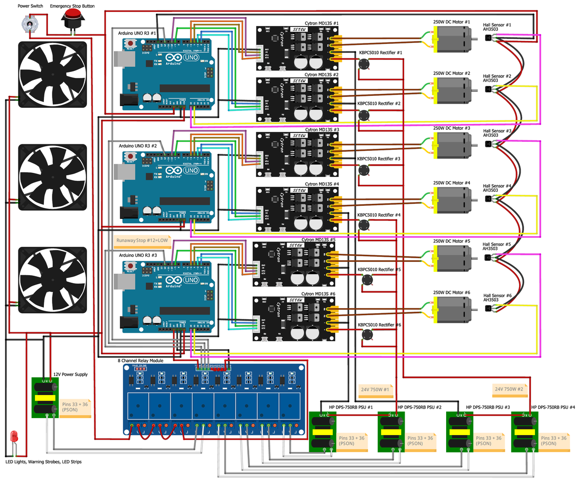

    @Ronan Design can you please post your schematic of the whole controller cabinet once again? I can't find it anymore. I still have the problem that my browser sometimes doesn't display embedded pictures. So make sure you insert is as thumbnail. Thanks

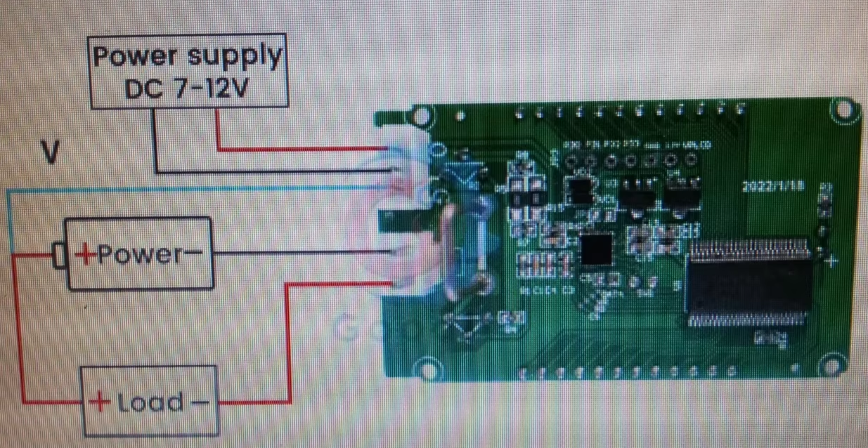

    Thanks, yes, that's the schematic. It does not include the LCD voltmeter/ammeter devices, which are not essential. But just in case, here's how they are wired:
    They are rated up to 100V/10A, which should mean 1000W, so they should be good for 41A @24V which is more than I need.

    Ah, thanks @noorbeast for posting the schematic, again. The original post still looks like this in my browser. It doesn't like big pictures embedded in the posts.
    @Ronan Design The problem with the sensors is the "daisy chain" of the power and ground wires to the sensors. The red and black wires all go to the first Arduino while the signals (yellow and blue wires) go to different boards.
    You should run three seperate wires to each sensor and connect +5V and ground to the same Arduino where the signal goes. (this is called "star grounding") The best cable would be a shielded twisted pair. (+5V and signal as twisted pair and ground on the shield). If you don't have such a cable twisting all three wires should also work as long as they don't run close to the motor cables.

    Be careful, the fact that 100V * 10A is 1000W doesn't mean that you can run 41A @ 24V through it. Power at the shunt resistor is proportional to the square of the current, no matter what the voltage (at the supply or motor) is. So 40A means 16 times the rated power @ 10A!:eek:
    But don't worry. I think the average current doesn't exceed 10A and the shunt can handle very short pulses of higher currents.

    Exactly my thoughts. I have found precisely the cables you described lying around. those are old high-grade audio cables with a twisted pair inside and shield outside, so I use the shield as ground and the pair as +5V and return signal and solder them directly to individual Arduino boards. I also found some ferrite cores I'll clip on, and I can also solder capacitors between ground and signal which supposedly can help with HF noise. I need to figure out if I have suitable ones and where to put them - at the Arduino side or directly on the sensors.

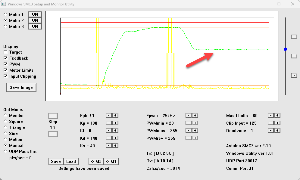

    I added 0.1uF (104) capacitors to all 6 sensors and also added ferrite clips around all cables on both ends now. I have no severe problems now, however, some noise is still present. The motors are not visibly twitching but they are crackling a bit.

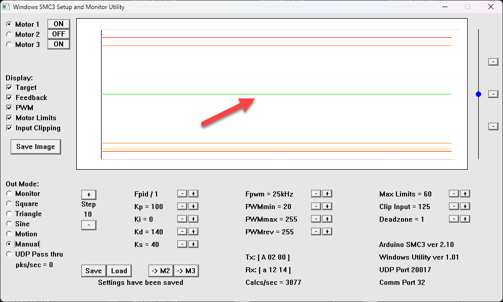

    This is the data from the sensor when the motor is under power:
    And this is the same sensor when I turn the AC power off, so motors are powered down. The signal is definitely much clearer.
    I also have some motor twitching at extreme positions. What's interesting is that it only happens when I hit the "clip" line, so maybe SMC3 is at fault here. If I go below the line and the signal is not clipped, the twitching disappears.
    I've read on some post that the SMC3 code can be modified with taking the running average of the last 10 reading, which should smooth out the signal, but there was no code there and I can't figure out how to piggyback the GetFeedback function of SMC3 for the running average.

    In SMC3 if the motor feedback does move beyond the set range (typically through inertia), then SMC3 will attempt to brake the motors hard by driving them in reverse until they are back out of this limit zone, that may be what you are describing.

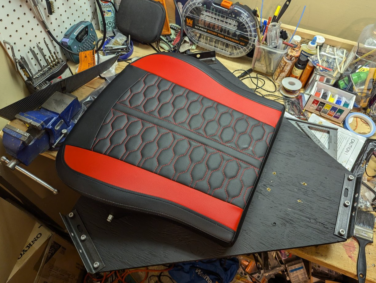

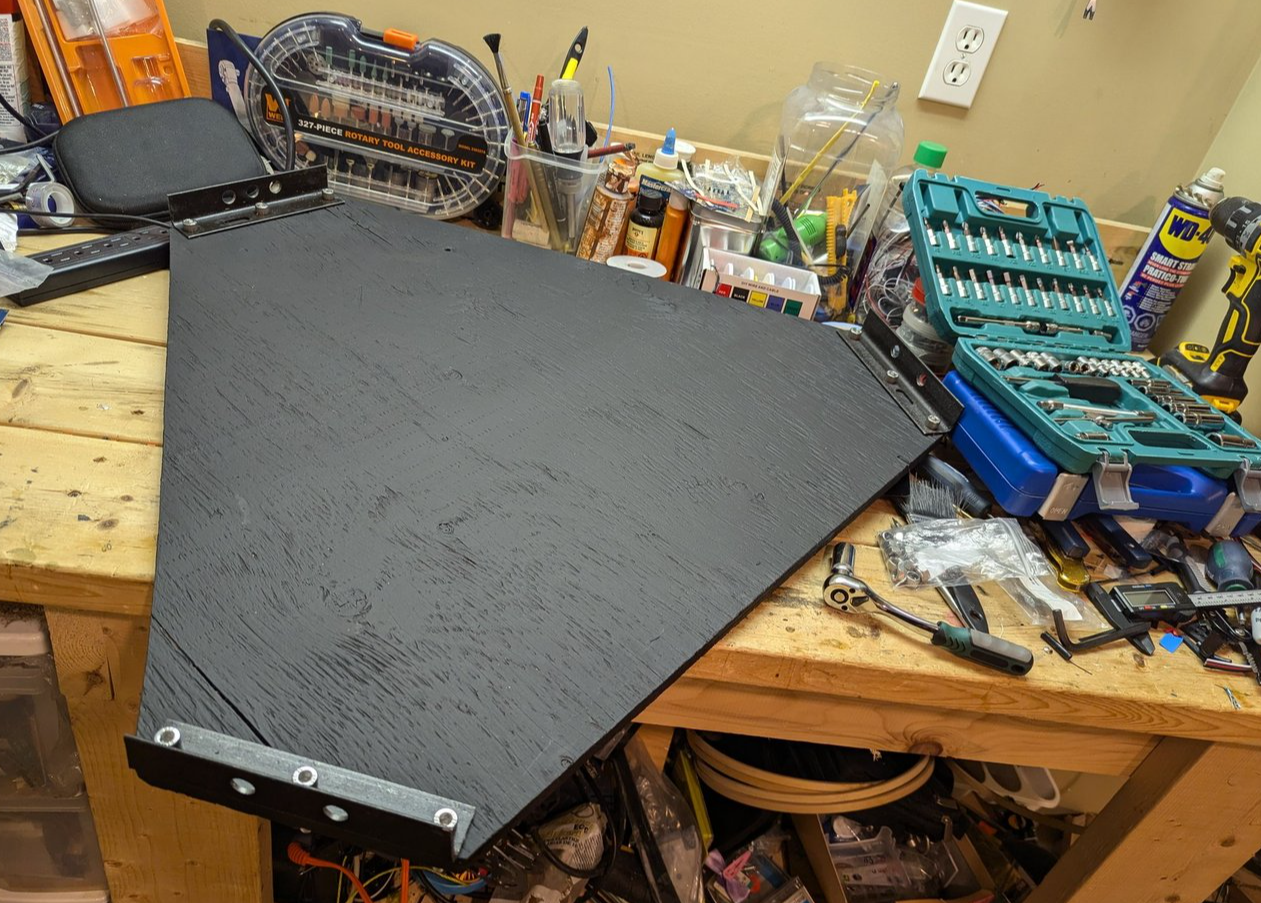

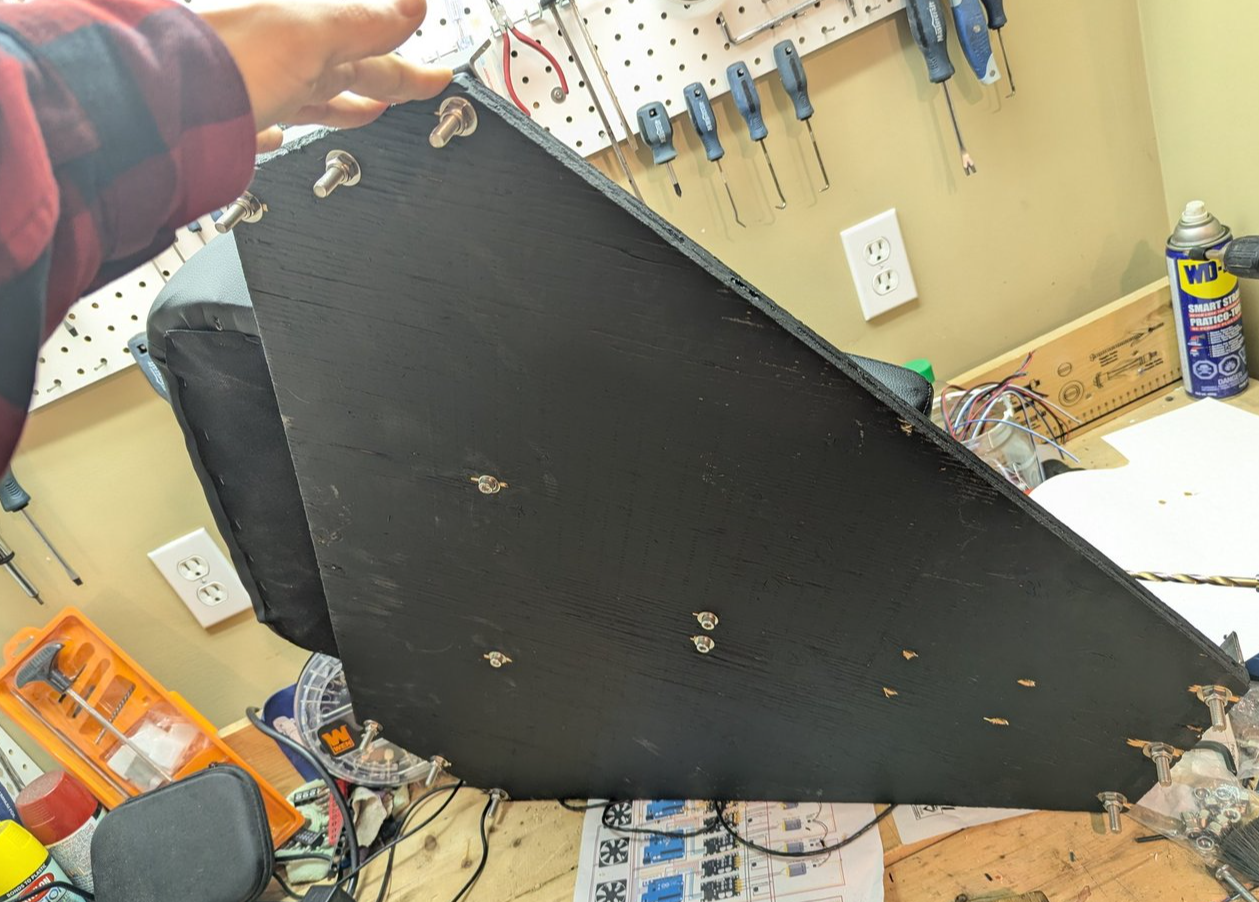

    Meanwhile some progress.
    I assembled the top platform:
    And attached the seat base:
    I hope the thick plywood will hold the weight and the G forces. I think it should. I can reinforce it if it flexes too much, but I actually think a tiny bit of flex is a good thing so the platform is not too jarring.
