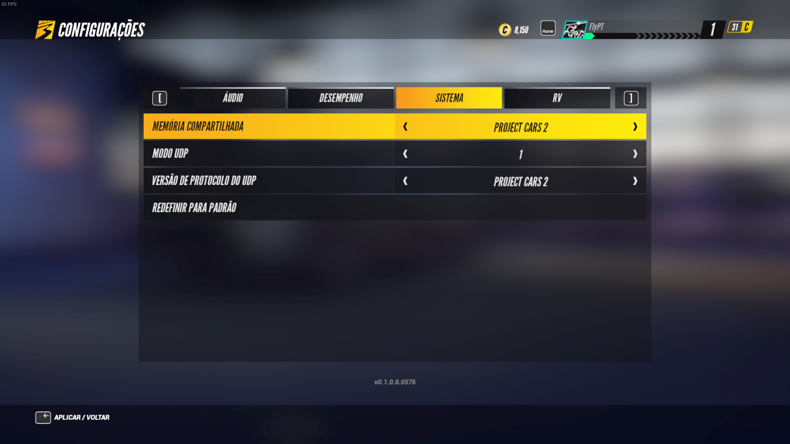

    Telemetry is the same as pcars2
    Being part of wmd1 and 2, I'm really sad the way they took pcars3...

    To work with SimTools, maybe rename the exe to PCARS2
    And go to options and select telemetry for PCARS2 in the game menus
    SETUP->SYSTEM
    (here in Portuguese)

    The telemetry is indeed the same as pcars2. As stated above, it's either a case of adding the new .exe name to the existing pcars2 plugin, or manually renaming the pcars3 exe to pcars2, then running simtools with the old plugin.
    Not sure what the new telemetry brings over the old one to justify a whole new plugin, but I guess there is a reason it's changed.
