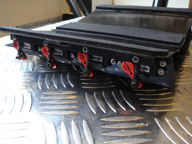

    Hello guys,
    I own GS-4 gseat and use it heavy for 3 years..and last week it died. I have done all necessary action to fix it but failed. I had contacted the company (sim experience) asking for help and they say most probably the controller has died.
    Long story short, i have seen some few people making a DIY gseat, it made me thinking maybe i can resurrect my died GS4 using same principle a like them.
    all the servos are in great condition, so what i need to do now is to make a new controller and using sim tool to control the GS4 seat.
    I dont know where to start but i have a couple of MM drivers and Unos laying around
    Died GS4 that need to resurrect:
    The main controller, Servo control 4.1 from yost Engineering.
    Trying to get a better ideas where to start

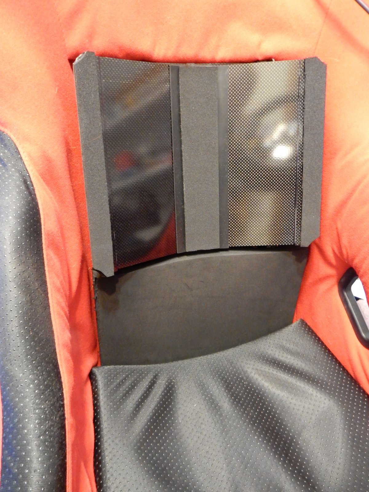

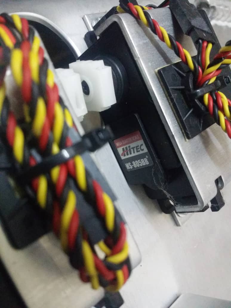

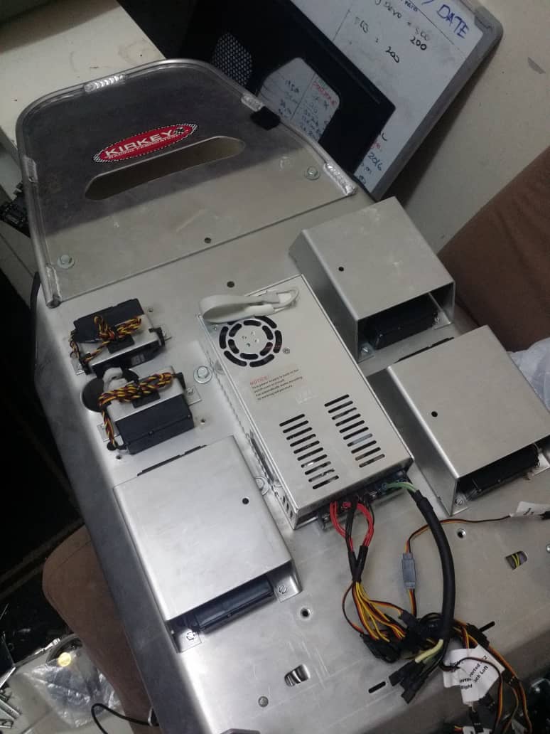

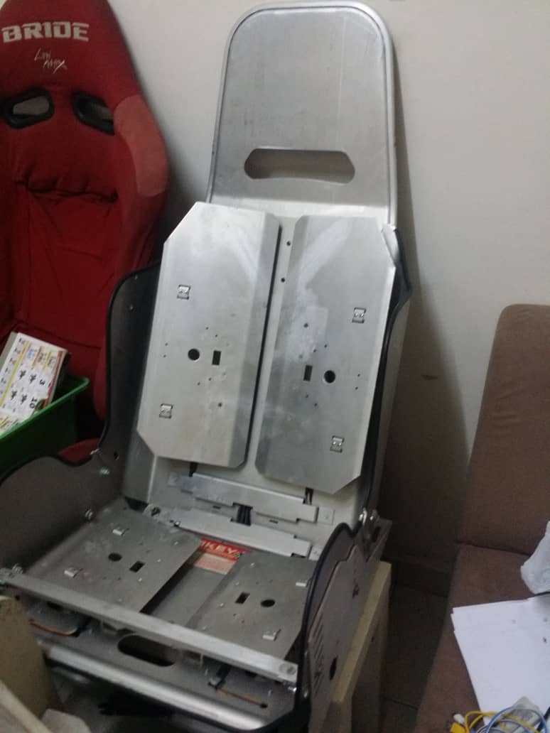

    Thanks @noorbeast , i have a look now. I just dismantle the servo cover. So the GS4 have 2 plates for back and 2 plates for bottom. 1 plate is controlled by 4 servos which is 2 servos are coupled together.
    Backrest plate servos
    Bottom plate servos
    The servo model
    yes i hope so too. Because im planning to use simtools together with my future motion system. Im not sure if simtool can control both Gseat and motion together

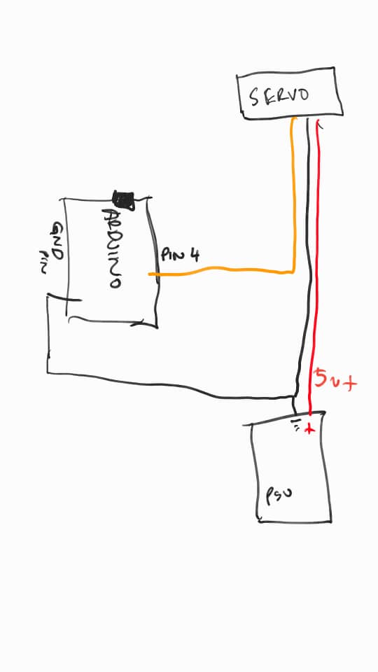

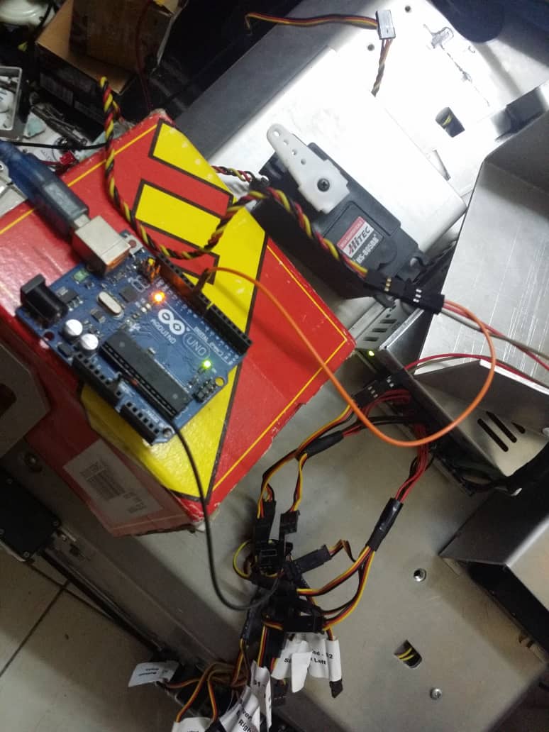

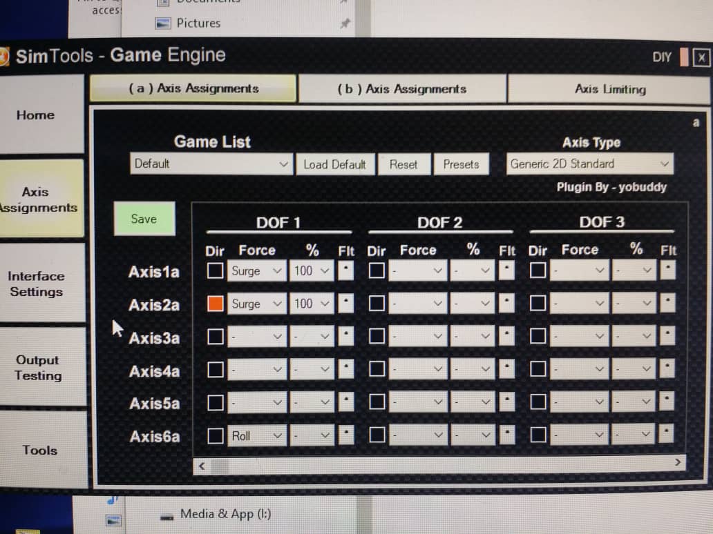

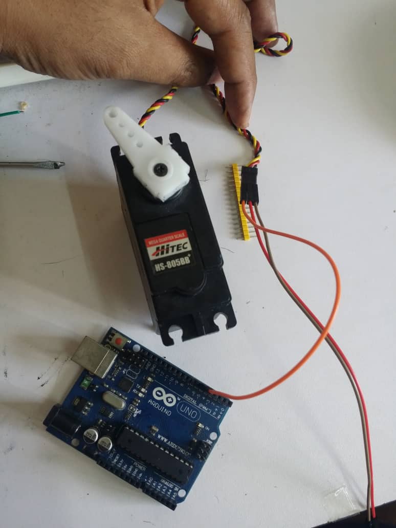

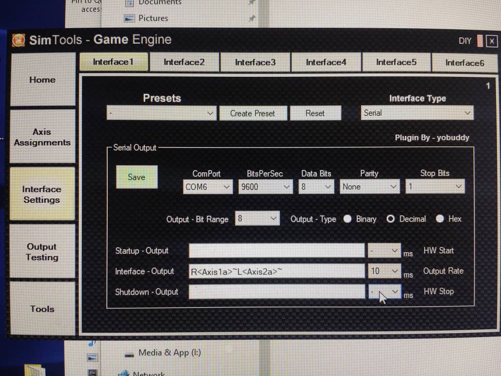

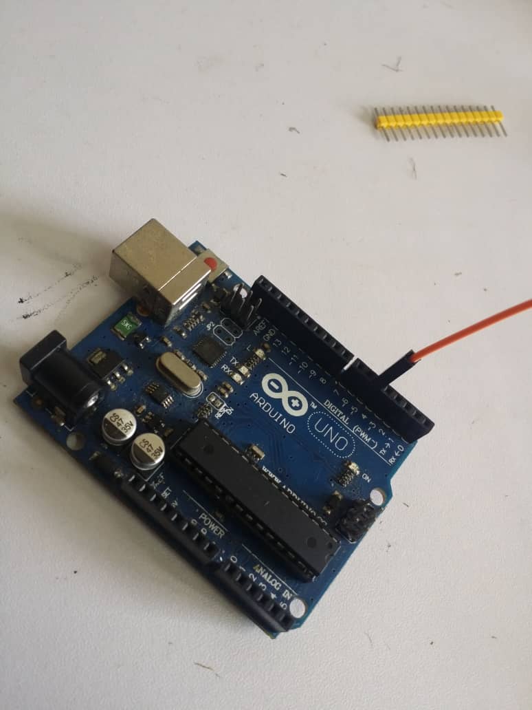

    So this is my 1st official trouble im facing,
    SimTool cant communicate with my servo. I have downloaded the "Rcmodel.zip" from @eaorobbie https://www.xsimulator.net/community/marketplace/rc-model-code-for-arduino-uno-2dof-expandable.89/ and use his .ino file upload into my ard uno.
    I had follow the same setting simtool interface setting. BTW im using the latest simtool 2.4 and aware of the axis output command "R<axis1a> etc etc. And also setting all the axis assignment to Surge/roll. When i try to test in output testing, nothing is moving.
    I connect and tested both pin 4 & 5 and none of it move the servo
    My hitec HS-805BB servo are using external power originally from GS4 power supply.
  11. MarkusB
    Jun 30, 2015
    552
    4,213Coins
    +597 / 2 / -0
    You need to connect the GND of your GS4 power supply to the GND of the Arduino. Otherwise the signal line does not have any reference point.

    I need help. i have done like you said earlier, to connect GND from GS4 to my arduino. But unfortunately the problem still the same. Tested on all my servo as well but nothing works.
    what did i do wrong?

    Try changing the arduino code line from:
    const char kEOL = '~'; // End of Line - the delimiter for our acutator values
    to:
    const char kEOL = ']'; // End of Line - the delimiter for our acutator values
    Re-upload to the arduino and then use this for Interface Output in Simtools:
    [R<Axis1a>][L<Axis2a>]
    That's how I have mine set up. There may be a way top get it working with the '~' but I think something changed since the original servo code with a Simtools update which stops the original code from working.
  16. RacingMat
    2,237
    21,031Coins
    in this case, you'll have to change it accordingly in Game Engine interface settings
    by the way, if you use ] then you don't nedd to add [
    this will only slow the code
    R<Axis1a>]L<Axis2a>]
  17. lilted86
    lilted86 Member
    Dec 30, 2016
    87
    Malaysia
    489Coins
    +20 / 0 / -0
    Found it!
    The culprit is my arduino. I have 2 units and both are broken but somehow i can upload .ino into it,weiirrddd... anyway, borrowed my friend's arduino,test it and now all working!
    Merry christmas to all!!!!

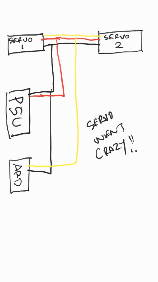

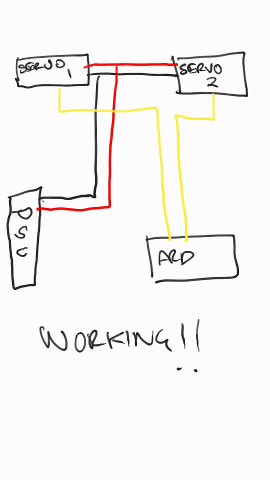

    hello guys,
    so today i made some progress. i have finally move 1 of the flap in GS4 but i encounter some problem which that i need to ask.
    regarding this
    i have tried to sync 2 of my servos by taking both signal wire and do parallel wiring like below image, but when i turn on supply 1 of the servo when crazy and it does not response to adjustment in simtool.
    yes, i already check into the arduino code as well. so far when connecting 1 servo it working like it should.
    this is what i do to make both servo working, and of cause i did some adjustment to the arduino code and simtool output script.
    i can use this 2nd method of connecting servos to arduino but i have to write a long script in simtool output example like this :
    A<axis1a>~ B<axis1a>~ C<axis1a>~ D<axis1a>
    this is just for left moving plate in GS4 which is has 4 servos divided by 2 group, normal and inverted servos. A and B is inverted servos.
    i read somewhere if i write the script very long (A+B+C+D=left flap) + (E+F+G+H=right flap) + (I+J+K+L=left bottom) + (M+N+O+P=right bottom) , the simtool will process the script slowly and giving the feedback real slow. can any one confirm this?
    btw i am sory as english is not my native language. i hope you guys still understand what im trying to explain here:p:p:p
  20. MarkusB
    Jun 30, 2015
    552
    4,213Coins
    +597 / 2 / -0
    Some time ago I used RC servos and did this parallel signal wiring. It worked without problems.
    One difference in my setup was that I connected the Arduino to an external 9V power supply, so that it did not rely only on the power provided by the USB port.
