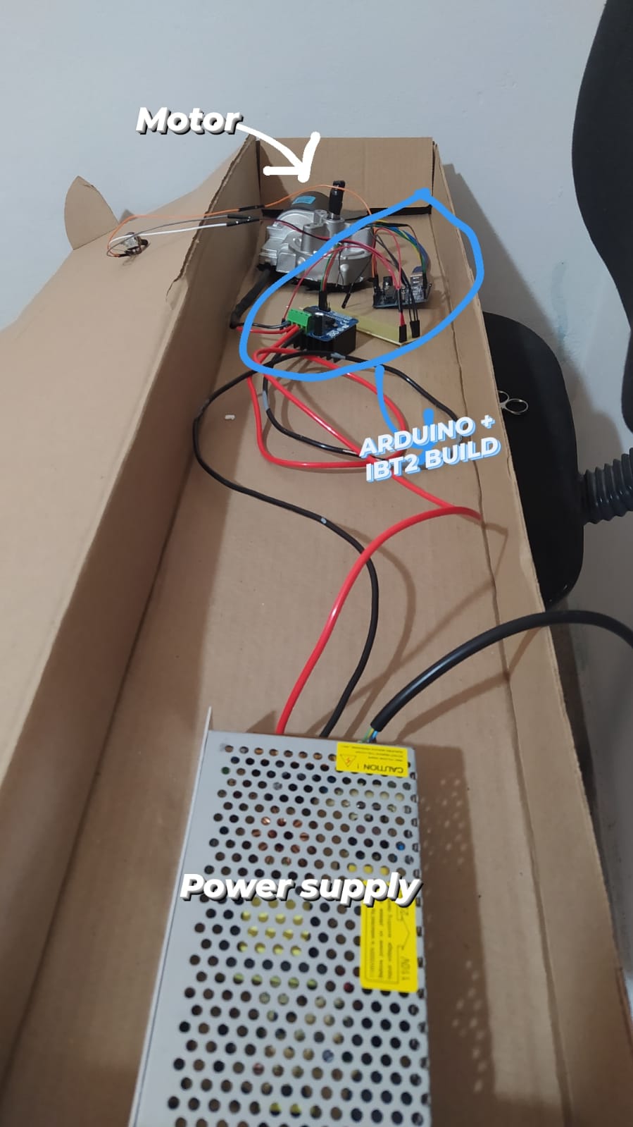

    One thing that is important to mention, motors from the list were pretty hard to find, so i got a lookalike, if anyone in latin america is struggling i am using a 35Nm, 85RPM, 12V "motoredutor" from the brand J11, looks like a big wiper motor, but a little stronger.
    I followed @RufusDufus detailed tutorial on Arduino + IBT2 build (https://www.xsimulator.net/communit...3dof-motor-driver-and-windows-utilities.4957/) And it worked perfectly.
    I am currently testing on a single engine, SMC3 tests have been sucessfull, i guess the next step is using simtools
    Heres the shopping list (i'm new so idk if i should post links, if anyone needs it DM me) :
    - 1 'motoredutor' motor [82 RPM, 35Nm, 12V, 20A]
    - 1 IBT2 controller board
    - 1 Arduino Uno R3
    - Lots of jumpers to connect your arduino board to everything else
    - A couple of 10k potentiometers (i burnt some hehe)
    - A 12V 25A Power supply, or as we call it here "fonte chaveada", i found 25A to be cheaper than 20A and its good to have a supply margin on those, you never know
    - Some scrap metal so you can make a housing for your potentiometer
    Its kinda thrown around, but heres a view of everyuthing, it was setted on a wallmount but i took it off cause we were moooooooovingg
    By the way, Dmax on youtube helped me a lot, that guy is awesome

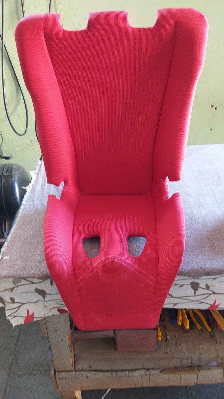

    on the structural side of the build (where i am much more comfortable at) i made a seat!!!!
    DIY Carbon fiber structure and then cushioned, heres a pic, it weights 560grams
    Chassi is almost done as well, i am finishing painting it, will be posting soon!
