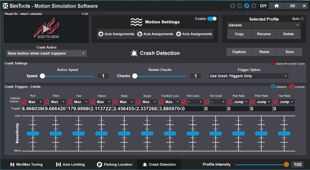

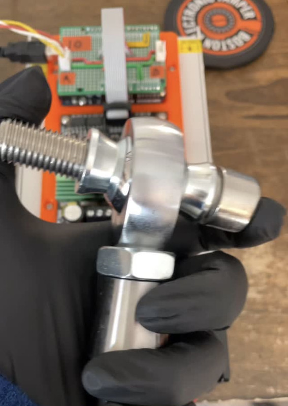

    Hi All, here I share my dream racing sim rig DIY build... a 6 DoF Steward platform base...
    Also some post on my IG story.
    Here I share the arduino code. My revision with some additional codes filters out the ringing hunting PWM noise on my motor during idle. It is very very silent now.
    Here I share the full assembly 3D CAD design files. When you use it, please credit me @BOSeTAMPER as the original creator.
    Here is my Simtools setting:
    List of Electronic control components:
    List of Mechanical components:
    List of Machining/Welding parts:

    Thanks! Exactly, I want a compact build. Originally for go-kart setup.
    I just added the code on the post, see on the top link.
    The heatsink is fine (not that concerning the hot level). I add a small fan just for extra precaution.
    I do have 1 lemon board though, just a warning. I checked the solder quality on that particular one is just way low quality (should not passed if the manufacture is actually test it).
