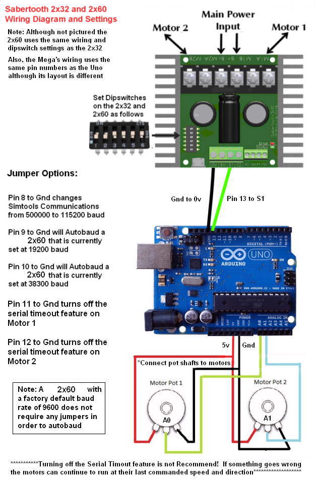

    Sold the 1060 and bought a 1070 (1080 would be bottlenecked by my CPU).
    Next... Sabertooth 2x60. Question: could I keep my two DPS600 or should I buy a new PSU?

    Since one jrk keeps giving me problems, I chose to move to Sabertooth 2x60, so I also won't have to limit motors to half their power in order to use them.
    I hope to be able to make the switch for July, in time for my holidays because I have no motion now. And that sucks!

    Next month I'm moving to sabertooth. Having to use the motors at 33% their full power is not fun at all...
    2x32 should be enough for my motors that work at 23A. I'd really like some suggestions for what PSU to use with it.
